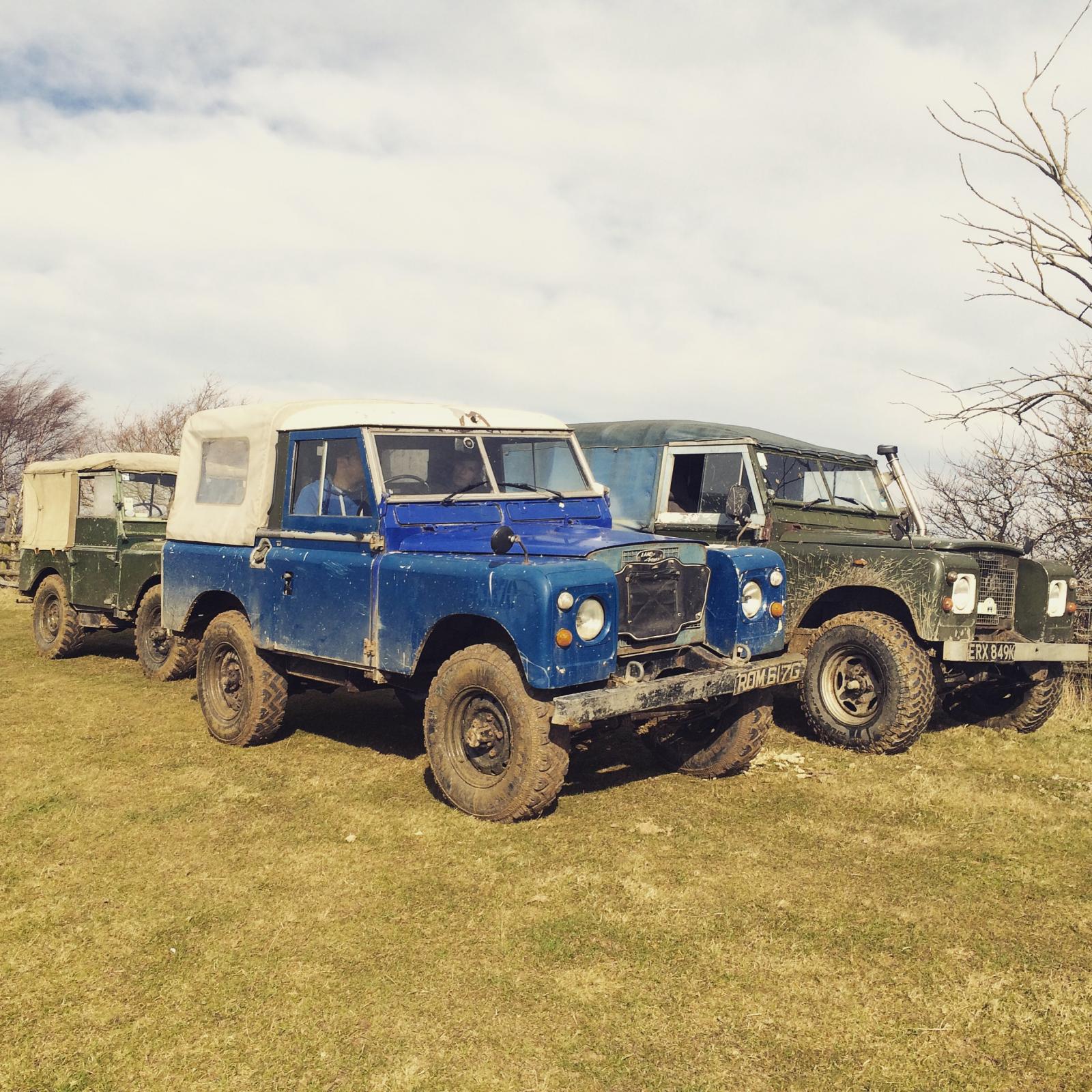

This weekend we went GREENLANING for a pal's birthday, the other motors in this cast of wallies are a 1966 ex military 109 ambulance which is now a double cab pickup with Disco engine and Defender gearbox, a 1969 88 with a disco donk and Defender gearbox, and a 1971 109 with a Nissan Patrol 3.3 straight six diesel and box and axles from one of them Northern Irish armoured jobs!! Which makes mine the most original there, COUNT MY RIVETS...!!

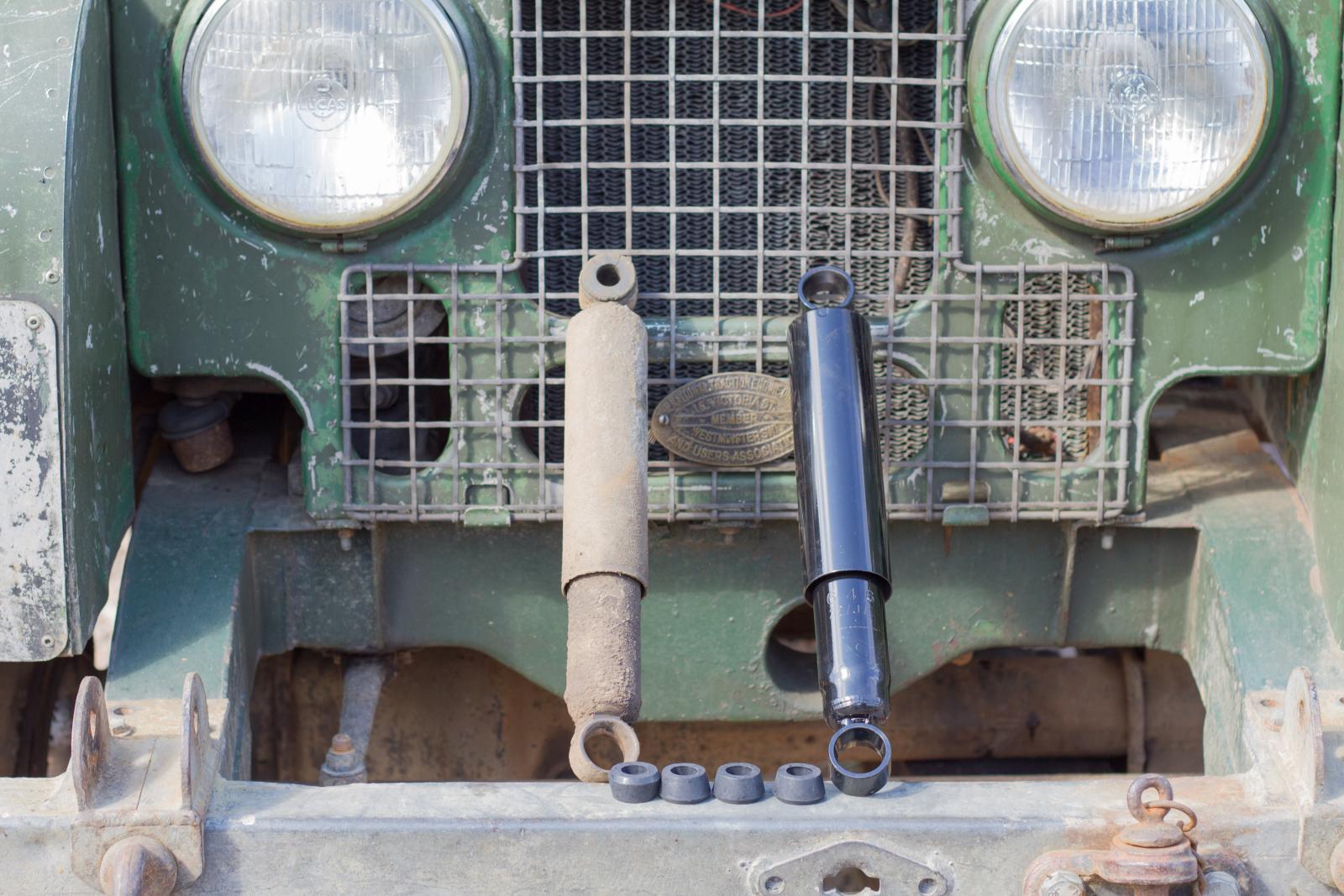

I've been doing a few more miles than is usual with this lately which showed up the dampers and bushes were totally borked. Fortunately I had a set "in stock" along with bushes so I changed them the other day:
S H I N Y
Shit what a difference, vastly improved!! It's still an old cart sprung farm hack so hardly up there with a Citroen but all the crashing and banging has gone and speed humps are no longer a literal headache.

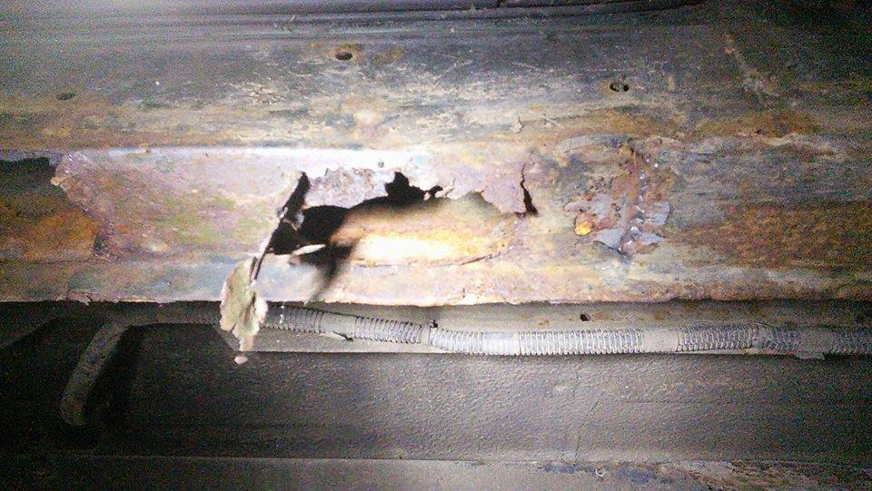

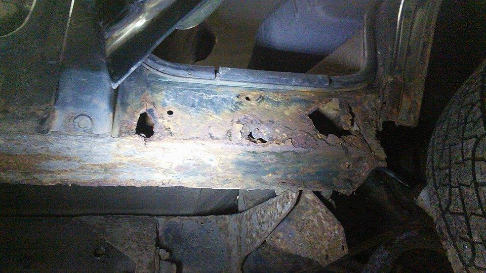

Here's the problem with old Range Rover Classics:

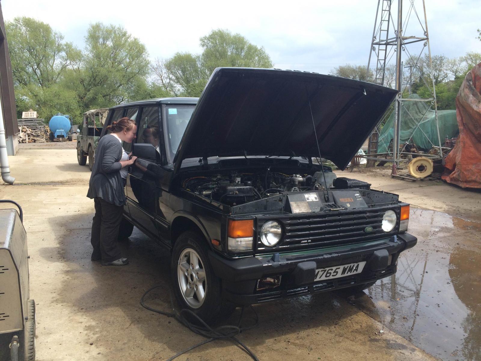

All done now with lots of lovely new steel, thanks to me old china Jon, and freshly MoT'd. Picked it up yesterday while on a job in Hampshire.
Needs a massive clean now...

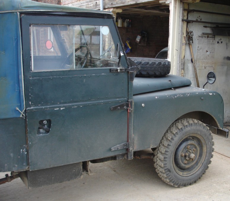

Heres another series 1 offering, this time an 88" from 1957. I bought it in 2009 for about £1400, and 5 miles into the journey home it broke down. The distributor had seized so there was little prospect of a roadside fix and I was relayed home. It looked like this:
Plenty of mirrors, the galvanising painted and just about everything else painted in green Hammerite. I revived the engine with a borrowed distributor; it was noisy and after investigating the cost of a rebuild (a lot just for parts) I decided that it wasn't the thing for me.
My wife and I set to with lots of paint stripper and tidied it all up a bit. A new hood went on and we used it for 3 years like this:

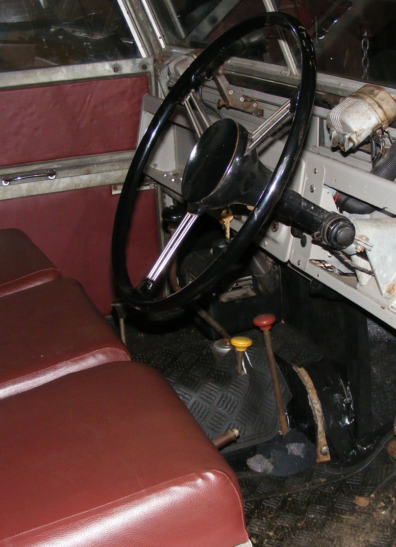

 I'm aware that Landrovers are very uncomfortable and a flawed means of transport. The plus side is that there are lots of ways to make them better without spending much, this is what I've done to mine. At least I haven't covered it with checker plate.

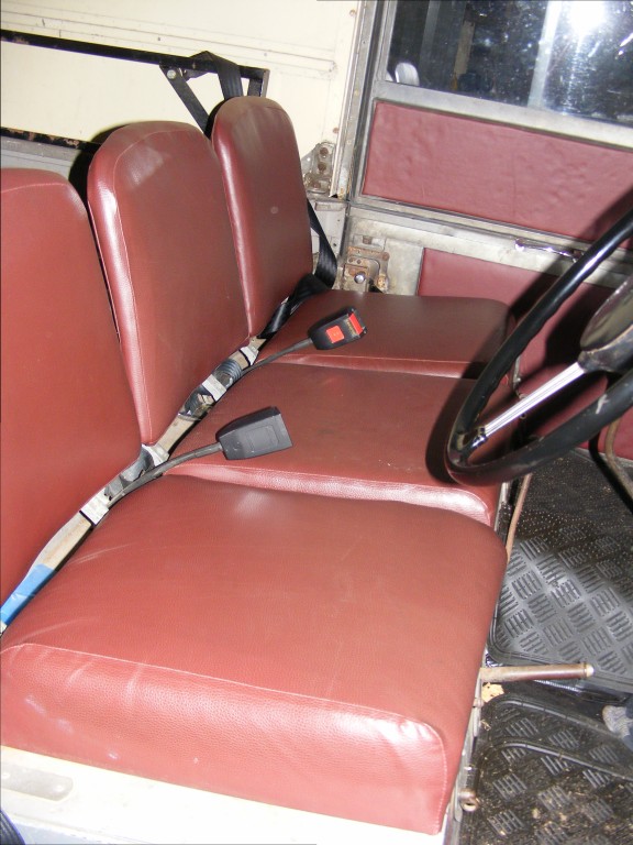

She made seat covers and they went onto a new base with better foam than you get with aftermarket seats. This is not saying much, but it was all I could find without buying new, very expensive stuff. She also cut up old carpet, cheap car mats and odd bits of soundproofing and glued it under the bonnet and on both sides of the bulkhead. We've tried most methods of shutting these noisy bastards up, but this has been the most successful. The doors have padded cards glued onto the inside and the roof has foam lining. The last two have made the biggest improvement.

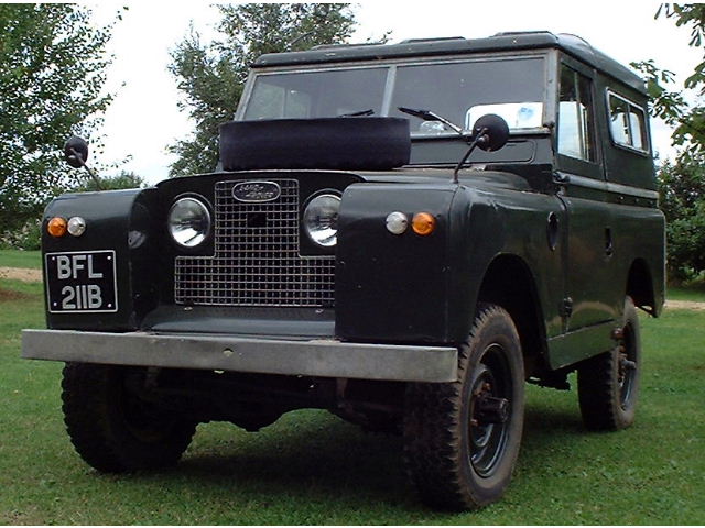

Digging out old pictures to put on this thread I realise that I'm on a decline- my vehicles are looking ever more down at heel.. This is a series 2 that my wife had in the '90's. We rebuilt it with a galvanised chassis and 2.25 engine. After putting up with the usual woes of the original diesel I made a conversion plate up to put a n/a Prima engine in. This was before kits were available and before turbo versions were cheap. It was better than the Landrover lump (not a hard act to follow) but noisy as hell.
 A Dutchman bought it and took it home to his country
