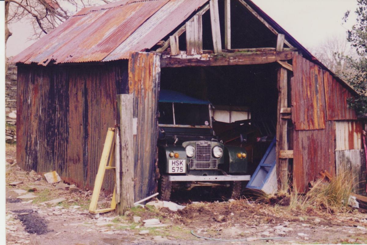

I like the Series 1, good on you for putting it back to normal.This was my old one which still had its very tired 2 litre engine (and rusty bulkhead). I kept it as my get me out in bad weather car, it always started, apart from the day it was being sold, when it decided that it wouldn't run which lost me the sale. (It was just a blocked jet) It ended up having to move house with me and I eventually sold it to my vet. I think it still exists but has not been used for a long time.
If you think the garage looks bad, my house was not much better.
