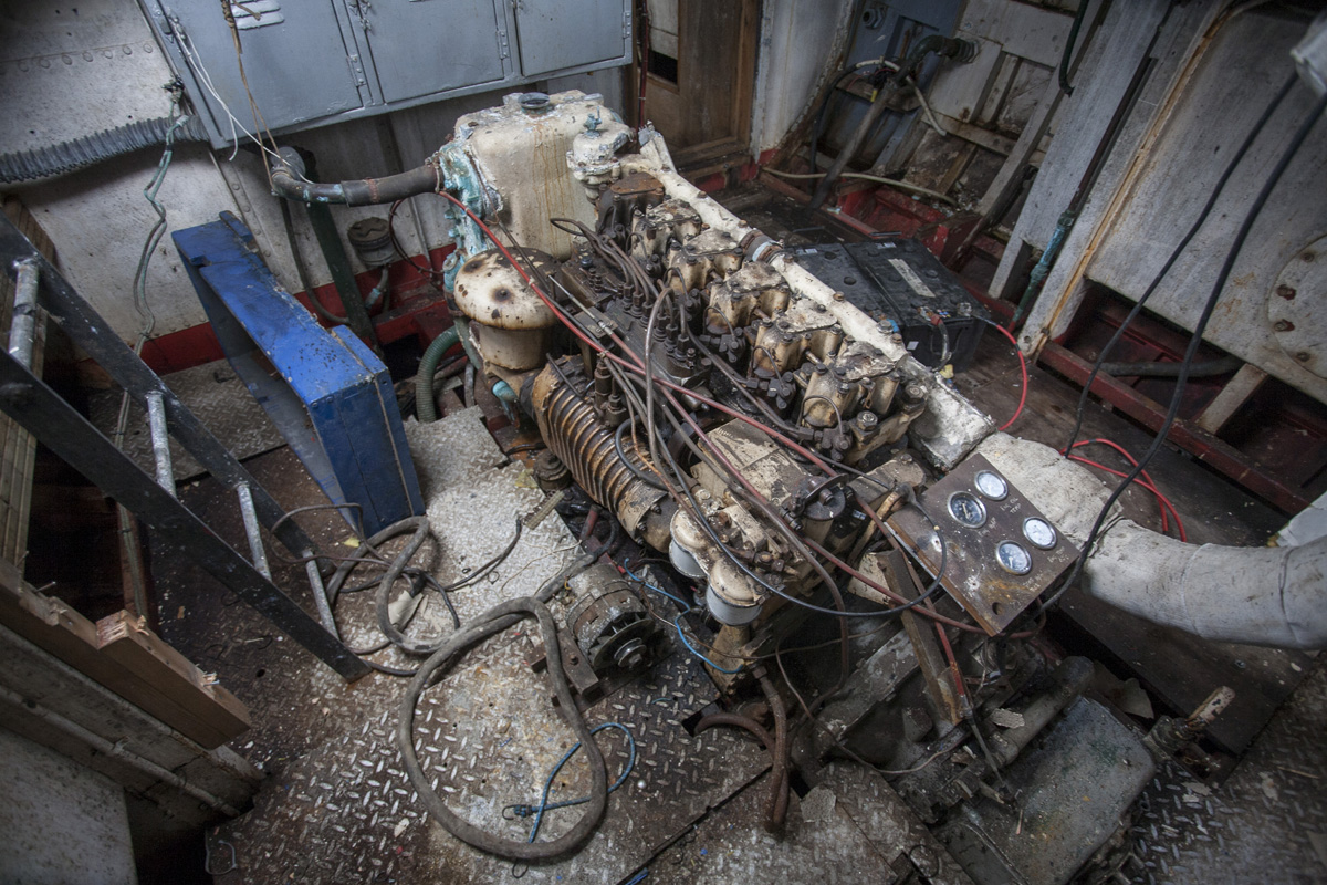

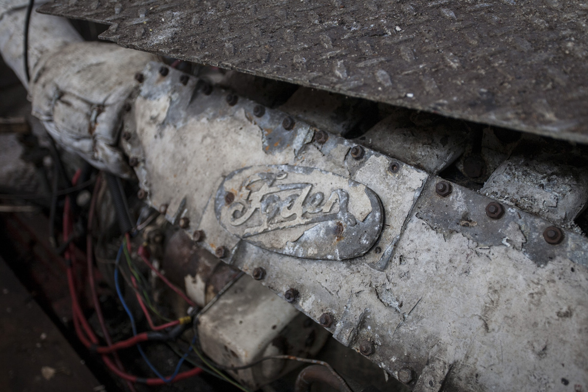

If that's a 2-stroke diesel is it an old GM lump? Never seen two exhaust valves and (preseumably only) one on the intake before...
Edit: I also forgot there is a plan to acquire a spares boat....
Where the hell would you keep that? You can hardly stuff it down the side of the garage under a tarp....
Its a British Foden FD6 mk6, twin overhead exhaust valves operated by roller tip pushrods. intake air is forced by the supercharger into an air gallery in the block and through swirl holes around the cylinder liners so no inlet valves.
I'll try and sort a photo of a piston and liner as my spare ones are in Joe's garage and I'm giving him a hand to change the gearbox on his scimitar (yet again) this weekend.

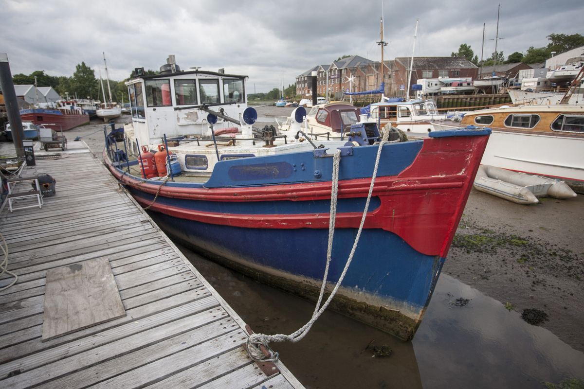

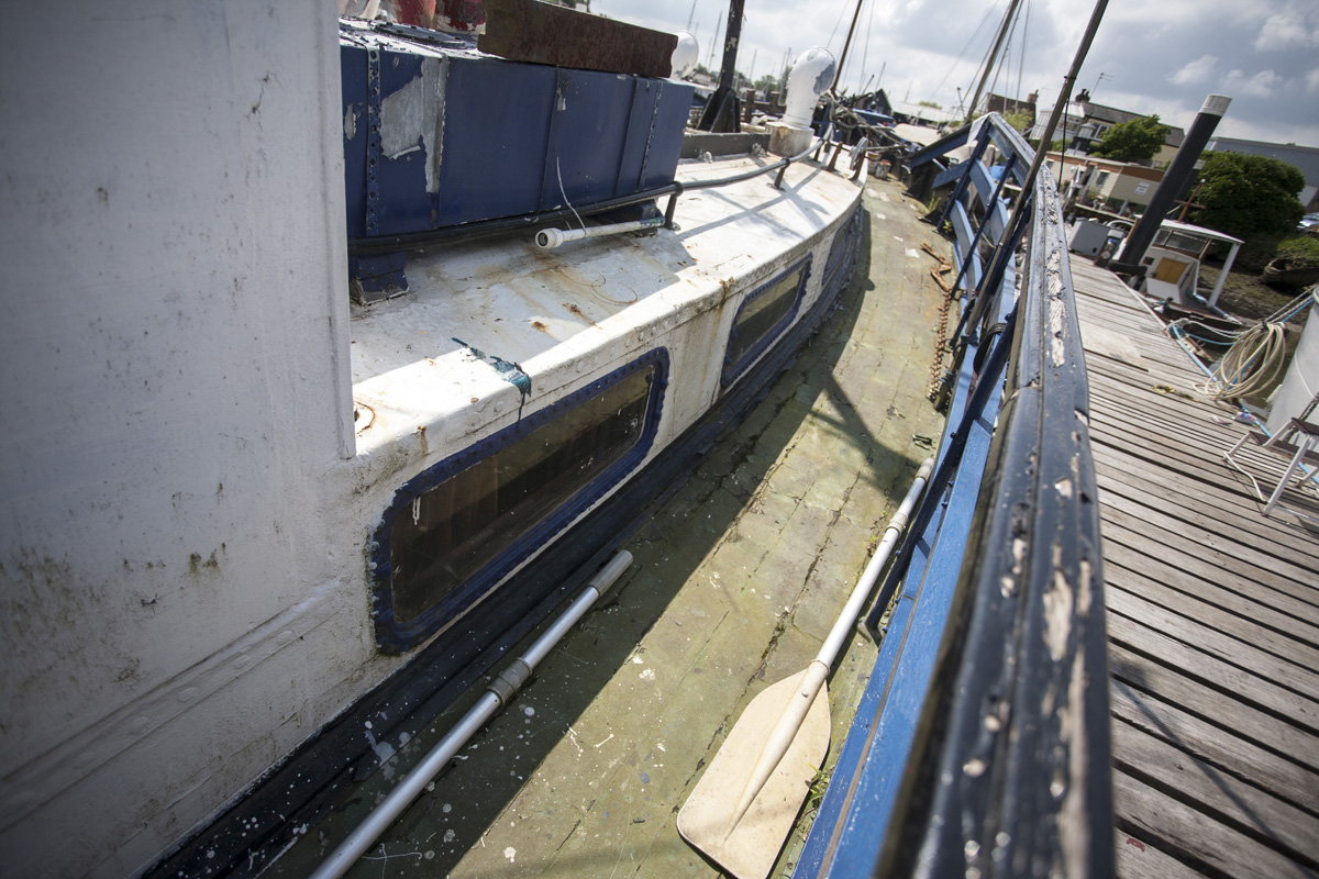

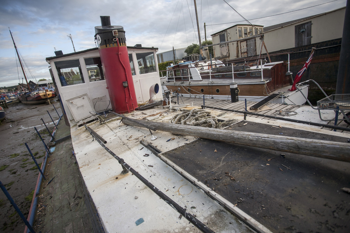

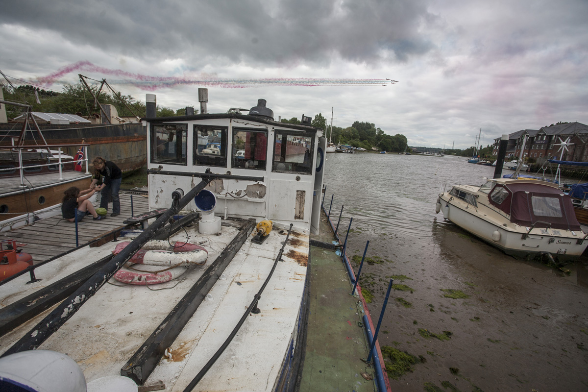

Heres what greeted me on Saturday morning:
The boat had been a livaboard for a long time but has suffered quite badly from mistreatment by previous owners modifications both internally and on deck. The end result is its all been bodged about quite a bit and there are lots of things that needed removing and throwing away.
In this photo you can see a variety of "extras" on the foredeck there is also a shocking wooden handrail which is made of B&Q cheapo pine and falls apart if you poke it...
Aft view, It had aquired a mast, supposedly as a steadysail, cradle for a dinghy and some horrible davits held on my gate hinges as well as lots of other random rubbish.

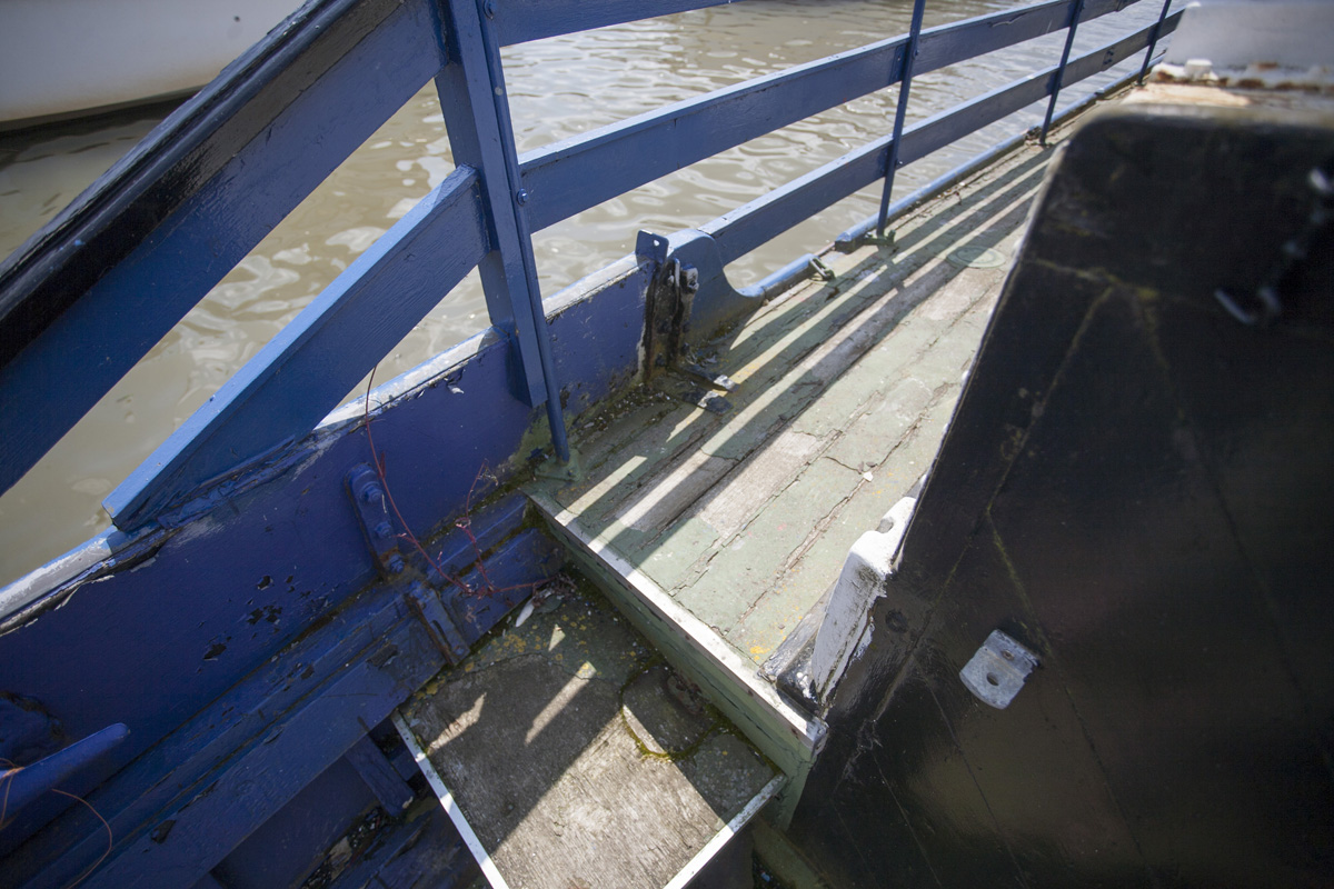

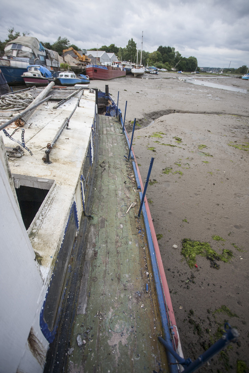

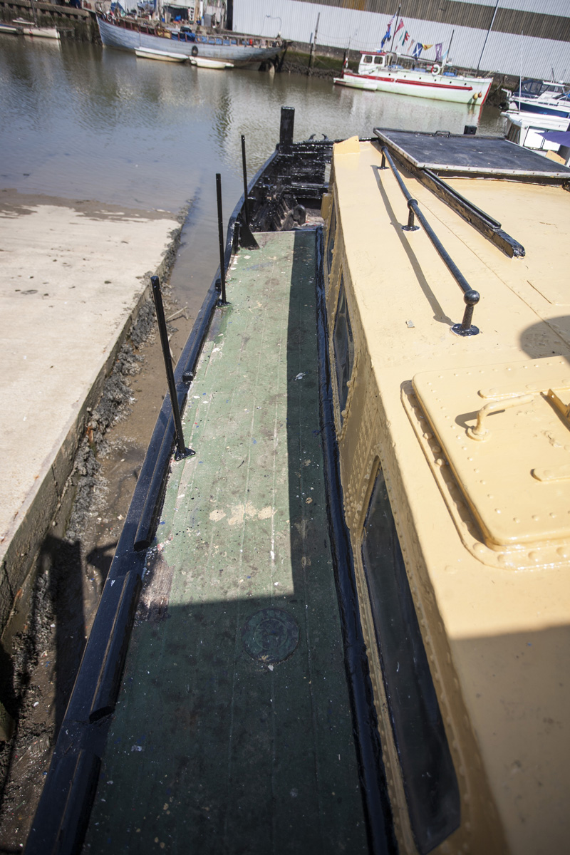

Handrail and Deck closeup,
The teak deck is actually ok but the corking has failed and hence It leaks between the joints. At some point someone painted it green in an attempt to keep the water out...

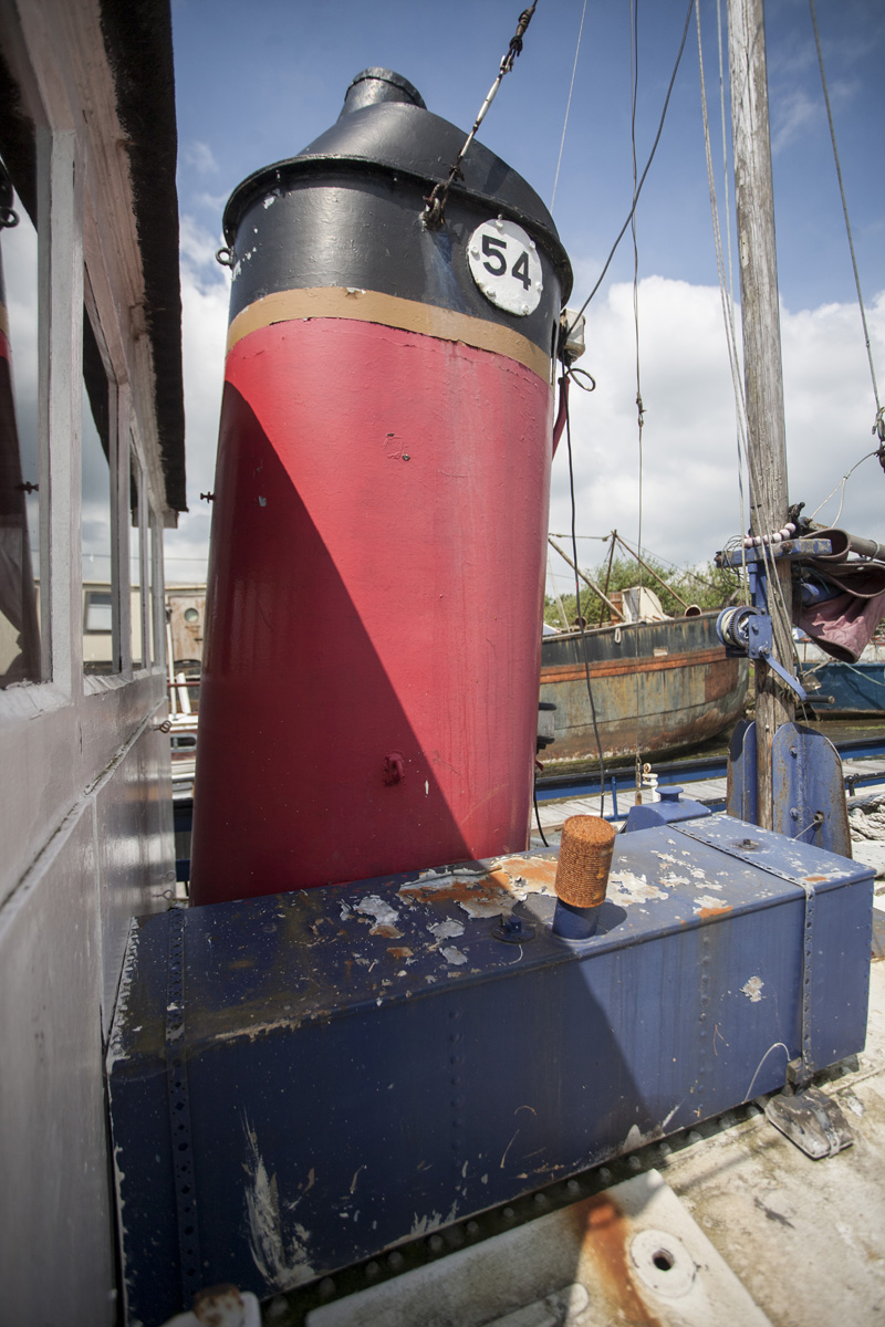

The funnel, which is nice and hasn't been messed about with.

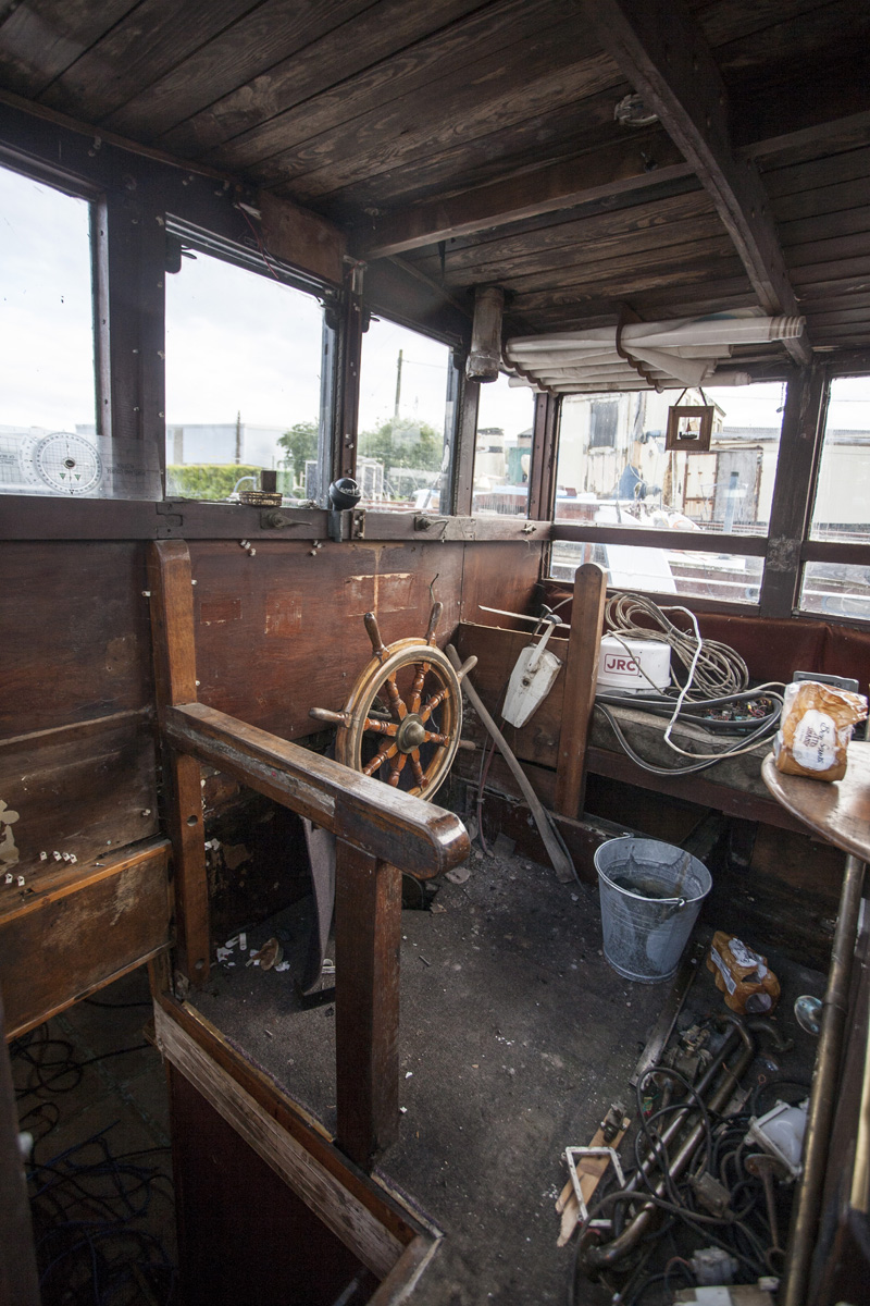

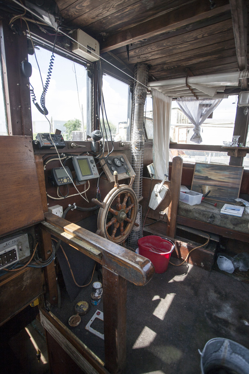

The wheelhouse has been messed about with to make it wider which gives the deck a very cluttered appearance. The following photos show what we found when we looked inside...

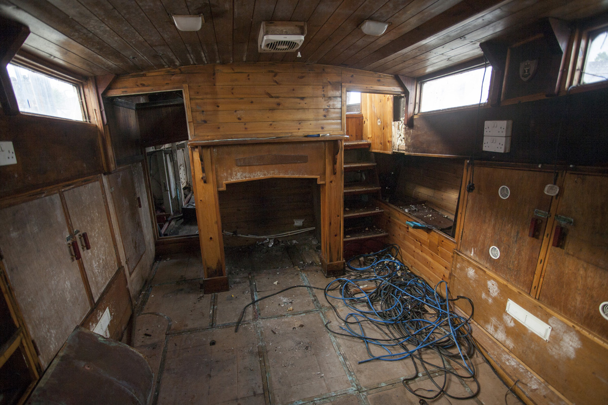

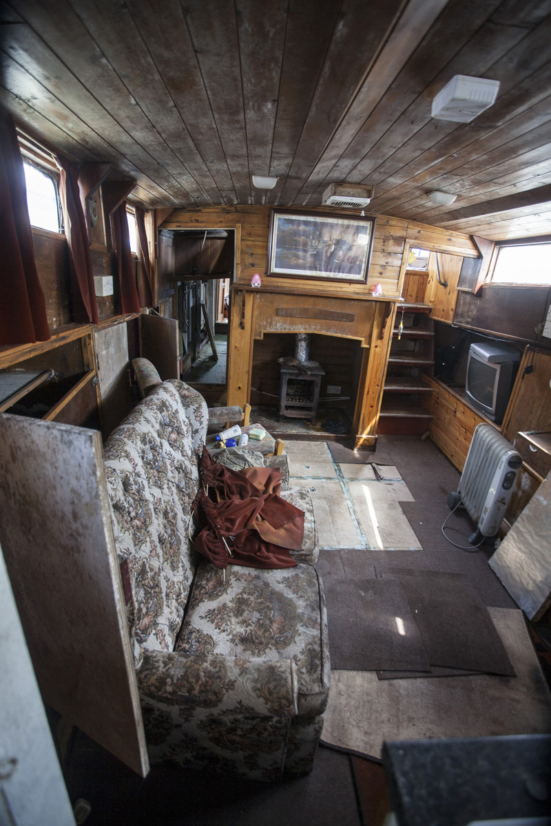

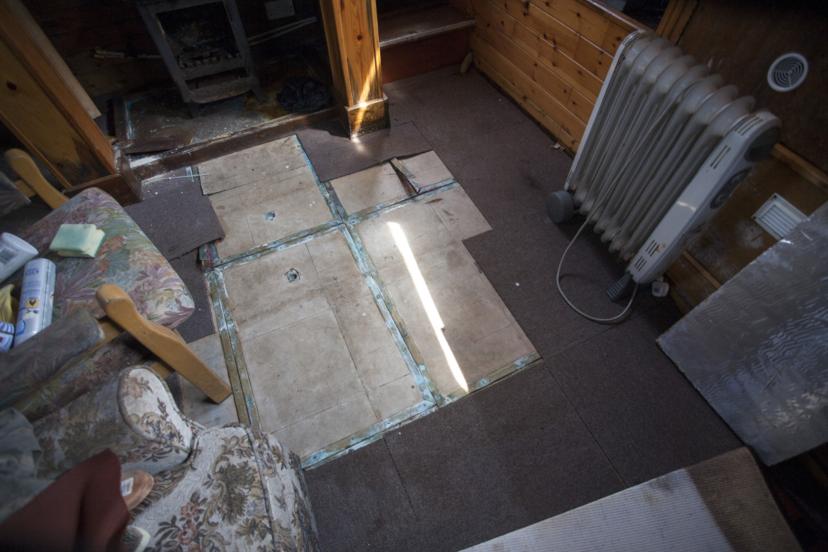

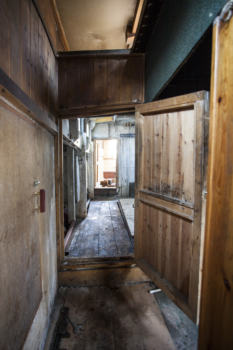

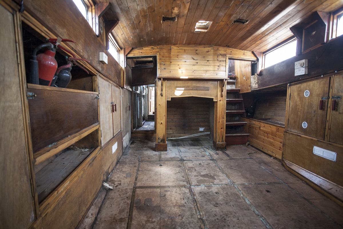

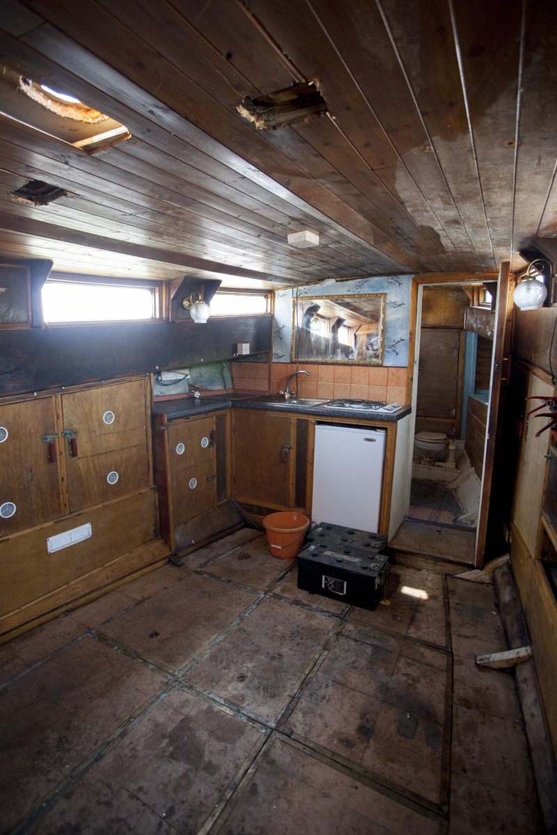

Going below reveals the forecabin, with an overpowering smell of damp carpet tiles. The tiles were apparently floating in there a few weeks back!
Lifting the carpet tiles reveals a less offensive and more practical floor dating from 1970's refit.

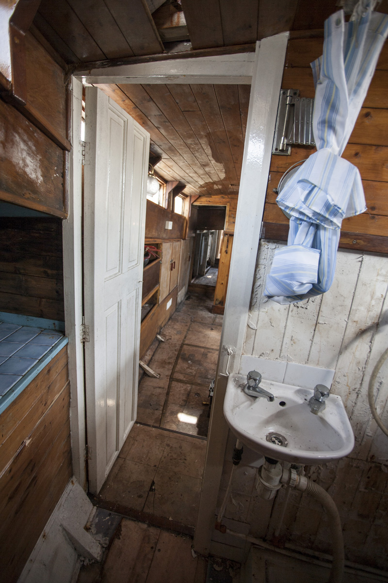

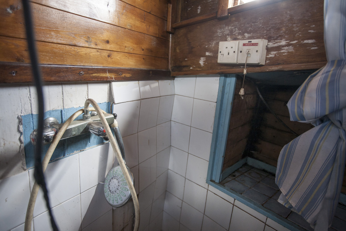

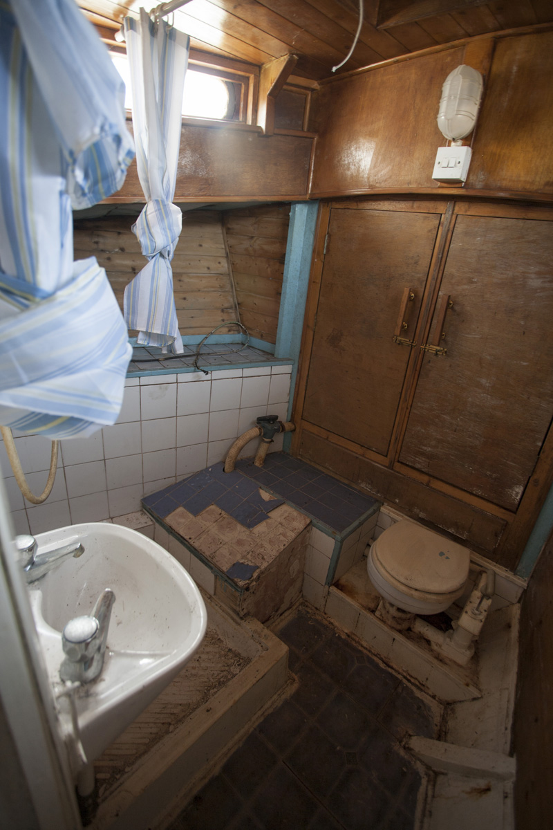

The forward end of the forecabin has been made into a heads compartment, in what has to be one of the worst fitted out areas on board.
In shower Mains electricity anyone?

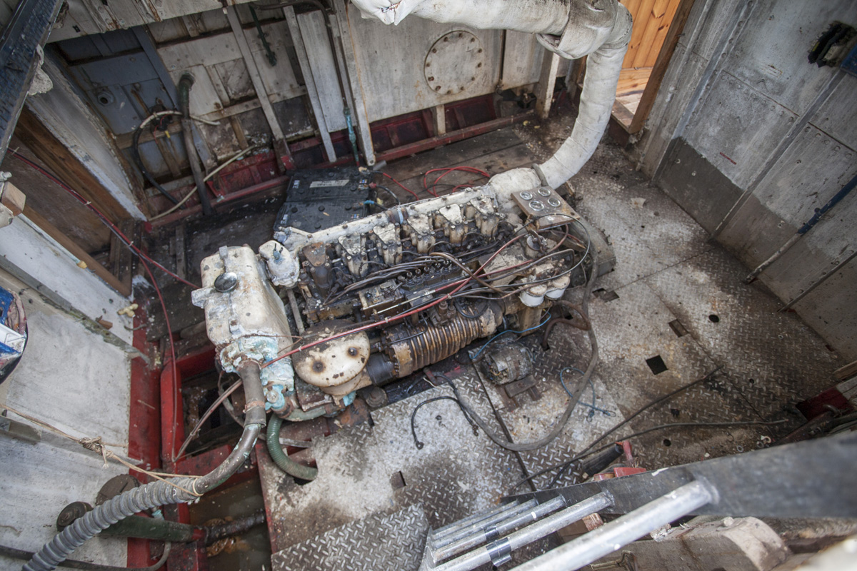

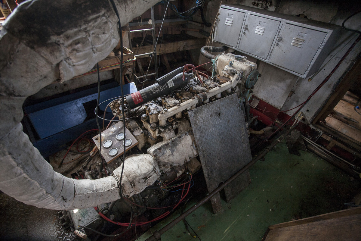

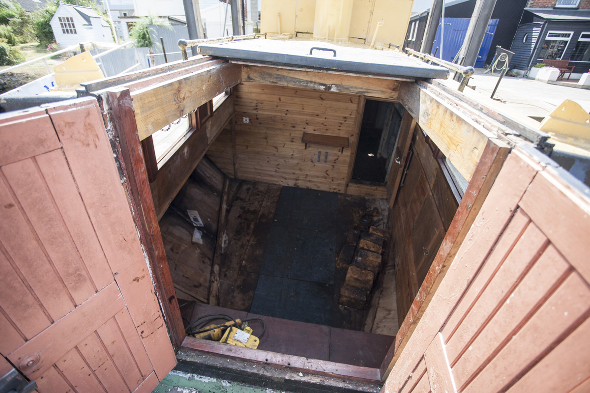

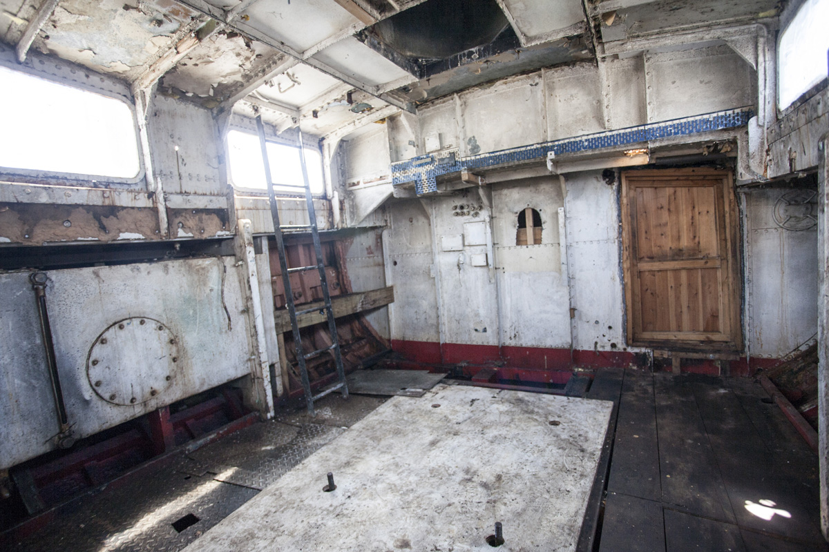

Moving on to the engine room, The engine had not been run for some years but a look at the fuel tanks suggests there is 90-110 Gallons of diesel on board.

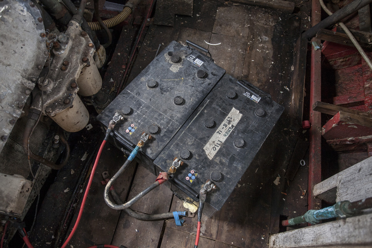

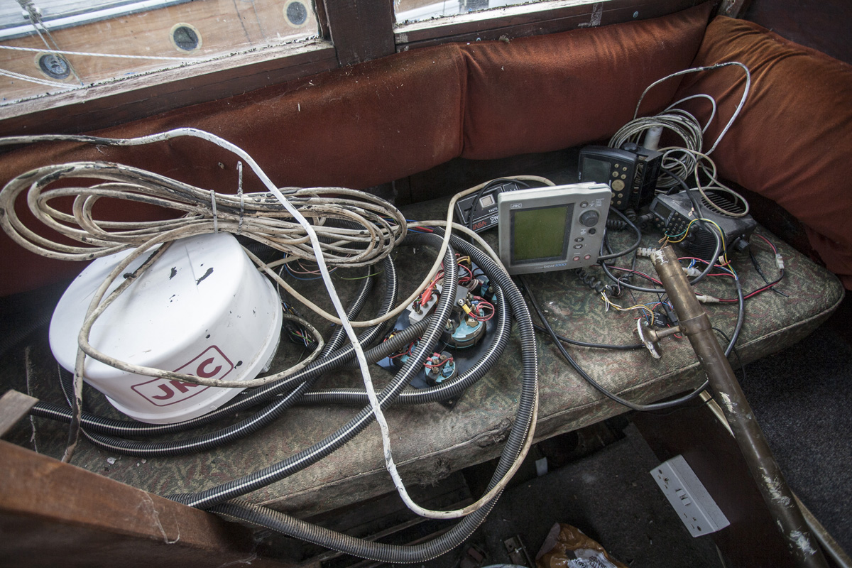

The on-board electrics had apparently been refitted by an oil rig fitter...

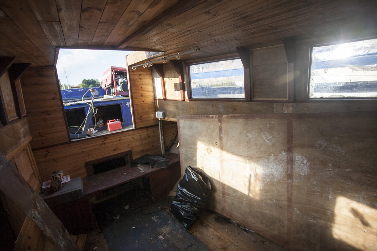

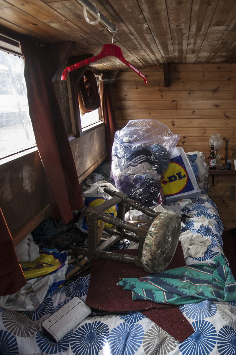

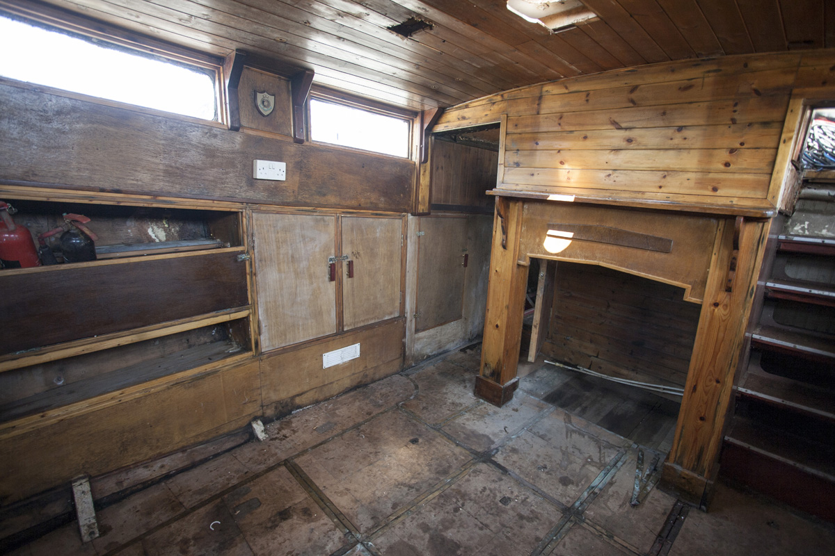

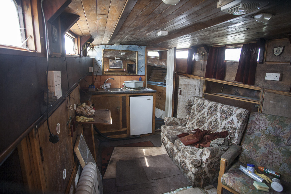

Moving into the aft cabin, most recently being used as a bedroom, it now was filled with damp mouldering clothing, bedding, vhs cassettes and other leftovers. The smell really was very bad.
I've got some other photos to sort through and post up later but thought I'd stick these up before going to work.
Cheers.
Joe

Carpet tiles were stripped out,

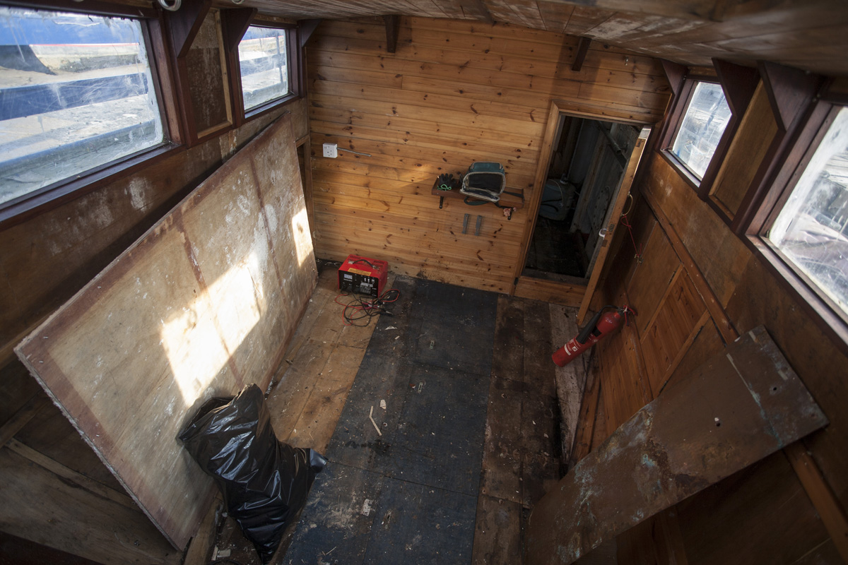

The aft cabin was cleared of clothes and other rancid items,
Forecabin had the remaining furnishings binned,

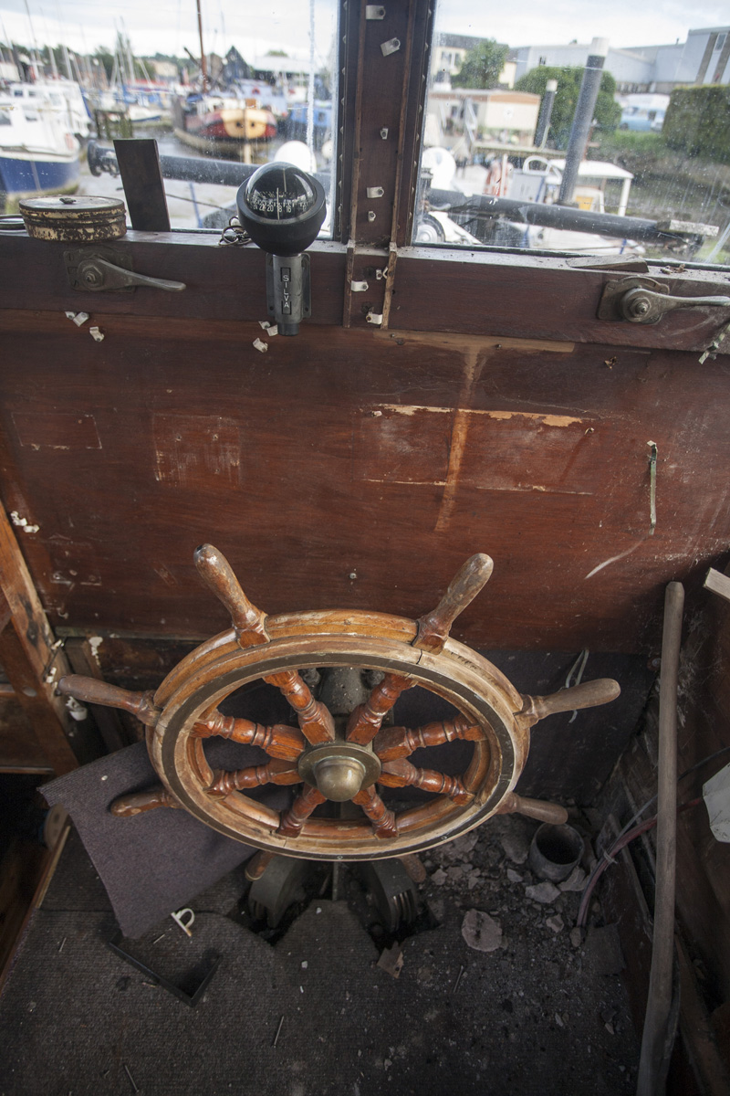

De-badged?
Deck showing tanks removed, and masts lowered for removal, also the bodged starboard handrail has been removed...

We also found time to take a look at the engine and see if it runs... To the best of anyone's knowledge it had not been run in all the time it had been at this yard (about 14 years) First port of call was to borrow the battery's off of daves boat.
Ready to run?
A poke at the fuel tank reveled it has about 100 gallons of cherry in the tanks which is an unexpected bonus. The gearbox linkages were then disconnected and we then turned the engine over on the starter to make sure the fuel was pumping ok. It took quite a bit of messing about to adequately bleed the hydraulic Governor.
After a couple of goes it burst into life:
In order to celebrate the running of the engine, Immediately booked the red arrows to do a fly past...

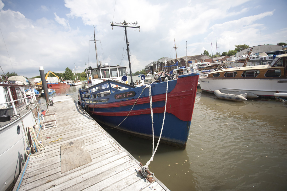

I'll end with a few overviews showing how things were when I left.

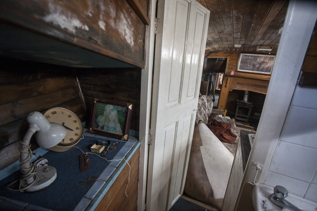

Electronics to be sold

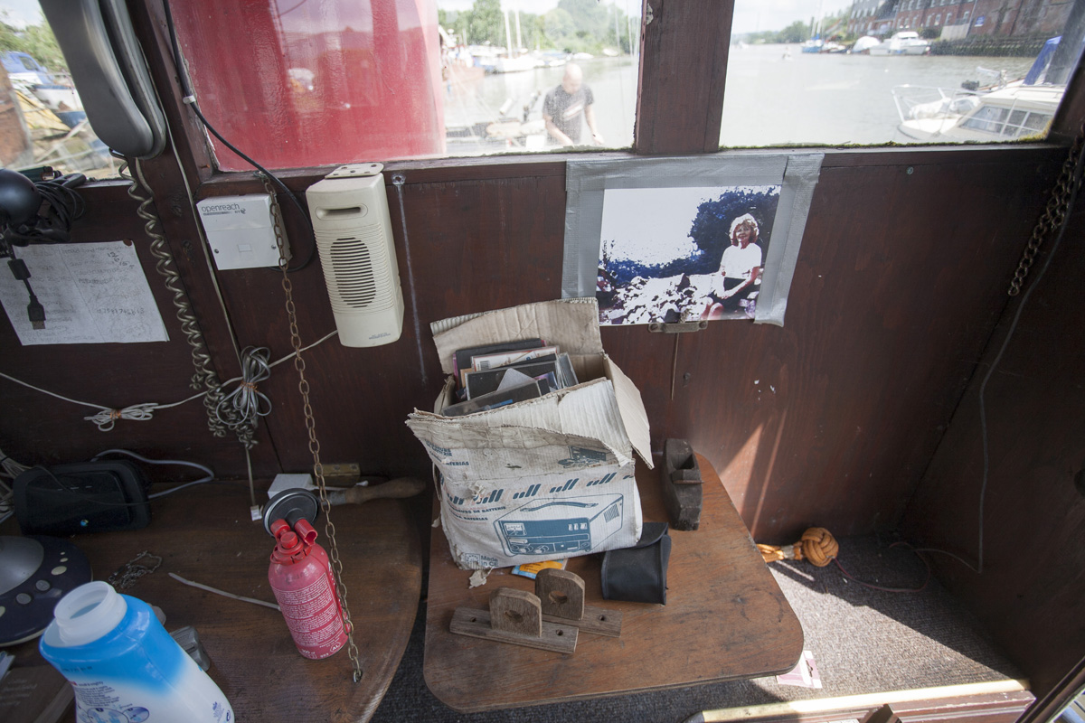

Dated clock, this was saved (as it said made in england all over it)
Port side hand rail removed:

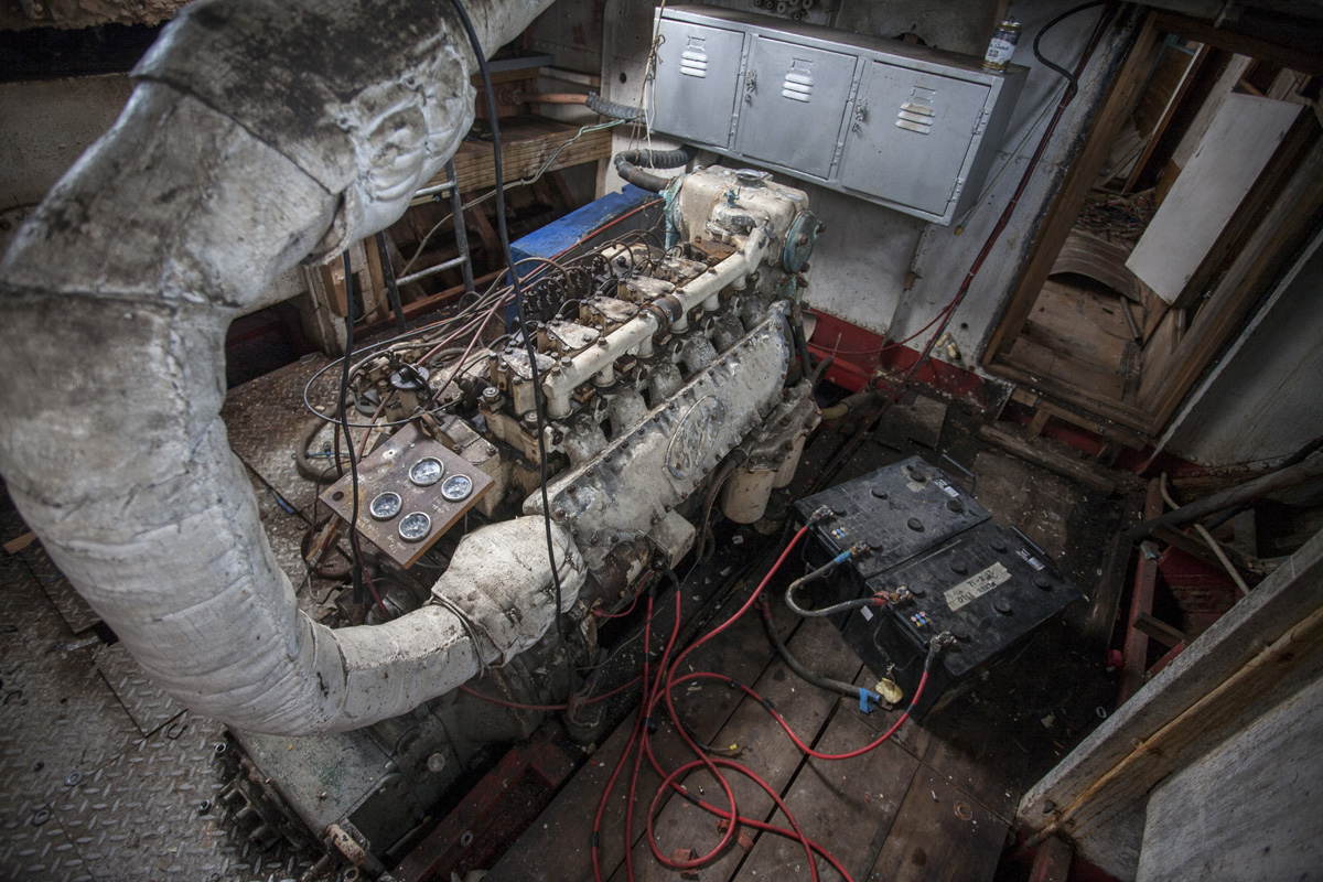

Cleared enigne room:
Aft coach roof:
final overview:

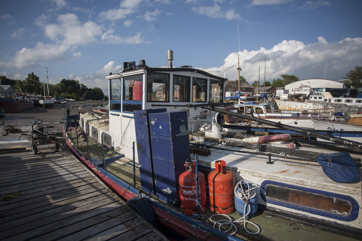

Since the photos were taken It has now moved mooring and sits alongside Dave's boat, Though it did not move there under its own power as it turns out a bearing in the prop-shaft is seized. Its booked to come out on the slipway next month so there will probably be some new photos to share then!

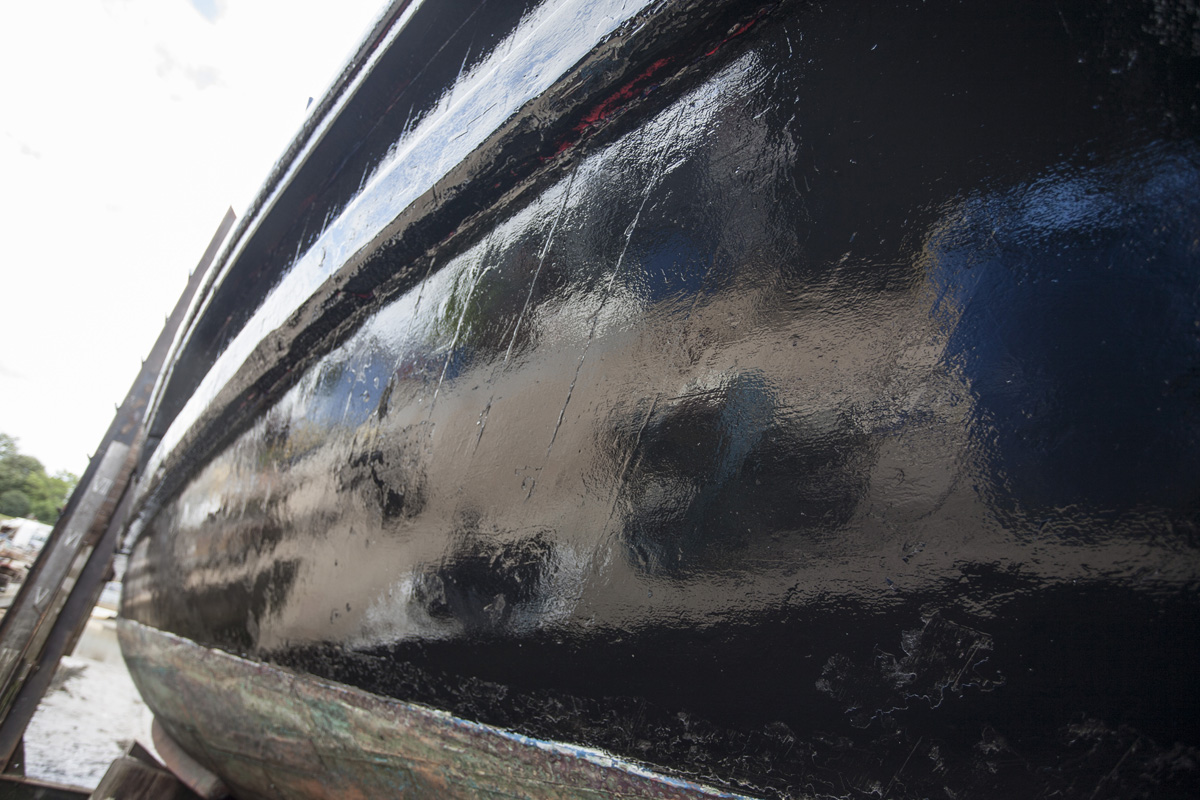

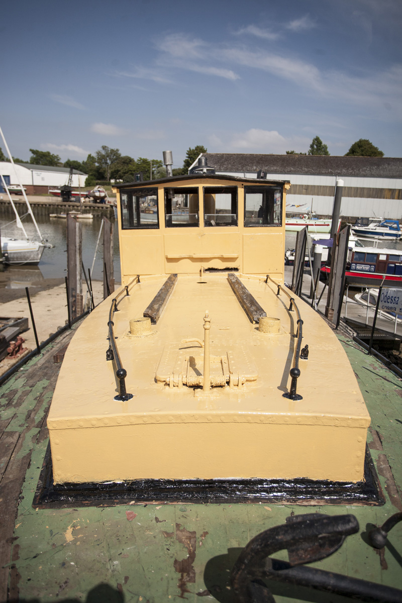

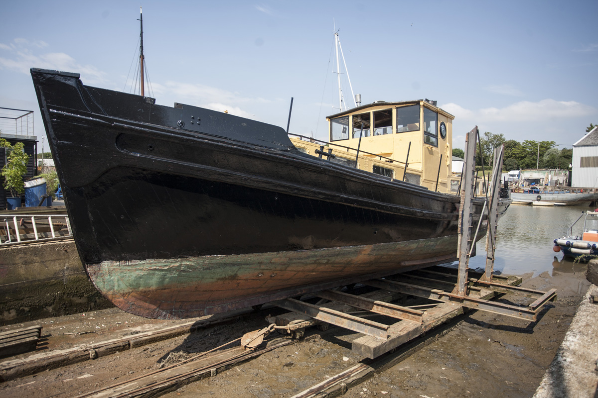

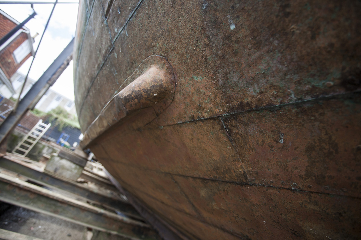

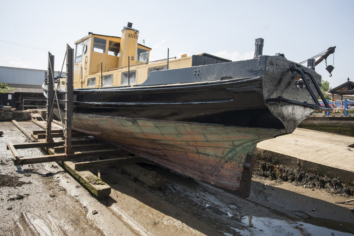

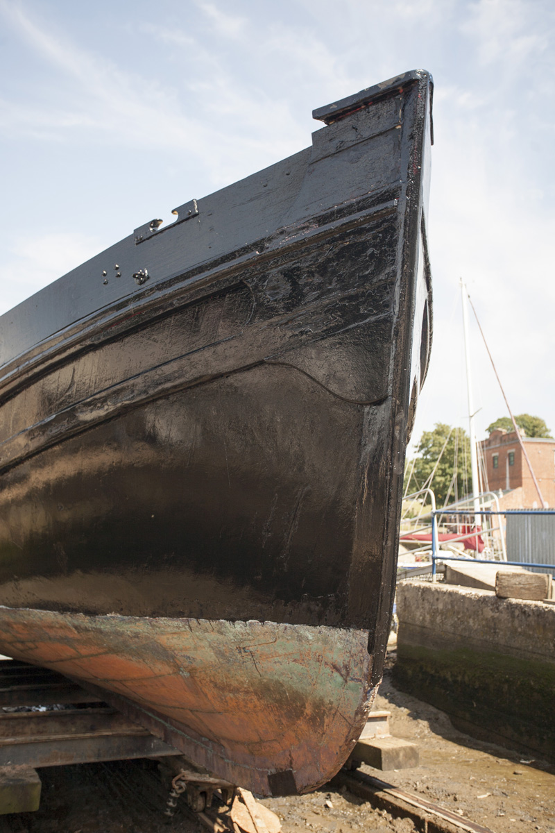

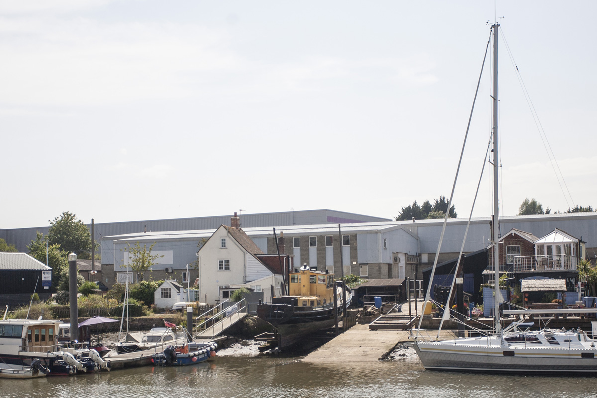

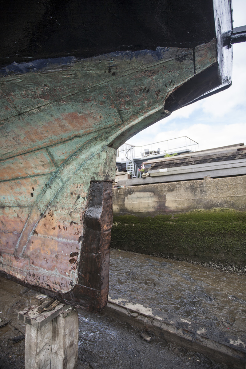

The plan was formed to bring it out on the slipway and to remove the propeller, propshaft and Skeg (bronze bracket which holds the rudder) Dave had already lifted the rudder and the engine out the week before.

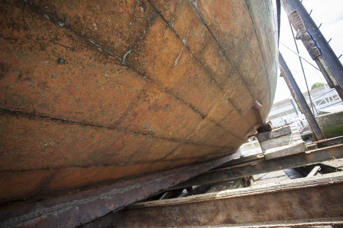

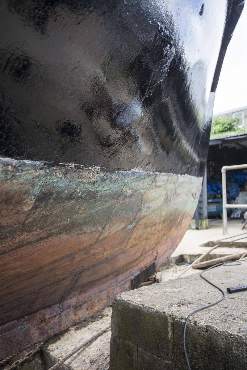

While out on the slipway the plan was to inspect the bottom, evaluate the copper sheaving, make any repairs needed and then give the whole boat a decent coat of paint.
The prop came off easily but the prop shaft was seized solid and repeated effort with the slege hammer would not dive it far enough inboard to get it out. The white metal bearings had spun at both ends of the stern tube. The propshaft had also badly de-zincified around the bearing carrier which effectively meant it was scrap. In the angle grinder was the only thing that was able to get it out.
The copper turned out to be in very good condition, it needed only minor repairs to get it up to a decent standard. The timber underneath has been protected amazingly well illustrating that copper over teak construction method really does last.
The final task was painting her up in the traditional buff and black of the Royal Fleet Axillary which I hope you'll all agree looks much better:

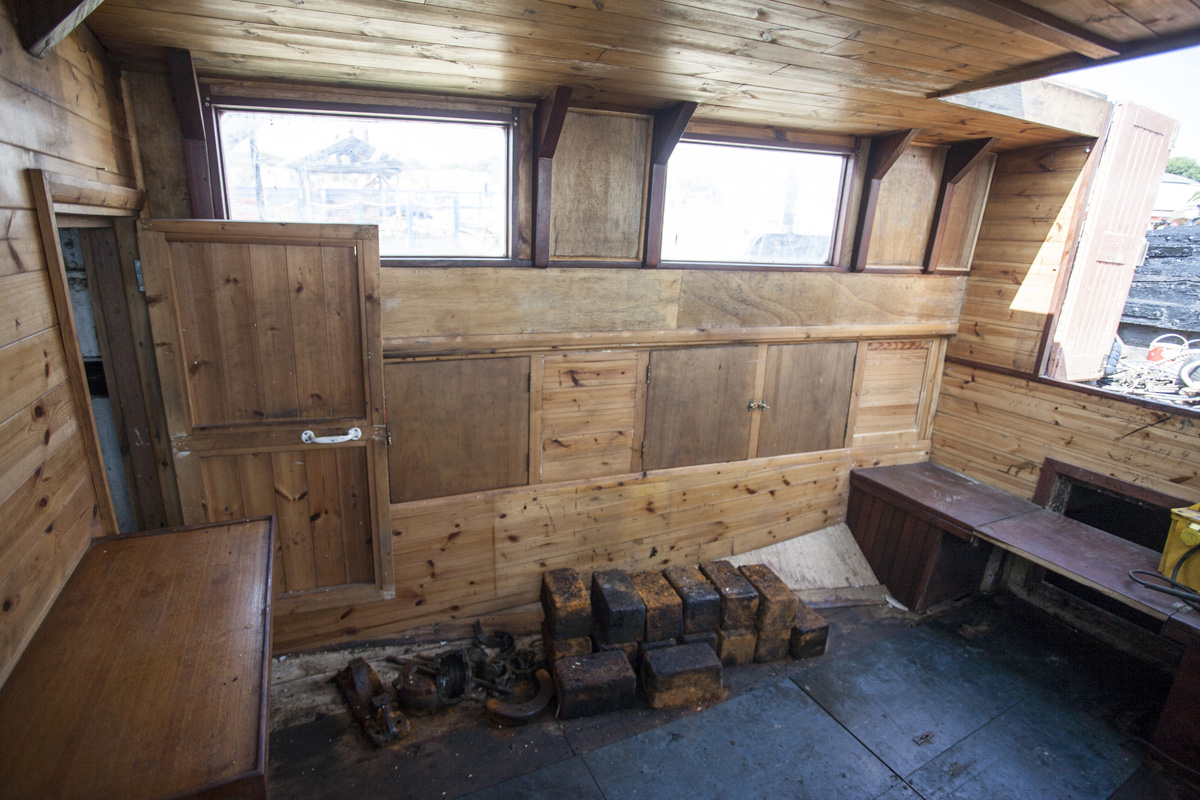

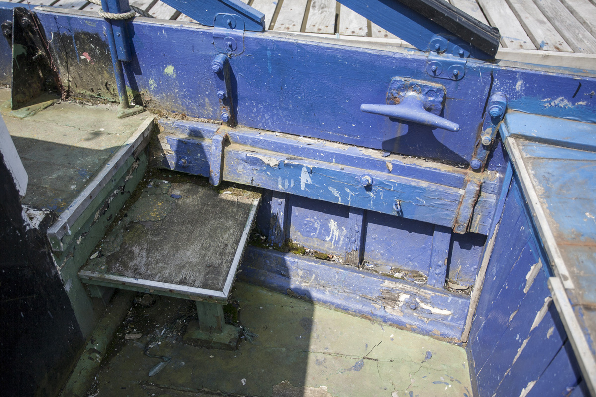

Aft Cabin
Engine Room (former)
Forecabin:
And finally a shot of her ready for relaunch...

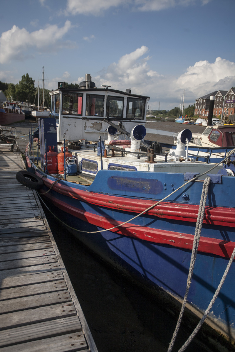

The fleet:
