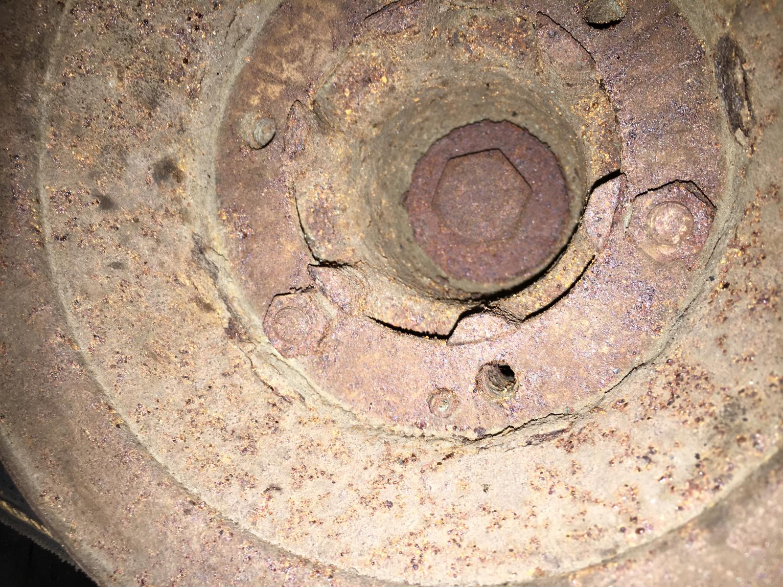

Skizzer Posted February 18, 2017 Author Posted February 18, 2017 Help please! Rover SD1 V8 crankshaft pulley: WTAF? I need to crank it round to TDC to swap the distributor. I'm expecting a BFO bolt that I can swing on to do this, like every other engine in Christendom. But no, there's just a tiny little bolt buried so deep in the back of the pulley that my fingers can't feel it: Flash on the photo makes it look a lot more accessible than it is. Is that it? Or do I need some sort of tool to rotate the crank? Maybe something that slots into those three holes in the pic? Can't find such a tool online. By the way, I've taken the plugs out and tried hauling on the fan belt and crank pulley, which got maybe 10 degrees of rotation and that's it. Or maybe the fanbelt slipped and I imagined the rotation. Grumpy now. Any ideas?
Tickman Posted February 18, 2017 Posted February 18, 2017 Turn it over on the starter and recheck? Skizzer 1
Skizzer Posted February 18, 2017 Author Posted February 18, 2017 I did try that and felt a bit of an idiot as I only had a 1 in 360 chance of being within one degree of TDC. But maybe I just need to be more patient? Doesn't seem like a very elegant solution though...
Guest Breadvan72 Posted February 18, 2017 Posted February 18, 2017 I can see that trying the chancy starter method might lead to even more swearing and random violence than you get in Jane Austen. Skizzer 1
Dave_Q Posted February 18, 2017 Posted February 18, 2017 Socket on a bit of extension? I don't have any experience of this particular engine, but on every other engine I've seen that bolt in the middle of the pulley would be the one to turn. Skizzer 1
Guest Breadvan72 Posted February 18, 2017 Posted February 18, 2017 Autoshite is surely in a happy place when there are two threads about slightly foutu SD1s on page one. Could you use an emaciated starveling child chimney sweep to climb in and get it? You do still have those in Wales, I assume. spike60, Dave_Q, anonymous user and 2 others 5
Guest Hooli Posted February 18, 2017 Posted February 18, 2017 I'd go with the deep socket/extension bar idea too. Pretty sure that's what I did when I timed up the V8 LR I had once, I don't remember any hassles so the normal way must have worked. Skizzer 1
Skizzer Posted February 18, 2017 Author Posted February 18, 2017 Thanks chaps, I'll persevere with trying to get a socket on it unless anyone else comes up with a better plan. Good to know I'm not going mad and missing something obvious. God only knows what size socket fits, the odds of me having the right Whitworth deep socket or extension bar combo might be even worse than starter motor roulette.
