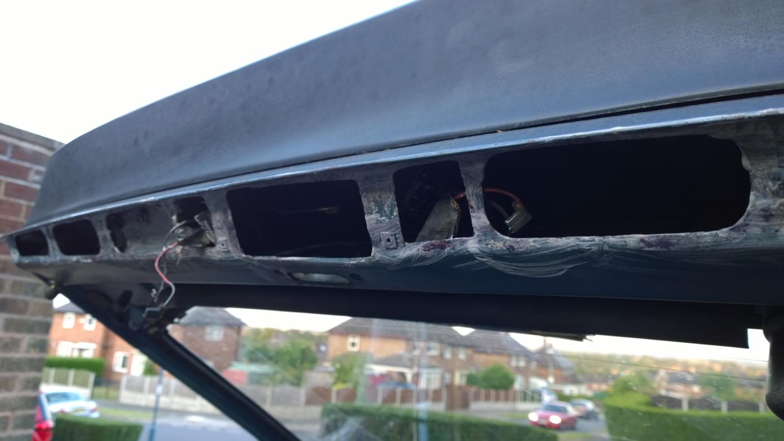

Skizzer Posted January 2, 2018 Author Posted January 2, 2018 looking through other threads, the rear seat back hinges can be seen either side on the rear wheelarch check out this pic from RR http://forum.retro-rides.org/thread/201402/kelvinators-sd1-vitesse this link goes direct to a thread with loads of pics of the boot lock and mechanism how about undoing the hinge and pivoting the seat back upwards on the locked top pins? might give you enough room to see what is going on with the lockSome progress this morning. I wrestled the seat base out, which exposes the screws holding in the side wings, which then lift up to allow access to the hinge bolts at the bottom of the seat back: These are T40 torx bolts (how very Car of Tomorrow!) which responded well to a big ratchet driver once I managed to manoeuvre one in there past the seat wing and hinge hardware. Then the whole seat back just pivots upwards on the latches... in my dreams, that is. In reality it lifts about an inch. If I can wrestle out the side wings fully then I should be able to get at the latch bolts at the top. The trick will be doing that without breaking the seat wing retaining clips. I ran out of time this trip but will have a fresh go later/tomorrow. Onwards and upwards. I must say, the more I work on the SD1 the more I think it is a thoroughly well designed car, contrary to what everyone in the pub will tell you. If only they'd built the bodies out of better quality steel, and perhaps paid better attention when nailing them together. Have a moody photo to compensate for lack of real progress. Note: the apparent puddle on the right is NOT from something leaking out of the Rover. Cleon-Fonte, andy18s, Zantimisfit and 20 others 23

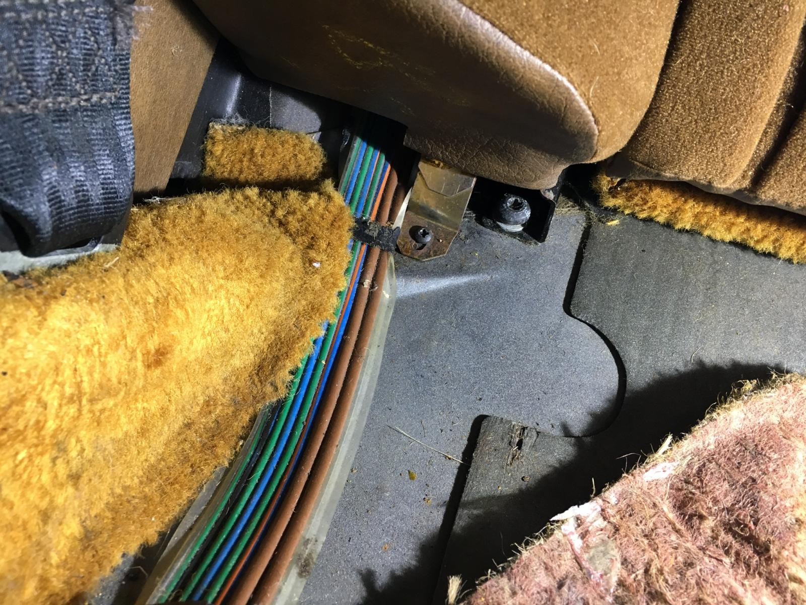

SamR380 Posted January 2, 2018 Posted January 2, 2018 The bench and seat wings are out of mine atm as I'm doing some welding, the seat wing only has the one screw at the bottom, then you have to wiggle and push it upwards. I'll try to get some photos of the catch etc. to help you come up with a plan. Skizzer 1

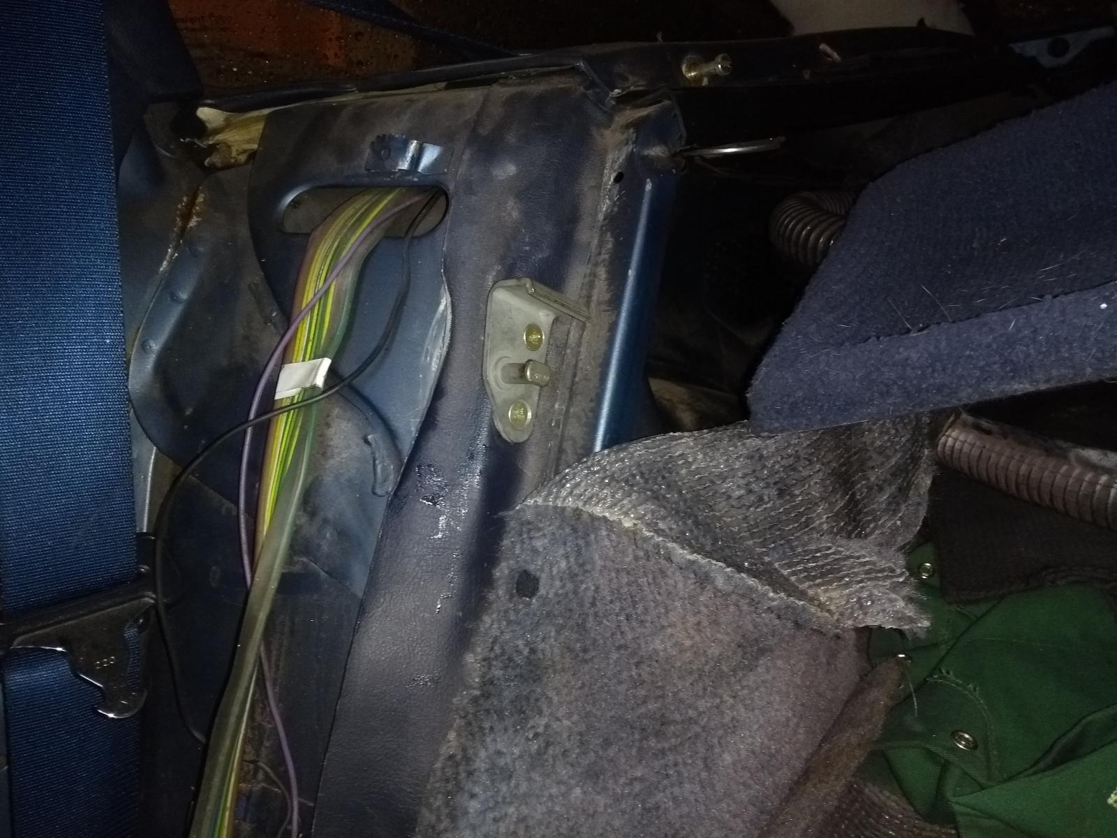

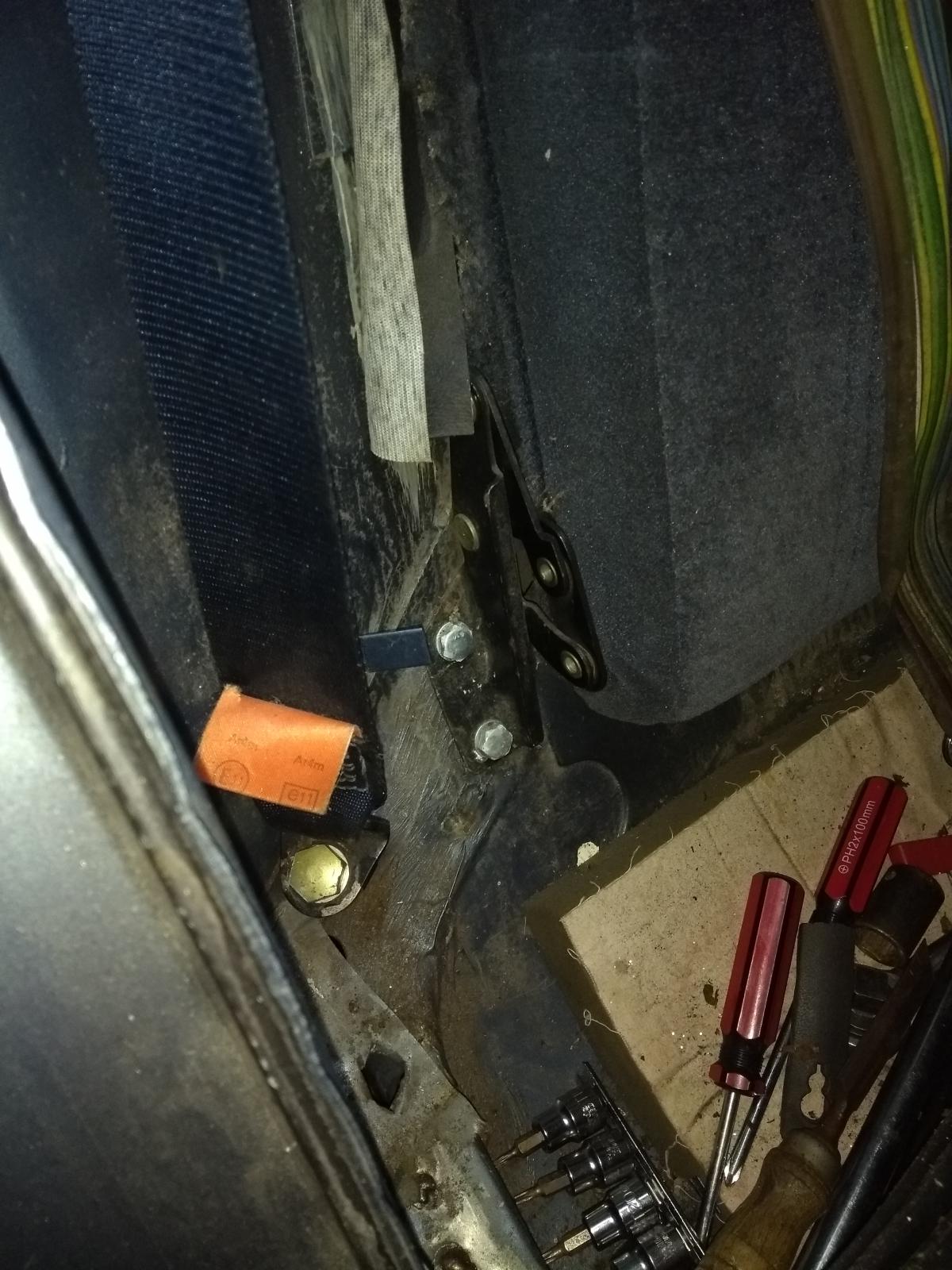

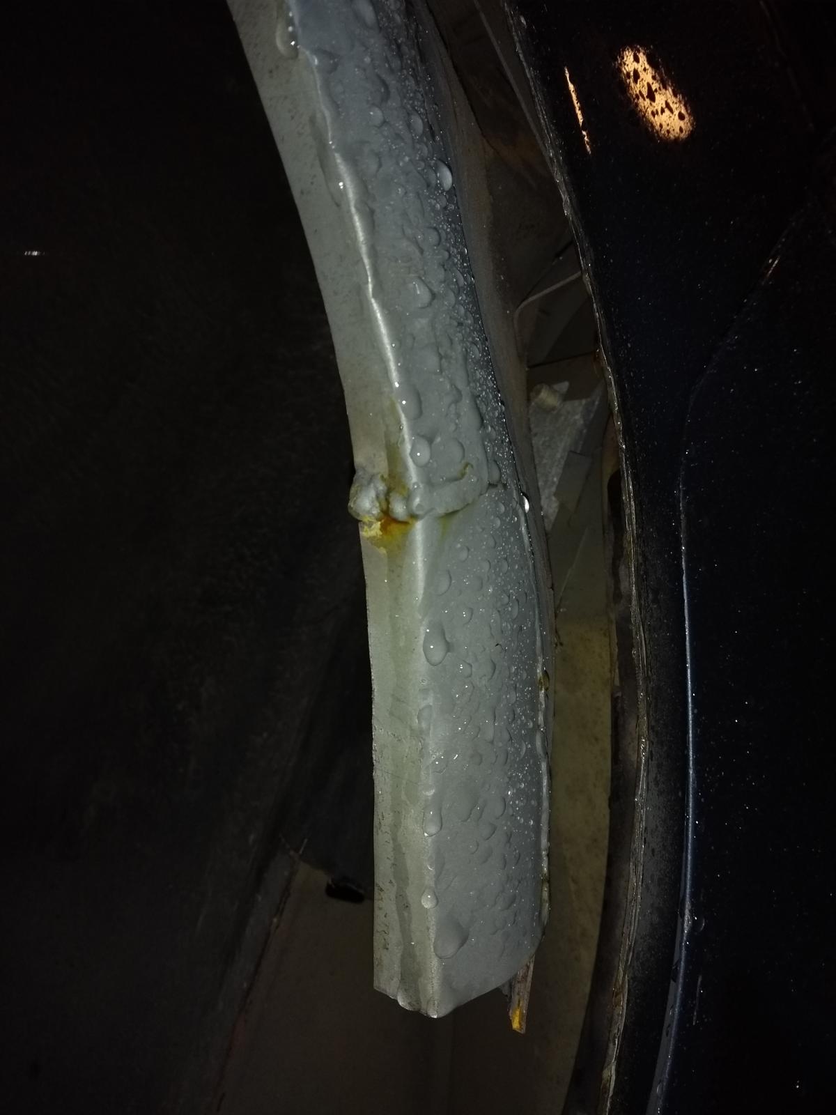

SamR380 Posted January 2, 2018 Posted January 2, 2018 Here are some pics of my S2, which all jokes aside does have a massive hole in the wheel arch so you can see where the bolts for the catch go. I've used the attach feature so I'm not sure what order they'll come out in. The catches at the top of the seat back are fixed with two countersunk machine screws but they're not really accessible until the seat back is down. The screws go through the panel and into a 5mm plate behind, you can kind of see it in the pics but tbh it's not much use to you either. I'd guess your best be is to take out the hinge bolts at the bottom and see what state that leaves you in. Skizzer 1
Skizzer Posted January 2, 2018 Author Posted January 2, 2018 That's massively helpful, thank you - it looks like the seat back should lift out if I get the angle right, now that it's not fixed at the bottom. Hopefully I'll get time to give this a go tomorrow, otherwise it'll be the weekend as I'm back at work on Thursday. richardthestag and SamR380 2
