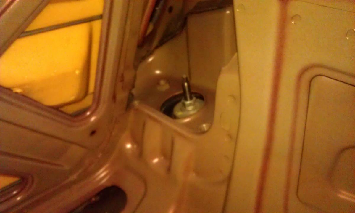

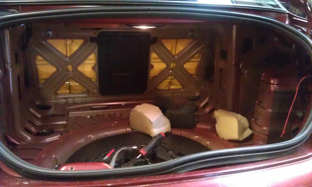

It's a true modern shite in the shape of an Alfa Romeo 159 with a broken rear spring. This particular model would seem to need the subframe dropping to get the springs out. Fucking beezer idea that.
Well that was fun, drop the rear subframe and completely gut the boot of trim, it'd better be a nice drive to be worth all this hassle!
Gut the boot:
To find these little feckers:
Once I'd got down to those, it was 4 wheel alignment time, and a subsequent road test, it's a pretty dull modern inside, the a/c controls are a pain in the arse and the seats are too hard for comfort, personally I'd have got a petrol version as the diesel is rather unrefined, the turbo comes in with a hefty kick rather than a gradual build up, very unfitting for the classy saloon it calls home.

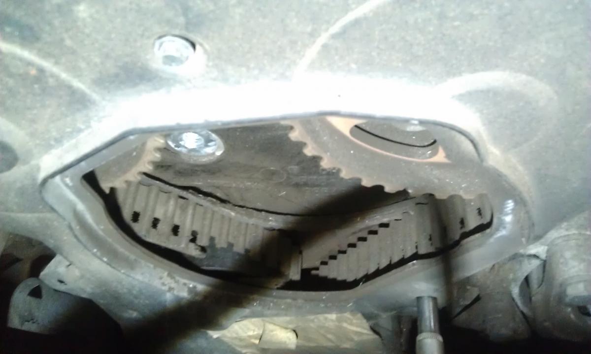

This little delight came in on the truck from another garage yesterday, turns over fine, has spark, has fuel.
Tested the crank sensor and the engine bay fuse box (known fault on these, particularly when the lid is missing and has a broken lunchbox taped over it)
Still no go, no faults in the memory.
We try a bit of easy start up it, but it only gets blown back out of the inlet, so it would seem to be a timing issue...
This belongs to one of those customers for whom blame is like water to a duck's back. "A previous garage lost the fusebox lid" and "the recovery company broke that bit"
I had to bite my tongue, as this sort of thing makes me rather cross.
The plan is to chuck another belt on it and see what happens...
The Inlet is 3 teeth retarded, and the exhaust 8 teeth advanced, needless to say, I am not holding my breath!

Bit surprised to see the boot of that Alfa just painted in primer. My Panda is like that but probably cost at least £10k less to buy new.
A lot of them like that now.
My brothers brand new focus had door shuts that looked like that had been rattle canned - they all seem to have defects like this.
I have pulled welding wire off door hinges before now.
I have a Z3, lady friend a 530D BMW, both grey primer underbonnet as well as inside boot. Surprised when 1st saw it but neither rusting, at least not in said bits.
Just a sign of the times and obsolecense built in to modern s***
My 1series was also like that when I bought it new in 2010. So I dropped all the underside trays and finshed the job tht BMW couldn't. I 2 packed the underside and wheel arches and then waxoyled the whole lot before putting it all back.
Also did the same to the Punto when that was new.This included greasing the brake ipes and all bolt threads and nuts.
