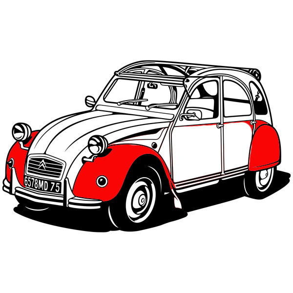

perhaps you might at least have the red to rounding up the rear door's bottom corner. ? sorta like the darker blue Dolly pictured above. That way your car will look a little different in the row of  Red & White's - without loosing Elly's long loved identity.?
..And as for all the colour / graphics suggestions recently received .. Thanks., As a second car I'd really like to acquire or build a Super-Dy2  (an Ami Super-Dyane-2cv, aka 'sidewinder') ...so some of those idea will be useful to me when trying to choose a scheme or its graphics.
Thanks guys  B)

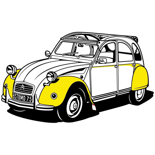

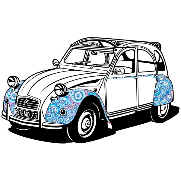

Messed about with a bit of line work found on an internet hunt.
Thought I read somewhere here abouts ..
" ...its a bloody motor car, not a Fabergé egg. !   "    :lol: :lol:  :lol:
..now where did I see that ?
..otherwise though.. nice graphics  ;)
That bottom one is very close to where my thoughts are heading. A red and white Dolly, but different.

a red paisley dolly?

That girl is remarkable. Just wish I had more time available, as I've hardly been able to do anything to the car since it came back. However, Mrs DW saw Vulg's selection above, and is especially taken (as I am) by the bottom one. Just need a practical way to make a scheme like that a possibility.
Easiest way to do a red Paisley finish is going to be a vinyl wrap. There's companies that do custom prints so you'd just need to find a design you liked, provide it to them and they'll do the rest.  If you're feeling particularly patient you can lay out the design by hand and paint it by hand which would be considerably cheaper and more authentic, you can get reusable stencil templates that would allow you to apply the elements of the pattern slightly easier if you wanted something more regular, it's just massively time consuming to do.  Glad to be of service :D
How about a densely packed mosaic of red Citroen chevrons or 2CV silhouettes? Just an idea that popped into my head, might look rubbish in render/reality.
