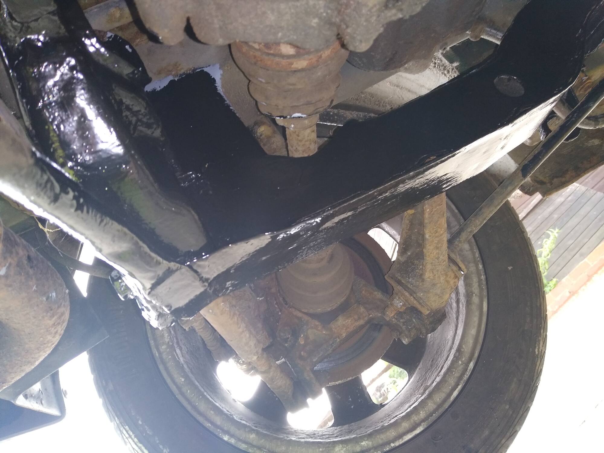

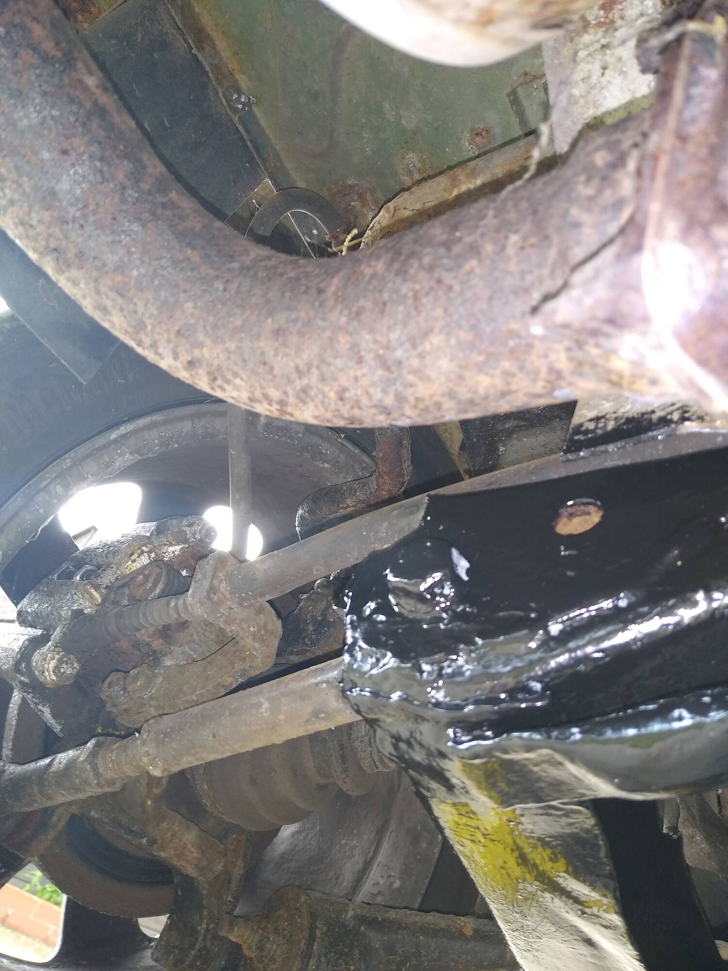

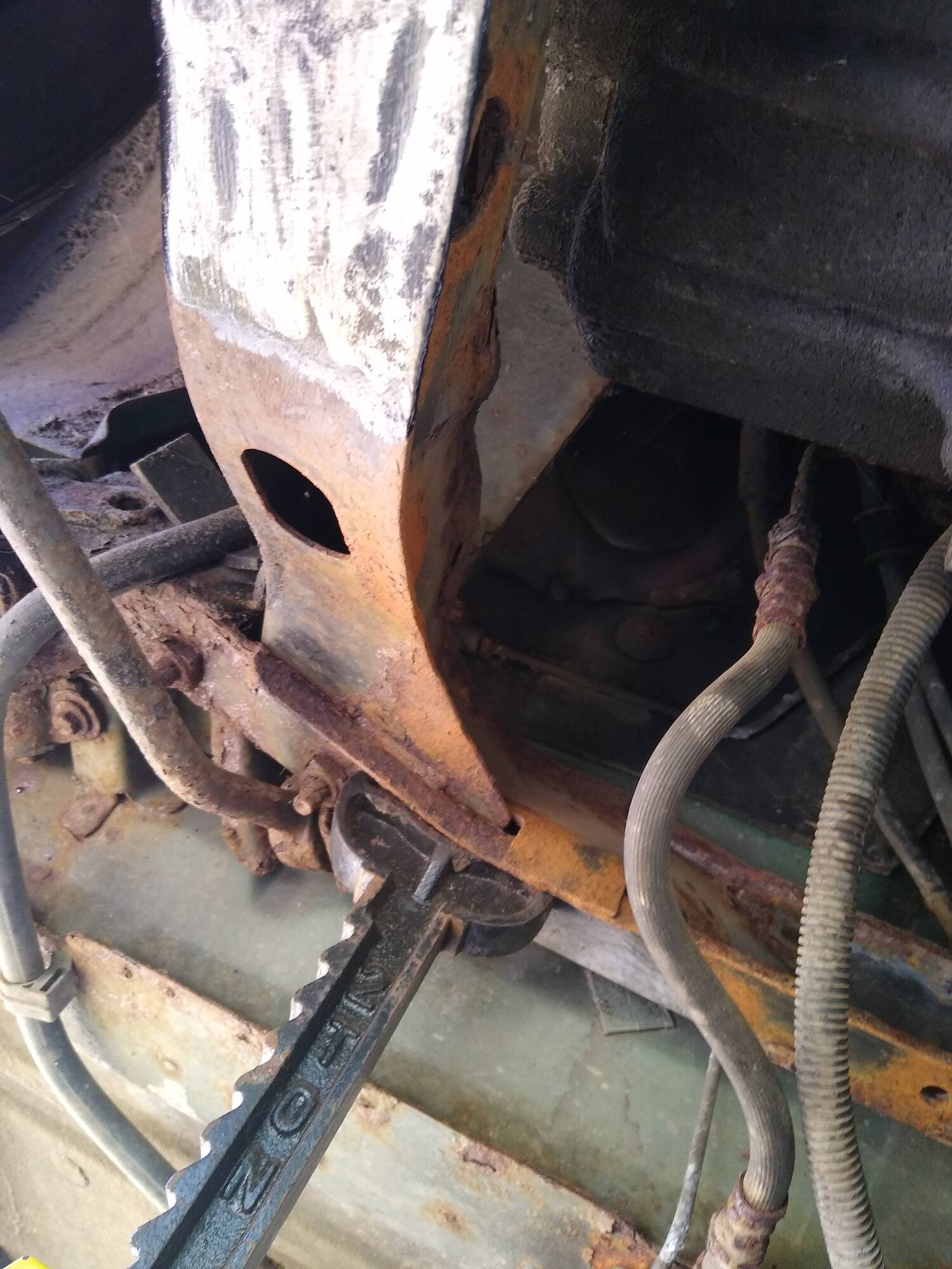

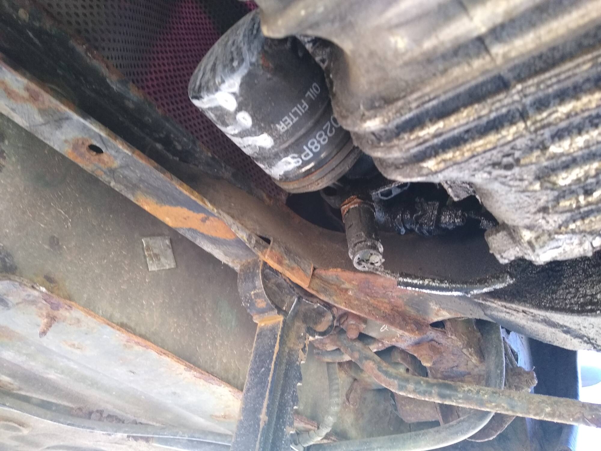

MGF will hopefully be in for an MOT next week, seems to run well but I need to give the rest subframe and various other bits a clean up and rust protect.
Started with the angle grinder and flap wheel, Vactan put on. Zinc primer and black chassis paint to follow.
Two coats of Vatcan and then Zinc 182.
Having to hide under the car as the hale started half way through.
Sorry Isopon, this isn't professional use
Hope to get another coat on tonight and then some black chassis paint tomorrow. MoT booked for Tuesday at 12.45.

Have to agree the underseal if pretty good, from the exposed fittings and swirl pot cover it looks like the car spend some time near the sea, or possibly in it, but the underseal has kept the actual bodyshell protected. But it reaching the age where it is drying out and cracking on the edges. Post not it will need a bit of TLC.
Couple of coats of chassis paint.
Front of the car is now up in the air for that to be done as well.

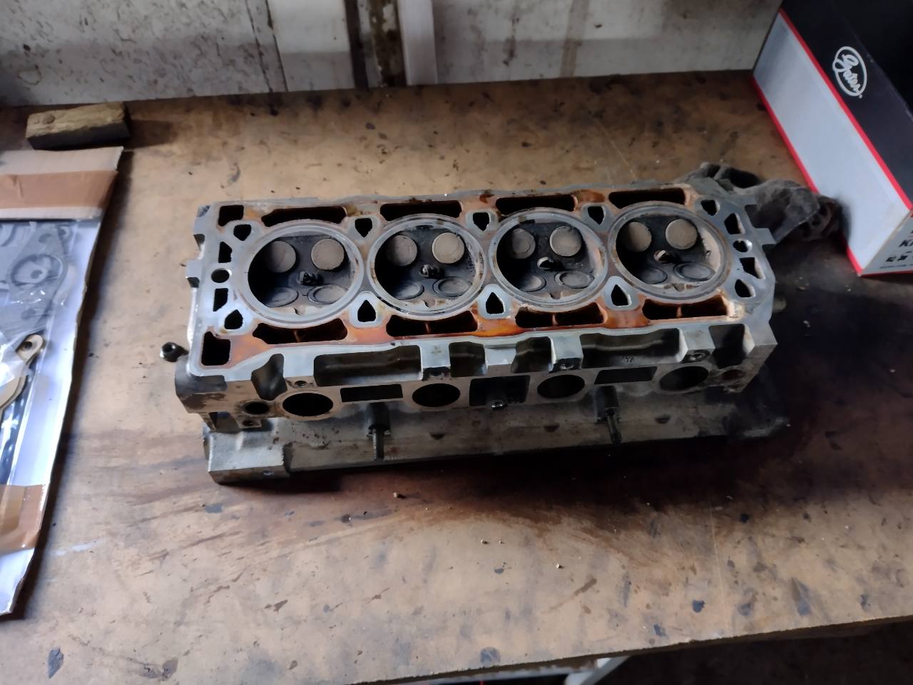

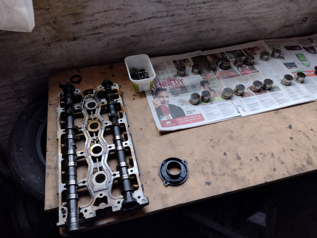

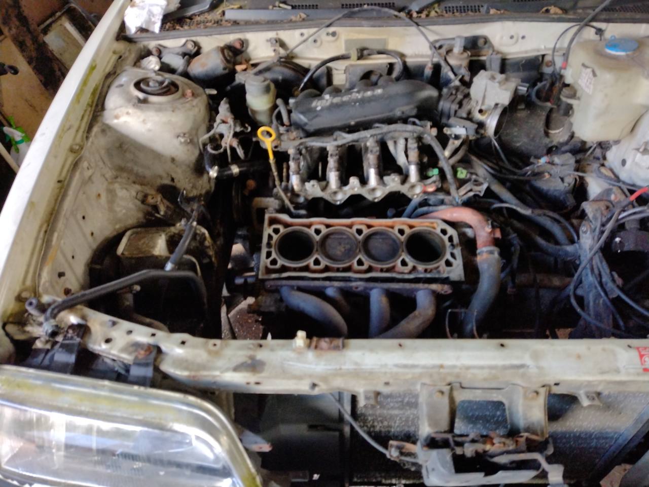

Now the Rover 414 is seeing the mechanic. The timing belt hadn't snapped but the inlet cam pulley had worked loose!
All striped now, some damage showing to the head gasket so the head will be skimmed before it goes back together.
A K series with the head off?

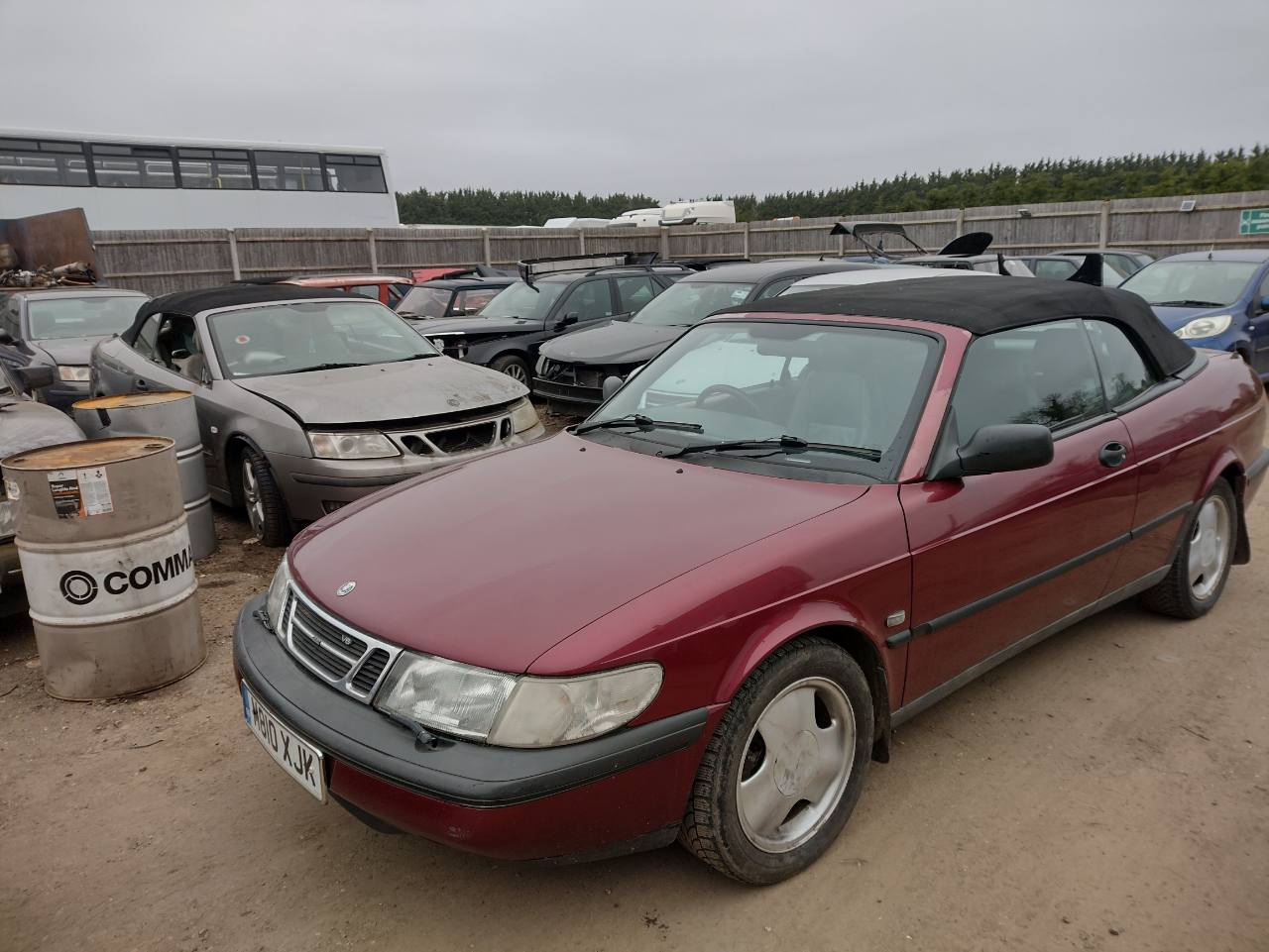

IMG_20210401_085908912_HDR.thumb.jpg.3b8027e1b4f9be8167e453561398eb5a.jpgAs the Saab's roof continued to refuse to work I've decided to sell it to a breaker.
As I am short of working vehicles I bought from them a diesel a working diesel 9-5.

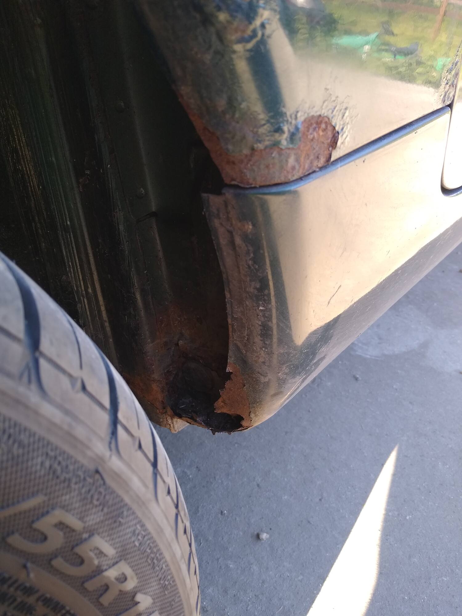

I saw an ad for a tidy looking 2007 MX5 on muppetface recently.  I won't sell the MR2 because it's a brilliant car, but I read the blurb anyway. I stopped at the part where it mentioned 'all the welding has been done '. Didn't Mazda learn after the grim rot issues with the Mk2?! Yes, they have other issues, but at least your average MGF and MR2 of a similar vintage won't need tickling with a MIG once a year.
27 minutes ago, Dick Longbridge said:
 Yes, they have other issues, but at least your average MGF [] of a similar vintage won't need tickling with a MIG once a year.
Ummm 🤔
Not in my experience.

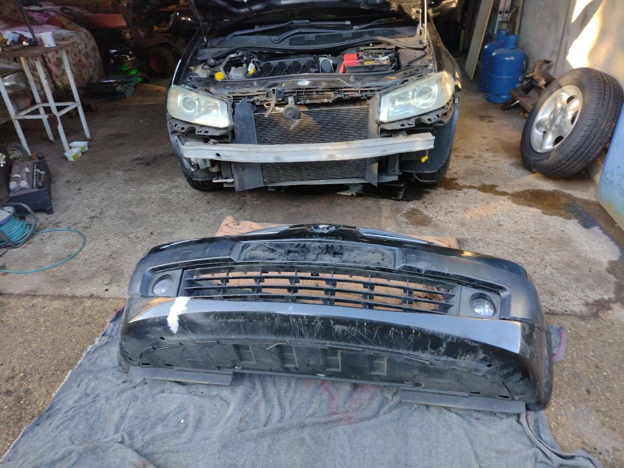

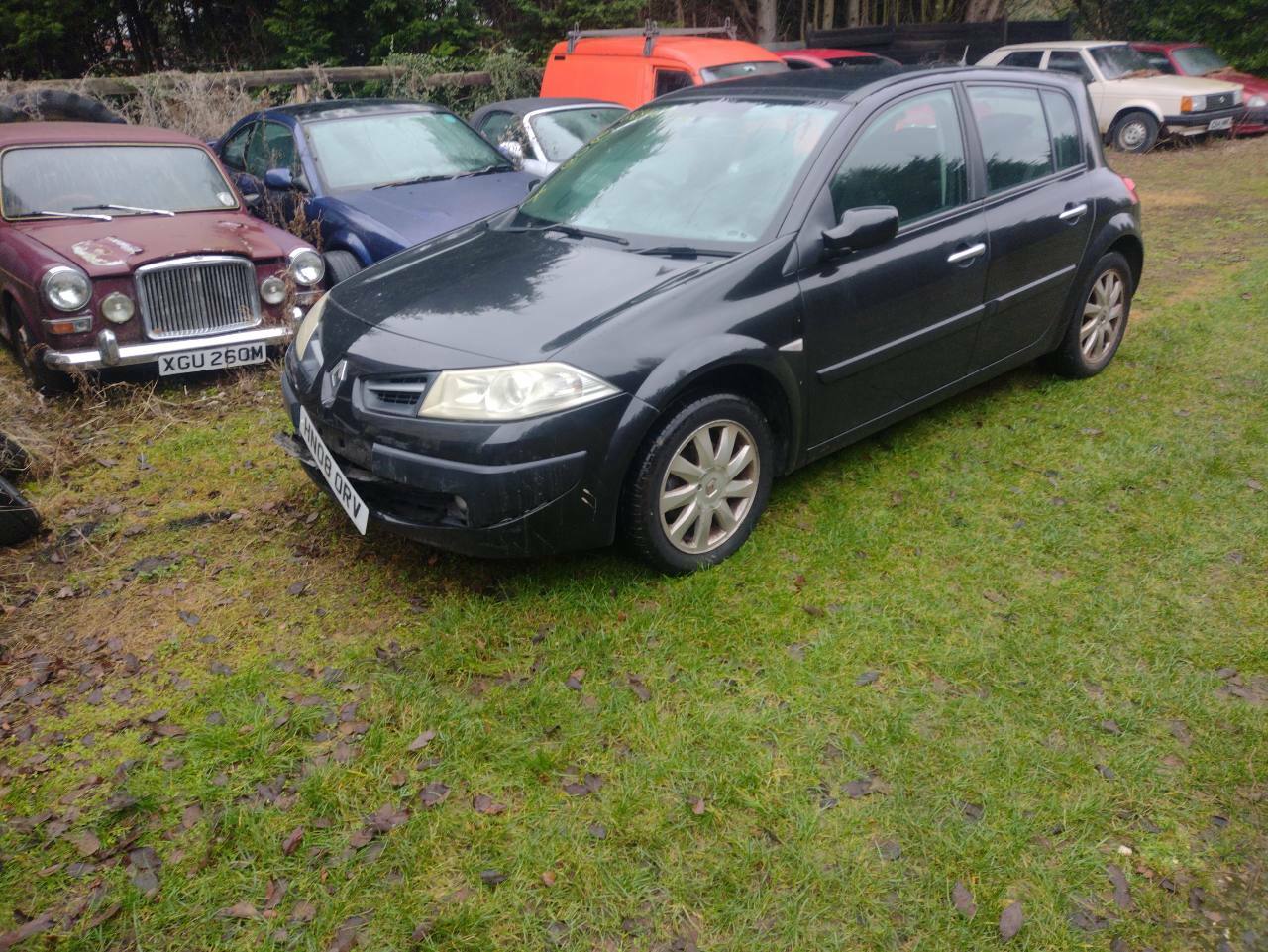

Replacement comes in the shape of a big arsed Megane which was bought from Copart.IMG_20220110_121221250.thumb.jpg.75db0e9f7162fd5616723419dc6c7b69.jpg
It is cat N for the front bumper damage that was easily fixed, BeEP's plastic welding gun doing a great job putting it together.

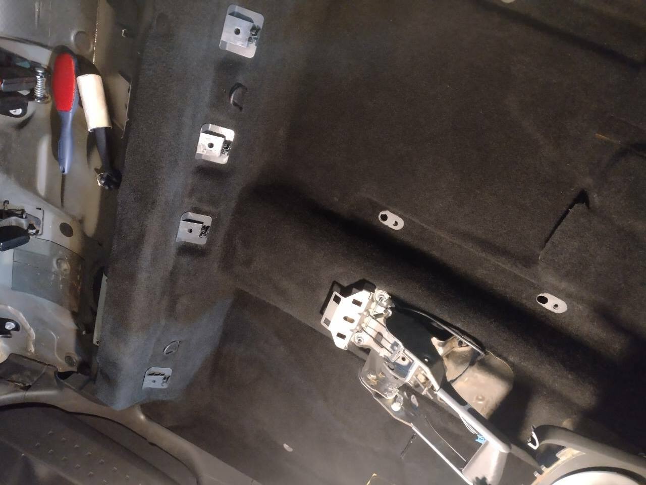

More of a problem was the interior.
IMG_20220112_093737540.thumb.jpg.bc6e6569084ff968cd21993c0f276f6b.jpgIMG_20220112_094547954.thumb.jpg.74a76979f9dd04944b127d3a61457c41.jpgIMG_20220112_094551980_HDR.thumb.jpg.261a65884cf15235d5590c45baacac5f.jpg
The poor dog (it maybe dogs) the previous owner had must have been ball by then end.
Hours with the vacuum, wet vac, brushes, drill brushes and degreaser have it looking much better (but far from perfect). The whiff of dog is there when you first get it but hopefully with use and air fresheners it will go.
