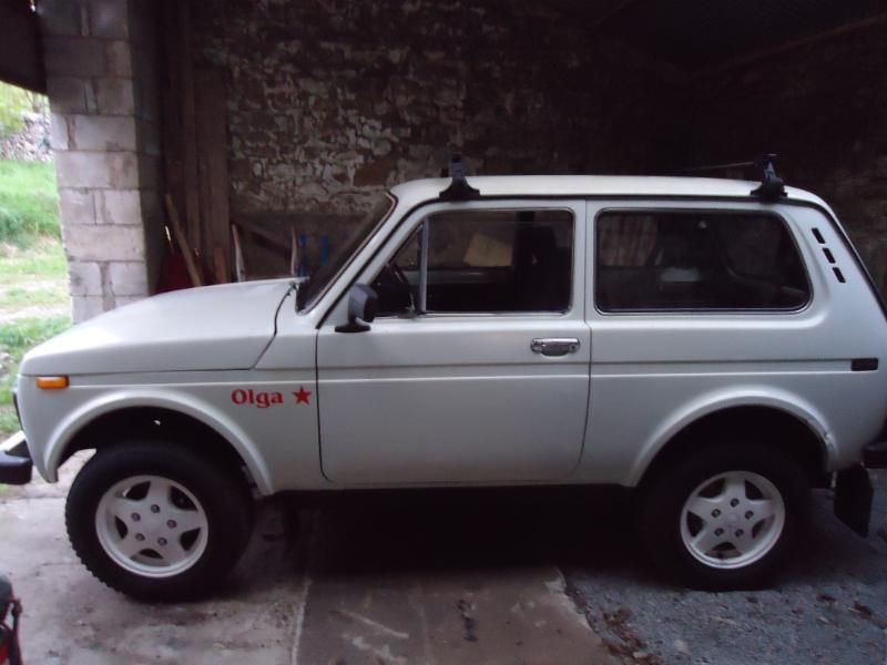

Here we have'OLGA' my Lada Niva Hussar 4x4 1.7i.
She has only done 8273 miles from new and even though the pictures dont show it the bodywork is in good condition.
She has been standing for 5 years as the head gasket blew.

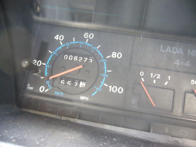

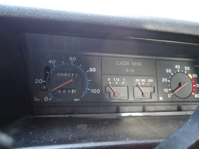

Yes that clock does say 8200 miles.
And yes, you will see that the pictures of it confirm that the clock hasn't been fiddled with.

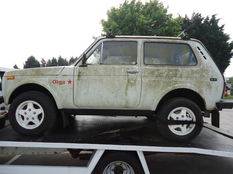

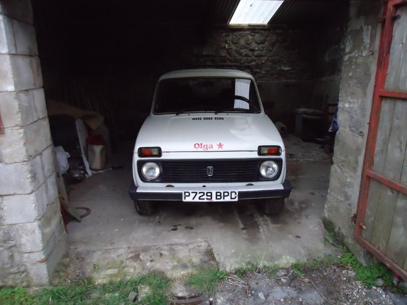

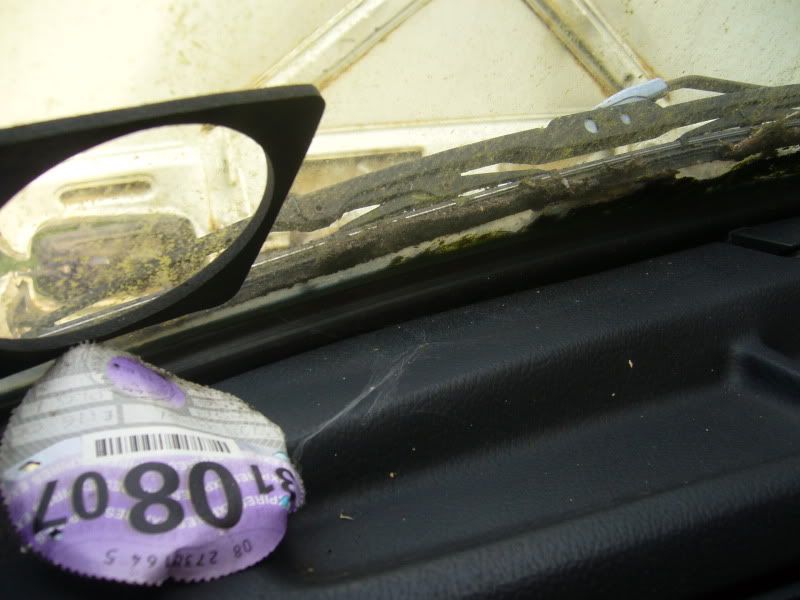

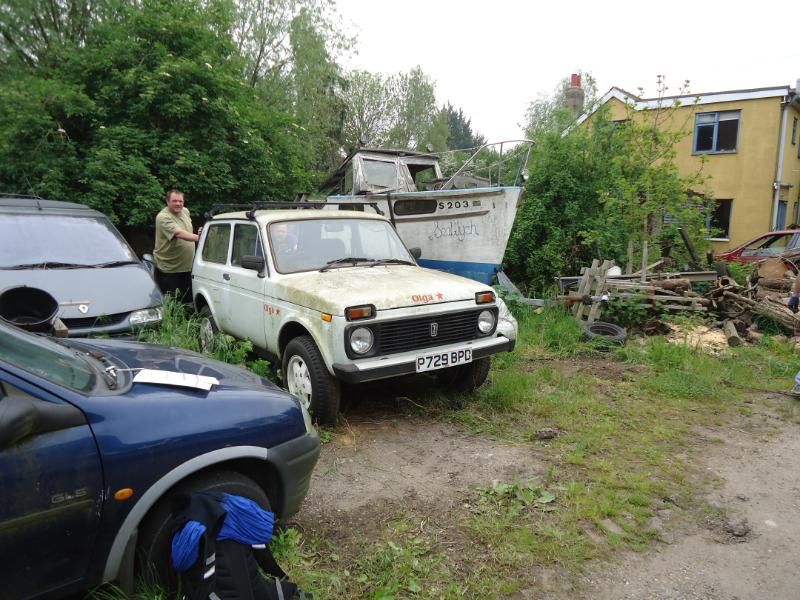

She had been hiding in that bush for the last 5 years. That flimsy wad of paperwork on the Corsa bonnet is all I got by way of fire-starting material, but the service record shows it only did 4400 miles in the first 10 years.

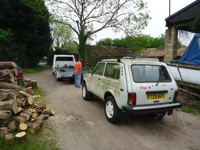

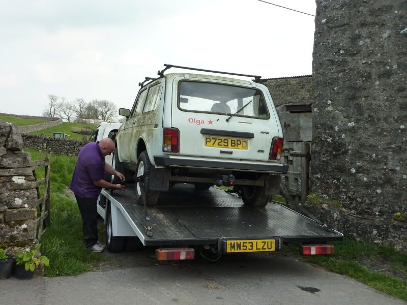

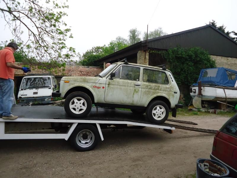

Met a couple guys on http://www.shiply.com that could bring her from Cambridge to North Yorkshire for £80, reasonable price. She was an obvious non starter but rolled fairly well.
Wanted to get a few pictures of the various boats grounded in this old farmyard, without being intrusive. The eagle-eyed of you will have noticed the flying canal boat on the eBay page above :?
On she goes.

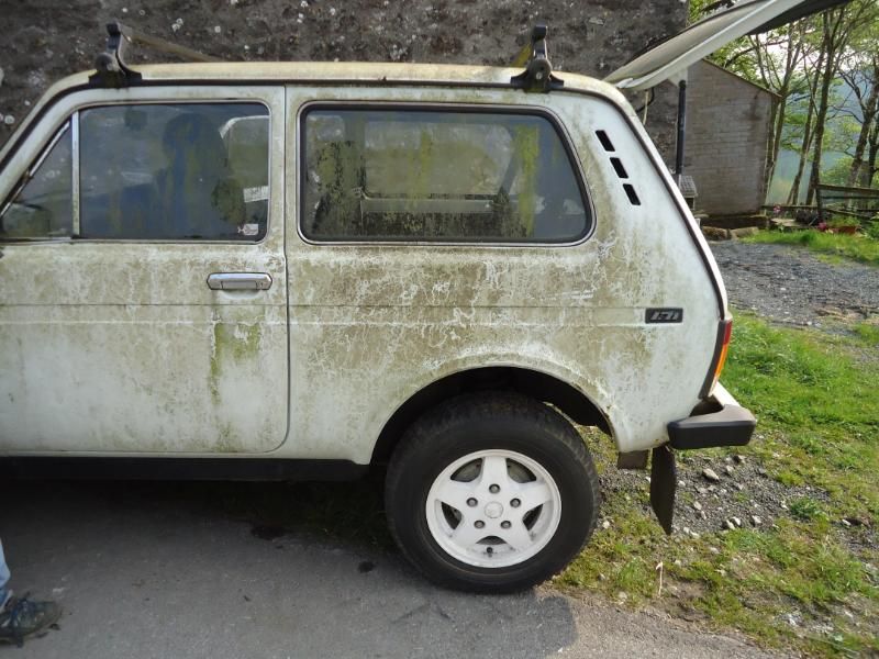

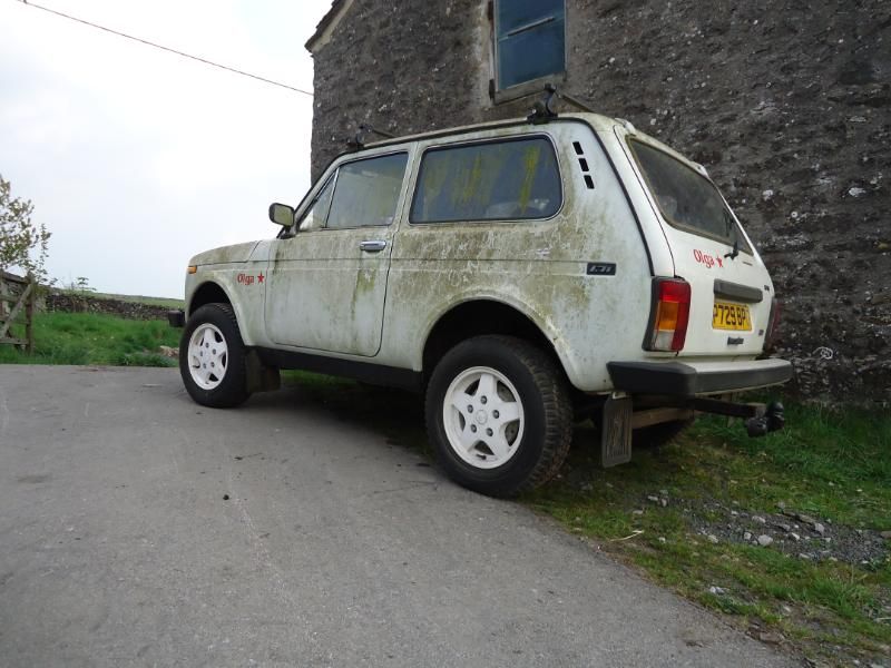

Bit mouldy, but nothing a dab of bleach and T-cut won't sort out.
Before you ask, this was nothing to do with me. Cute name though, and it seems to have stuck. She's now locally known as 'OLGA' and I don't seem to have much choice in the matter.

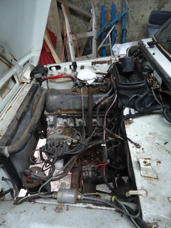

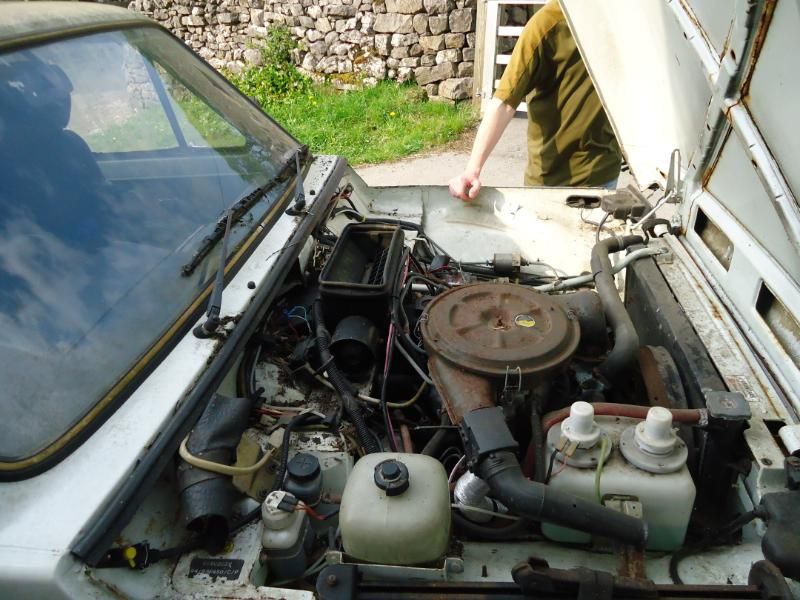

4 hours later, once home, the first job was to open her up and see whats inside.
Not looking an impossible fix. My brother Joe seems a bit more apprehensive:

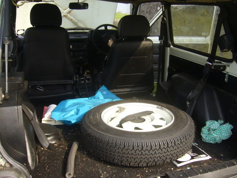

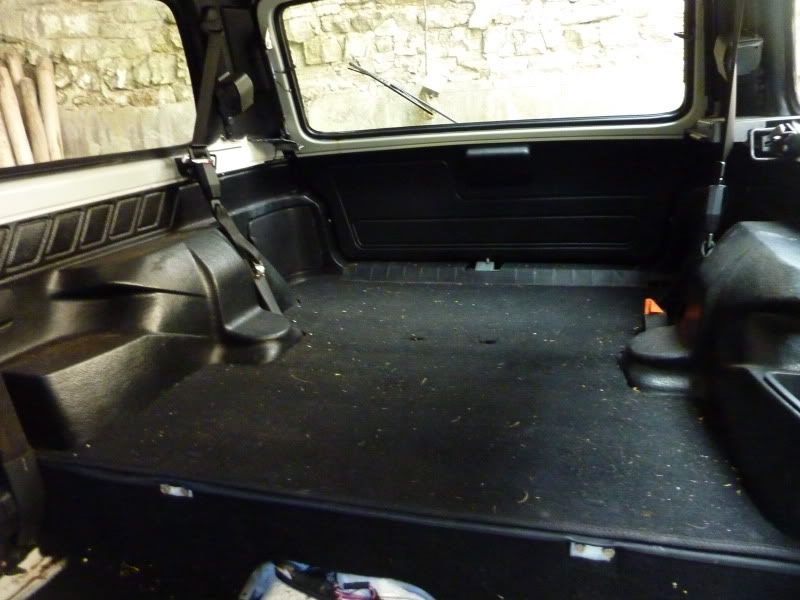

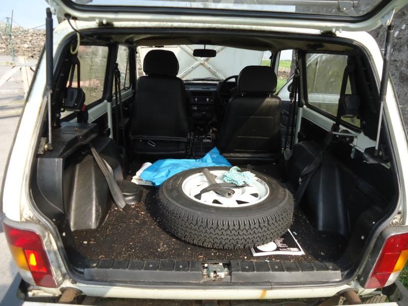

Hmmmmm. Missing rear seats. A homemade marine ply load liner could be mighty practical though.

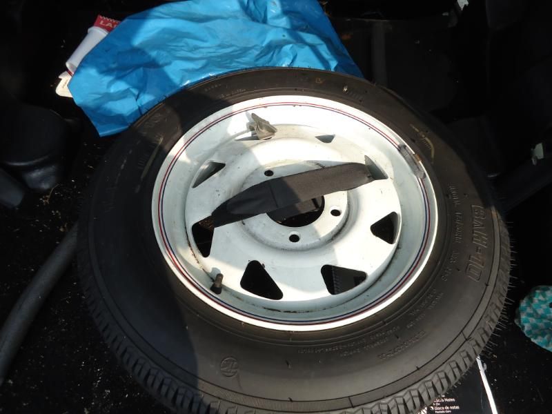

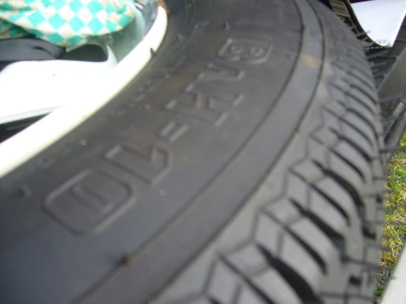

EH?? What's this I spot? :P Original unused spare tyre?? OMGs.

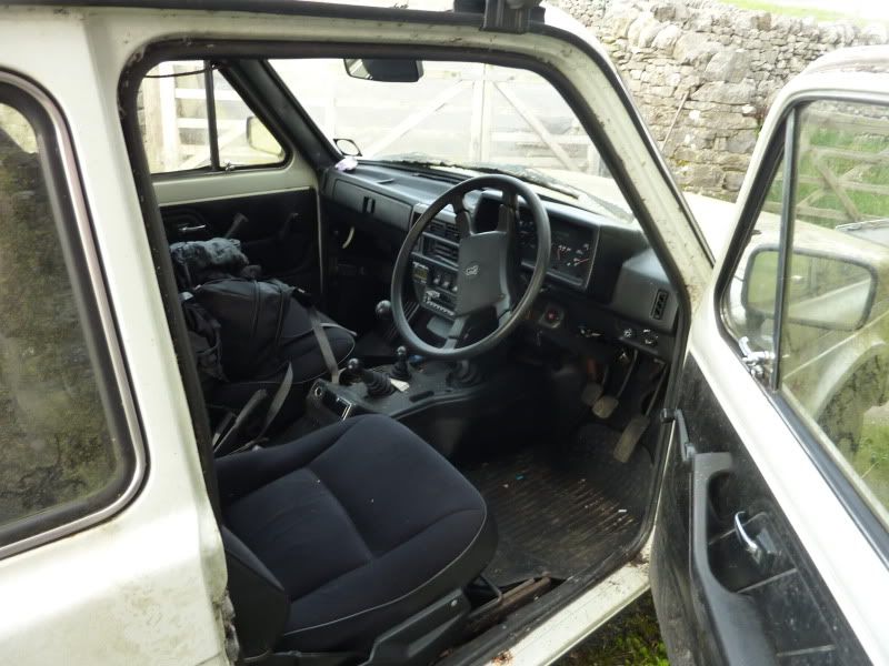

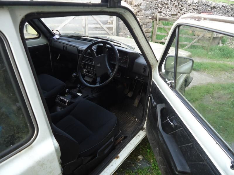

Good, tidy interior too.

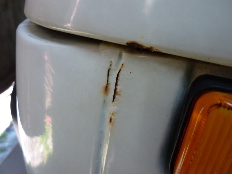

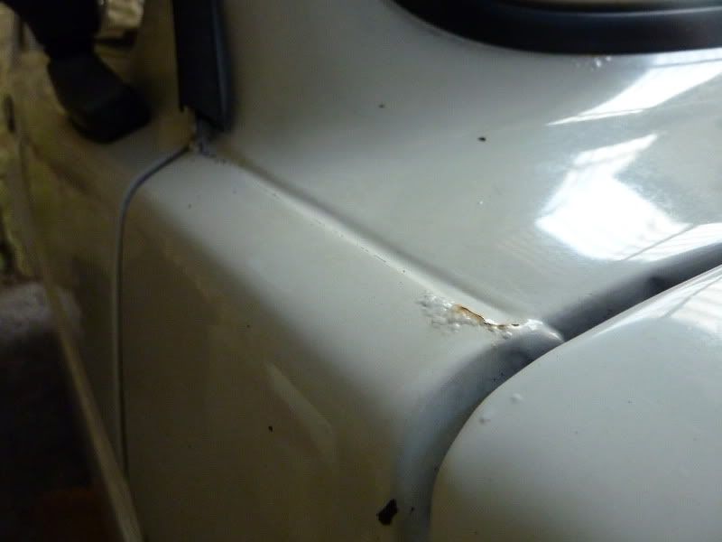

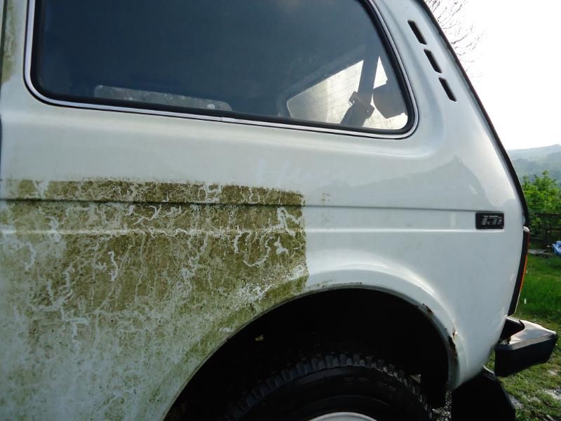

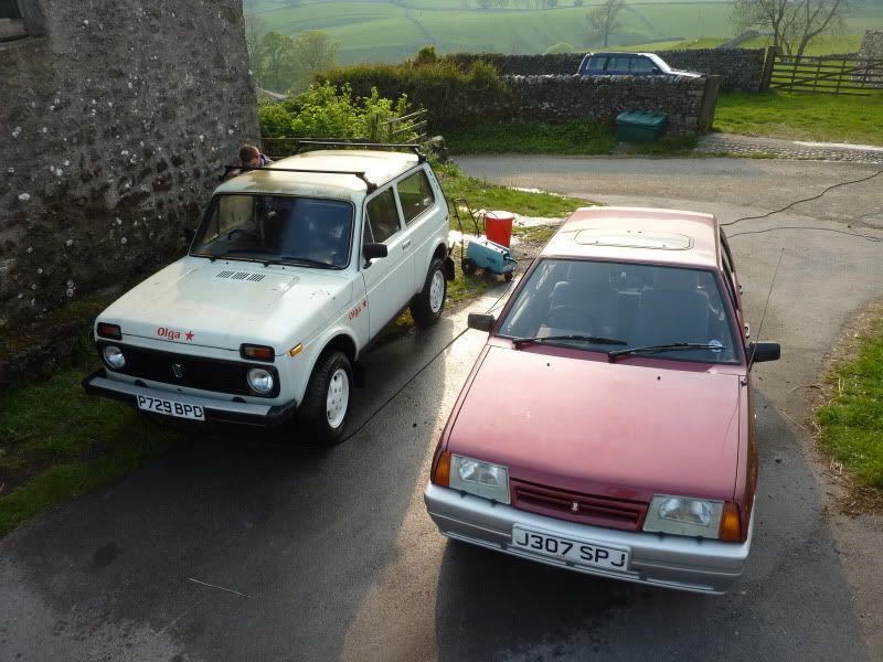

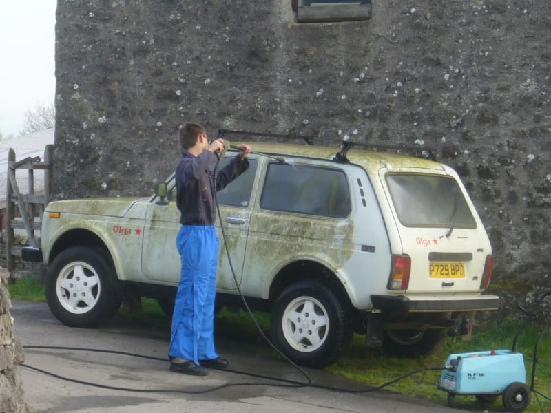

What a difference a good pressure washer makes! Dent on the rear N/S arch, and a very slight bump on the other side.

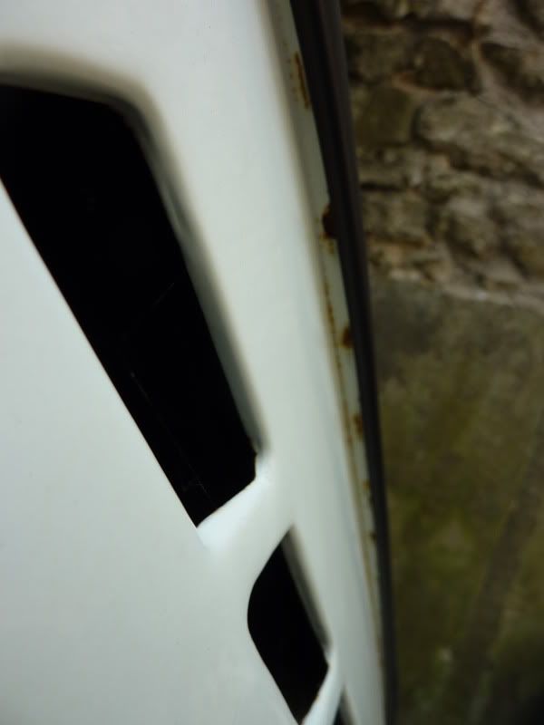

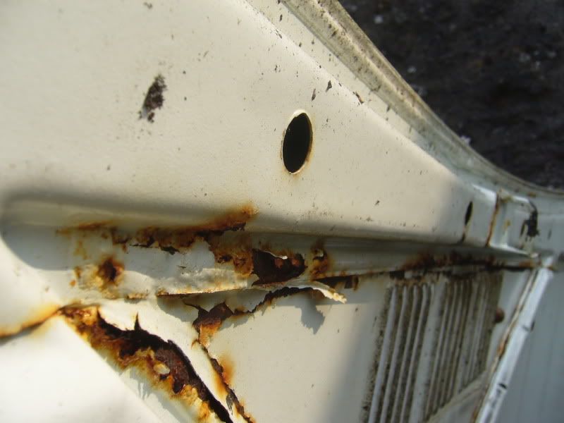

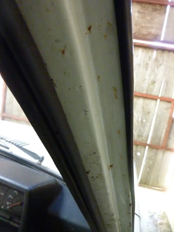

After cleaning I found dozens of places where the rust was just starting to ingress under the paint, round seams etc, but nothing you could call really crunchy. Another 2 years living in that bush and she would have been a pile of rusty panels.

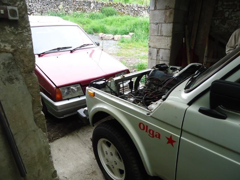

After a bit of swift re-arranging and some chugging about on the tractor me and Joe managed to find some room for her.

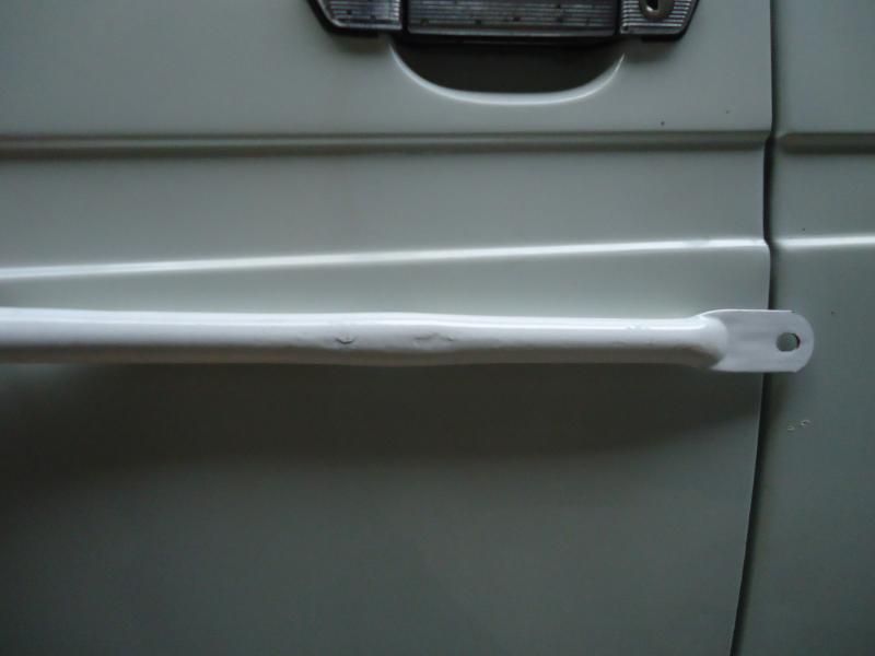

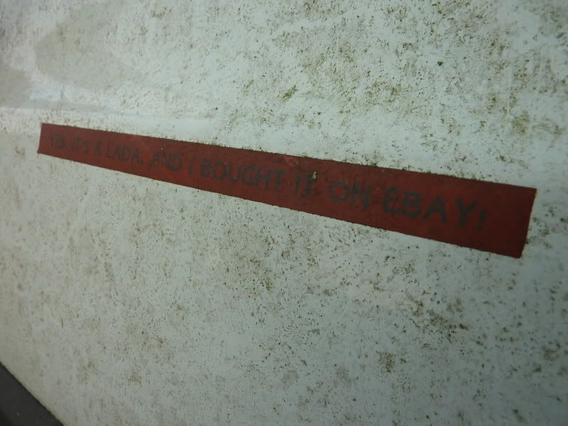

Check this out! The last owner bought it with this on, And its only had 3 owners before me!
Yes, It's a Lada, And I bought it on eBay!

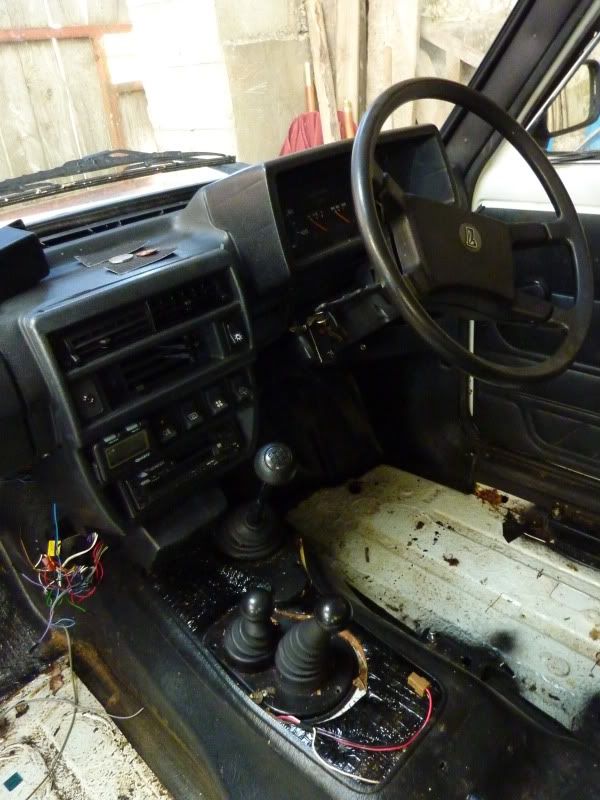

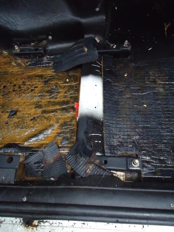

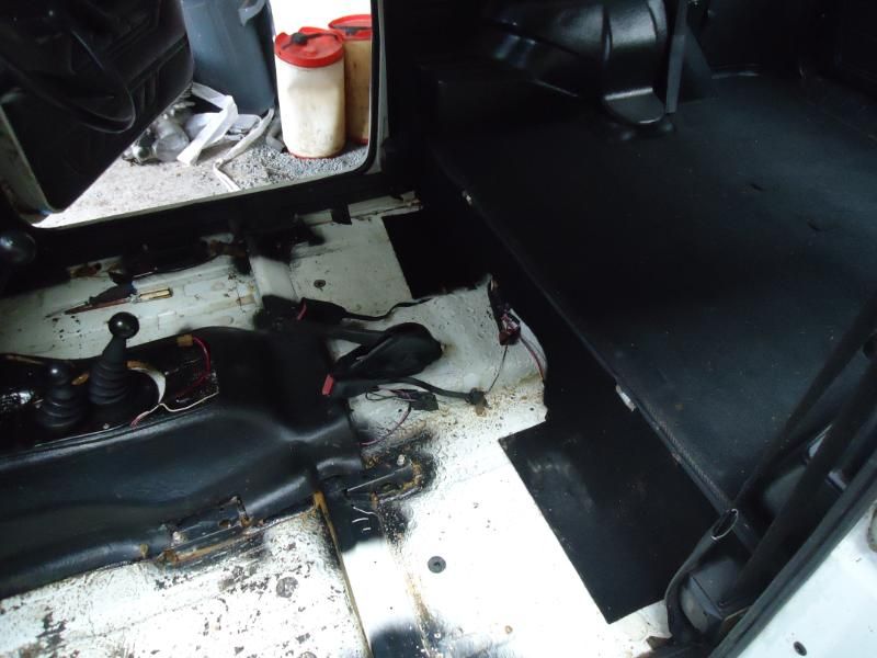

Second job: Stop the rust! I stripped out the interior to dry out the inevitably wet underlay. It was surprisingly clean and tidy, and the only sign of a little damp was in the N/S front footwell, probably because, to quote KruJoe
panel gaps big enough to fit an arm through
^Check out the random offcuts of rubber used under the seat runners to do some nondescript but most likely important job.
Bit of a wipe and that mucky patch went down the drain.
Henry Hoover did it's job well.
A week has passed and I am back to start tinkering on her. Because I work in a pub 5 days and 50+ hours a week, I can only spend my 2 days off over the hill at my parent's house in Malhamdale working on the car, and posting on Autoshite, so bear with me if this thread seems slow.
Plan for the day:
Get electric into it,
Check to see if it will turn over,

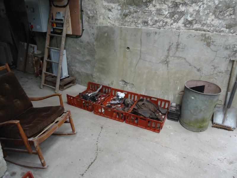

Remove various ancillaries,
Remove metal parts that I could clean and re-paint in my split shifts at work ,
Check for parts that need replacing.

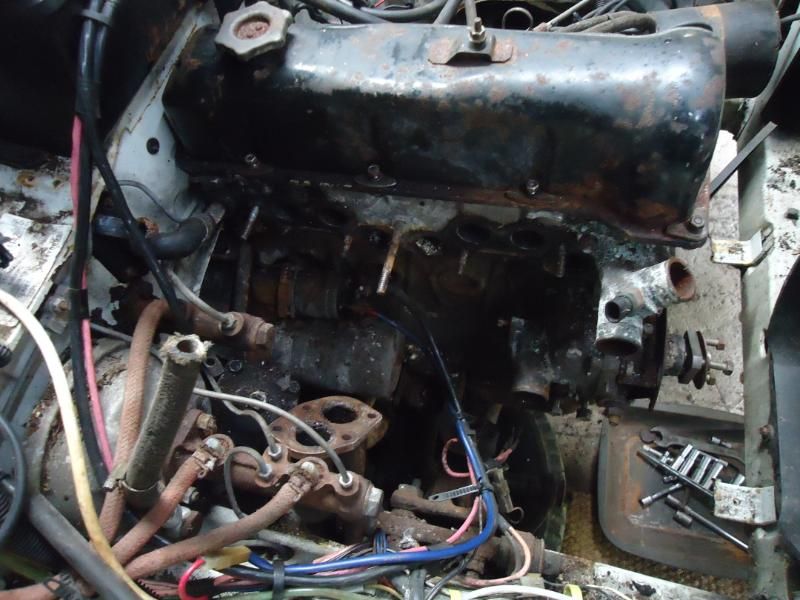

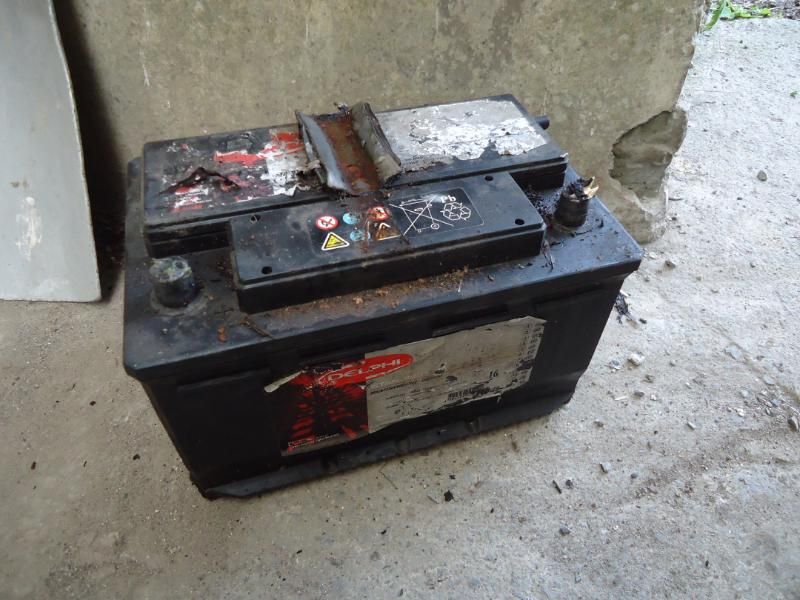

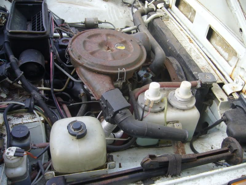

Battery off

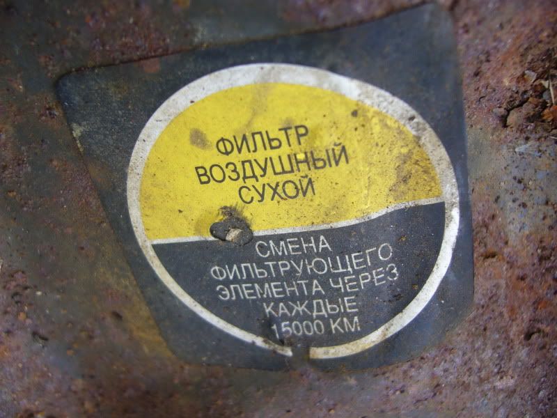

Looks like the original Russian one!

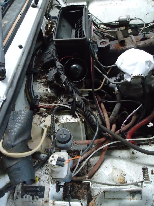

Battery tray, cross-member, air filter off
Sump guards to paint and engine tray to repair and paint.

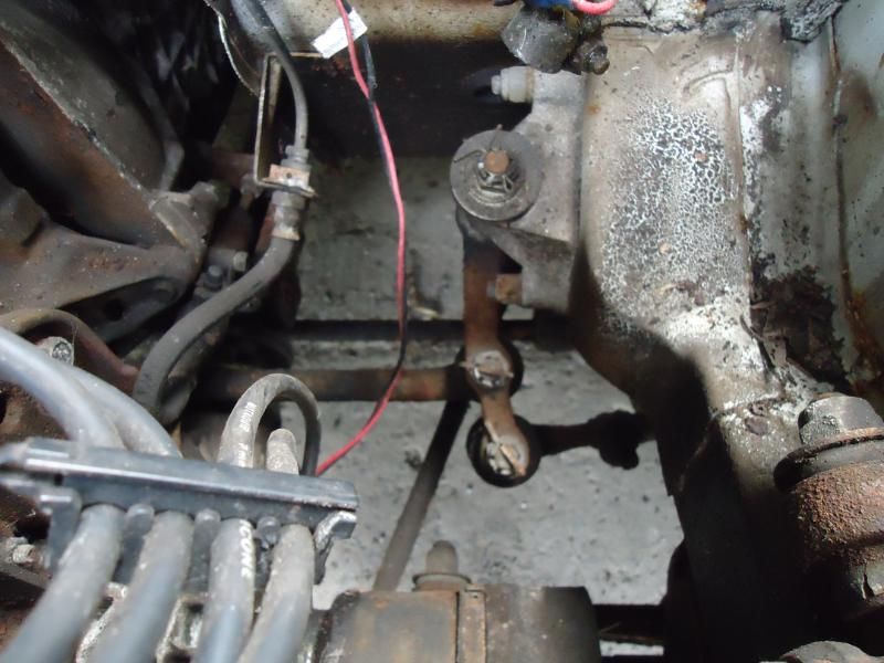

Can't remember Joe's exact words, something about redneck steering arrangements. Here's why:

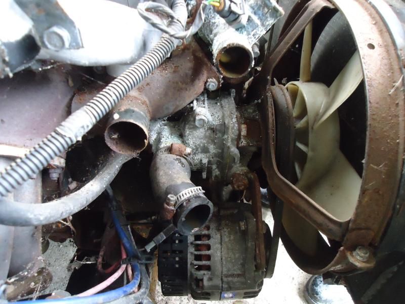

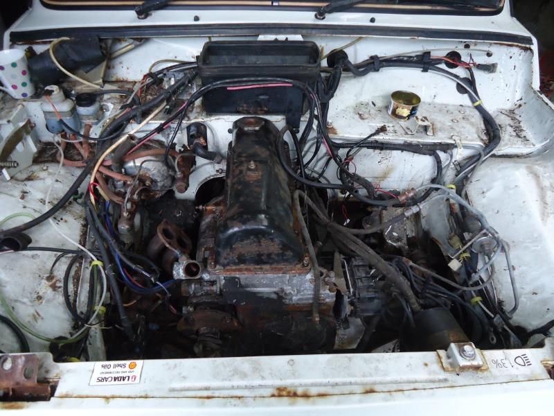

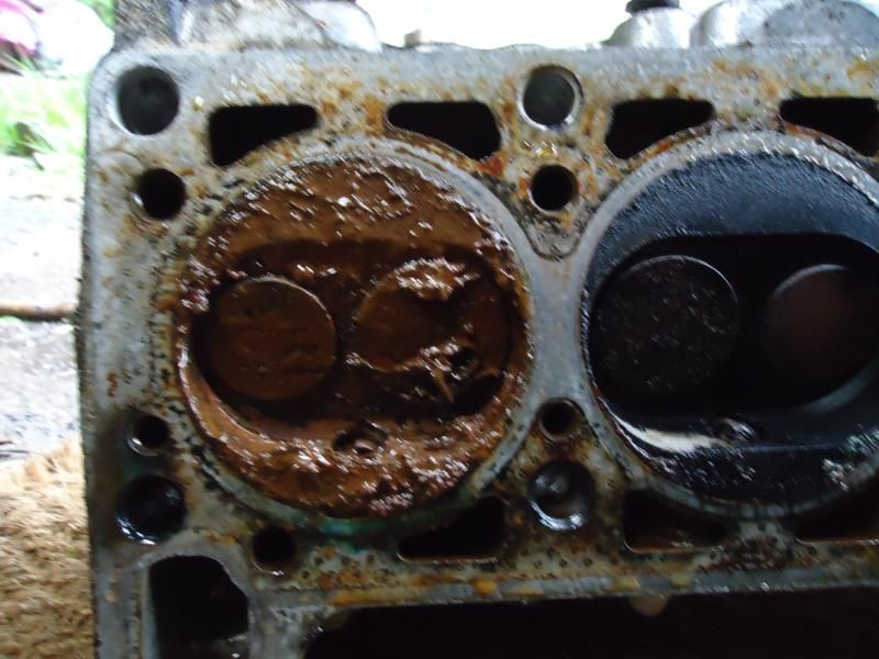

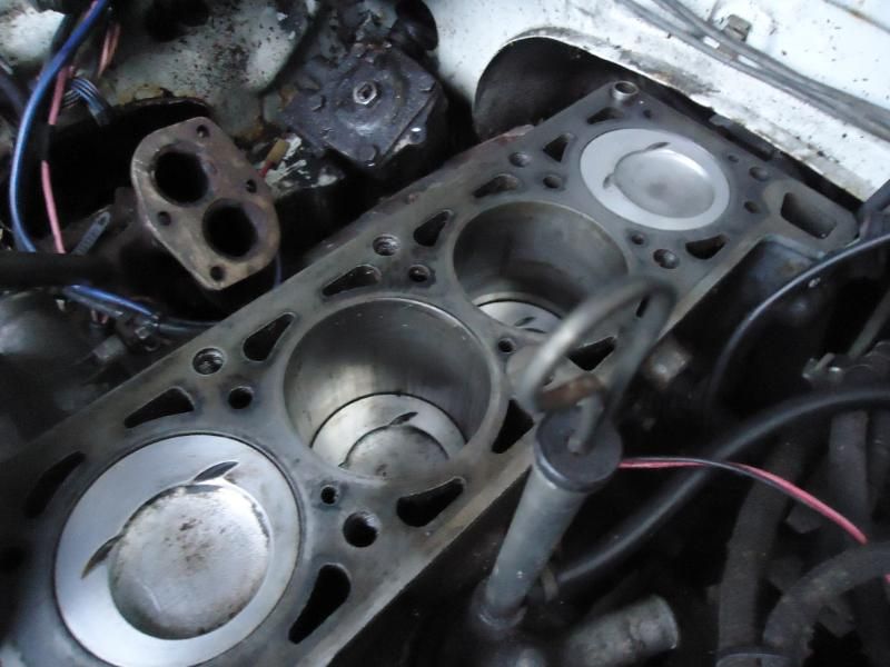

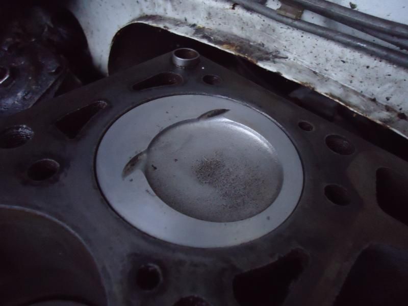

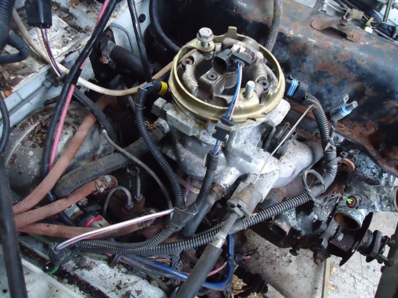

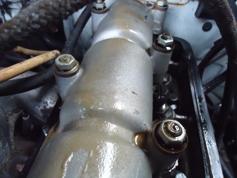

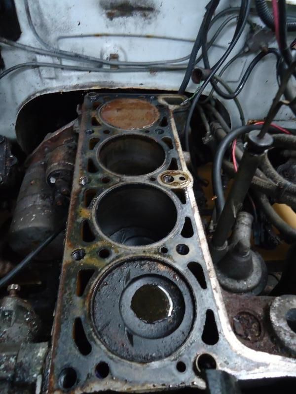

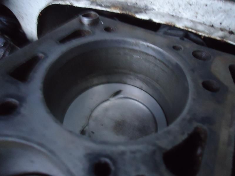

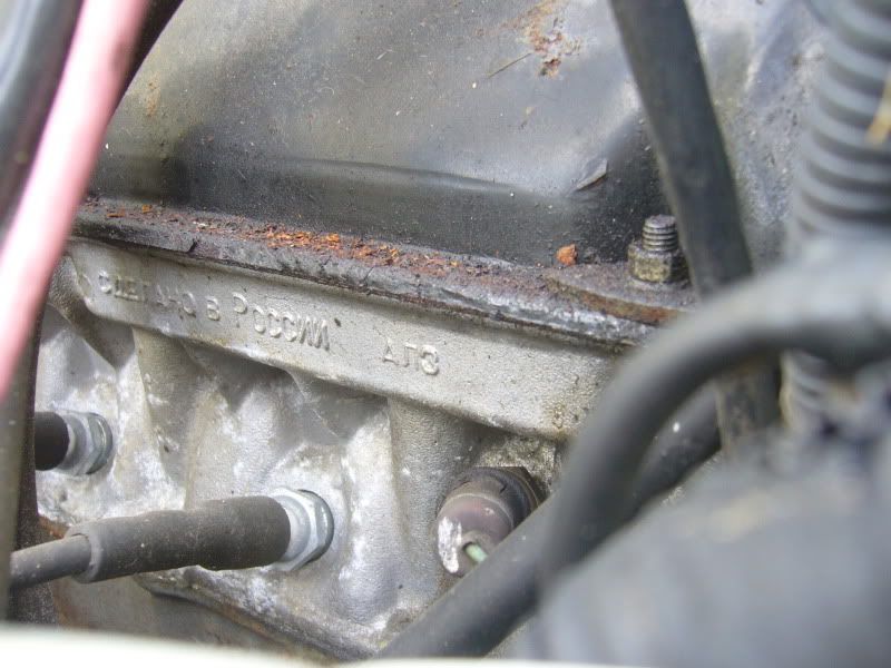

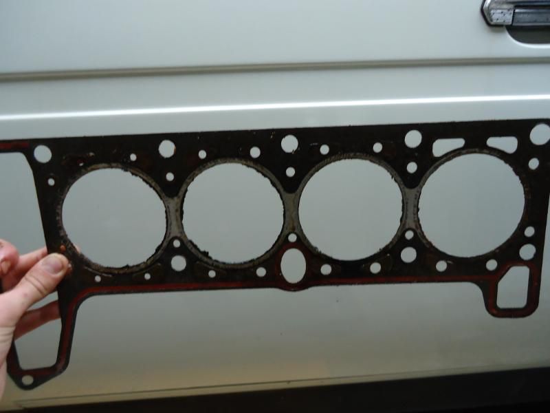

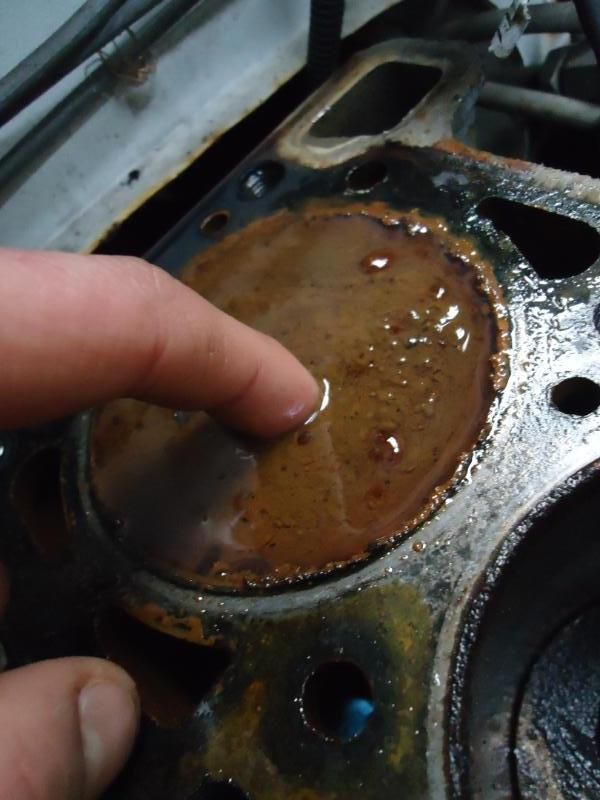

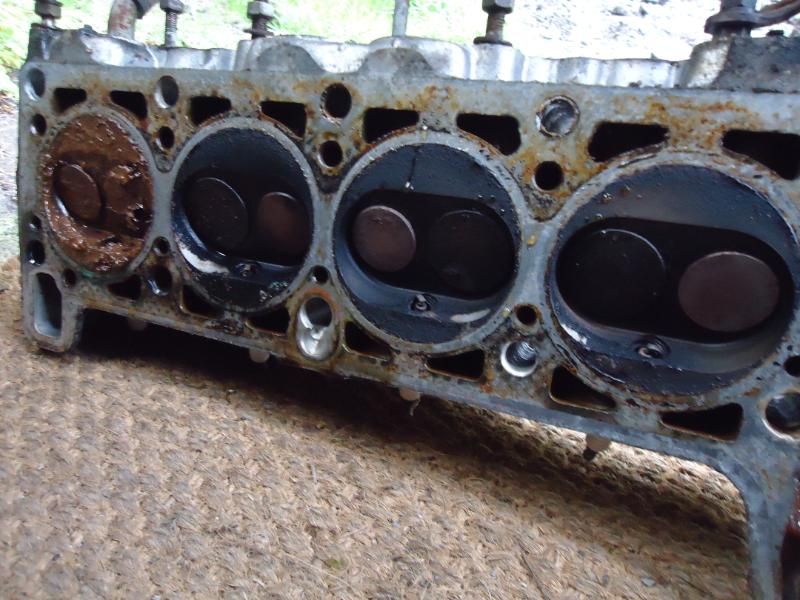

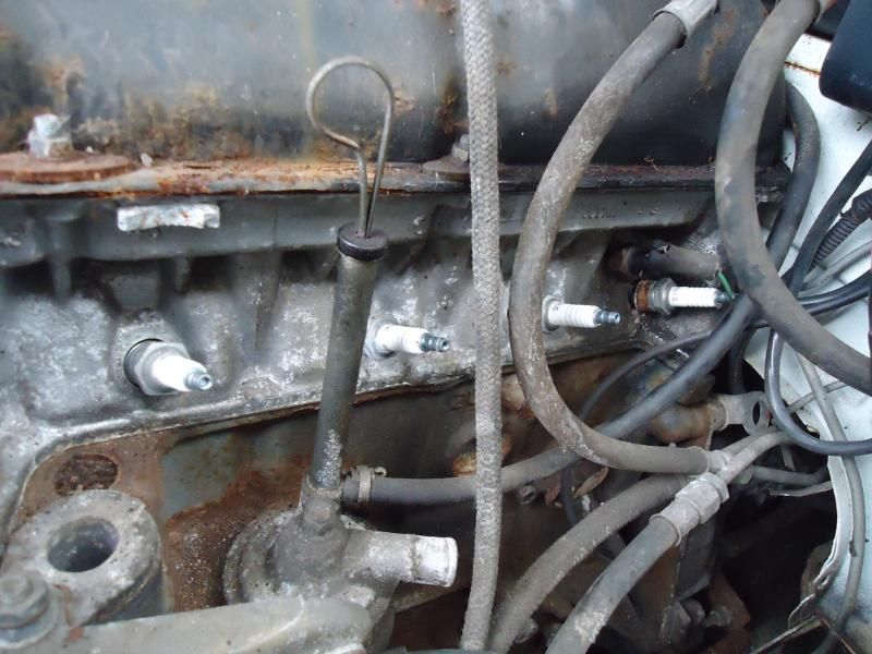

Spark plugs out, and looked okay till I found the 4th cylinder full of water. She turned over with a bit of a lean on a spanner though, so not entirely ceased.
Found Cambridge wildlife living in the engine bay

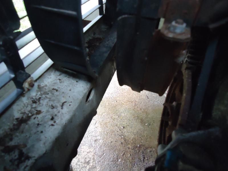

The well-educated amongst you will know what that hole is for. Never in a million years did I expect, at the age of 21, to have a car with a starting handle!
Luckily the water pump was fine as the coolant looked clean and blue.

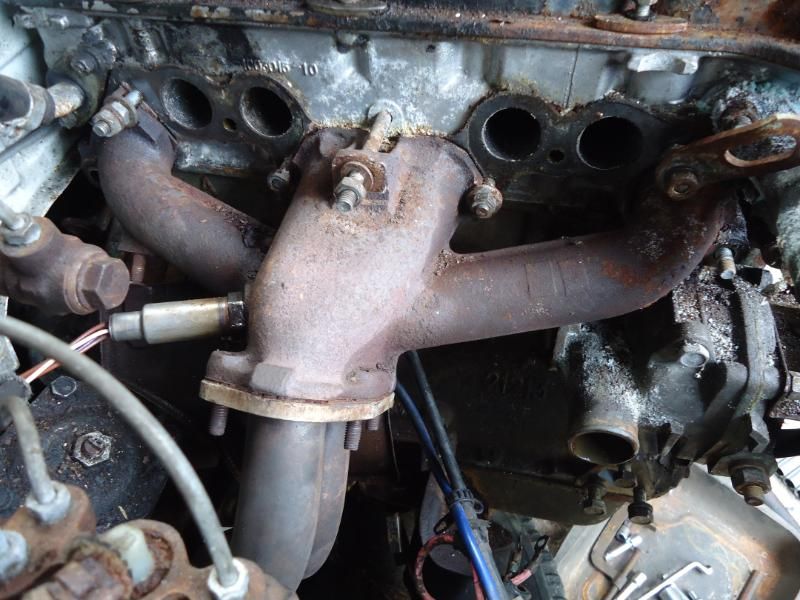

The alternator was a bastard to get off, ceased solid, but managed in the end with a bit of help from Joe and his trusty hammer. Banging it obviously helped, it span freely as soon as we got it off!
Re-engineered the alternator bracket so the semi-captive nut was free and easier to remove in a hurry next time.

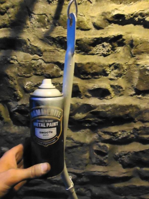

And the last job before it got too dark to work was to re-spray the engine bay cross-member, to check the colour match to Hammerite Smooth White. Hopefully I can get away with re-spraying repaired/re-sealed sections with this paint, cheaper, easier to use and very good stuff! Used this on white 205s all the time and a concourse judge would never know!

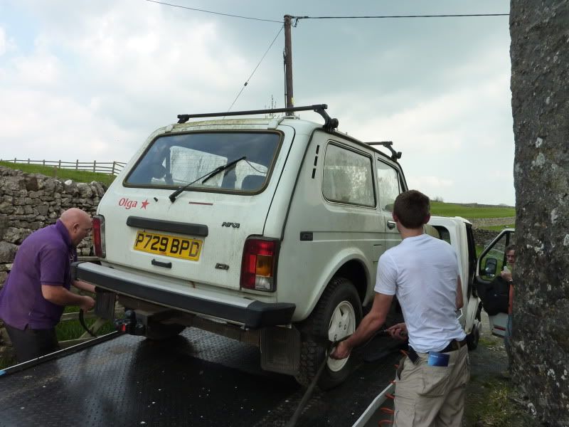

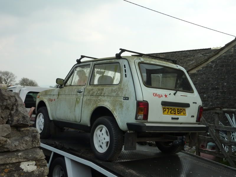

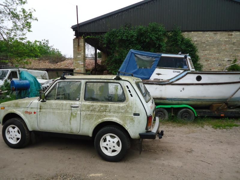

On she goes.

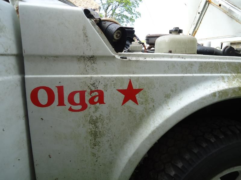

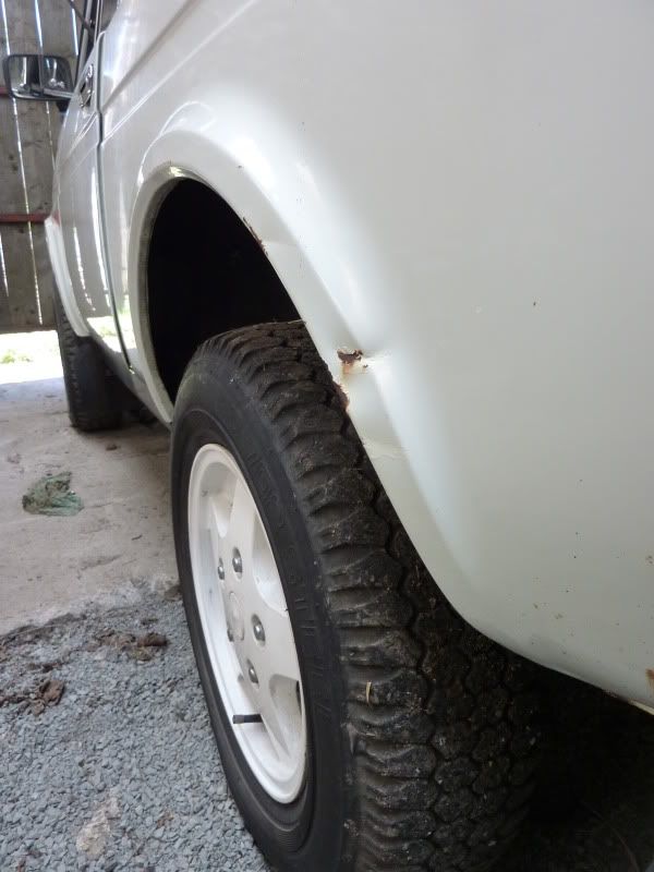

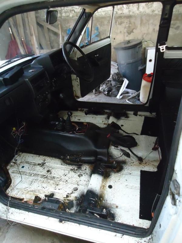

Battery off

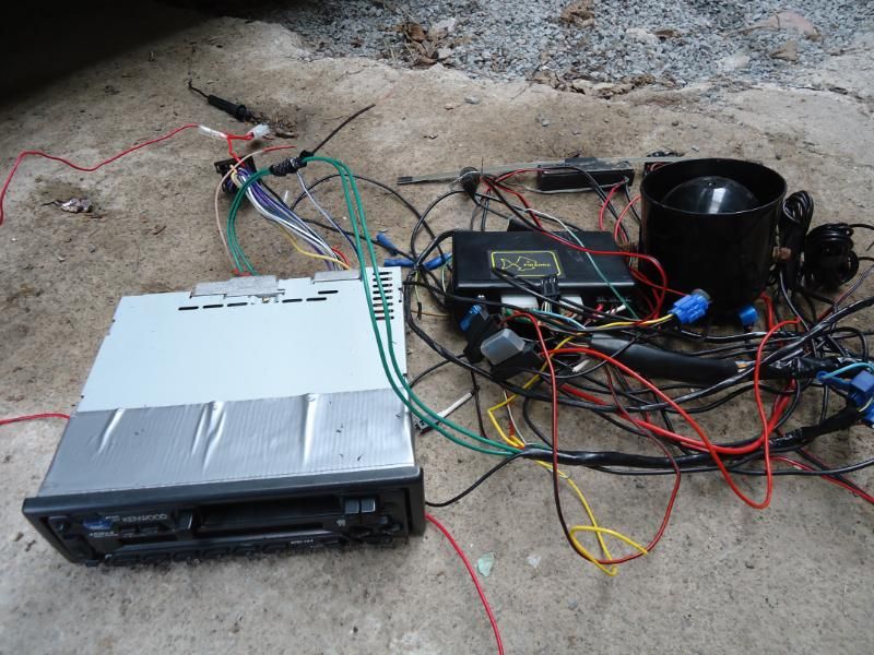

Joe's Lada supplied the power to check electrics, all looked and sounded okay because we were deafened and stunned by that little bastard immobilizer some numpty had installed.
Soon became a pile of scrap! :D Along with that awful head unit and tweeters that were aftermarket installed. Originality all the way!

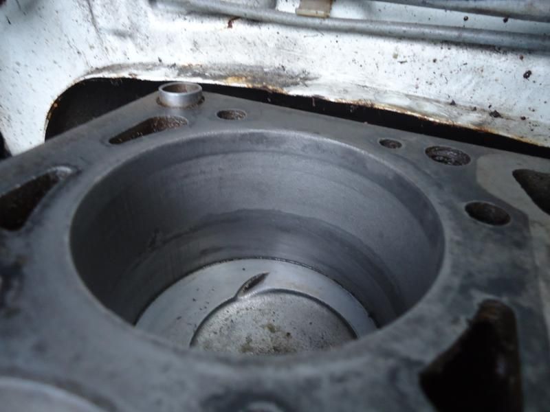

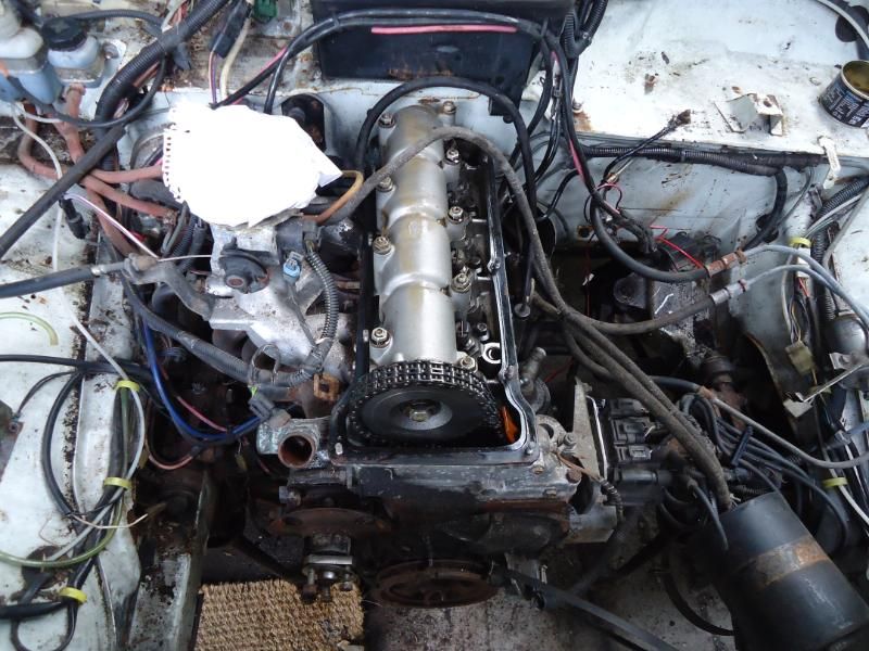

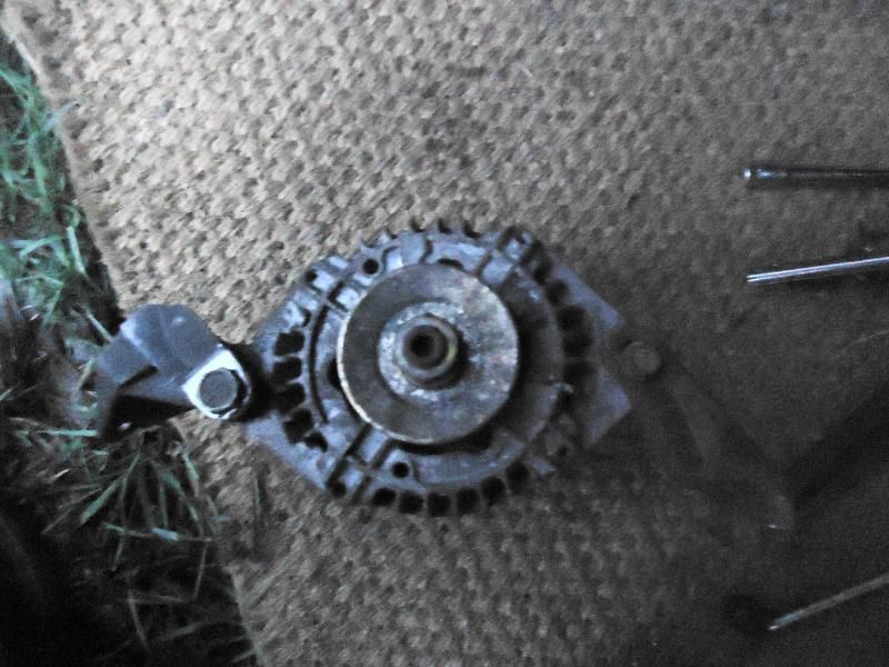

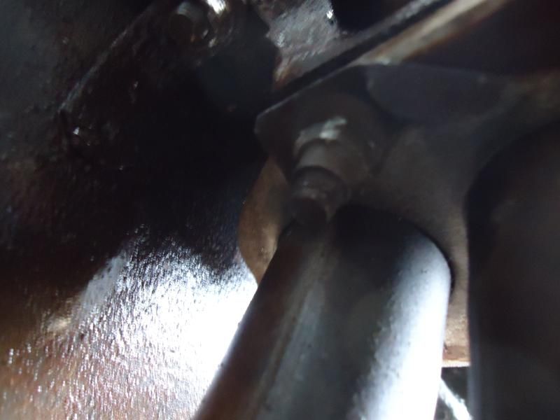

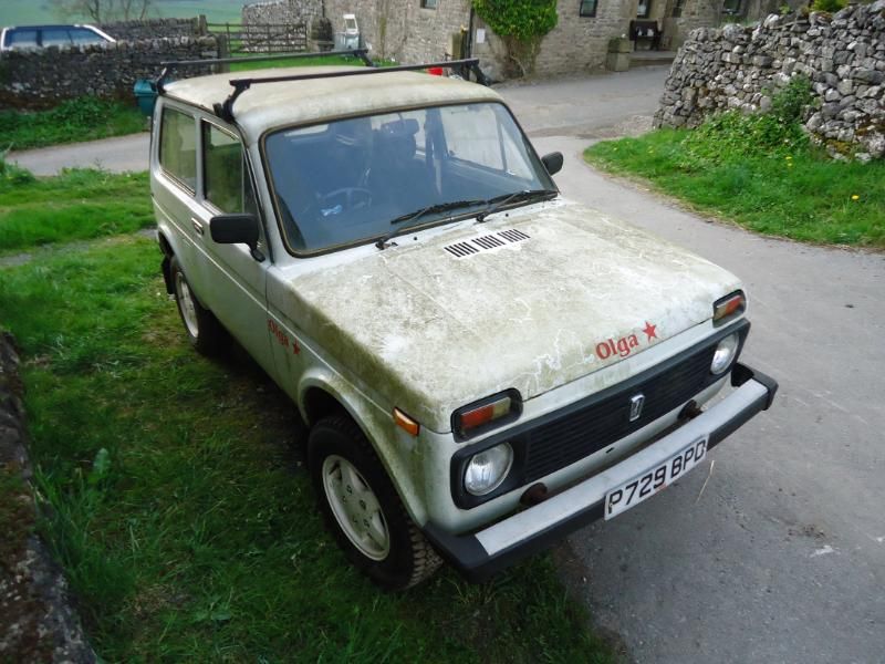

First progress:

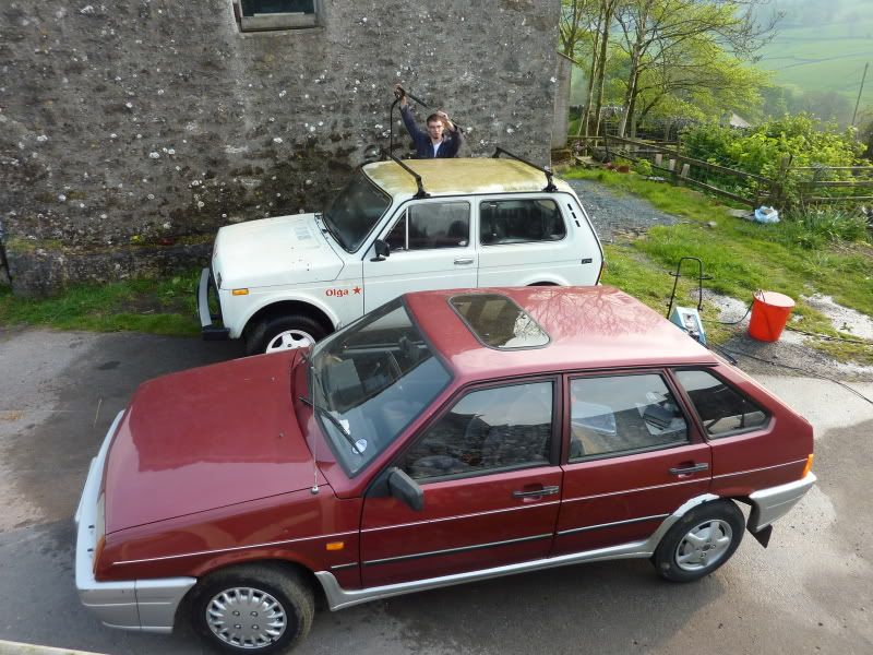

The Samara is not a big car. I' had forgotten how small these Nivas are.

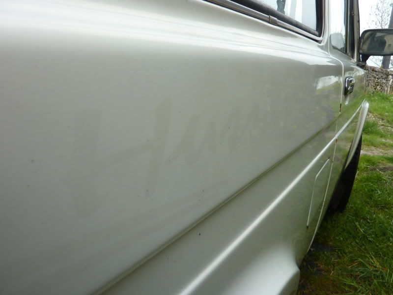

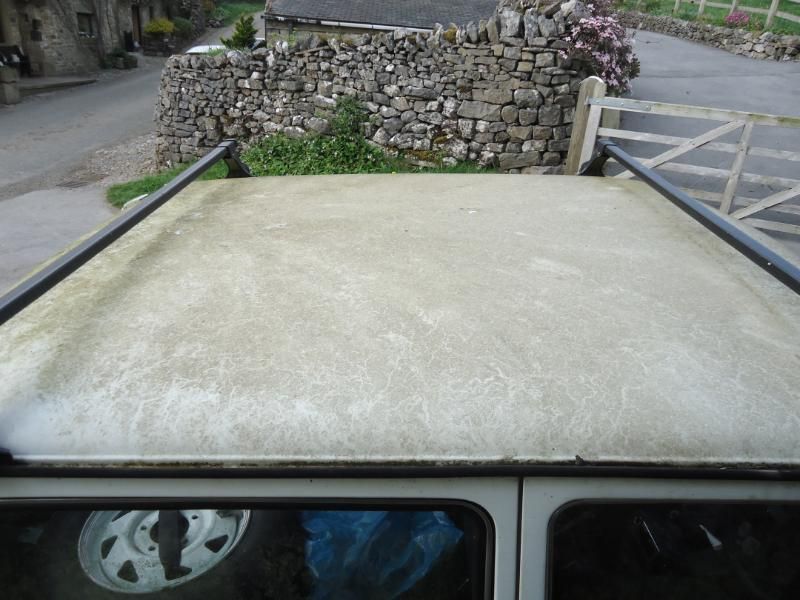

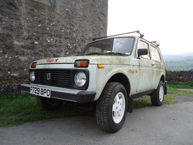

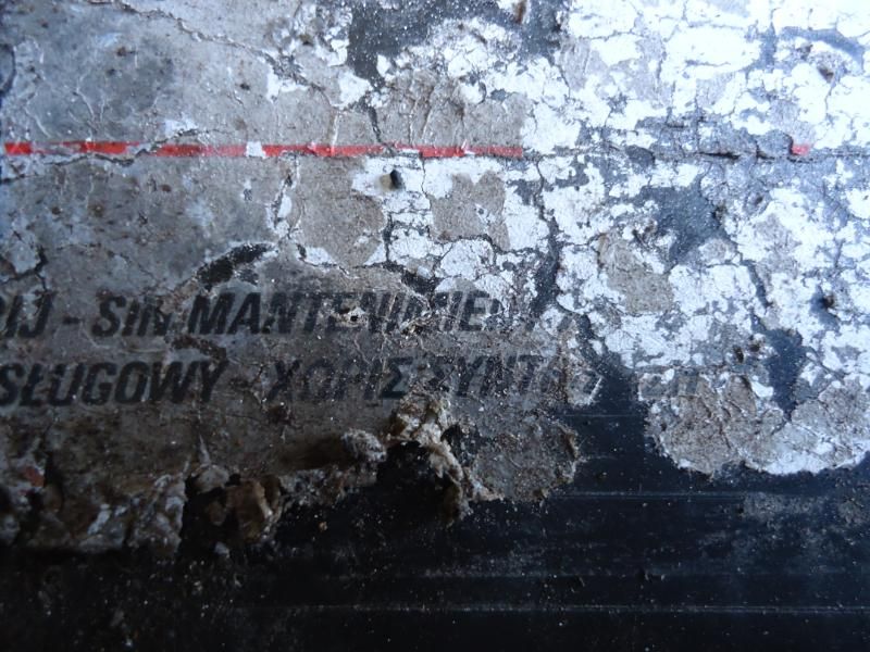

Shadows from the original graphics under the moss:
The condition is best described as a "16 year old Lada with 8000 miles on the clock, that has been in a hedge for five years. With HGF."
Sadly, there is rust showing through the paint on almost every seam. Another five years in that yard - I hate to think of the state...
Into its new home:
That'll do for now.
I must say, she's a fine looking thing (if you don't look too closely) and if Will manages to pull this off, I'll be WELL JELL.

Back at home after another 5 days away at work, and have made some progress today on Olga, if slow. Good and bad news to follow!
This post follows last friday's work, then leads on into today.

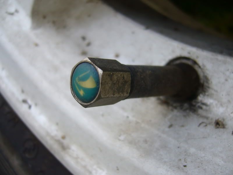

But first, a little trivia. What the hell is this?? Found it under the trim below drivers seat, KruJoe seems to think it is a subway token or suchlike lost by a factory worker. I'm hoping it may be something exciting like a dinner token. One thing is for sure, it has probably been under there since it was built. Anyone with experience in a Russian factory please let us know! :roll:
Anyway, down to business.
After removing the alternator, fan, radiator, bonnet and associated gubbins I needed to remove other ancillaries to make way for cylinder head removal. Curiosity got the better of me and I removed the cam cover for a sneek peak.
Looks a bit slimey but generally good and clean, with nothing in there you wouldn't expect.
Was sailing along merrily and the injection system came off a dream.
Unfortunately I spent a large amount of the afternoon pissing about trying to remove the exhaust manifold, what a bitch! I think they should make a law whereby copper grease has to be used in the construction of all motors!
Looking at the picture above, it would have been a damn sight easier working on this motor if it was left hand drive, as the clutch servo and brake servos may have been on the other side, leaving more room around the back of the block for hands/ratchets.
As always happens in life, its the manifold studs you can't reach that always are the ones that are seized tight! I had to get a picture of it with my camera because I couldn't see it. Looking back it was a wonder that I managed to get it off at all! I had to jack the car up, remove the wheel, make a foot long extension up through the inner wheel arch with Joe's 3/8s ratchet set and use a lump hammer to bang a 1/2inch socket onto the 13mm nut! Exercise in ingenuity!
Anyway, got it off eventually, with a bit of gentle persuasion, and a lot of cursing.
Turns out it is recommended in my new-found 'VAZ VEHICLES REPAIR MANUAL' that the cylinder head is best removed with exhaust and intake manifolds still attached, something completely new to me, after working on deisel 205s!
Looking tidier, ready now for head removal.
Joe returns home from work and offers a jump to turn her over, see what happens.
I was too hands on with jump leads etc at this point to get any good pictures of myself being sprayed in the face with rusty, oily water from the cylinder bores as I touched the jump leads across the starter motor. I think Joe has a few.
Knowing that the engine turns over reasonably well I could sleep that night without nightmares of bad internal engine damage. I spent half an hour or so cleaning and re-arranging the shed and sweeping it out. After rolling about under the car trying to remove exhaust manifold nuts I was sick of getting gravel and shit in my hair. And I have to keep the shop tidy to keep the parents happy!

Unfortunately it turns out that Hammerite White spray paint is the wrong shade for the bodywork, but I will invest in a tin to do the inside of the engine bay now that the engine is smaller and easier to get around. Its close to the right colour but just a little too bright white, it will be a quick and easy paint to do the inside of the engine bay whilst I can, and the colour difference will be un-noticable with time and grime.

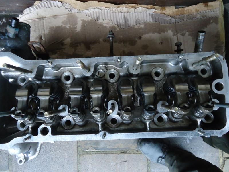

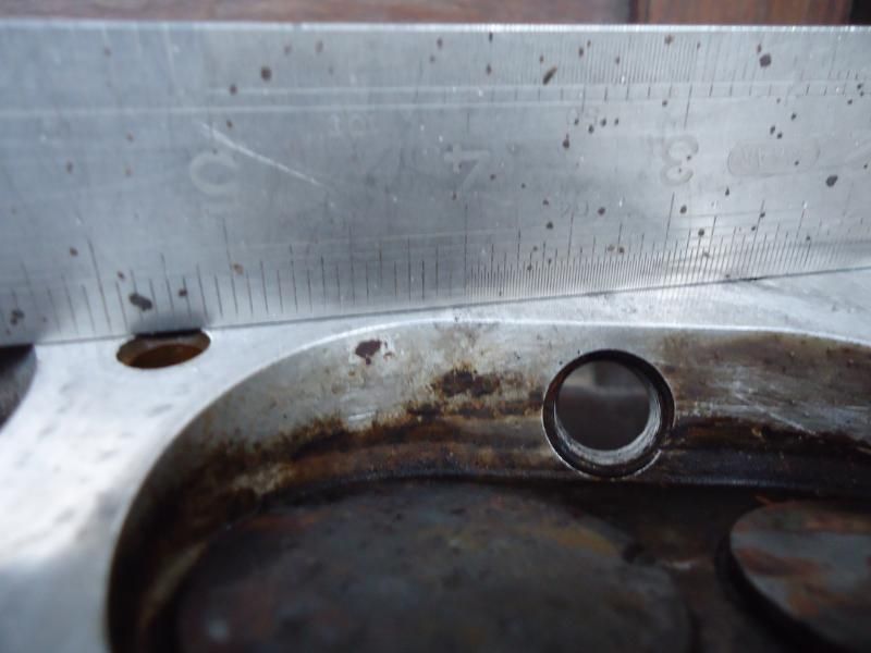

The head removal was a quick an simple job in the state I left the engine in, none of this hex bolt shit, just a standard 13mm bolts :D
But this was what I found...
Cylinder head looked bad at first glance, but looked much better after a couple hours cleaning with a wire wool and Wicked Liquid (like WD40, cleans really well and smells like cheap aftershave :) ) Sprayed it with a good pressure washer loaded with Flash and Fairy Liquid in hot water, followed by a good rinse and a blow down with the air compressor.
The head was in brilliant condition with no cracks and wasn't noticeably warped in the area it leaked, but I will get a tiny bit shaved off the head just for good measure. I know a garage that can do it fairly cheap, and its worth the effort just to be sure.
After lunch I set about the cylinder block with wire wool and elbow grease and it soon came up good too.
Then I noticed corrosion in the 4th bore and my heart dropped.
It was as rough as sandpaper. Luckily the piston wasn't right at the bottom of the stroke when it was stood with water in the cylinder, or it could have been much worse, the corrosion was only an inch deep band.
I had no choice but to attack it with strong rust remover and wire wool and fine wet and dry paper.
3 hours later, the result was this:
The pictures don't do the change justice, all roughness was gone and the result was a fairly smooth, if slightly pitted bore.
Dad has seemed to have taken a liking to Olga (the parents didn't see it arrive dirty) and was more than helpful. He seems to think that if the bores are smooth enough and lubed well and if I take it steady when running the engine in I might be able to get away with it. Bear in mind my Dad did work on old pre-war side-valve engines that didn't have as fine tolerances as these new ones do. God knows what a pitted cylinder bore will do to the emission test readings!
But I don't have much other choice but to keep calm an carry on :|
Well at least the piston was nice and clean after so much attention! :)
^Those dints aren't because of pistons hitting the valves, they were designed in.
The script round the outside reads something like 'Moskovski Metropoliten', so yes it's probably a tube token.

Car bought with HGF, now home and head removed, how does one tell whether it needs the head skimming or not?
If it is done, must it be stripped first? (Looks to be plenty enough meat before the valves would be touched if they were left in.)
When we had the C*rsa head skimmed we left all the valves etc in place. No idea if you can tell whether a head's been skimmed or not (unless you have a micrometer or whatever they use) but for the cost I wouldn't risk not having it done tbh.
Cheers Billy.
Will has had an offer from a mate to do it for £20 - it would be rude not to! So are you taking the head home in your rucksack Will?
