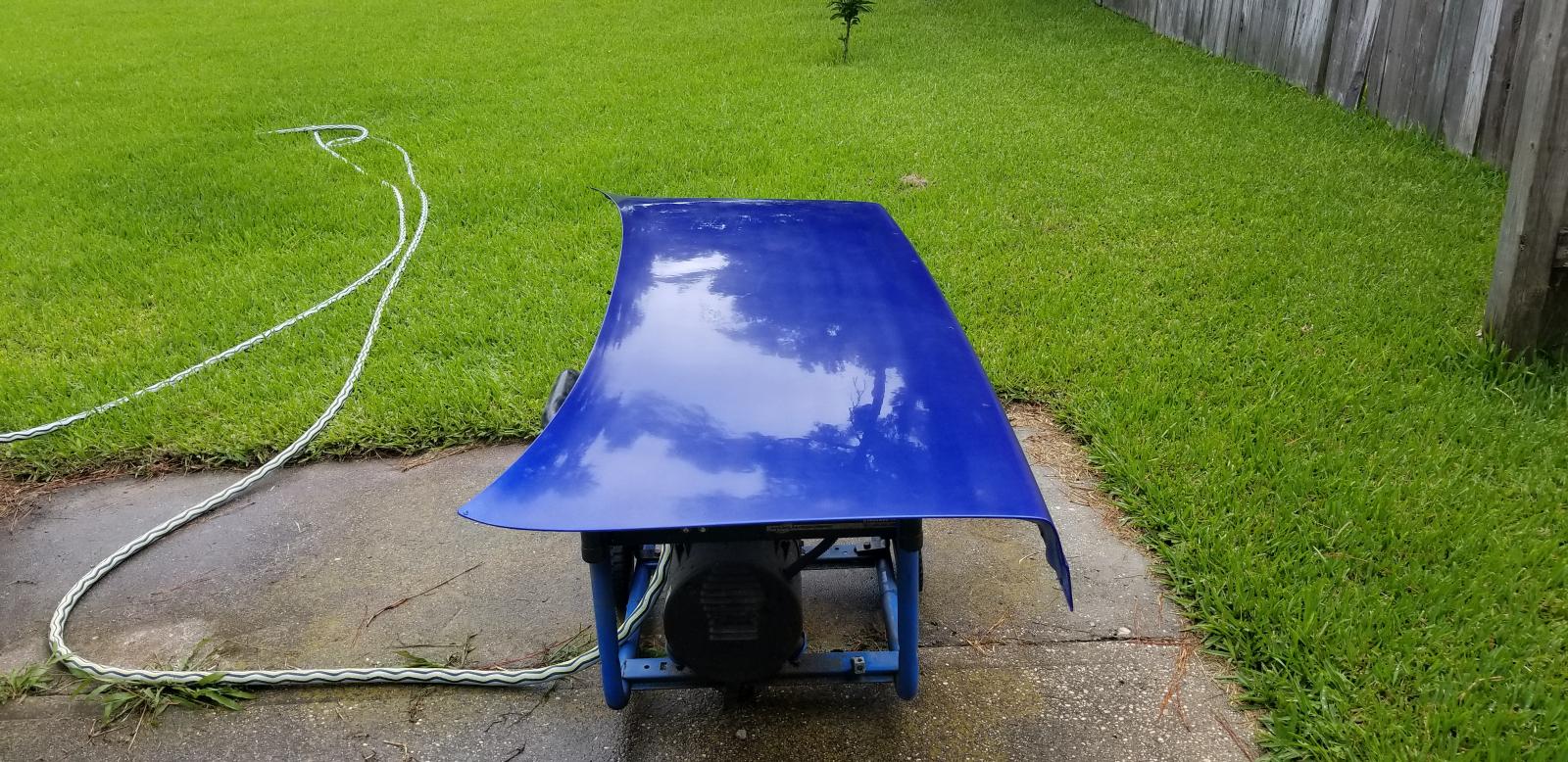

So, the last application of blue went on a little stripey, coupled with speckled finish from the spitting can.
Wet flatted it back with 600 grit.
Not a bad finish, right there. No water on that surface, it was dried.
I hung it up on a box, it decided to stay put well enough to do so. Also found that spraying "forwards" with these cans yields halfway decent results.
Applied clear coat as the blue was still tacky.
It's now drying, we'll see what it looks like once the clear coat stops being cloudy wet.
Phil

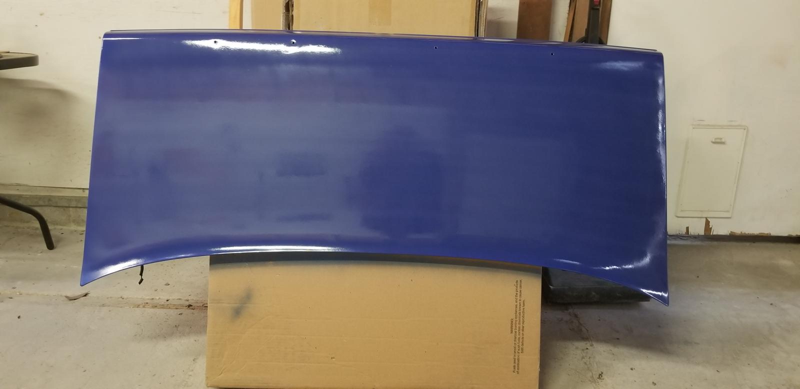

It's dried quite dull and hazy, which is my experience with this type of clear coat. Humidity probably factors in, it got all humid this afternoon, likely adding to the bloom.
I'll flat it back gently and see if I can liberate a shine.
Either way, it's got more paint on it than it ever had, and to add to that, this paint is not porous.
Phil
Edit: The paint finish on the cardboard box it was sitting on is most excellent. The overspray looks fine...
Go figure

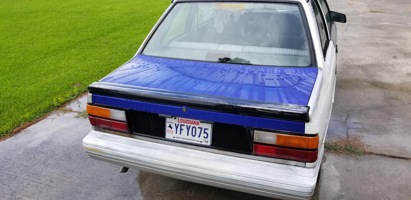

Began wet flatting the clear coat back by hand. 800, 1000, 2000, 2500.
The sun decided to come out, typically. Gave it a buff over by hand.
Decided to wedge it back onto the car.
It even beads water now!

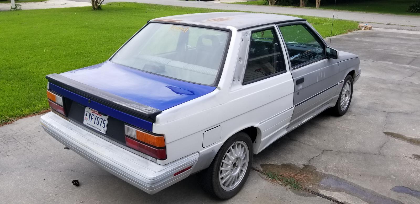

I quite like the color. It has shown the necessity for a proper paint gun though.
Phil

That's a really nice blue and contrasts well with the bits of black trim.  Looks really good for a rattlecan job too, it's amazing what folks can do when they have a go.
Yeah. I think I'm going to retain the satin black, it looks better than I thought.
Need to redo the spoiler, but it had to go back on to stop the water getting in!
The contrast of the indicators sets it off, they're not far off the complimentary color.
Phil
