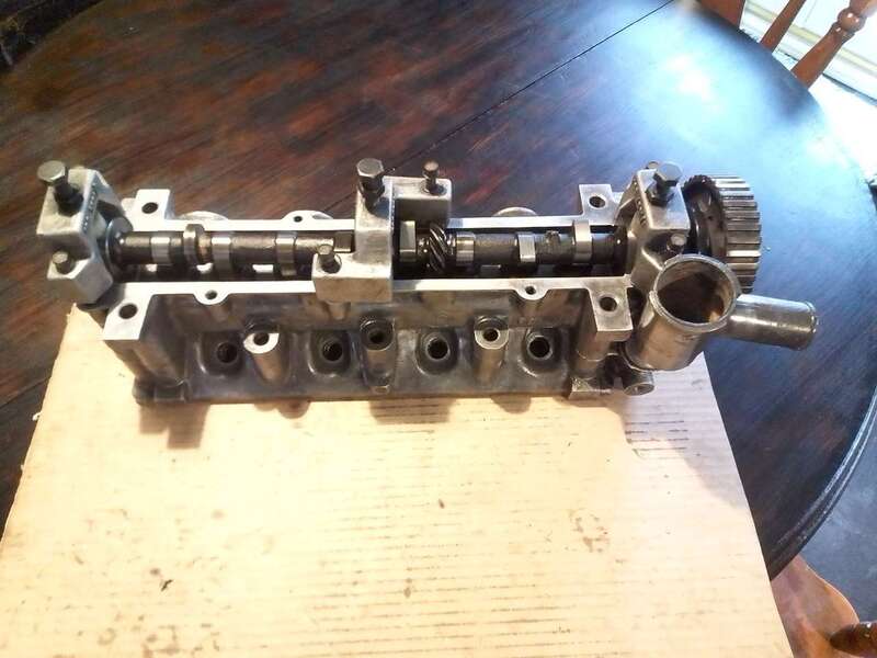

vulgalour Posted January 6 Author Posted January 6 Yesterday was rough, definitely overdid it. Anyway, today I got the head stripped down and ready to ship off to the machine shop later this week. There are some very minor surface scratches that I can see but can't get with a fingernail on one bearing surface, a bit of carbon build up on the valves, oil is a little black but devoid of chunks and sparkles. I'll take the camshaft with me to the shop and get their advice on if any work is needed there. Nothing has jumped out as being amiss to the naked eye. The only other weird thing is the head gasket itself. The metal rings in the middle are fine, but the rest of the material it's made of seems to have shrunk? I've never seen it happen before, but it's like the gasket is just ever so slightly too small in every dimension except for where the metal bits of it are. I'll let you know what the report is from the machinist when the head comes back. If need be I've got that spare head too so hopefully I can make one good head out of the two. It's the best I can do for now. @24vdiamond funny you should mention that, someone was asking me about copper gasket spray, I imagine that's the more modern equivalent. cbowditch 1

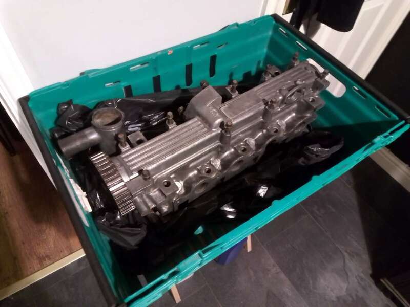

vulgalour Posted January 16 Author Posted January 16 Ready to be rebuilt. Hopefully I'm going to get into it this weekend. danthecapriman, Marshall2810, Angrydicky and 7 others 8 2
SilverMachine Posted January 16 Posted January 16 1 hour ago, vulgalour said: Ready to be rebuilt. Hopefully I'm going to get into it this weekend. supermarket veg crates are handy! i have a couple myself... hopefully there will be a few hours of sun over the weekend for you! but please, take it easy! also wondering if theres still any companies that will put new linings on your old brake shoes, and or refurb them for you? as i know linings used to be available to rivet on yourself!
Angrydicky Posted January 16 Posted January 16 8 minutes ago, SilverMachine said: supermarket veg crates are handy! i have a couple myself... hopefully there will be a few hours of sun over the weekend for you! but please, take it easy! also wondering if theres still any companies that will put new linings on your old brake shoes, and or refurb them for you? as i know linings used to be available to rivet on yourself! Charles Johnson in Norwich are who I use for shoe relining. Nos ones probably cheaper if you can find them. SilverMachine 1

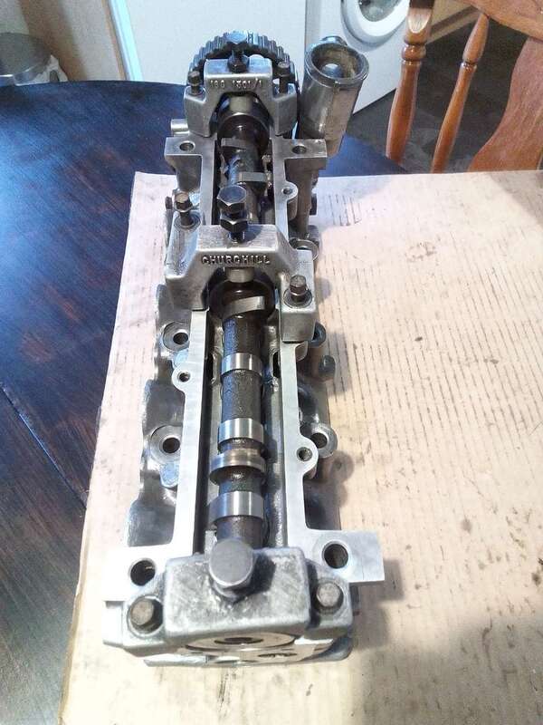

vulgalour Posted January 18 Author Posted January 18 Okay, a more full story on what's going on with this head then. Pressure test was fine, no cracks or similar identified. Bearing surfaces in the cambox and on the camshaft were given a light wet-and-dry just to clean them up, otherwise fine. Valve guide stems are quite healthy, no damage there. Original waxstat housing installed in place of the modification that had been done, apparently the pipe that was in there was a real bear to get out so I'm glad I didn't try that one myself. Head itself needed the barest whisper of a skim, almost as though the last time it was done it was maybe not done well enough, but it certainly wasn't bad enough that you'd call it warped in the usual sense. Today I've spent time cleaning the carbon off the valves, lapping them in with the old twizzly stick and valve grinding paste, and rebuilding the valve train. I hate this particular job and I hate the next job I have to do even more, which is setting the valve clearances. Fortunately I do have the proper Churchill tool which does make it a bit bit easier and I don't have to sacrifice a cambox to make one. Next job is feeler guages and micrometer to get all the valve shims to the correct thickness so that the clearances are nicely balanced and I can hopefully do away with that one noisy one. From what we can figure out it seems that the cause of the head gasket failure is a combination of a bad gasket and possibly a less-than-perfect skim when it was done last, it's just taken a while for these two things to get bad enough to actually fail and of course I caught it immediately so we didn't go into mega overheating and mayonnaise territory, which is good. RayMK, somewhatfoolish, timolloyd and 16 others 16 3
