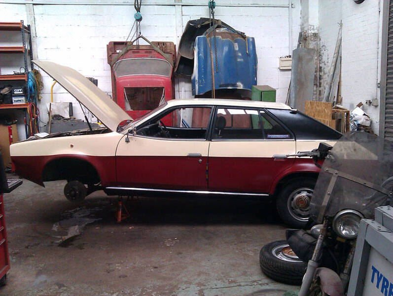

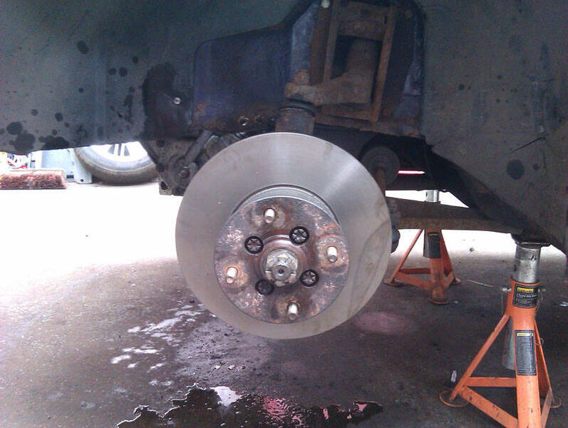

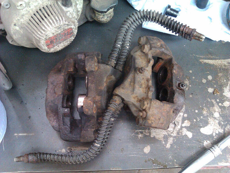

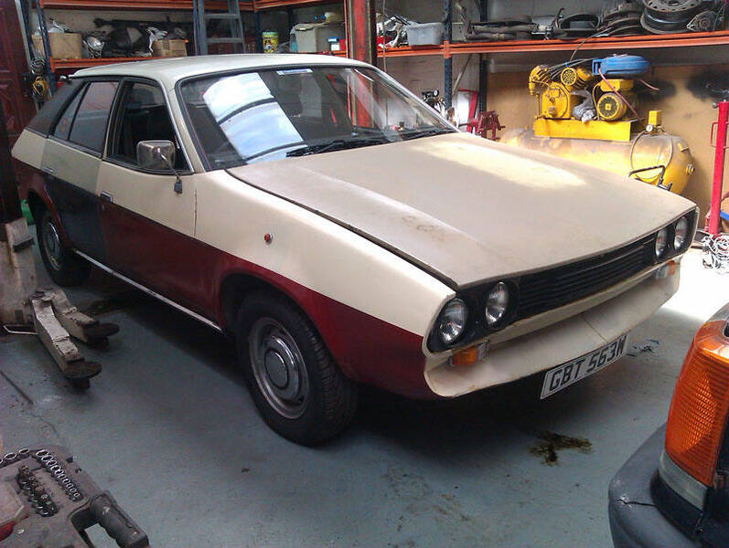

Right then, these brakes.  Princess started no bother as has become the norm, and we trundled over to the unit.  Dismantling everything was actually surprisingly easy, in large part because Mike did that instead of me, but also because things weren't all rusted solid which made a very pleasant change.  The old brake pads still have loads of meat left on them and aren't particularly badly damaged really.  Even the pins and anti rattle/squeal plate things looked like they could be reused (they won't be).  Before disconnecting the hoses to the calipers, Mike stuck a bit of wood in them while I operated the pedal and most of the pistons popped free.
Annoyingly, 2 of the 8 pots are stuck, so Mike did battle with those on the bench while I dealt with that bit of flaking paint around the side repeater.  It is not my finest painting hour, I must say, at least the rust and bare metal are dealt with and that's all that matters at this point.

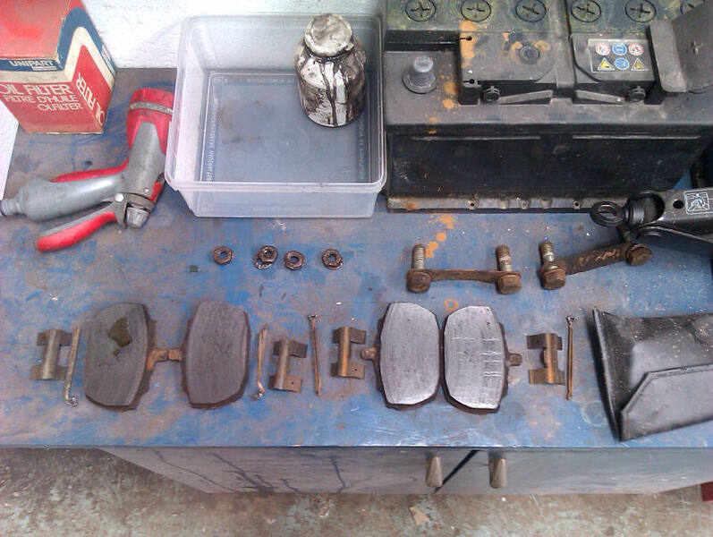

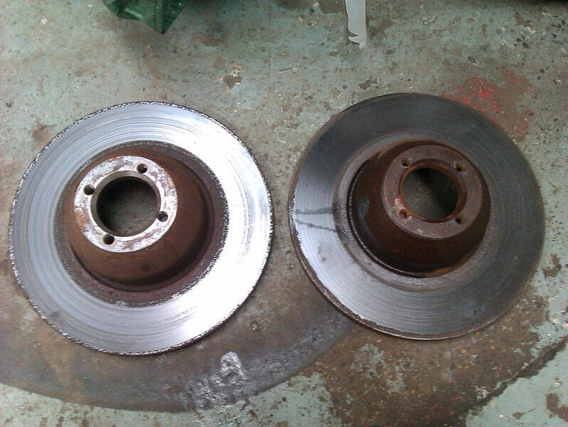

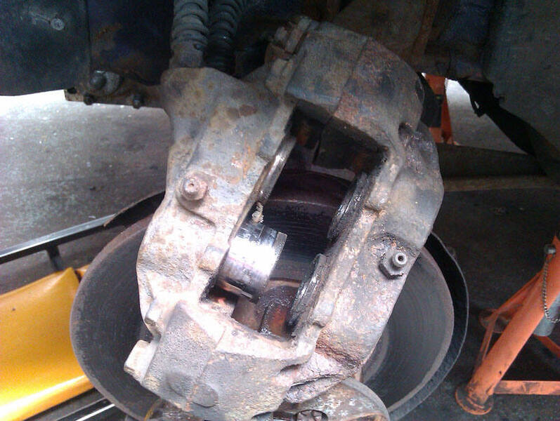

Removing the old discs was delightfully easy.  In fact, none of this brake job has been a war especially, which Mike and I were both surprised about.  To remove the discs you have to remove the split pin and hub nut, then clamp the disc in the vise to unbolt the outer hub part from the disc itself.  I haven't yet torqued up the hub nuts or refitted the split pin, the new discs are just in place until we're ready to put the calipers back on.

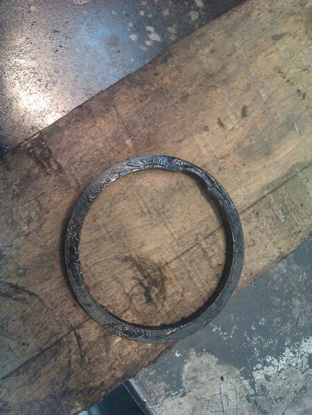

One of the brake caliper piston seals and retaining ring fell off which demonstrated the need for a rebuild (I have the kits, it's a job that will be done before reassembly) and the passenger side disc has started to warp with a very similar section of damage on the surface to what the driver's side had.  Both calipers are ready for a rebuild, perhaps past ready, and while they don't leak and the brakes do meet the legal requirement, it's clear they've not been working as well as they should for quite some time.  At least now we can fix that.  There wasn't enough time to finish faffing with the calipers today and Mike's said he'll get the sticky pistons unstuck this week so that everything can go back together.  The hoses and hard lines all look in good shape, which was nice to see, and while the calipers are scruffy they're certainly not in need of massive amounts of remedial work, just a quick tidy and new seals really.

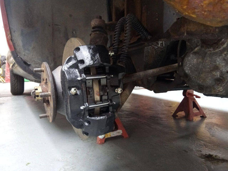

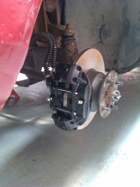

Those calipers look massively over powered for the car?! I mean four pots and two brake lines!
The disc setup looks very much like my MGBs. I'm not looking forward to trying to remove the hub and disc combo.
Really good brakes on these cars: two circuits, both circuits work both front wheels. Princess calipers were the brake mod for fast Fords for years.
I agree, the brakes are massively over-engineered for the car and it's not hard to see why they continue to be one of the most valuable items on even a scrap car, as Asimo says, they were a cheap and effective performance upgrade on Fords for a very long time, and standard fare for many a kit car.  Realistically it doesn't need the brakes its got and most Princesses seem to have survived without ever needing to have the front discs or pads replaced from new, it's entirely plausible that the ones on my car are the originals from 1980.  What's going to be interesting is how good the brakes will be when we're done, they've never been particularly lacking until the warped disc incident so I imagine they could even compare favourably to the BX brakes.
Those pads look glazed tae fook. Rest of it looks in good shape though.
Renault pads looked like that, put new ones in and the difference even on old discs was startling.
--Phil
Trick of the light.  In person they're not very shiny, for some reason my phone-cam picked up a lot of shine you can't see in person.

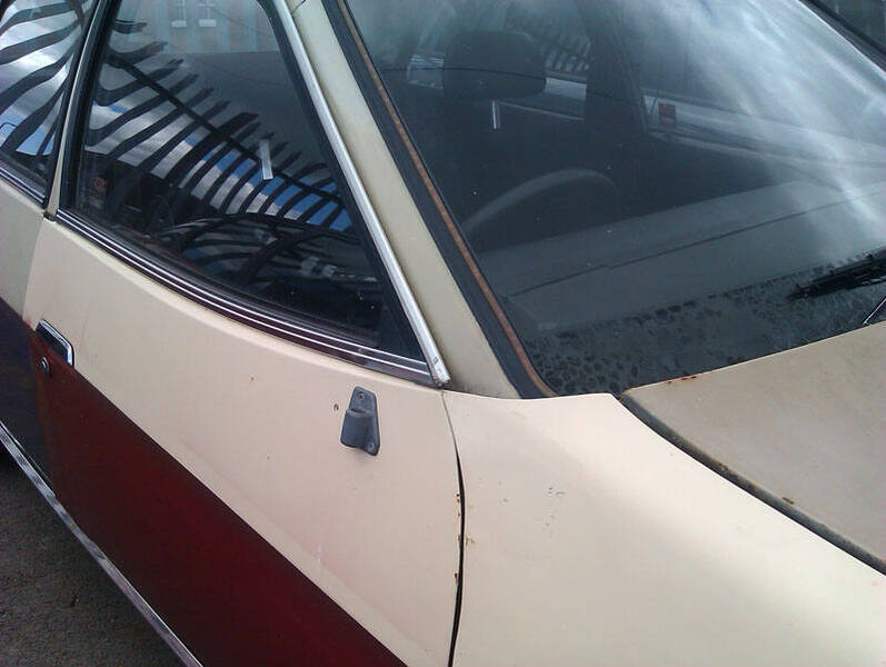

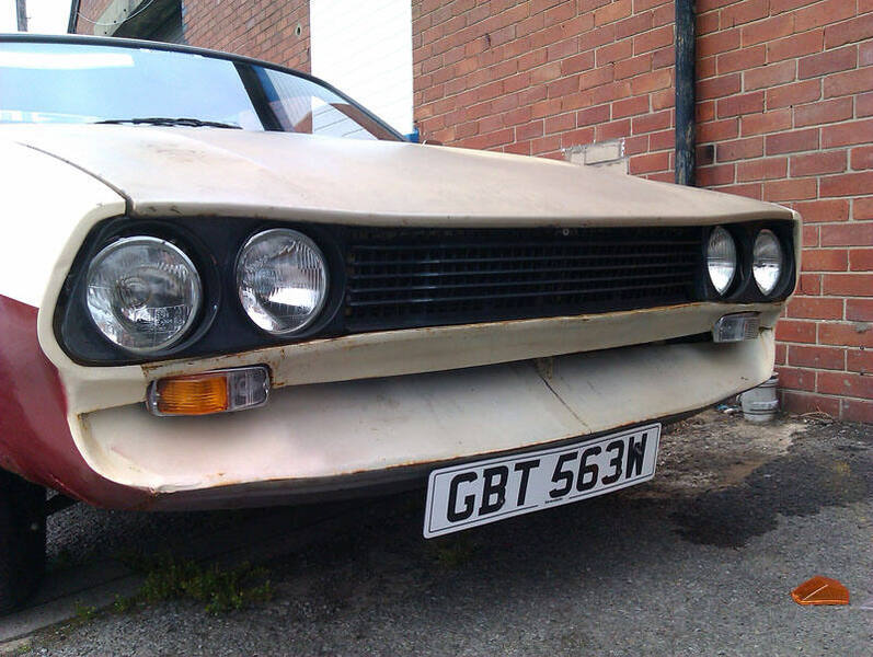

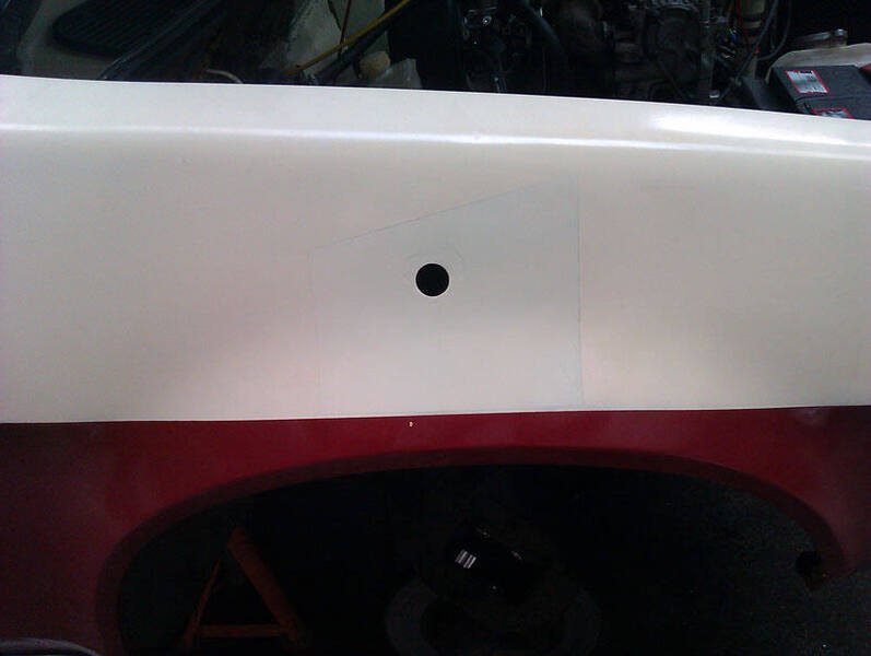

While the Princess has been at the unit waiting for brake parts, someone has been snooping around everything and snapped the door mirror off.  Fortunately I can repair it.  I had initially thought the weld between the original arm and the new threaded portion I had to attach is what had broken, it was actually part of the weld itself which had a weak point.  That said, the amount of force required to bend the mirror forwards to snap the weld must have been considerable and deliberate so I'm not particularly thrilled about it.  I'm just relieved it didn't do more damage, had the weld not failed it could have put a nasty dent in that panel, or worse.  I'll repair the mirror stem when I do the rear door, which I'll be doing over the next few days, since it seems a bit daft to haul the welder out just to do one little blob on the mirror stem.

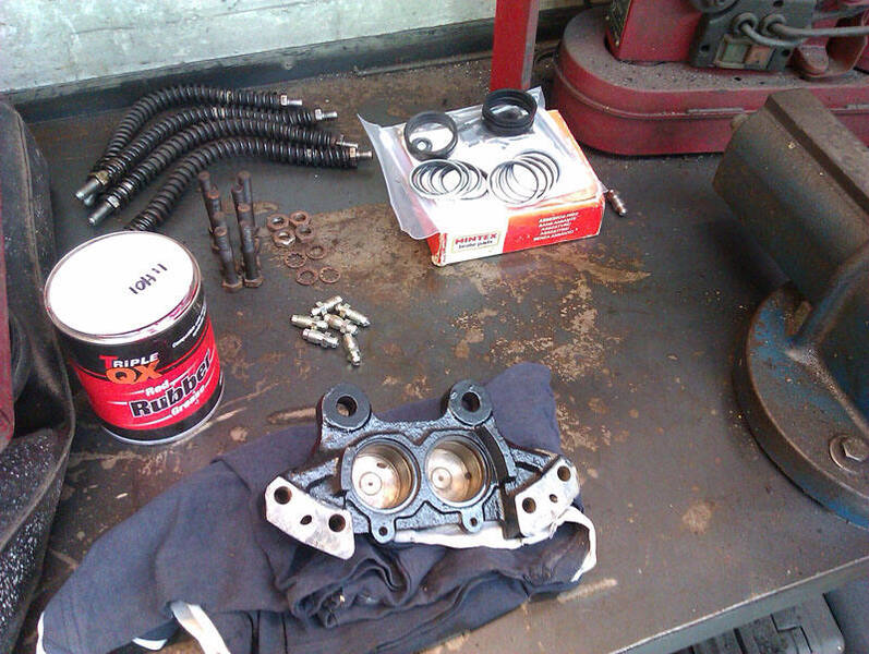

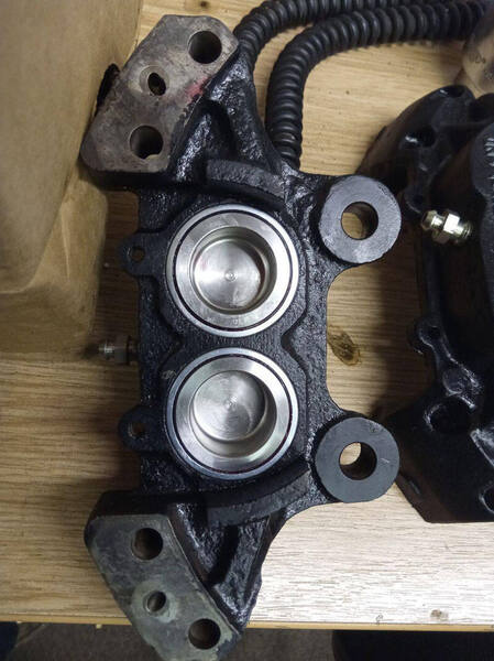

In other news, the brake parts arrived so we could get on with that.  Mike had already stripped down, inspected, painted, and baked the caliper bodies as well as retapping one of the dodgy threads to a slightly larger size to accept a slightly larger bleed nipple.  There's three bleed nipples on each brake caliper on the Princess.  The old caliper pistons were difficult to remove, some had stuck, and several had corrosion and pitting bad enough to render them scrap.  Fortunately, the corrosion hadn't attacked the bores which are nice and clean, it was limited to the part of the piston that should be protected by the dirt seal, much of which had disintegrated on both pistons.  I bought a set of stainless steel pistons from eBay so this shouldn't be an issue in the future.
I've never done calipers before so Mike was talking me through how to do them.  Much simpler than I expected in all honesty.  We then encountered a problem when we realised that both of the O ring seals needed to be fitted before installing the pistons because otherwise the metal locking ring thing won't seat.  It's just as well we did have to remove the pistons, one of the seals we'd installed broke up as the piston was removed.  All of the other seals are perfectly fine and these are brand new seals, there was no fighting with assembly of the parts, it was all as snug as it should be, so we think this was just a defective seal and nothing more.  A new set of seals has been ordered so the brakes will have to wait a little longer for those to arrive before we can complete reassembly.
At this point I've spent more money trying to rebuild these calipers than it would have cost to just buy a new pair.  Unfortunately, I'm invested in the rebuild to the point that it wouldn't now be cost effective to buy a new pair, so let's hope nothing else goes wrong.

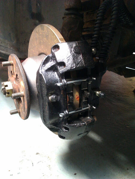

The seal kit and bleed nipple dust covers that I ordered arrived today, much sooner than expected, so Mike got busy rebuilding the calipers and now they're all done and looking lovely.
Bleeding process went very smoothly and everything was going well.  All that needed to be done was nip up the last bleed nipple and put the dust caps and wheels back on.  The last bleed nipple is the one that had to have the thread retapped.  The last bleed nipple did this.
Great joy.  Fortunately, the spare calipers haven't sold so we're pulling those off sale and hoping we can dismantle them to give us the bits we need and that they're in good enough shape to be rebuilt.  At least I've enough spare components to do this after having to order the other seal kit.  If we can't salvage things this way then it looks like all this effort to rebuild the front calipers, and the money invested, as a waste of time and I'll end up having to buy new calipers.  Oh well, that's just the way these jobs go sometimes.

You can't helicoil it, part of the casting has broken off.
Shit about the vandalism to the mirror. Hope the brake job works out.
I actually enjoy refurbing brake calipers; suppose I'm just wierd.
I'd build up that casting with the MIG, re-bore and re-tap.  As I said I'm wierd.
It's okay, Mike managed to salvage the good part from the spare calipers, has already stripped and painted it, so it should all be back together this weekend we hope.
Bollocks to the broken caliper. BUT had you sent these off then they would have still failed and it would have cost you more than it did.

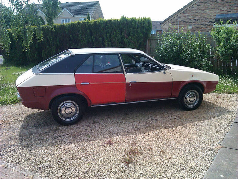

Had a surprisingly easy time of swapping the rear door for my (fairly rotten) spare so I can repair the one I took off and finally get it painted to match.  Eventually I'll replace that rear Allegro hubcap with a Princess one.

With the hub caps?  Allegro ones have a smaller black circle and no scalloped edge.

That's a simply mental number of caliper pistons for just the front wheels. Like something from an aircraft.
On my old metro Turbo it had 4 piston either side. What happens is that gradually one after another seizes up until there's one per wheel working.
In comparison to the Lucas Collette caliper with one piston per side, they are just full of cost.
That's pretty much what had happened with mine.  Aviation redundancy engineering could well be inspiration for it, they do seem rather excessive for what the car is.  A frivolity arrived in the post today for the Princess.  I got some clear indicator lenses and orange bulbs to try out in place of the orange indicator lenses and clear bulbs up front.  I haven't got a preference either way on the appearance, though I do like that the clear lenses obscure the origin of the MG B units somewhat so they look a bit less like they've come from another car.
