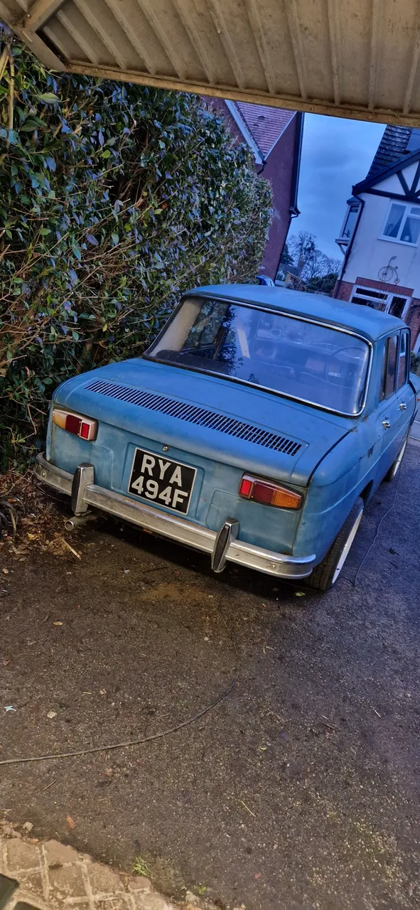

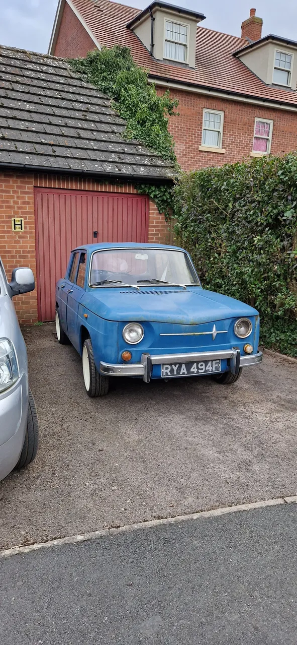

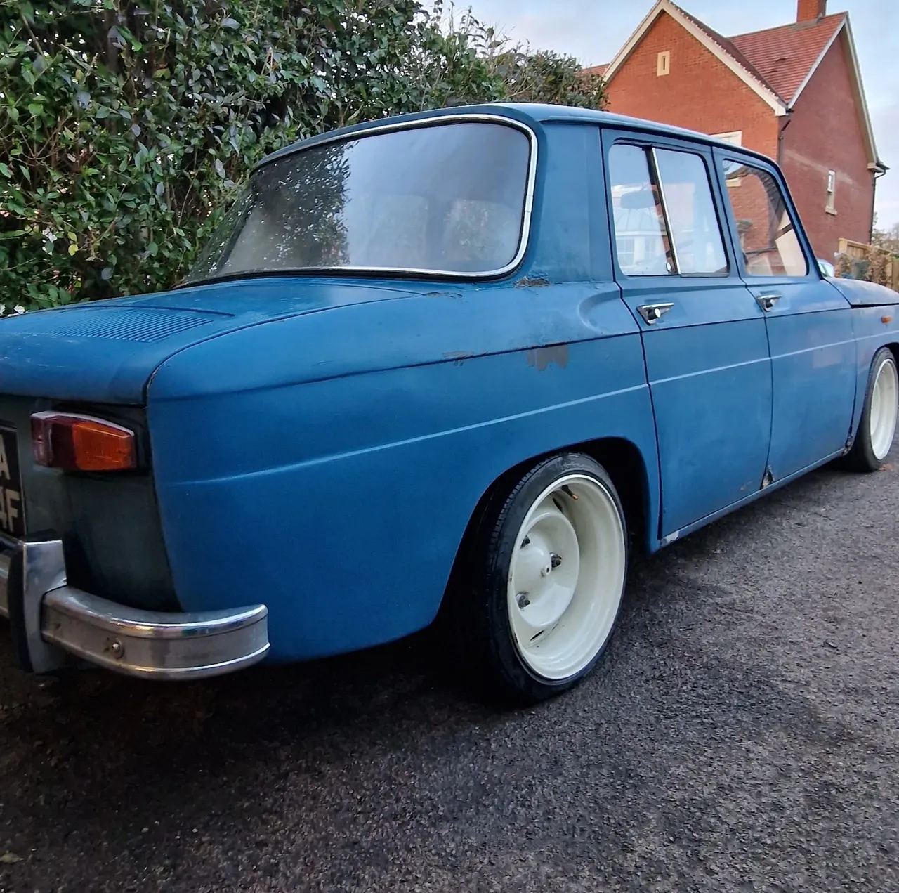

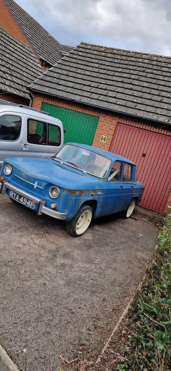

Let me show you "Dolly" (not sure why its called Dolly but that's what Pauls wife has called it for all the time they have had it)

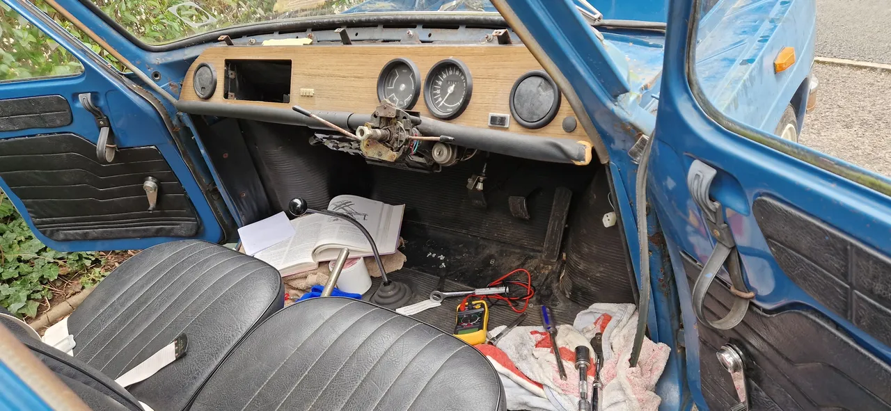

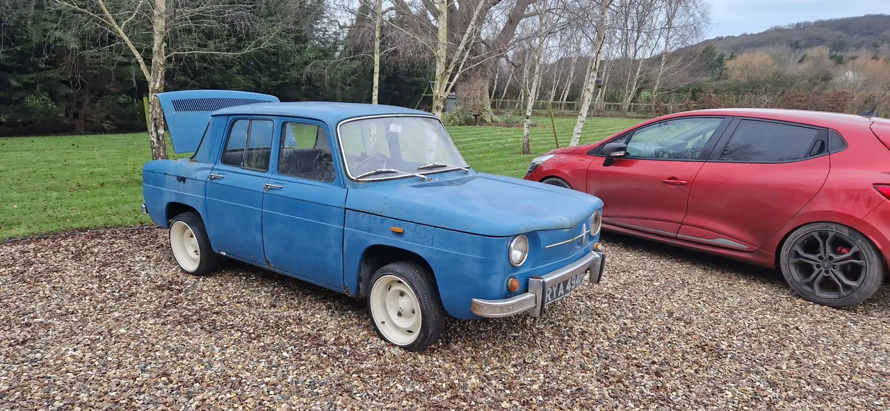

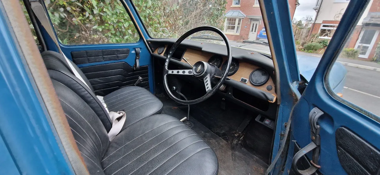

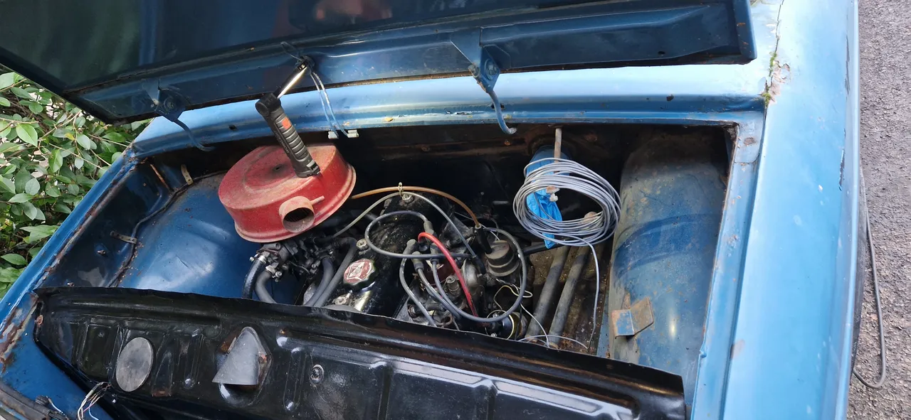

So it is here :D and I'm grinning like a kid at Christmas. At first look there are a few issues to sort but really all I've done this eve is empty it of spares.

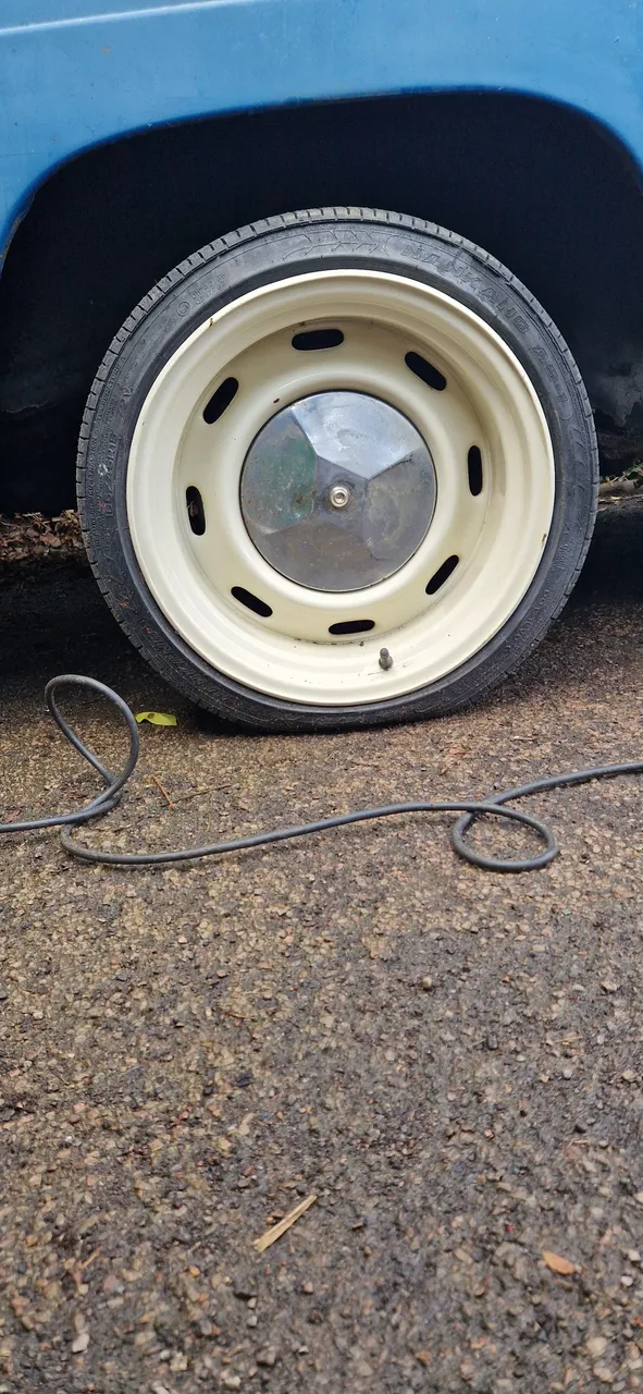

Paul had gotten an ali rad made up for the car which was a nice find. The wheels have been banded already though the tires may need swapping out for something a little chunkier.

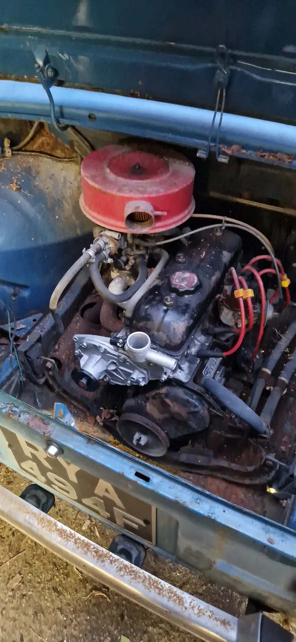

I've removed the spark plugs and the engine rotates with little effort with my hand on the bottom pulley, the head does have a couple of snapped off bolts that will need drilling out and tapping. I have mounted the new water pump so I can use it as a guide to hopefully (fingers crossed) drill out and tap new threads into the head.

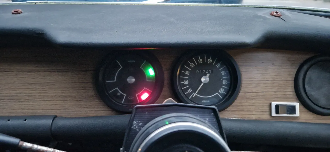

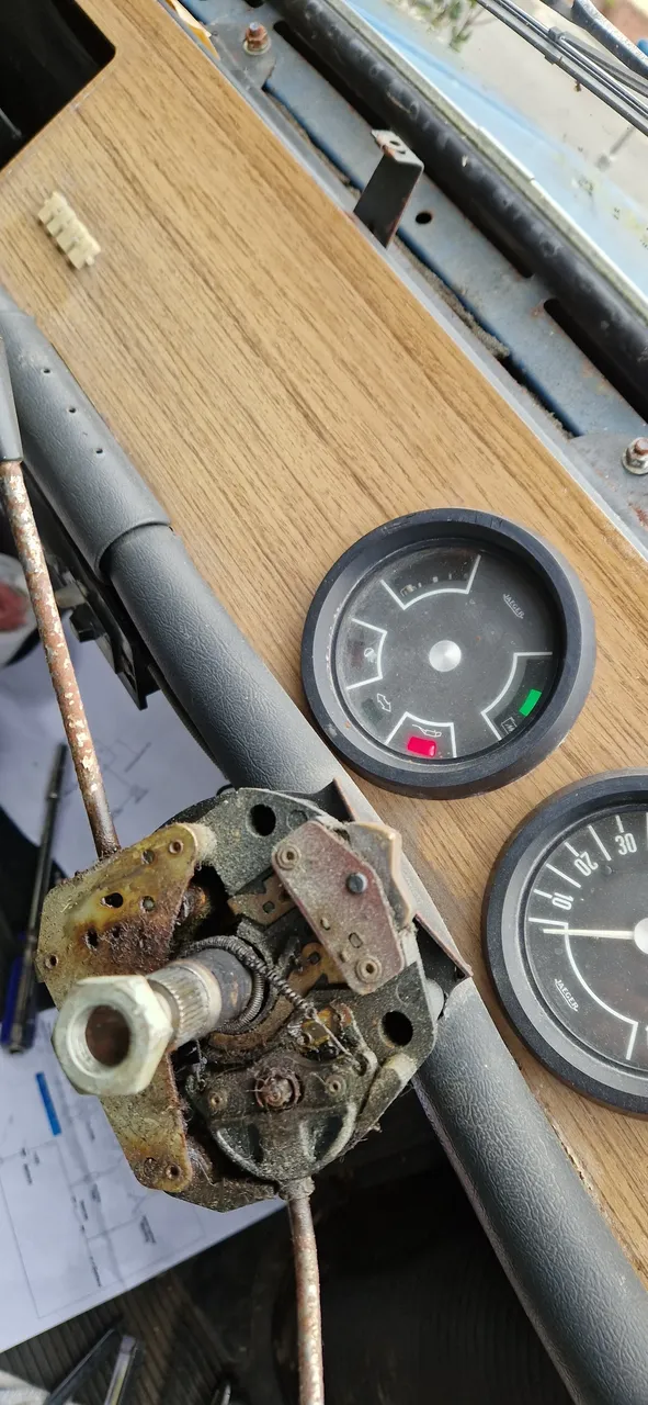

Electrically the dash has come alive, as has the dash fan. Headlights work on one setting and thats about it at the moment. i did click it over to try and start the car but got nothing at all. Itll need a trace of a fair few bits to get them up together. Cant hear any clicking for the indicators either.
Brake pedal is on the floor, I think this will be the biggest thing to sort tbh.
Hopefully I can get it back up and working with minimal fuss, a few evenings and weekends should see it moving under its own steam baring a catastrophic issue.

I've been tickling it along in the back ground.
Stripped cleaned and rebuilt the starter motor. It was turning slowly and only sometimes throwing out the gear. Full of dry grease and light rust. That works sweet as a nut now. Im also cleaning all terminals and remaking connections as I go along. This then allowed me to compression check the engine. Came up all good with everything between 115psi and 120psi so pretty equal between the cylinders. Ive also made a start on an alternator swap, using a clio mk1 alternator. This will allow me to ditch the dynamo and external regulator setup and make things more "modern"
A check and clean up of the condenser and points was done, and set to "haynes manual" settings. Plugs were also cleaned before refitting.
I threw a jerry can of fuel in the tank, and with a few mouthfuls of dirty petrol, made it to the pump....
With a little bit of persuasion (fuel down the carb) we managed this

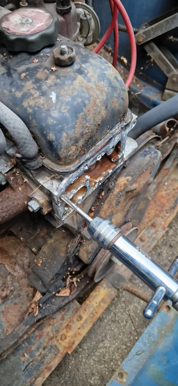

I managed to get some thread back in the head, I used the water pump as a guide to to clean up the head and snapped bolts (was a snug 6.7mm hole) then went in with a 5mm to re tap. fingers crossed it holds but if not the head can come off and go for repair (this is probably when I just build another engine up)
On the water pump, it looks like it may be an r12 item...... this means it doesnt have both the heater matrix hose outlets. Ill find the correct pump and replace it in the future.

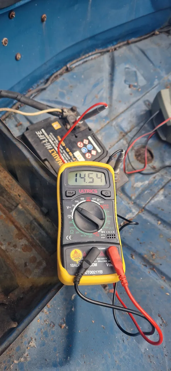

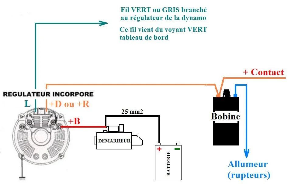

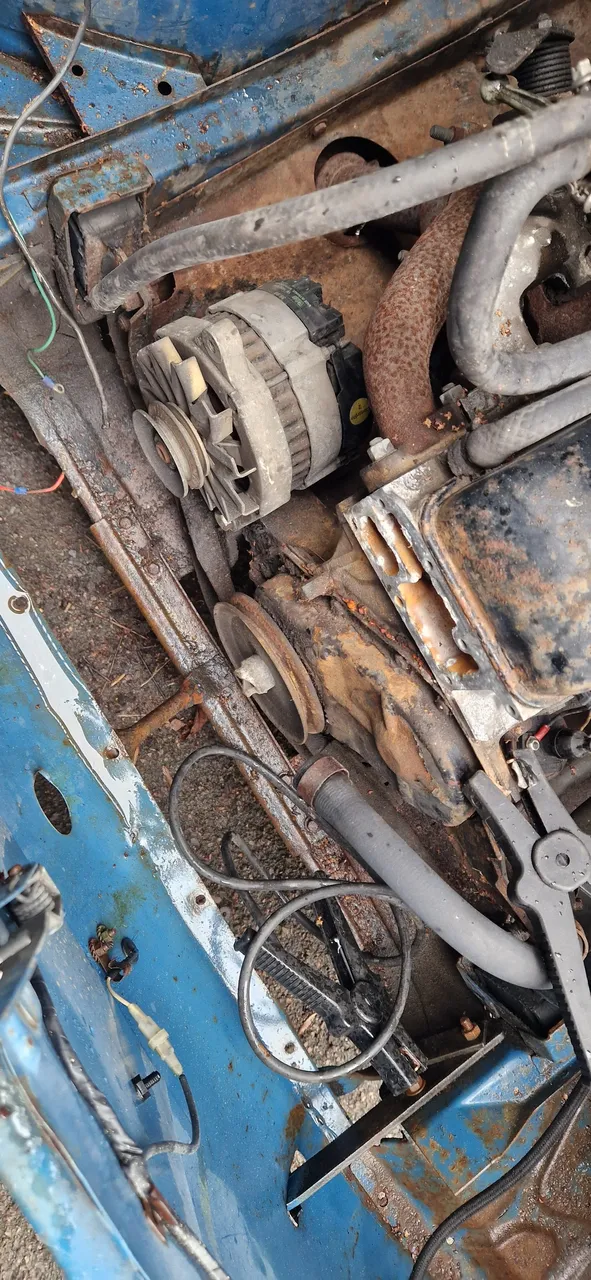

Alternator swap is all on now, finished the wiring this evening, I gave it a quick check and saw 13.6v on the multimeter so ill assume that's working, will check again once we are up and running properly. Rear light bulbs all swapped out too so nice and fresh (could possibly do with new covers in the future.
Hopefully I can wrap up as much as I can tomorrow and i can start making a move to sort the brakes and suspension.

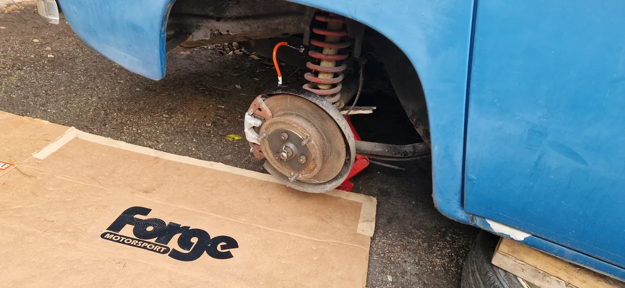

Jacked up the one side today and whipped the wheels off (haven't got any pics) brake callipers are there and look good, lines look like they may have been replaced in the last decade too, nothing looks like I need to worry too much, got the front up to check some lines there and see why there was no fluid in the brake reservoir to find............ no master cylinder. I think I have it in a box somewhere, so maybe its knackered and can be rebuilt or it just needs replacing completely. More investigation needed it think.
EDIT

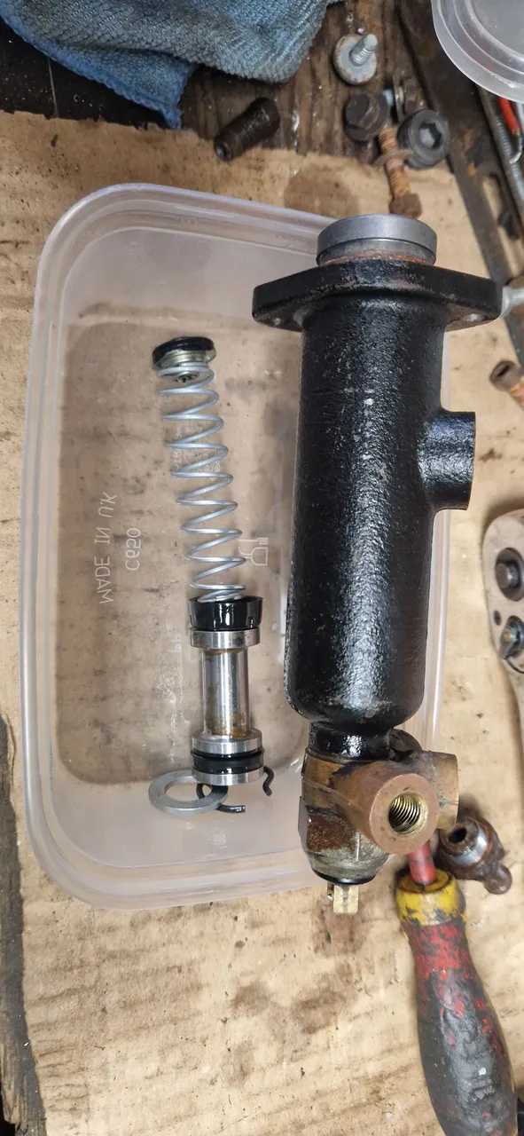

So I couldn't help myself and went and had a look at the MC. Didn't look too bad, pulled it to bits as you do and it looks like its either had a rebuild or is a NOS item.

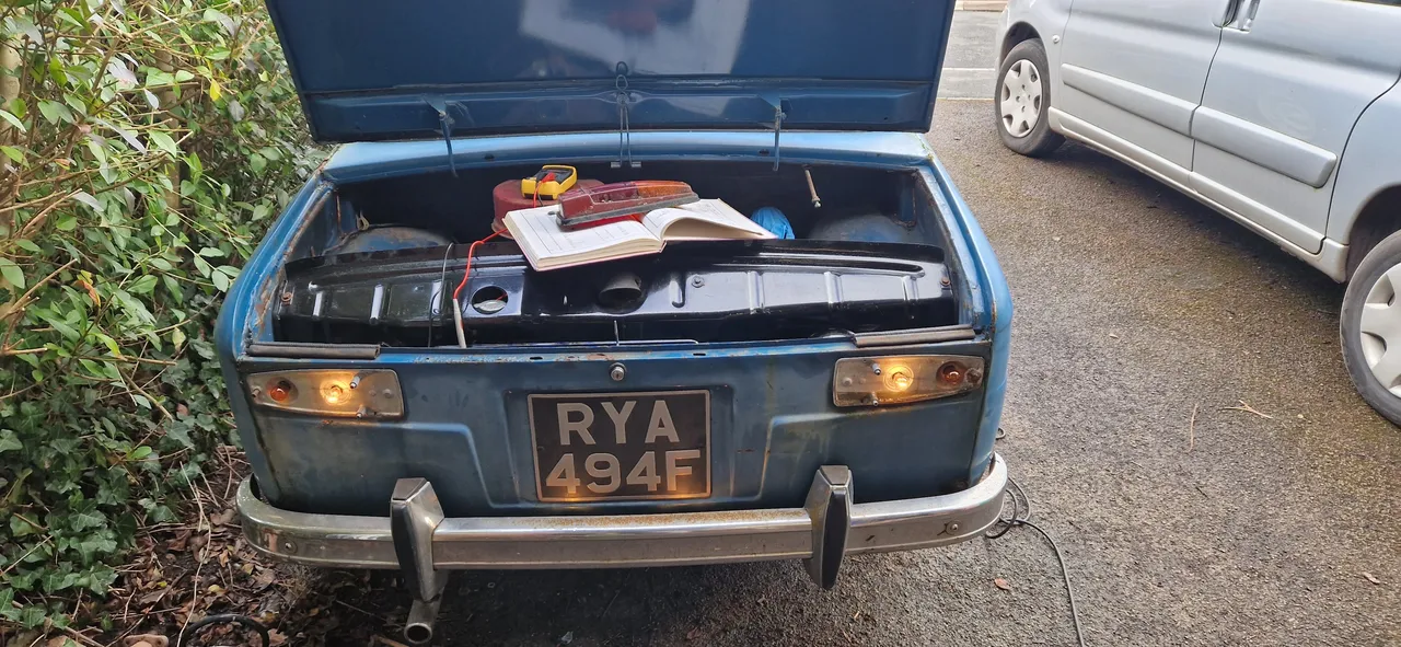

Also, alternator conversion doing its thing. Starts strong too 💪🏻 just need to get a battery that fits the box 👍🏼 no leaks to be seen on the cooling system either.

Right where are we up too. Started on all the brakes. Fitted the MC, new front hard lines and remade some of the rear fittings. Got everything filled with fluid on Thursday and then spent ages trying to get fluid through everything. No joy at all. Initially I thought it was because the system was bone dry but after cracking off some fittings I realised that the brake hoses I hade mentioned earlier as looking ok were actually fucked. Internally blocked. Anyway, a quick jaunt over to HoseTechnik (attached to Forge Motorsport) saw me with a custom set of orange braided lines. Managed to get them all fitted up and the first round of bleeding done. I do think it needs another go as there isn't much feedback on the pedal and it feels a little spongy so ill revisit that soon. Once i was happy that was 90% wrapped up I moved on to the next job.

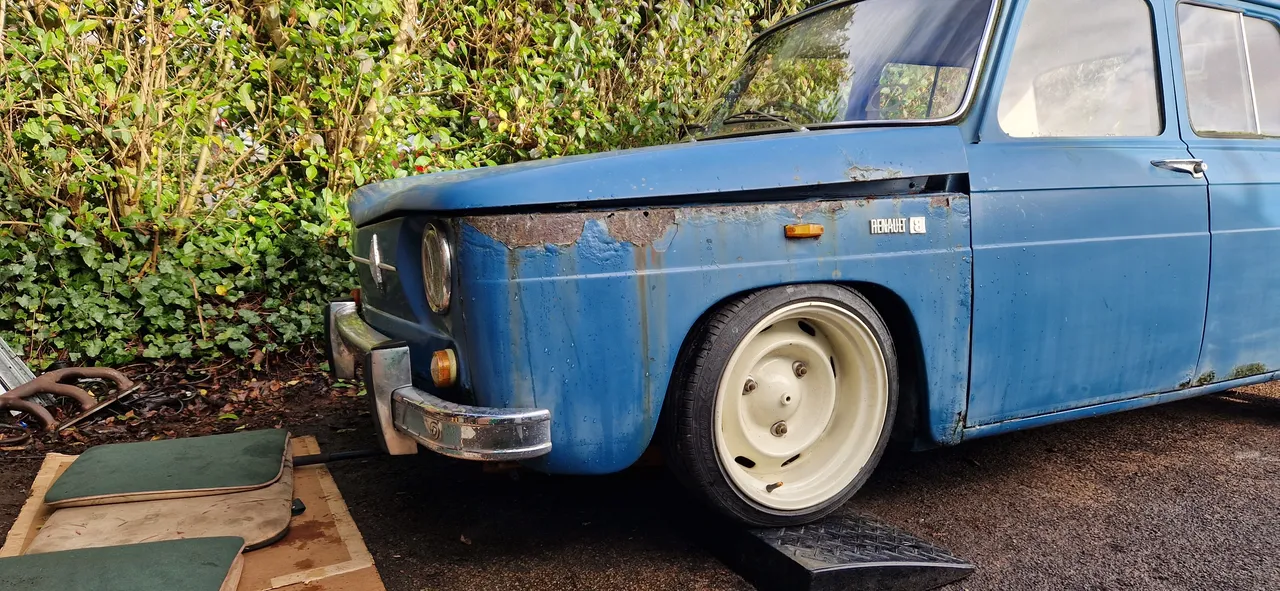

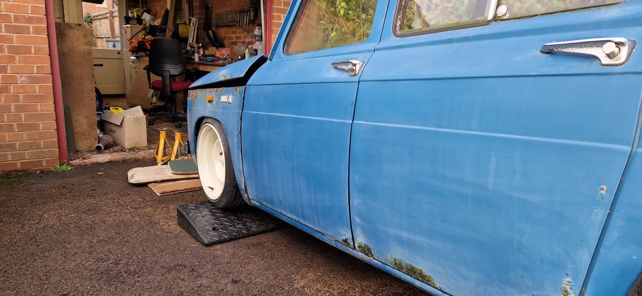

The suspension. Now long term I have some ideas on what I want to do to get the best of both worlds, lows and drivability. Now I used be hardcore static but these days with the amount of shite roads and speed bumps I feel I need the adjustability of air. That's further down the line though so for now we are going povo spec static lows. I needed to get some measurements from it all anyway so did a test with no suspension fitted at all, and resting on the bump stops. It looks cool as fuck tbh (don't care what anyone else thinks or the practicality of it all the car is getting built to go low and cruise) After I got what i needed I chopped the front springs to give me some useable lows. The front is good where it is, bar a little positive camber on one side which I need to address. I've started on the rear but will wrap that up in the next week. Once ive finished the suspension and brakes ill move to the rest of the electrics and we can hopefully start putting some miles on it 🤞
No Suspension fitted

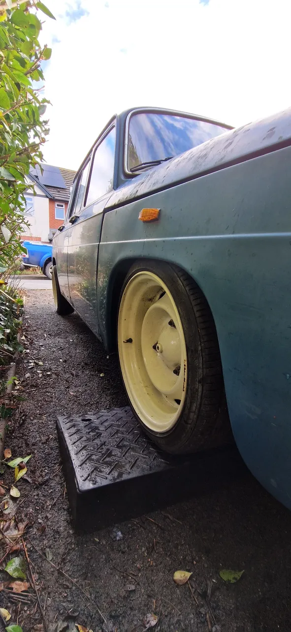

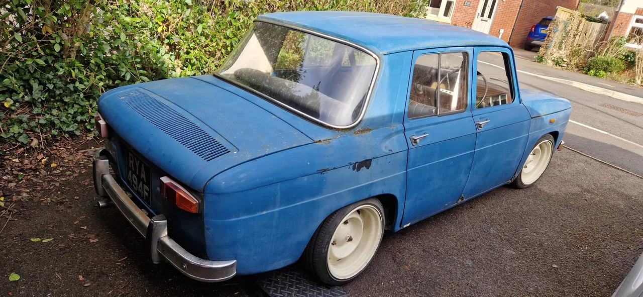

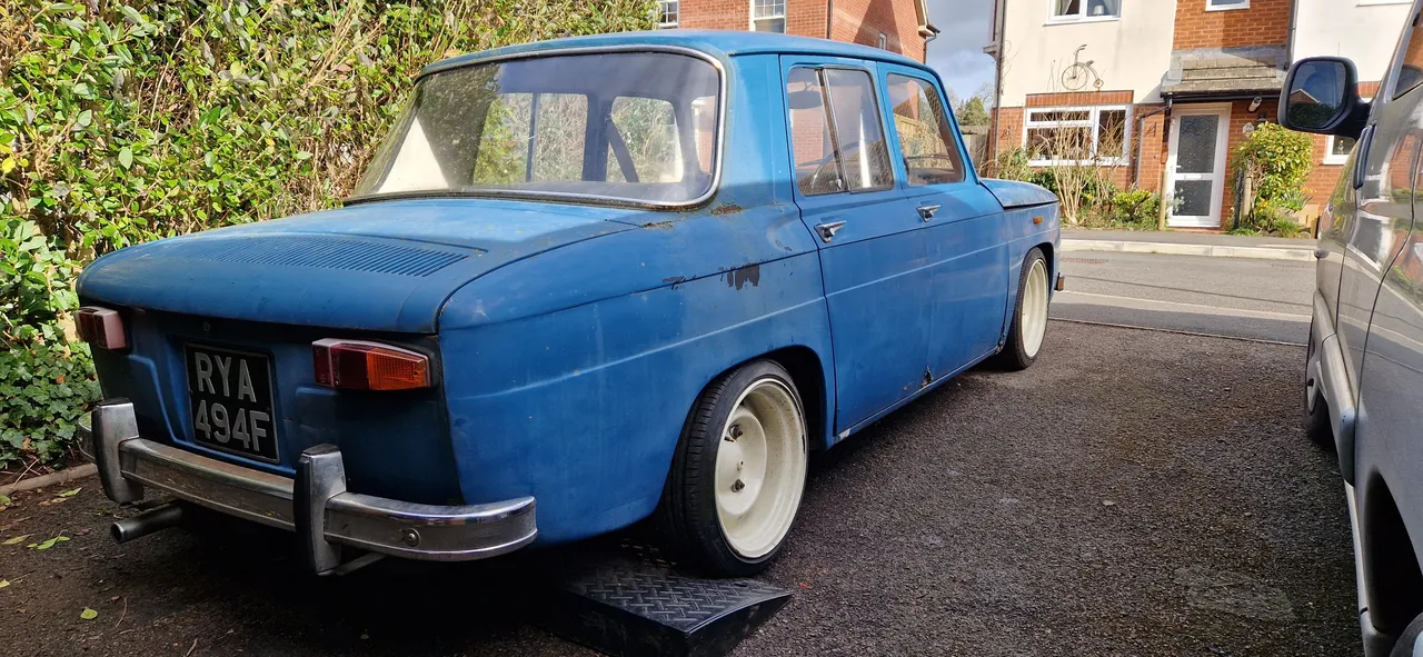

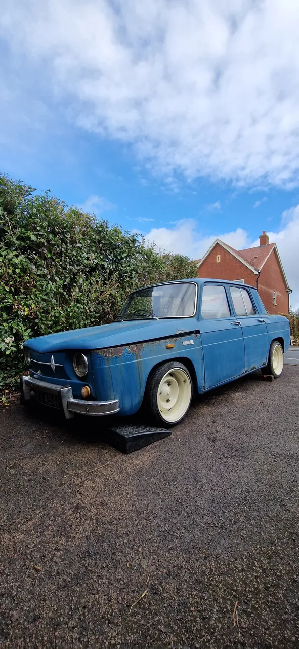

The sun was shining, and I was itching to get back on the 8, so I pulled a half day today so I could finish up on the ride height. 2 hours of messing about but we are there. Not massively slammed but it drives on and off my drive so its good to go in my eyes. Front camber still needs addressing but I need to get a tool made to accurately adjust it. Brakes are also starting to come to life now so ill bleed them again soon. Lots of little bits to sort and finish up so I can start using it. The carb being a big one. It'll start nicely but I think the auto choke part of it is stuck on. Once it gets some heat into it it'll stall every time you touch the throttle, and for some reason when you do tap it, the chock goes fully closed again.
Anyway, here are some pics

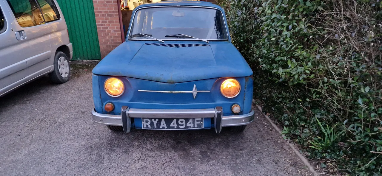

Electrics, headlights are now working, ideally I need a new unit on the one side. Brake lights all sorted. Wipers work as does the interior fan (though the matrix isn't plumbed in) that leaves the indicators to rewire with a modern flasher and the horn to sort.

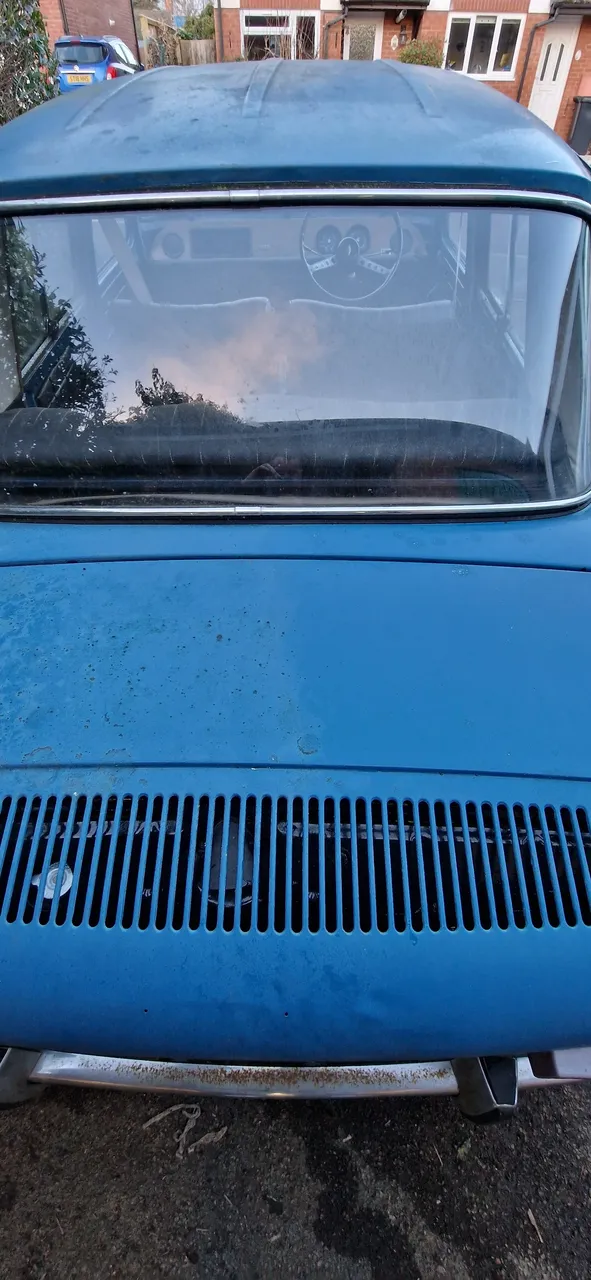

I popped my head out earlier and gave one corner a rub with some citrus pre wash and a sponge, and a quick rinse off. The pictures don't show how big a difference there is but WOW. Looking forward to giving it a good scrub all over. Will still look ropey but loads better than it currently does
