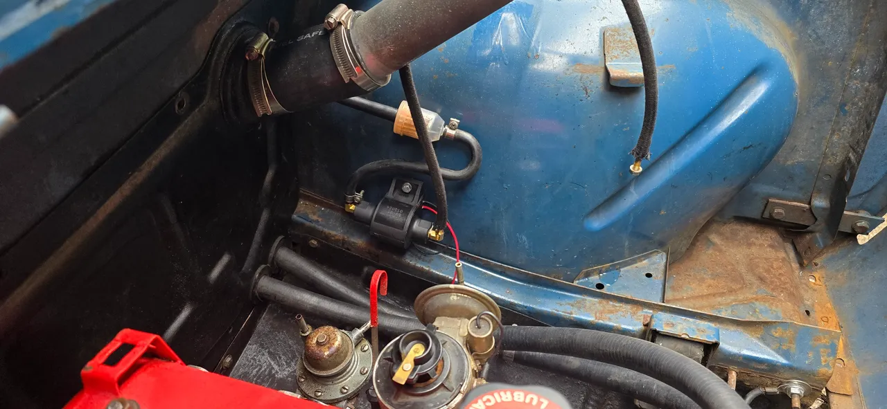

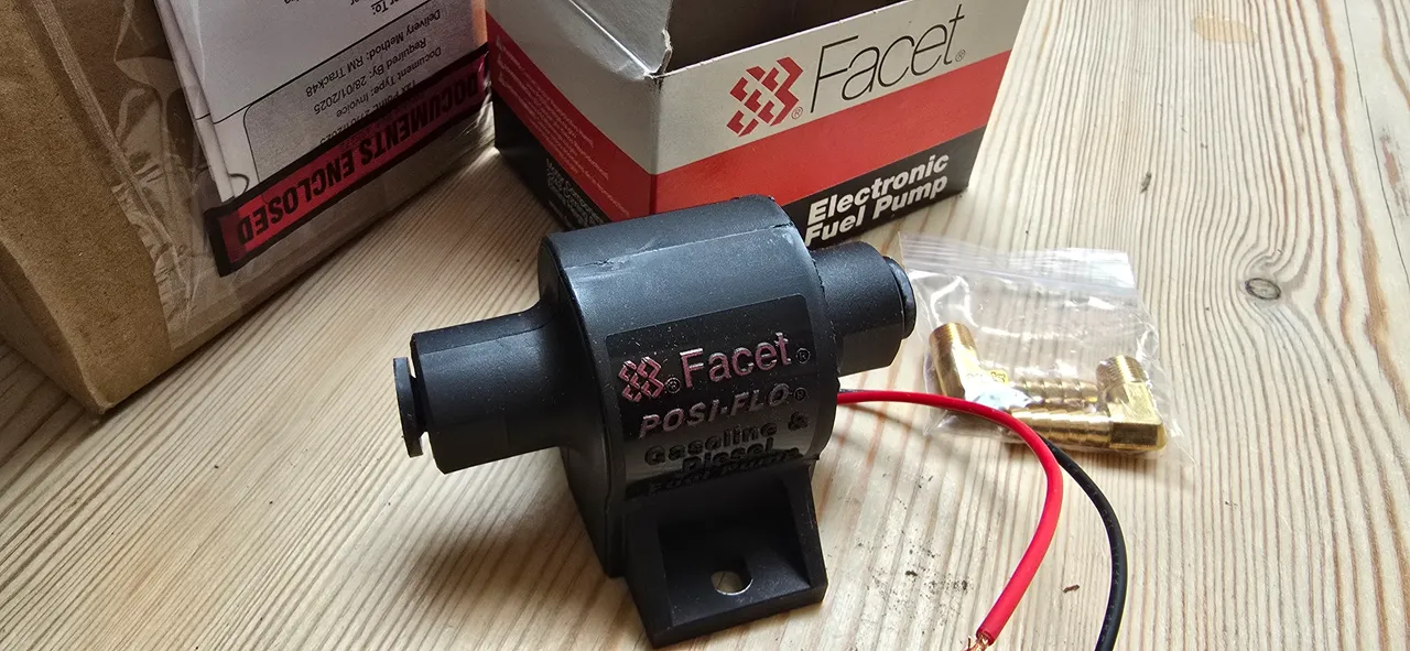

I have received my new electric fuel pump though. This was ordered after my "issue" last time I drove it. Though the more I think about it the more I think it could have been a vapour lock. Either way an electric pump should add a little more resistance to it happening again if that was the case. The car will actually start up and run fine now and I've had it idling for quarter of an hour at a time 🤷🏻‍♂️

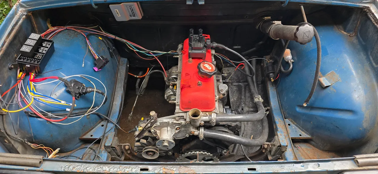

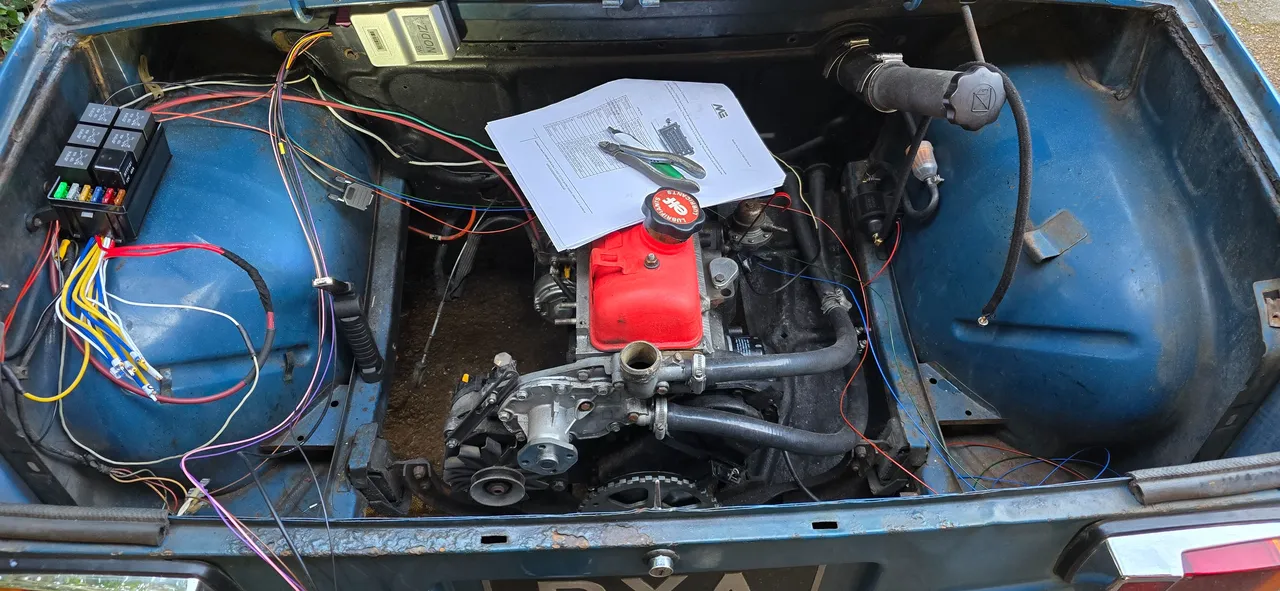

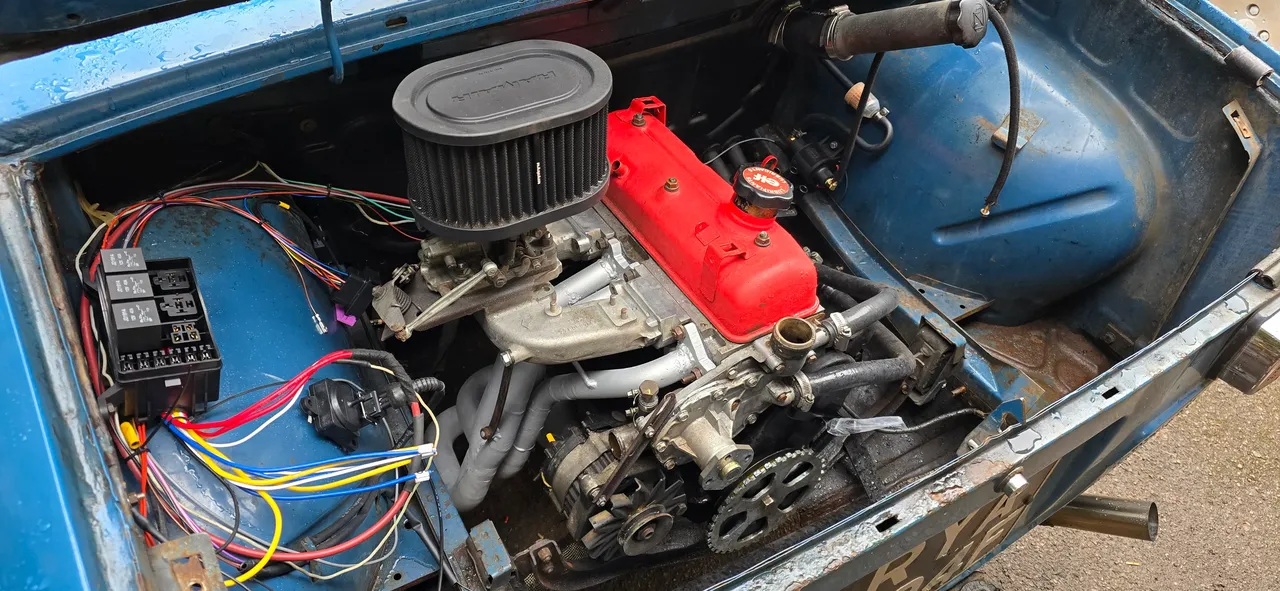

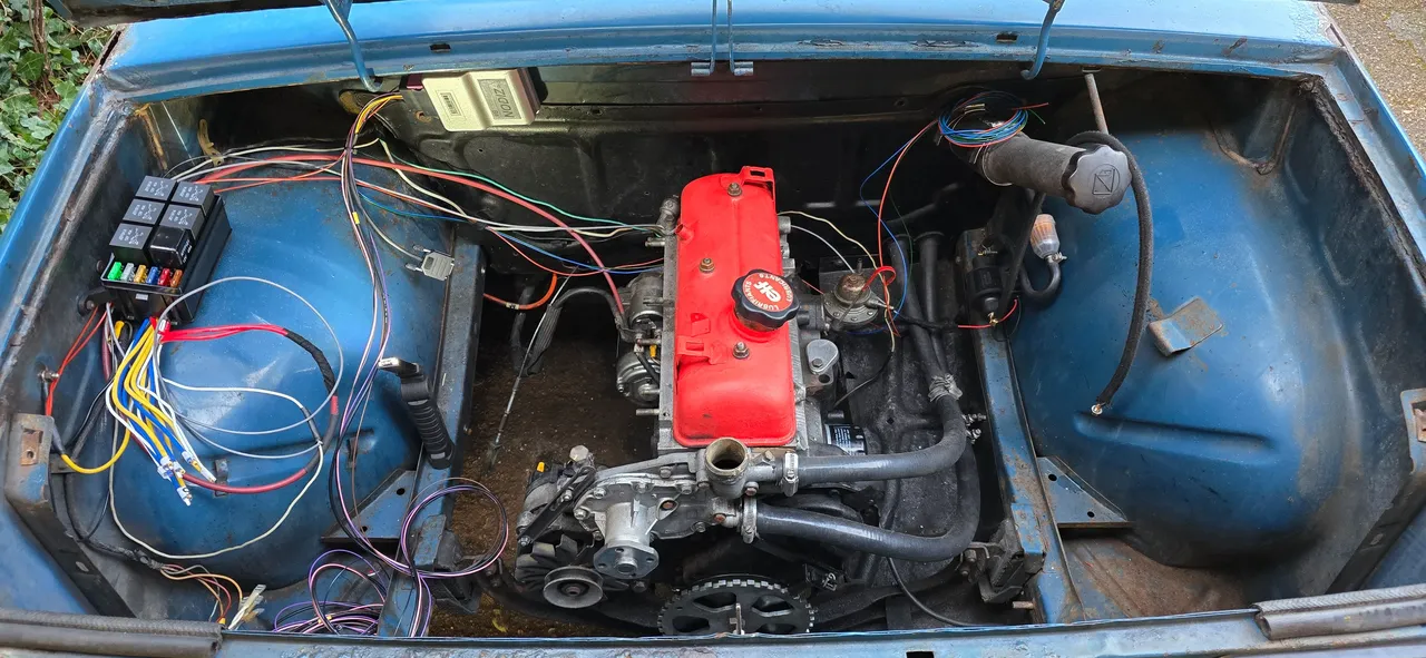

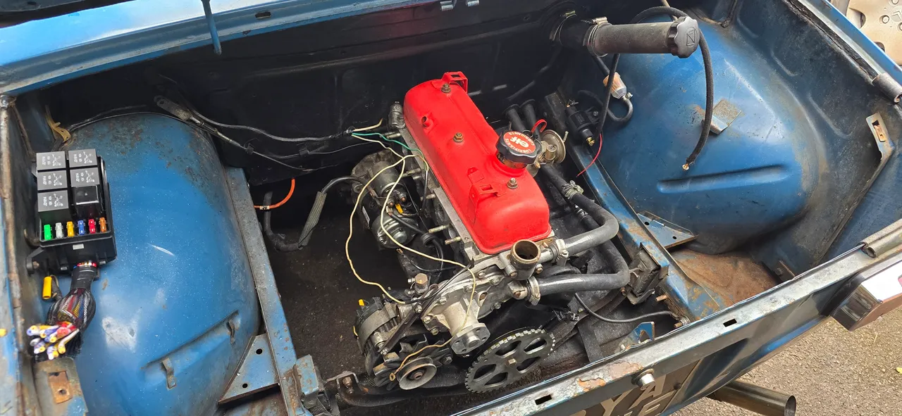

Made a start on the Ignition ecu and conversion stuff. Picked out placements for everything and started mounting parts. Fuel pump is bolted down on some fresh rivnuts and piped up. Got the 36-1 trigger and pickup is fitted and set in the correct place. Then I decided to remove the manifolds for extra access and repair. The exhaust manifold has a slight blow, and the inlet could do with a few more tweaks. So why not do it all at the same time. I'm actively stopping myself from pulling the head off and getting a cam in there too......

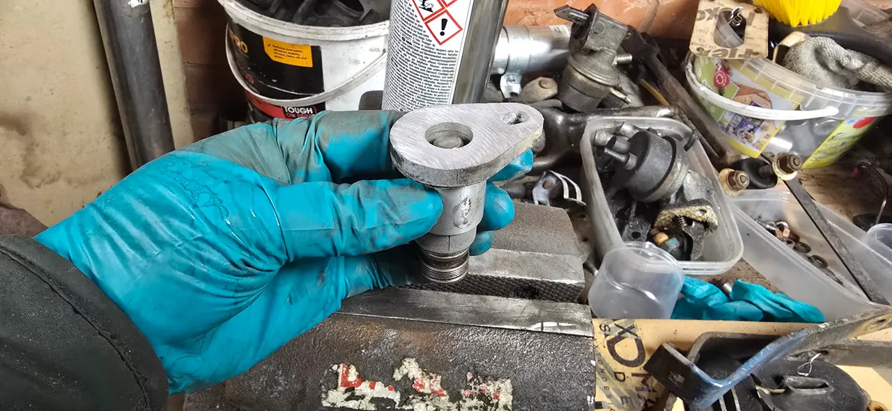

One of the other bits I wanted to remove was the dizzy, it pins the gear to the top of the oil pump so just removing it could be catastrophic. I did post on the R5 Gtt FB groups asking if any one knew the way to blank it off correctly to be shown them still in place but with a cap on. People had just left them fully in place when running standalone. Not good enough for me, I chopped a dizzy down, inspected it to make sure it wouldn't fall apart and would work as intended still (bar driving a distributor) then made a quick cover from aluminium. Job jobbed.

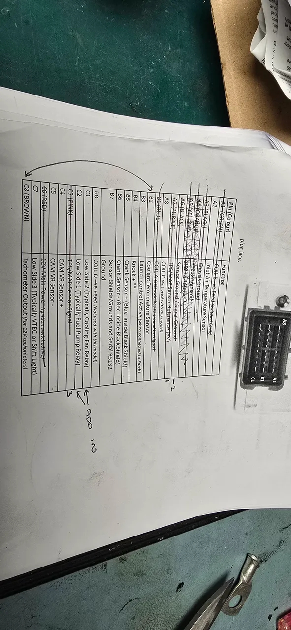

Made a start on the wiring side of things this afternoon, roughed out most of it in the correct locations. I don't think making it work will be an issue, making it look tidy will be though. Once I've got everything working properly I will go back and unwire everything that isn't needed in the fuse/relay box so there isn't an excess of wires hanging around.

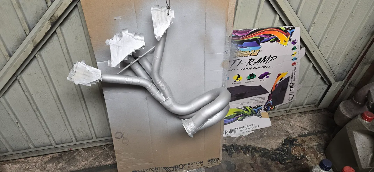

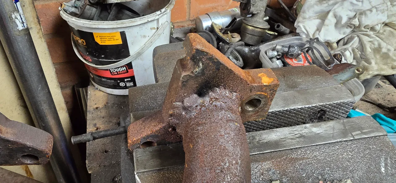

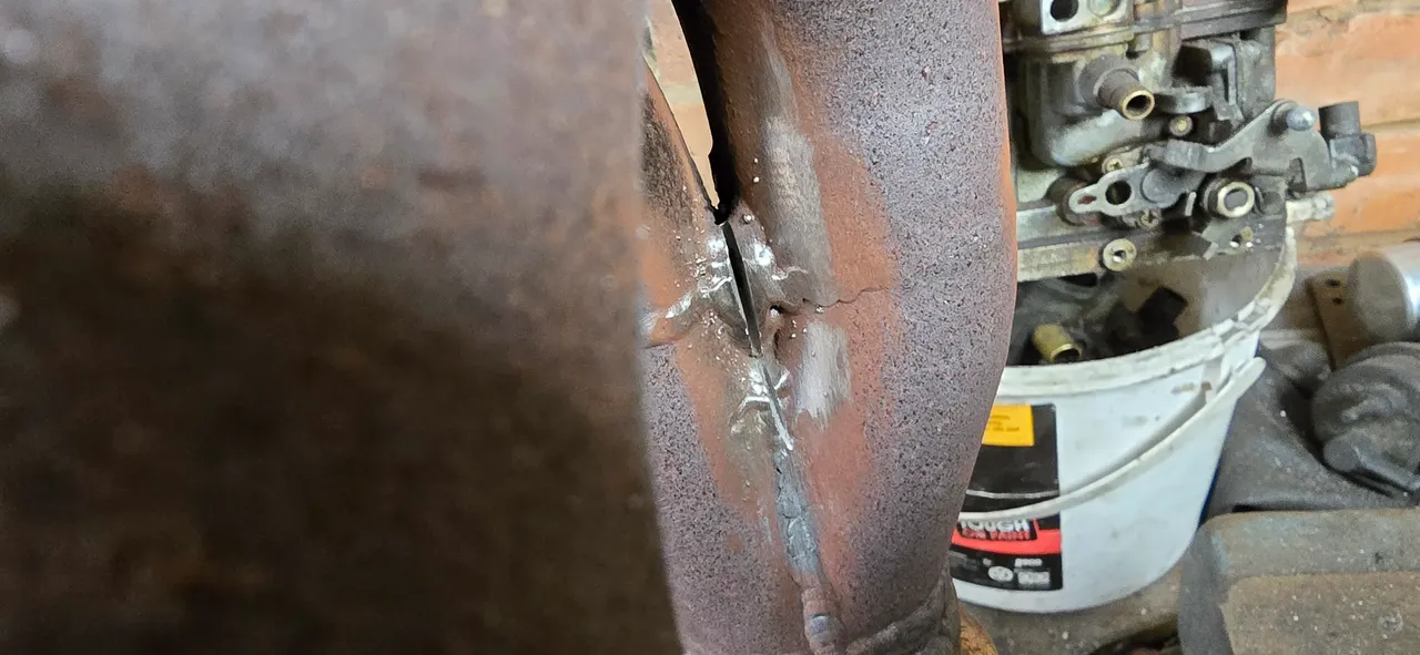

I made some Pidgeon shit repairs to the manifold. Was able to see the small blows of black against the mild steel colour, so did my best to repair them. Drilled or cut out where there was an issue and puddled it back together. Gave it a lick on jenolite high temp paint, hopefully it will protect it from the UK weather and damp.
Manifolds are back on so I can see what space I have with regards to sensors and wire routing. Also confirmed the switched ignition live it working and switching the ecu/coil feed on and off through the relay box (y)
All in all a good weekend and all being well I should have the extra ecu pins in need in the week. I can then get it to a "test" stage in the conversion.

Anyway pull the ecu and do the same on the bench, sure enough the ecu is showing continuity to ground through one of the coil drivers.
Seemingly I have a dead brand new ECU. The issue with the misfire creeping in as the coil heated up.

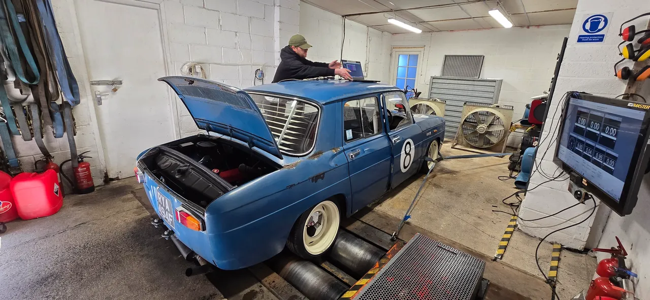

The replacement ecu is on and we are running very well. As its running a base map it didn't take too long to set it up again. Managed to get out and about for some testing and all is good so far after completing about 10 miles. Need to get some more done this week before mapping on the 28th
So a little wrap up of the day. Top line power mapping resulted in pretty much the same peak power it already had (high 60s low 70s), all the bottom and midrange stuff was where we gained everything and not just on full throttle.
Driveability is hugely improved and the engine itself seems quieter and less stressed, even though its doing more as such. As soon as you touch the throttle, even lightly, its very willing to get up go vs the old dizzy setup.
I'm calling it a win, peak power wasn't my main concern, though its always nice to have more, but I'm sure we can address that in the future..... for now, ill enjoy it 😁

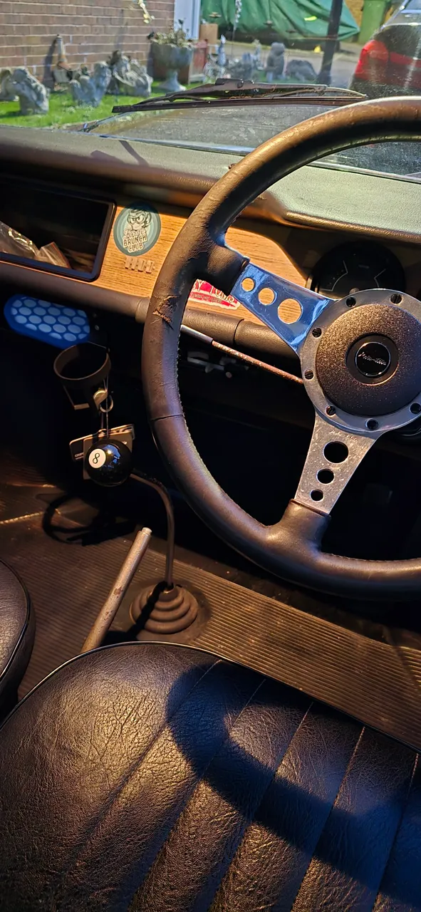

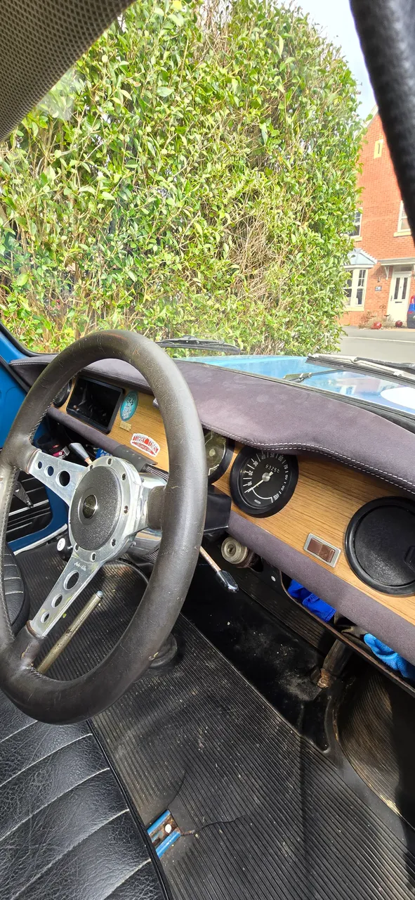

Little update on the interior of the car. Gone for an 8 ball gear knob (matches the name and the 8's on the outside), ended up drilling it to suit and then using some epoxy resin to fit it in place. Happy with that.
Also managed to bag some Alcantara covered dash trims and top. Covered by cobra seats for a friends car but he opted not to fit them. Dark grey with silver stitching.

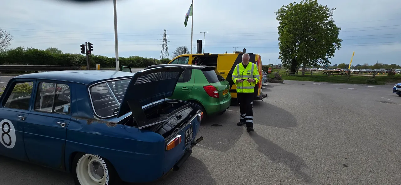

Started fine and I got a full English in and then off we headed until karma got me. At a set of traffic lights, joining a dual carriage way the chap in front of us stalled, we had a little chuckle as we waited patiently then a more laughter as the car seemingly kangarooed and just as the lights were turning red, it went. Not in a huff more slightly amused we blatted past in the outside lane. About 400meters down the road the car bogged every time I touched the throttle. Urgh, no biggy, coast into the local farm shop. Quick look over the car and I cant see anything major wrong. Using the AA app I request recovery. It was going to be a few hours, but luckily we are friends the people who own the farm, so off for a quick coffee and the farm house.
AA quickly pushed the time out so I opted to go home, get some kit and the laptop, and give it a proper going over. Now I could get the car to idle but only just, the carb seemingly squirting fuel when asked of it, so in my head a sensor had gone down. Laptop plugged in showed no issues, all the sensors were showing acceptable readings and it was syncing up fine. I started to wonder if the trigger wheel had slipped so went into checking that. plug out, at tdc and eyeball it on the pickup, again all fine.
It was then I noticed the pump wasn't as loud as normal when priming. Annoyingly I currently have some sort of ear issue, so hearing wasn't the best anyway. I used the laptop to put it into test mode, it was making some noise, but on removal of the carbs fuel feed, nowt was coming out....
This coincided with the AA arriving. We had a little chat, he looked at and said id know it better than he would and discussed towing it home. He pulled out a little hand pump device so we could see if the tank pickup was blocked or the pump was buggered and we were able to check draw through the pipe work all the way through to the carb so that was good but we were now talking about if it would be fine freewheeling with the engine and box being in the rear. As I was putting it all back together I jokingly said have you got a hammer, we can give it a clout. Set the ecu to run it continually, held the main feed over the carb inlet and "whack" all of a sudden the noise changed, and it filled the carb to the brim..... not ideal but it was working!!!!!
So out with all the plugs and cranked to empty out the excess fuel (didn't want to hydro it on petrol) back in and fired up. Ran lumpy whilst chugging black smoke for about 30 seconds, but a few blips of the throttle and she ran sweet again. Mr AA man followed me about 6 miles home and it ran sweet as you like. Ill be ordering another pump as a back up. Looking at the first bit of fuel we pulled through I think the pump has had some crap get into it, its the lowest point in the system and I think some sediment had made it through to there.
