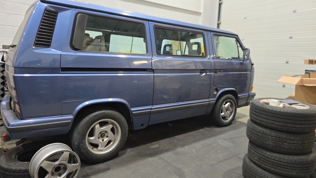

Well, I had a bit of a fettle on this on Saturday. I went to fit the new front discs, but Autodoc sent the wrong ones. Early discs listed as suitable up to 1990.... So I had to refit all the old stuff! What a ballache!

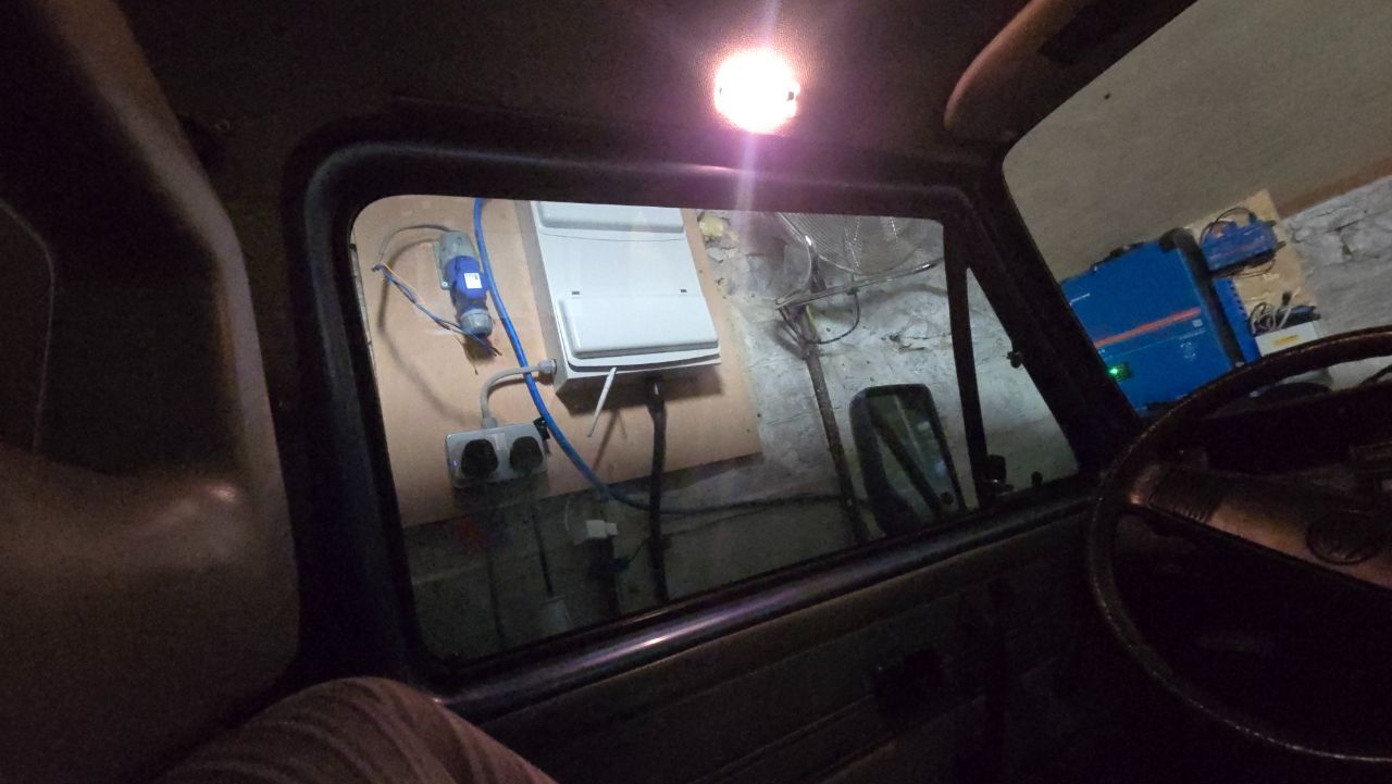

I was mithering about leaving this parked in't rain all winter, so I was eyeing up spaces for it, maybe a shuffle round at work etc.  Stroke of luck though, it *just* fits in the garage at home. With both mirrors folded in there's an inch to spare on the sides. If you drive it in til it hits the back wall, the door closes with an inch to spare against the towbar. You need to put a bit of cardboard on the roof to protect it from the garage door opener runner.
Luckily I can still access the consumer unit by winding the drivers window down.
It'll be tucked in there most of the time now, I'll get it out a week at a time til, they salt the roads I'll SORN both this and the pickup.
In typical "G691SAA" style it has kindly repaid my efforts at repairs and finding it a warm, dry space for the winter.... When crawling into the back of it, I put my hand on the carpet in front of the back seat and found it wet through. It's popped the rear heater matrix under the back seat 🙄
Luckily I've not yet ordered the correct brake disks so I can add a heater matrix onto the regular twice weekly brickwerks order.

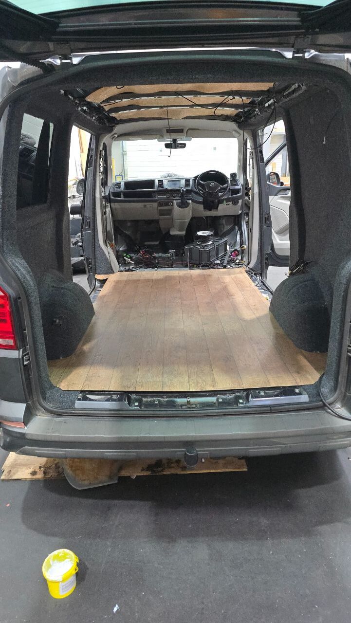

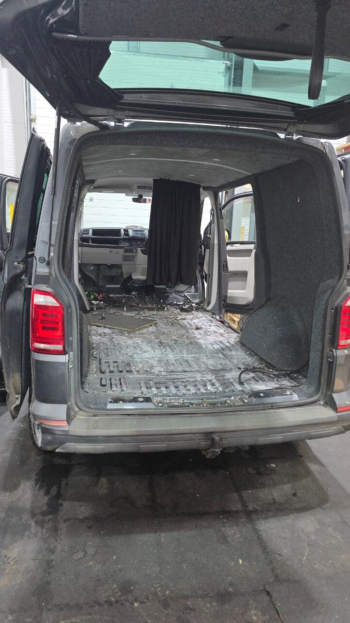

I went out camping in it last night, this morning nipped in to work and gutted it.
When I took the sliding door step out, there was a good inch of water!
I hoyed the bed and all the units out, ripped up the floor and here we are: What was a nice cosy camper quite quickly turns back into a bare van:#image.jpeg.5e20b1baf534496a460a8a64d76717a4.jpeg
Cab carpet is hung up on the wall at work next to the compressor to dry out, the subfloor is ready to go on the bonfire -  look at the state of it! Thiimage.jpeg.c1319cc14044cee1469d447e65fad12e.jpeg
While the thing is apart I'm going to do a few mods - fit another window in the back passenger quarter (it was a bit gloomy in there) and replace both the shitty OE VW side windows with some knockoff aftermarket ones that don't piss gallons of water in, and redo some of the lining carpet.
Tomorrows task is to clean and disinfect all the van floor to get rid of the damp smell, and probably cut a massive hole in the side of the van ready for the windows turning up next week.

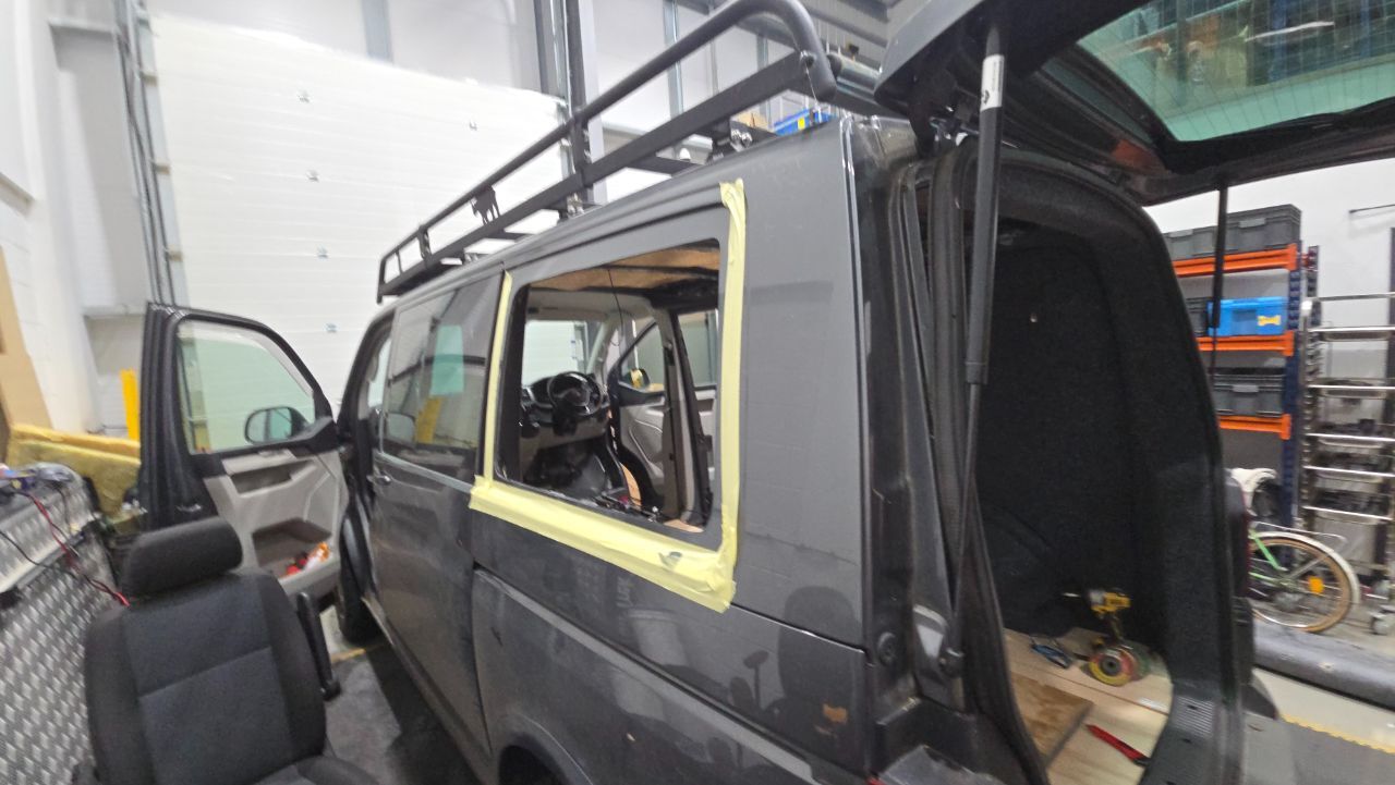

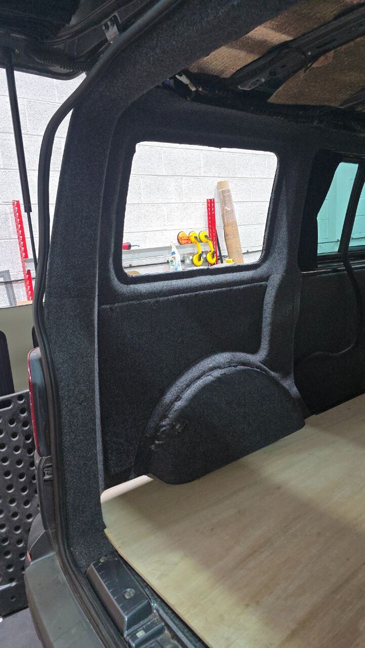

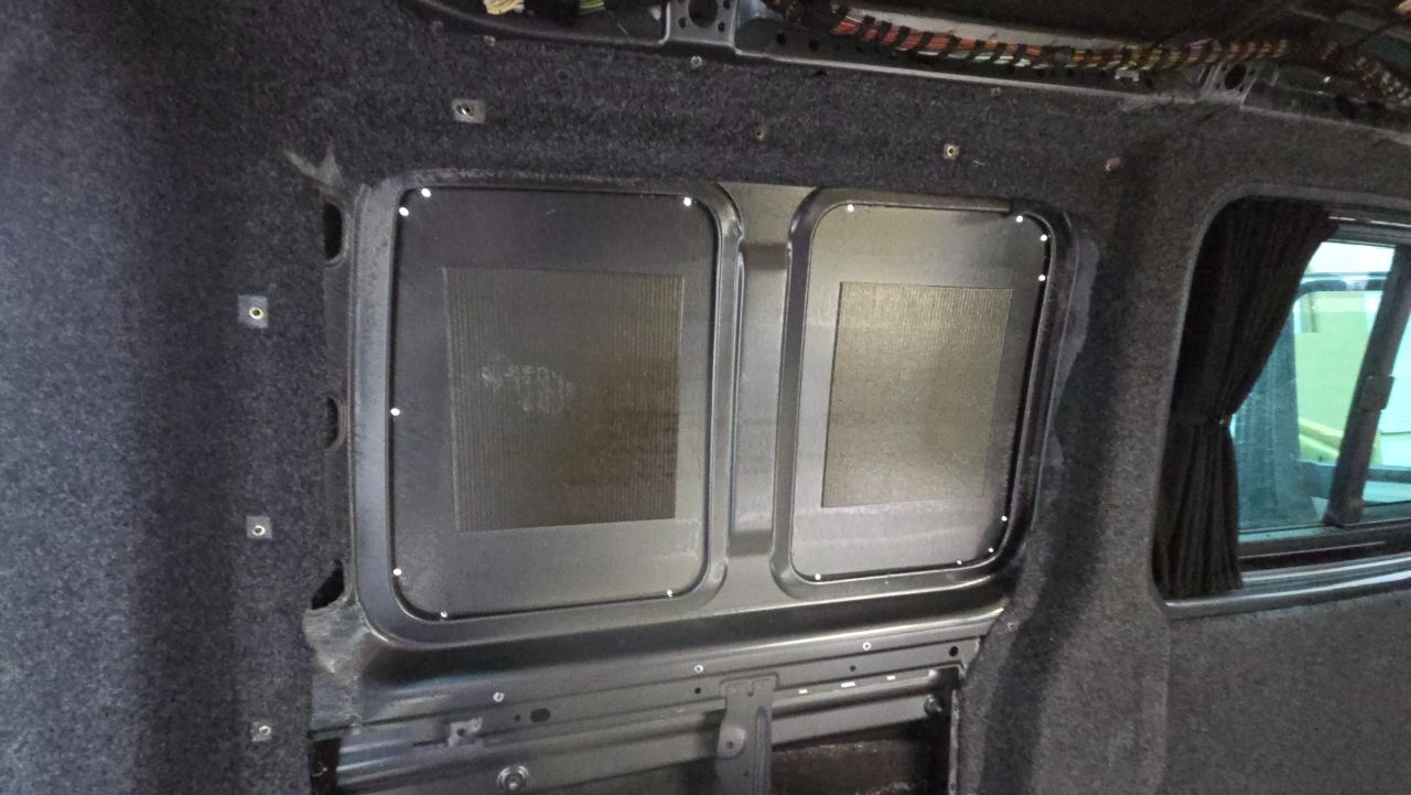

Cracked on with the T6. added an extra window. This bit is a lot more nerve wracking when you're doing it to your own van - I must have done 20 in the past and never once spent 15 minutes working up the balls to send the first drill through 😂
I pieced in the lining carpet - it's an offcut from the same stuff I used originally, but you can see the join (the stuff in the van has faded a bit). Was I going to line the whole thing out again? Absolutely fucking not.
The new stuff will fade to match sooner or later, and once I've fluffed the join up a bit it'll disappear a bit more. While I'm making excuses, there are creases in the wheelarch, but it's not really seen (the jack bolts on and hides them). Again, not doing it again. Fuck that!

Neat work. Fortunately, my 5.1 already had enough windows fitted for my liking, when I purchased it. I'm in the process of lining the back of mine - did you use screws to fix the lined panels in place?
Ordinarily I would use black countersunk self tappers through the carpet to hold the panels on, they sink in and become invisible. On this van, I have put m5 rivnuts in the original trim clip holes and used fancy black stainless screws. I fancied a change. Not sure if I'd bother doing it again.

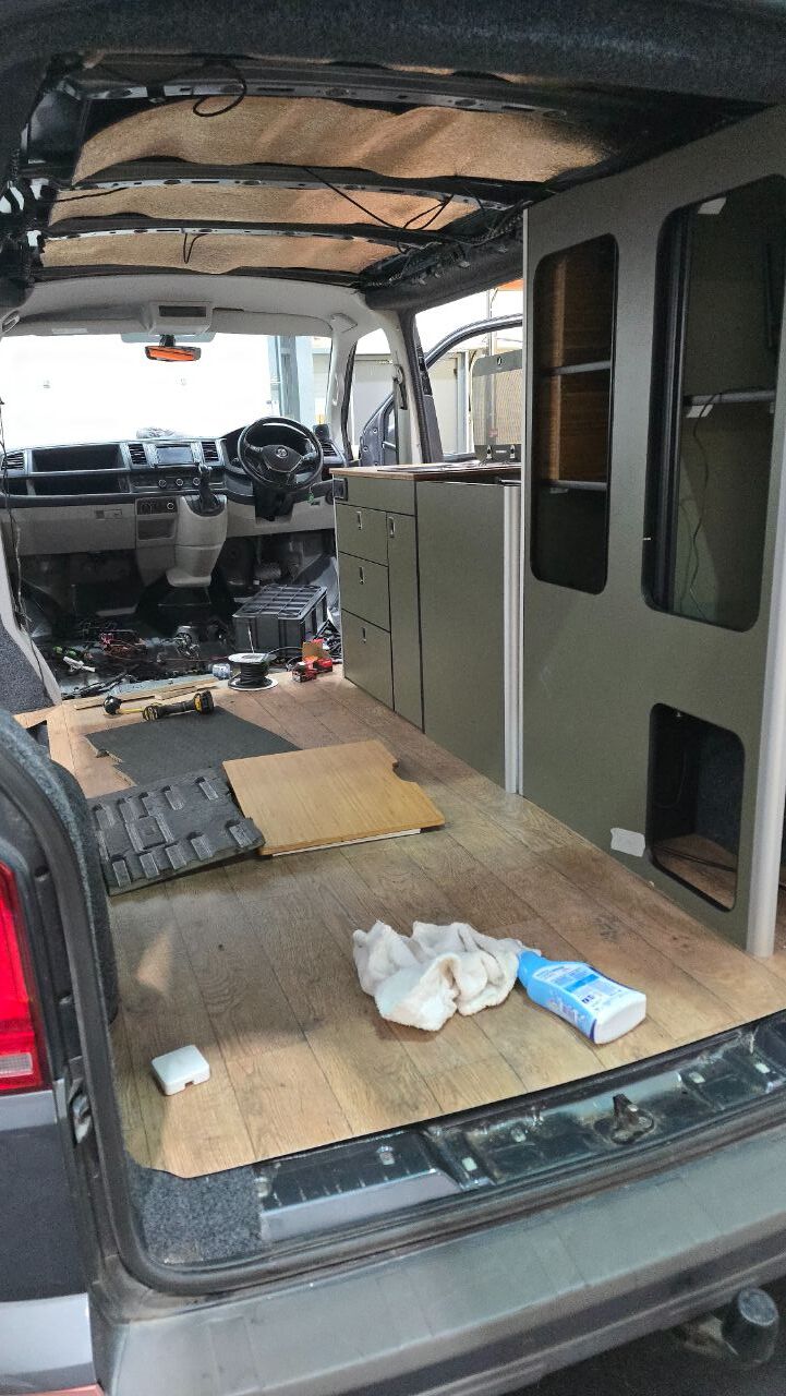

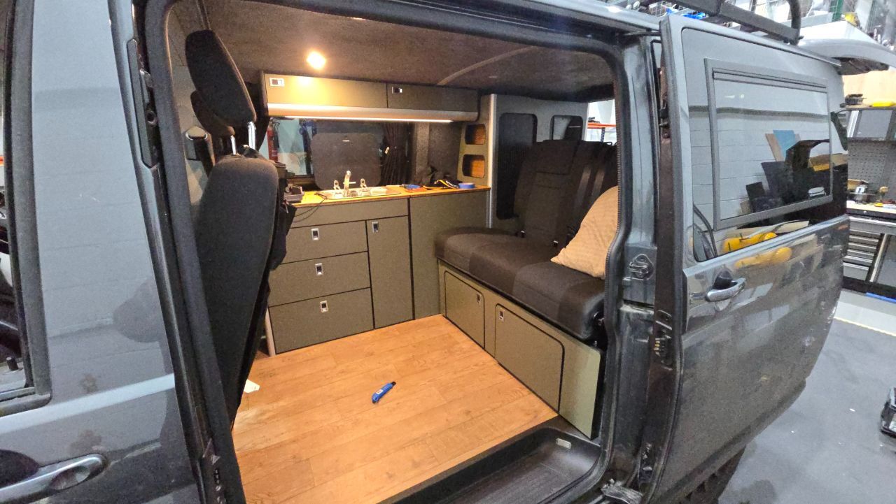

Insulated the floor:
Fitted the plywood and some heavy duty altro flooring that's a bit less gloomy than the old stuff. Since it was black, it looked filthy all the time.
Plonked the cabinets back in:
And the bed:
I didn't bother with the back bed board. It had never really fit very well, the frame of the bed obscured the door so it was useless. That's a heated massaging footspa on the drivers side under the bed 😄

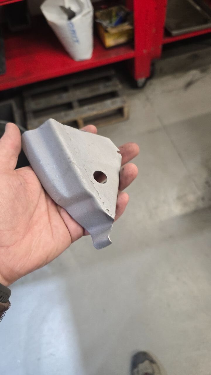

This is the cause of all the damage:
The duct for the diesel heater, comes up through the floor under the passenger seat. The undertray was cracked, allowing water to splash off the wheel and get up there. One big puddle at speed smashed a hole in the duct, and whenever I drove in the rain, a small amount of water found it's way inside...
I've replaced the undertray, and replaced this vulnerable bit of pipe with a silicone boost pipe type elbow, so hopefully we won't have a repeat of this!

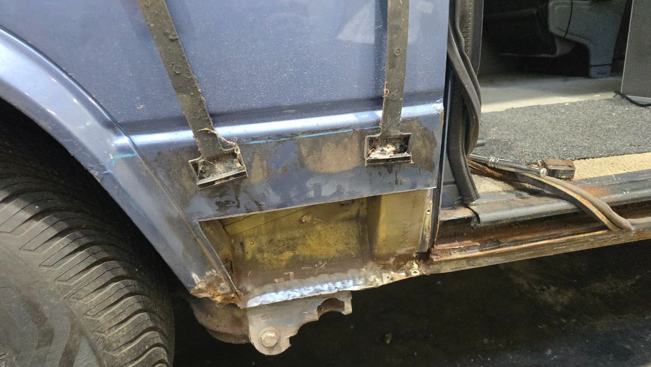

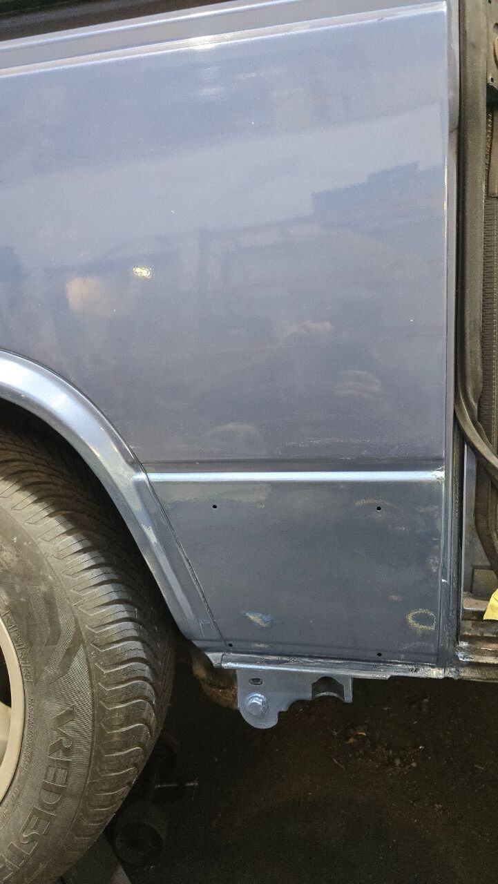

So I bought a £70 full rear wheel arch just to cut 4" off the front of it. And it was a shit fit anyway and needed a 10mm wedge cutting out to make it line up properly.
First I welded the arch piece in, did some minor repairs to the sliding door seal channel and got it all weld-primed inside and fitted on. It went OK, only minor warpage but luckily it sank (like it usually does) so a light skim of filler did the job.
A few coats of paint and here we are
I'm very happy with that. Will let the paint harden overnight, run a bead of tigerseal up the seam (and seam seal all the inside arch stuff) and refit the trim brackets and sliding door tomorrow.
Still amazed by how good the colour match is considering I matched it by eye to a photo

1 hour ago, cobblers said:
3:30PM new years eve I was passing Halfords and on the off chance, nipped in to see if they could mix me a rattle can. Obviously it's 18 years since I worked there and they don't mix paint anymore, and obviously they didn't list "VW Star Blue" in the chart.
I eyed up various cans on the shelf and ended up with "M3-470" - I didn't expect it to be particularly close, but I wanted it to at least be blue.
Anyway, it's absolutely spot on - If I'd bought the exact colour, I don't think it'd be any closer:

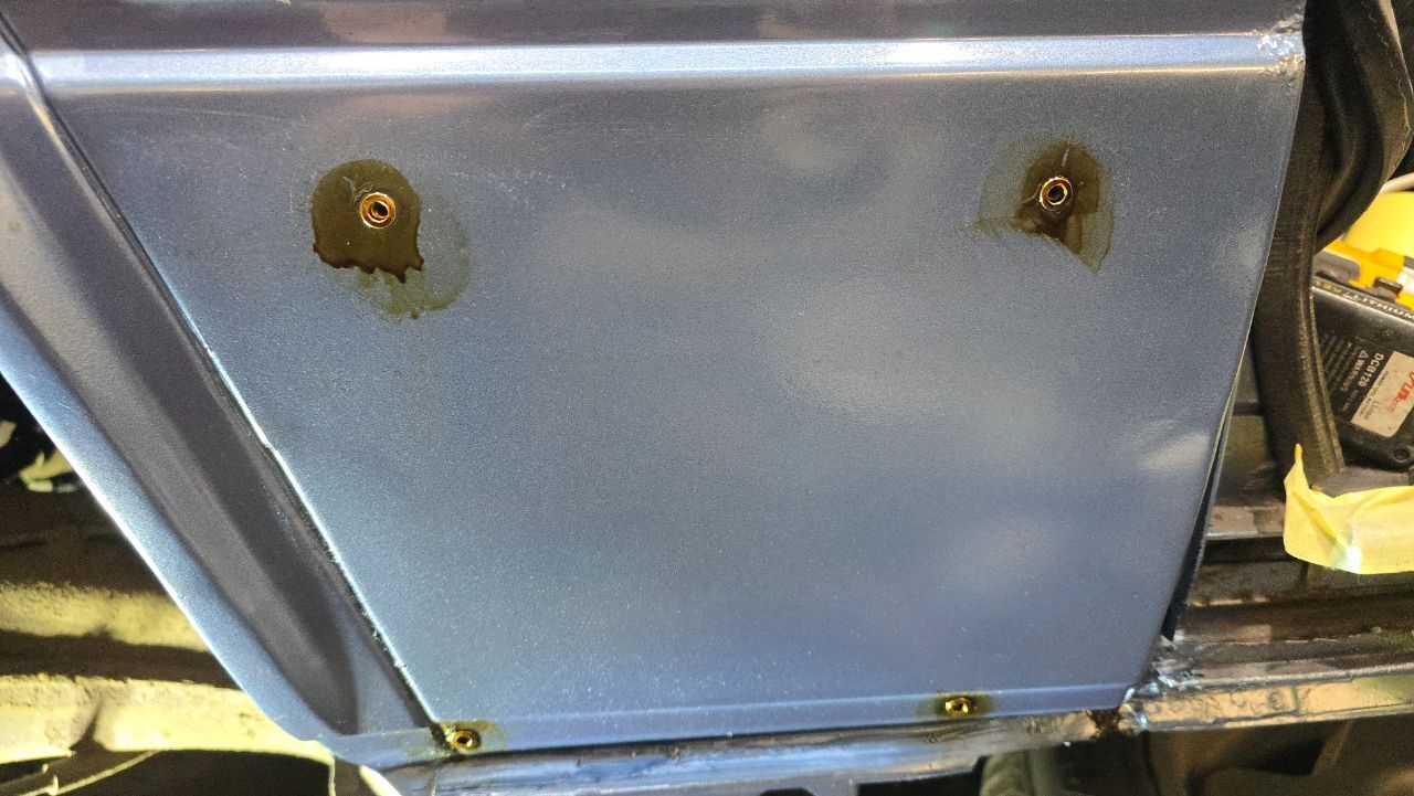

Rather than rivet the side trim clips on, I put some m4 rivnuts in. Spaffed gallons of dynax in and around everywhere, you can see it all dribbling out onto the sill.
I left that bubble at the top right on purpose (I wasn't sure if the paint match was very good) but I will probably go back and touch it in.

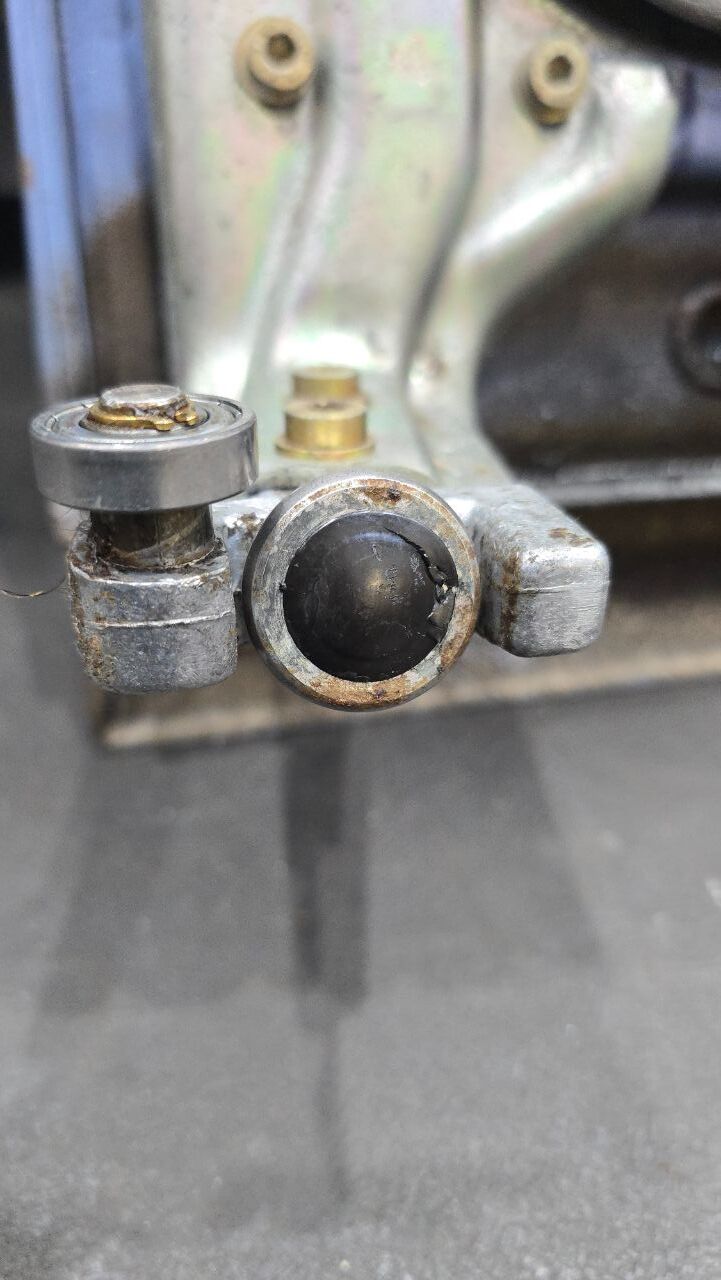

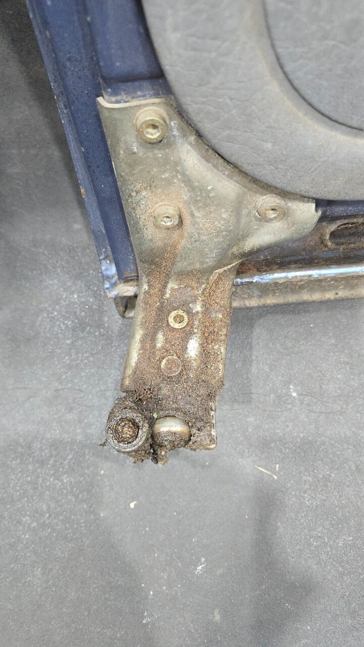

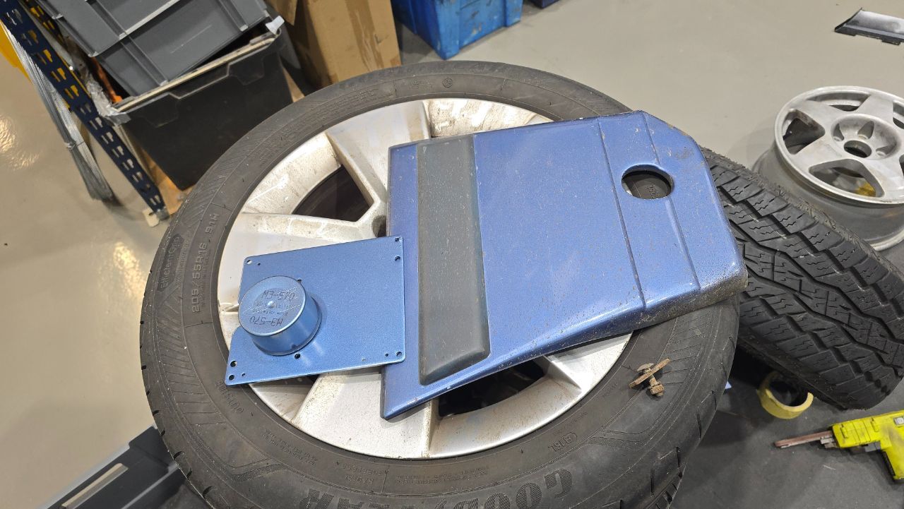

Sliding door runner was absolutely bloody minging so before refitting the door I cleaned it up. Bearings are fine.
I was going to replace the bearings - they're 608Z which we use at work and I have approximately 12,000 of them. But truth be told they were absolutely fine, so I just left them be.
All back together. A lot of work for something totally invisible unless the sliding door is open and you crouch down.

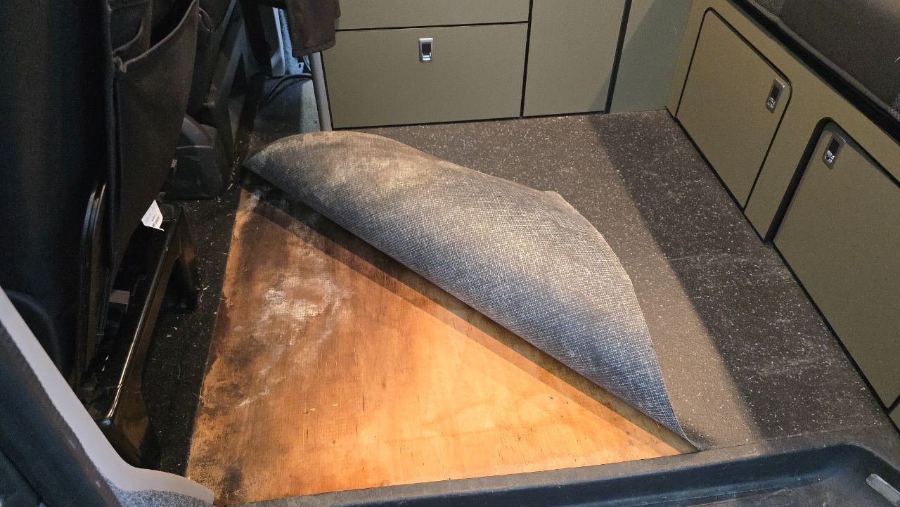

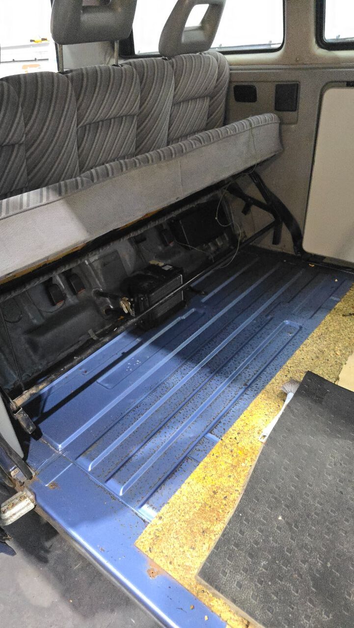

I was going to do this the other day but I didn't get round to it - I'd noticed the rear carpet was slightly damp when I kneeled on it, despite the van being stood in the garage for weeks. Lifted it up and there was red coolant under there.

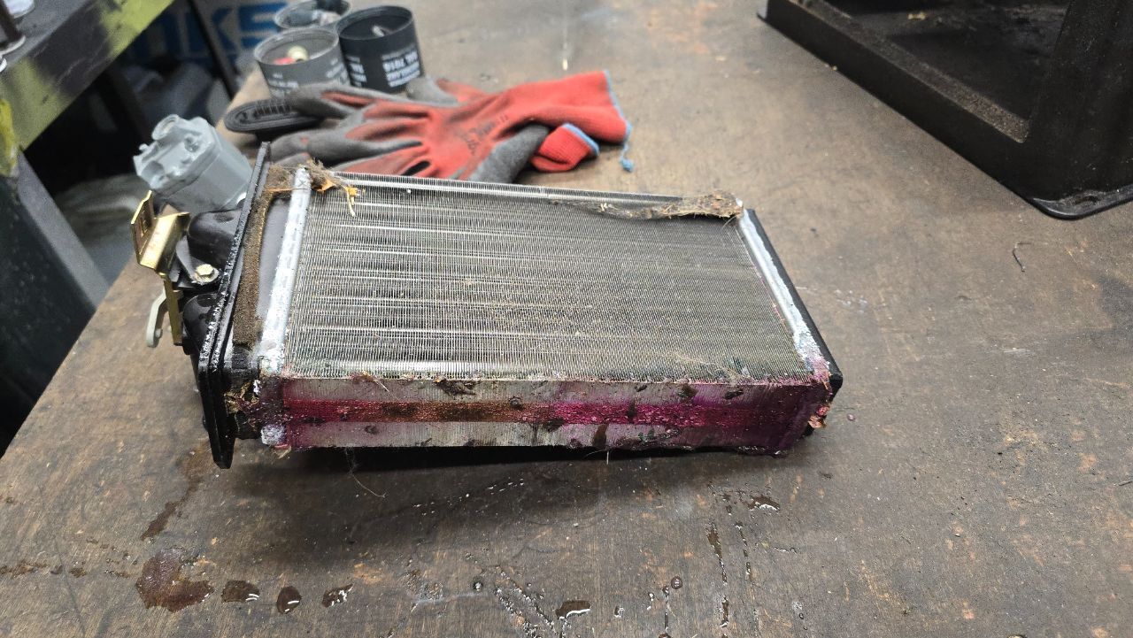

These have a heater under the back seat, the matrixes leak and there's a valve (which isn't connected to anything) which leaks, too. The one on my other van exploded and sprayed hot coolant on my legs the one time I sat in the back of the van!!
Matrix is leaking and fucked, and the O ring on the valve is totally hard and flat, too:
New matrix fitted, I've pulled the cork underlay up and left it out to dry, and cleaned all the floor up (it was quite minging with 37 years of "under the back seat" detritus). I'll leave the ozone generator in there for 20 minute before I leave today.
I'll leave it all apart for a week or so, and properly wet vac the carpet when I remember to bring it in with me. The backing is a bit fragile so I don't want to take it out and nail it on the fence and jet wash it like I ordinarily would!
