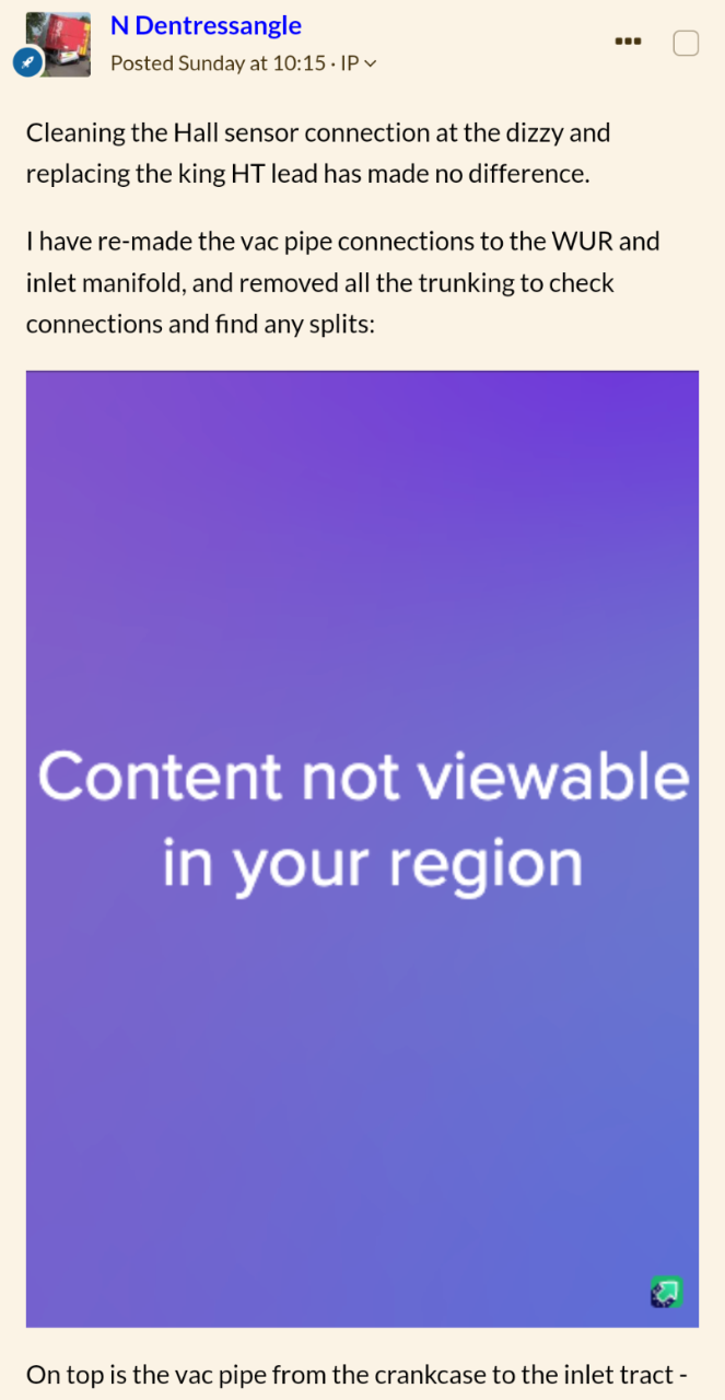

Thought it was just my phone being it's usual glitchy self earlier, but this is the same on my desktop.  Apparently Imgur is now blocked in the UK, so a bunch of those images aren't visible unless you're using a VPN.
It's the Photobucket debacle all over again.

Ah I wondered why I was seeing those instead if 924 bits and bobs!

What a total PITA
Hopefully they'll unblock it soon. I have no idea what other platform to use.

WordPress is OK for image hosting. Dump photos in the media library and use the copy image link button to get a url to paste in here.
Everyone will just use a VPN soon. This is too tedious.

Approximately zero chance of that. The cause is their unwillingness to comply with UK Online Safety Act.
