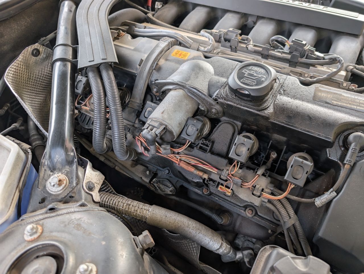

SiC Posted October 30, 2025 Author Posted October 30, 2025 Oh yeah. Also replaced the front wideband Lambda sensor on the Z4. Seemed to work fine for the most part but in certain scenarios it would trip the EML with a Lambda pump circuit fault. Mostly happened when allowing it to free-run downhill. Wiring and connector seemed fine. I would be happy to ignore it but Mrs SiC kept calling me to say the engine light was on and what to do. Despite me telling her to ignore it when it does it, it gets annoying after a few times being told. New genuine Bosch sensor with the correct connector and lead length (different length for front and back) was £72 with a eBay 20% off code from partsinmotion. So not particularly expensive at all. Bought a special Lambda socket as I appear to not own one. Took me a few months before I had any sort of time to do it. In the event it was extremely easy. I did it when the car was hot and it cracked right out. Loads of access room for these upstream sensors under the engine bay. Connector up top by the oil filler. Lambda below the coils and above the silver air con pipe. Right in the middle of this picture here: Old sensor looked all intact but hard to tell condition really. New sensor for comparison. Anti-seize material was already applied out of the factory. Also noticed a MAP error code stored. Looked fine for me apart from a bit oily up in the sensor end. Gave a good clean with Isopropyl Alcohol spray and a cotton bud. Since doing both above, it's not had the EML come back on again. (Knowing my luck it'll probably do it during the MOT 😂) RayMK, Peter C, Brigsy and 7 others 10
