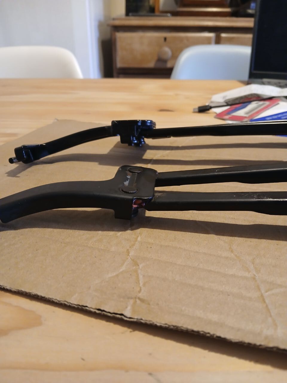

Contact a chap called Paul Whittle on A2OC. Among his many talents and aftermarket products he refurbs the wiper arms on these to better-than-new. Handle is depronman.
He did the arm on the last one I had, much improved

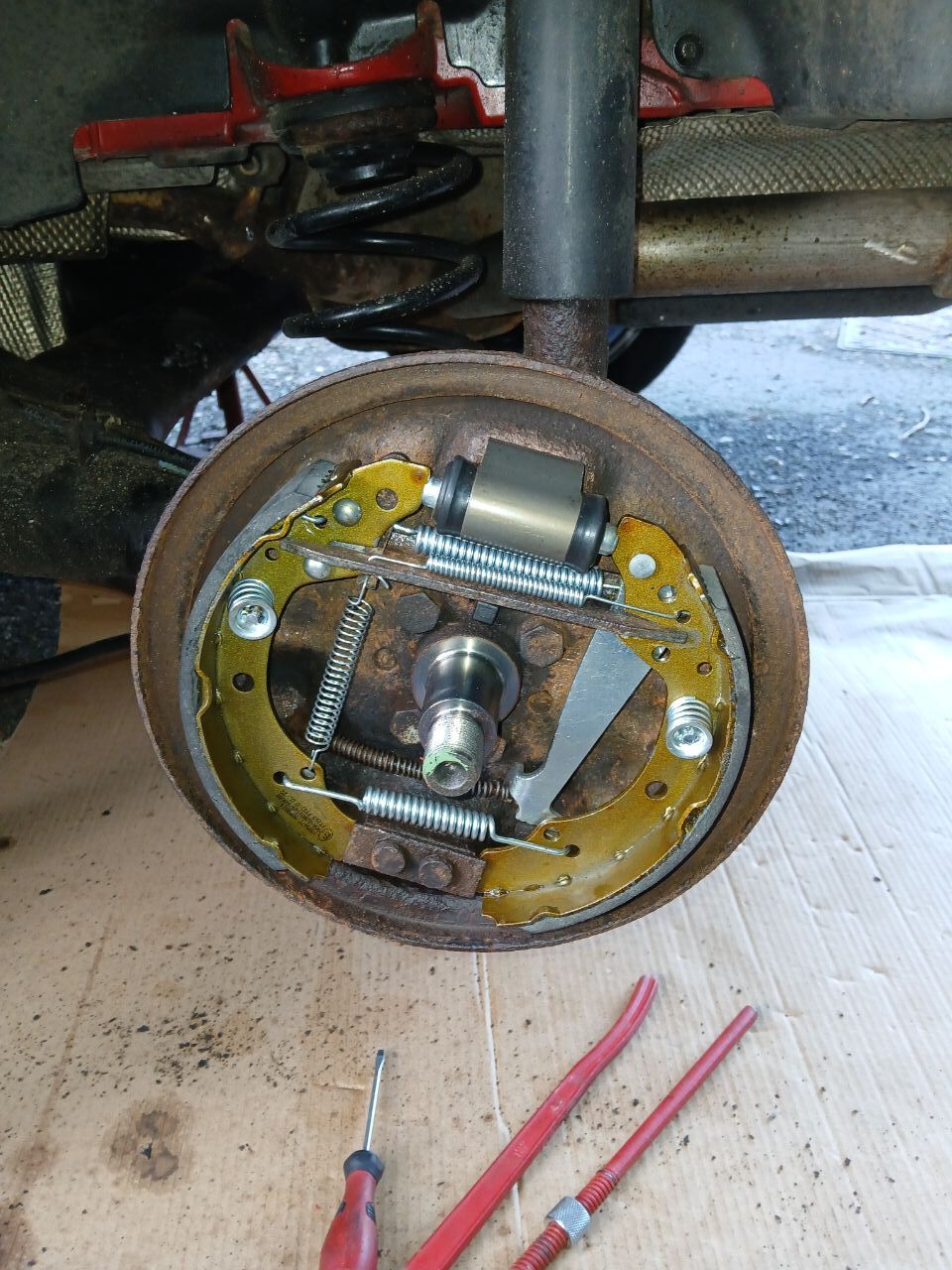

Tight space but almost doable but :-
That Bottom part of pic is cable interference fit holding bracket that after 20 years is  not un- interfering !
There is very little access into space to use force. I can only just get finger tips in there.
Have left it soaking in penetrating oil for now and praying tonight. Otherwise I have no idea how to get that out without lots of fuel tank, exhaust pipe and fuel pipe removal. Bugger .

Handbrake sorted. Took to a man with a lift, sacrificed part of exhaust heat shield and it is possible to remove and replace handbrake cable section from brake drum to centre cable piece.  £16 part plus £20 to man with lift. Result.
