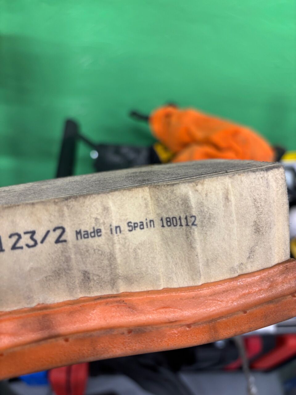

Kiltox Posted April 7 Author Posted April 7 Finally got the chance to do this today neglecting work I should be doing that’ll actually make me some money obvs. NSF drop link is knackered and hopefully the source of the clunking. Other suspension components on that side seem okay 🤞 Air filter was…. Overdue Schaefft, Coprolalia, dome and 4 others 7
Kiltox Posted April 7 Author Posted April 7 Just now, Schaefft said: Nice one, free fixes at least! I didn’t see any drop links in the parts stash, there are ARB bushes and a track rod end though.
Schaefft Posted April 7 Posted April 7 Just now, Kiltox said: I didn’t see any drop links in the parts stash, there are ARB bushes and a track rod end though. I'm fairly sure there was a drop link, unless I'm thinking of another car (Xedos came with one 🤔).
Kiltox Posted April 8 Author Posted April 8 9 hours ago, Schaefft said: I'm fairly sure there was a drop link, unless I'm thinking of another car (Xedos came with one 🤔). No doubt I’ll find it after the one I’ve ordered from Amazon arrives today was only £9.60, Febi too.
Kiltox Posted April 9 Author Posted April 9 On 28/03/2025 at 18:22, yes oui si said: Photos of the suspension, pls. Twin bolt Macstrut at the front, and divorced spring/shock at the rear? yes oui si 1
Kiltox Posted April 9 Author Posted April 9 New drop link has silenced the clunking. It still creaks a bit over speed bumps but meh. Bear, dome and yes oui si 3
