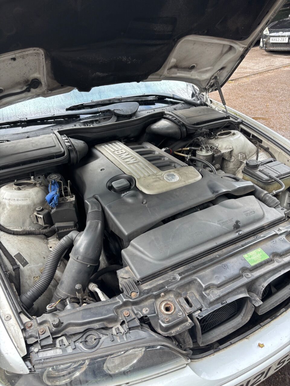

Next, decided to tackle to non-functional RCL. It worked right up until the day after it was here, works fine using the key and everything locks like it should. Checked fuse 55 in the boot and it’s not blown, relearn procedure for the keys didn’t work either, so I will try to fit batteries to the keys and see if that remedies it. I need to repair one of the keys anyway as it doesn’t always knock the immobiliser off.

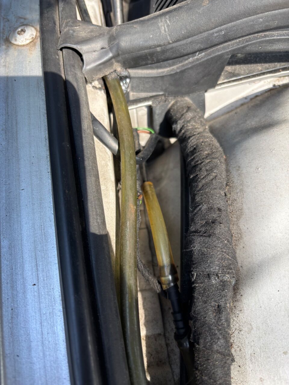

While under the bonnet I decided to figure out why my washers weren’t working. That wasn’t too hard, the pipe had gone brittle and snapped:
Luckily -just- enough room to push the pipe onto what’s left of the connector and we’re in business again:
I will eventually replace all that pipe work likely with soft lines all the way up since they’re easier to replace if they snap than hard lines are, but I’ll do that when I look into the rear wash/wipe, which doesn’t work at all. I can’t hear any pump engage when I move the stalk, and I know this has been confirmed as not being the wiring, so my next test is to wire the pump direct to the battery and see if it does anything, it not I’ll replace the pump and go from there.

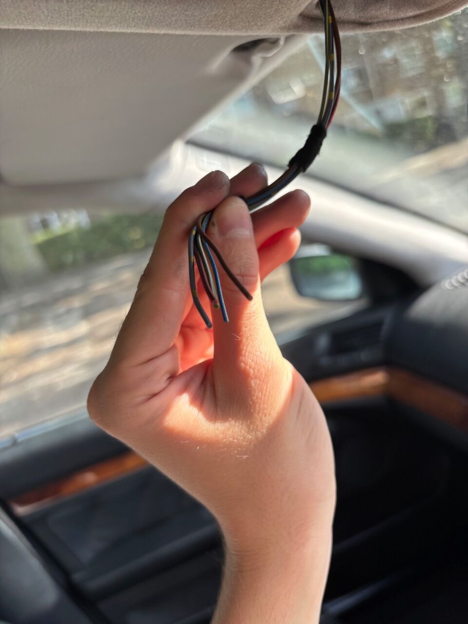

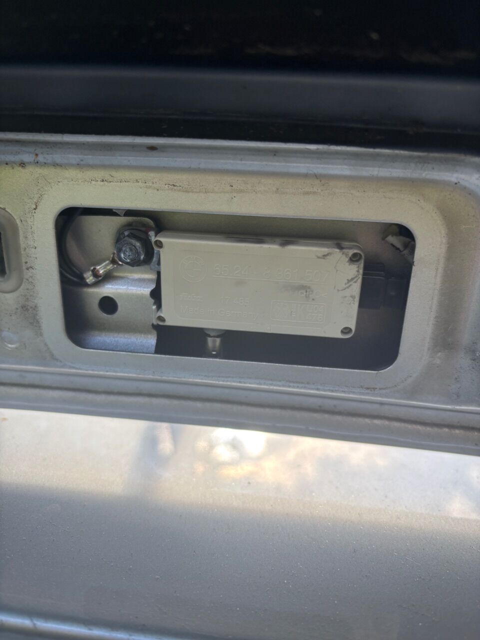

Tackling the RCL on the BMW part 2:
Took key apart and checked battery voltage:
Looks good to me. I borrowed my friend’s Flipper Zero to probe for a signal from the key, can confirm key is working absolutely as it should be. Right. Car end then. The RCL worked fine until I messed with the glass tailgate so logically I’ll start there. Took all that apart and found this with some very unhappy looking earths:
Looks very RF like, so took it apart and cleaned all the earth points:
No dice. After this I googled the part number. That’s the antenna booster for the radio, whoops! Well, at least the radio reception will be better, every cloud and that, eh? So, I moved on to the mirror. The connector is just… there:
Ah okay no worries I thought, I’ll get the interior light out, get the rest of the wiring and plug it in:
Oh. Never mind. Looked up the P/N on the rear view mirror as it has 8 wires, not the 6 that are here and all 8 are different colours, and BMW wiring is colour coded. P/N comes back to an E90/E60 mirror. Unfortunately, this means it won’t work, so I’ll buy an E39 auto dimming mirror and get my soldering iron out, that’ll fix that!
I’m also looking out for an E83 X3 3.0D auto breaking because I want the auto box ECU from it as it has updated software for the GM gearbox in this car.
Next is rear brakes for MOT, then I’ll attempt to tackle the RCL again with varying degrees of success I’m sure. I’m sure it’s wiring so I’ll strip it back and see if anything has broken.

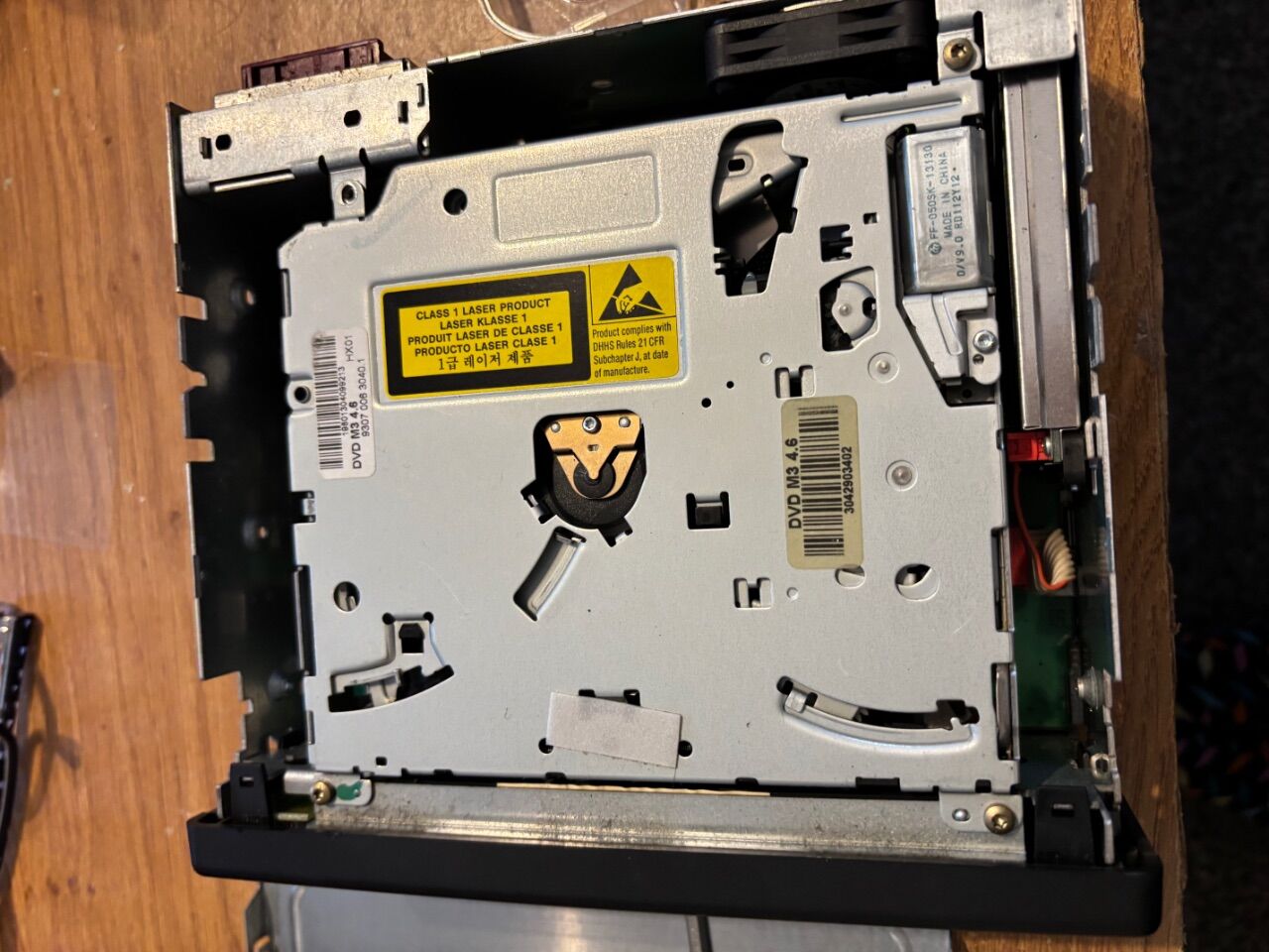

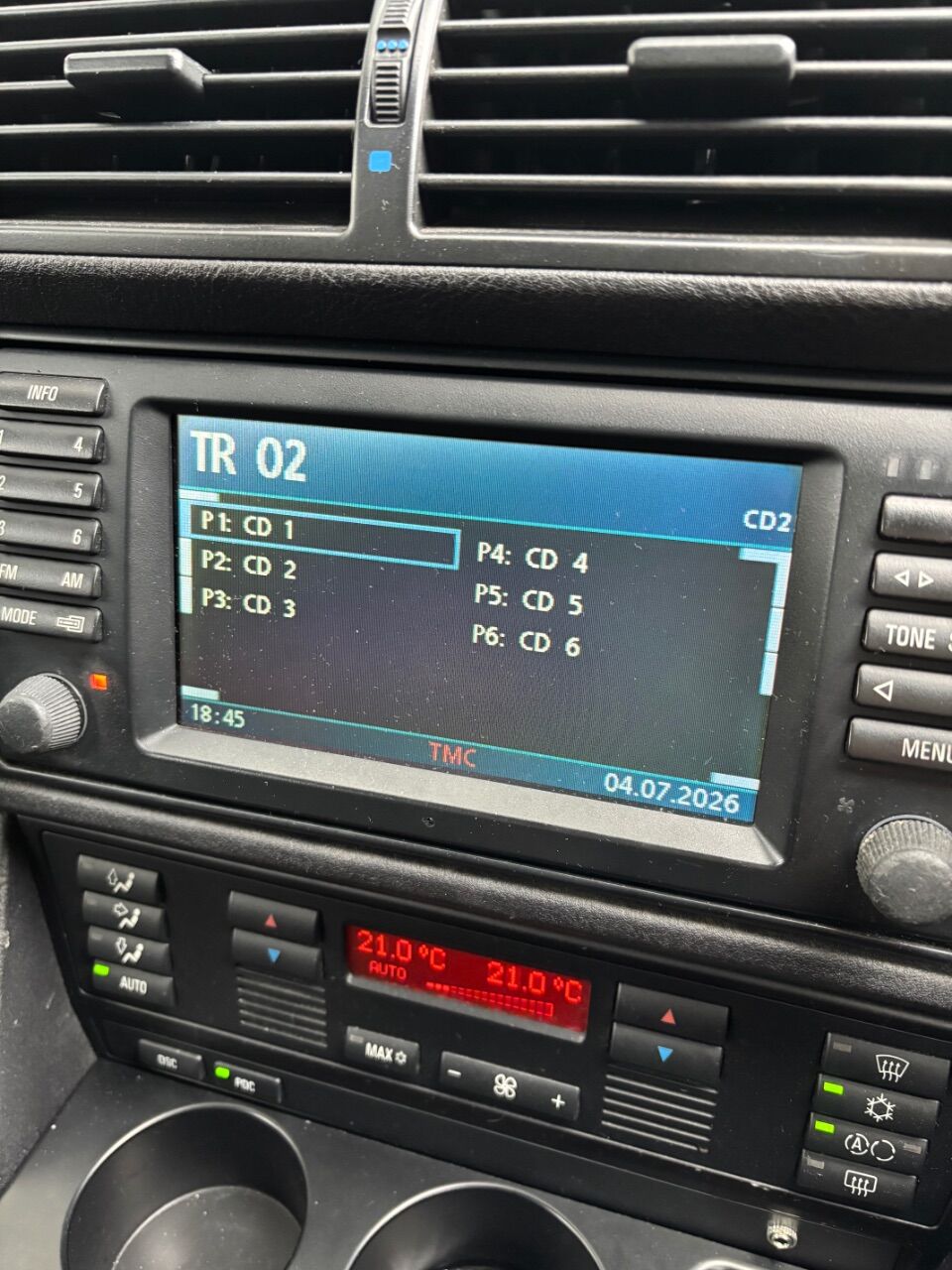

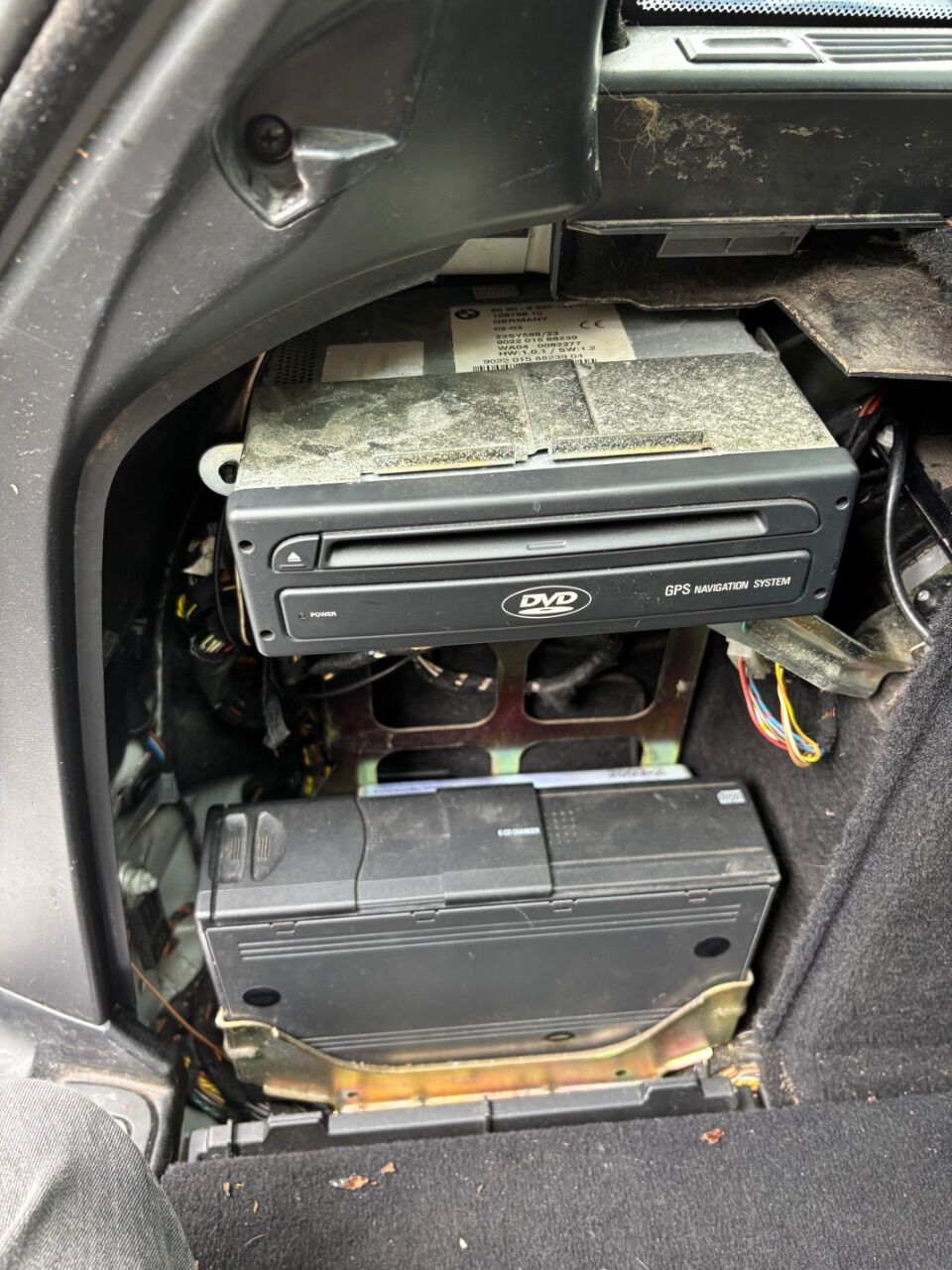

Free fixes… Satnav and CD changer didn’t work, decided to try to remedy that…
First, needed to pull them out:
Turns out they’re a bugger to remove with the mount in situ…

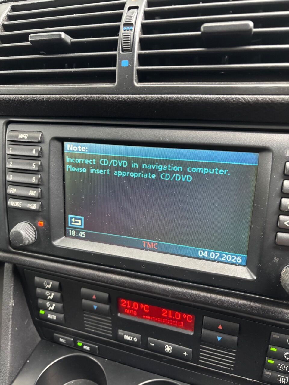

Sorted. Mounts can come with me then. First, satnav. This doesn’t recognise any disc in the drive, now the disks are extremely scratched but nevertheless… I took it apart and sadly no simple access to the laser:
Loads of brittle plastic also fell out with it that was in bits. I’m going to assume that was the shock protection, which would explain all the scratched up discs. Managed to get some rubbing alcohol on the end of an earbud and cleaned it up. Couldn’t work out how to get to the laser pot adjusters so let’s hope that worked… Next was the changer, this was substantially easier to access:
Laser accessible via the changer cartridge door, I just wanted to check if any ribbon cables were undone or broken, thankfully not. Cleaned laser, refitted:
I’ll try the satnav first…
Ah. That’s actually a different error mind, so that IS progress. I’ll burn a new navigation disc and see if that works when I can find some blank DVDs. As for the CD player:
Result! No more radio adverts for me.
Also, doing all of that has inexplicably mended the soft close bootlid. Not sure why or how but I’m not moaning!

@Imhotep Do you actually have many CD's then?
Enough to warrant doing this in fairness, I think I’ll eventually upgrade the entire system to an XTrons but for now…

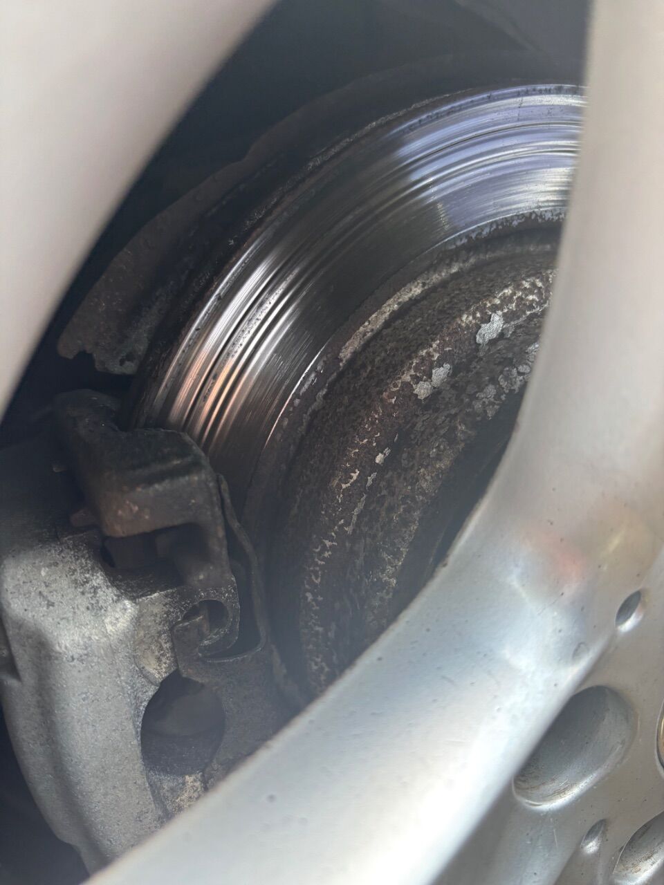

Now I’m not too inclined to spend too much on cars with short tests that I haven’t had for long, so some very cheap rear brakes which I know it needs for MOT. These will be replaced again if it passes, I don’t like cheap brakes or cheap tyres really, but at the same time I don’t want to spend £150 on rear brakes for it then to fail a test. I can’t see a reason it would fail other than the brakes mind:
I do need to do the prop doughnut too, but again, I don’t want to spend too much yet, and it won’t fail on the prop doughnut as it’s covered and they can’t see it. If it gets a pass or a minor fail more fixes are incoming. I need to sort out the gearbox mount too as I’m sure that’s the reason the gearbox is noisy. It drives too well for it to be a gearbox issue, if it was the gearbox I’d imagine I’d have errors or it would be stuck in third or have really harsh gearchanges, but it just… doesn’t. The auto box functions perfectly.

Those brake pads/discs will be absolutely fine for that car. Literally wasting money swapping them out again for more “premium” given it isn’t particularly powerful. Doing all that you’d be better off buying premium in the first place! I’ve fitted APEC and similar to loads and never had any issues re fade/squeal/premature wear
  • Agree 2
In truth it’s more the pads which are the well known brand called ‘brake pads’. Then again, as they’re rears they’re likely not doing a lot anyway, if this is anything like most cars the rear brakes will only be doing about 15% at most.

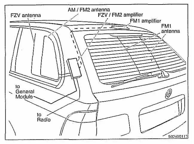

Also, BMW RCL part 3.
Found this image:
Decided to look for the General Module. So apart comes the D pillar:
Quickly dismissed this as it goes to the navigation system and radio. Both of which function. It can only be either the FM1 transmitter or the wiring to the transmitter. I think for now I’ll deal with having no RCL until I replace that rusty glass bootlid, while I’ve got it apart I’ll replace the wiring and the FM1 transmitter. Shame it wasn’t a more simple one but I’m not taking the thing apart to take it apart again in a few weeks when I get a new bootlid.

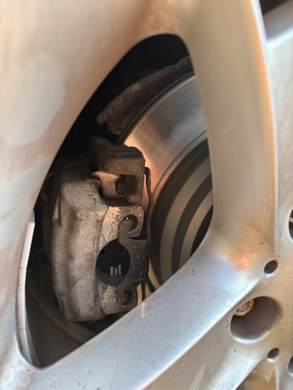

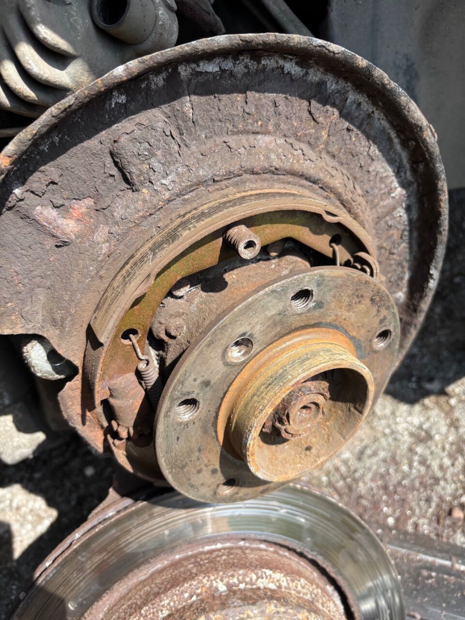

Today was new brakes day. As I alluded to in the grumpy thread, I’ve fractured a rib so there’s precious little I can do. So I went around the corner to see @Heidel_Kakao as always. He was doing the gearbox fluid on his XJR so I decided to park next to him and distract him from this by asking him to jack up my car and remove the wheels, and crack off all the bolts for me:
The rear brakes really weren’t looking well, and were desperate for replacement. The pads were fine, but figured while I was there…
We really had to fight this one. The disc took quite a beating from the hammer before it would come off, and the sliders were a bugger too. Not helped by the placement of the sliders meaning you couldn’t use a ratchet to get them out, and we had to use an Allen key. However finally we were down to the handbrake shoes. Thin, but looked okay:
Gave everything a very liberal cleaning and reassembled. Other side was far far easier, and took about 25 minutes start to finish.
Much nicer than when I did the MG brakes and everything was fighting me.
I also did the pad wear sensor on the back, at first I was a tad worried as it was still showing on the dash:
Turns out there’s a reset procedure I was unaware of, and after doing that, thankfully the warning has gone away:

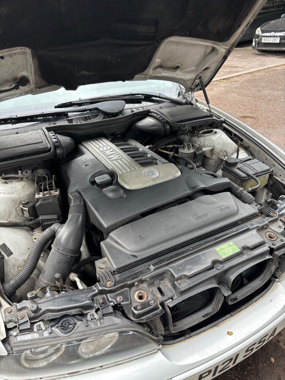

Minor FTP today, pulled out of a road and the car cut out and coasted to a stop showing ‘fuel injection system’ on the display. Fired straight back up once I’d got the car in park at least.
Now, I’d ran the tank quite low, so I assumed it was just that but I decided to check the dash anyway so I went into the hidden menu to check the status of the fuel tanks:
Huh. One tank apparently has 4 gallons in and the other apparently has no fuel in it whatsoever.
That might explain why the fuel gauge can’t work out what’s in the tank. Likely a sender or a failed fuel pump. Will look into this after MOT next week.

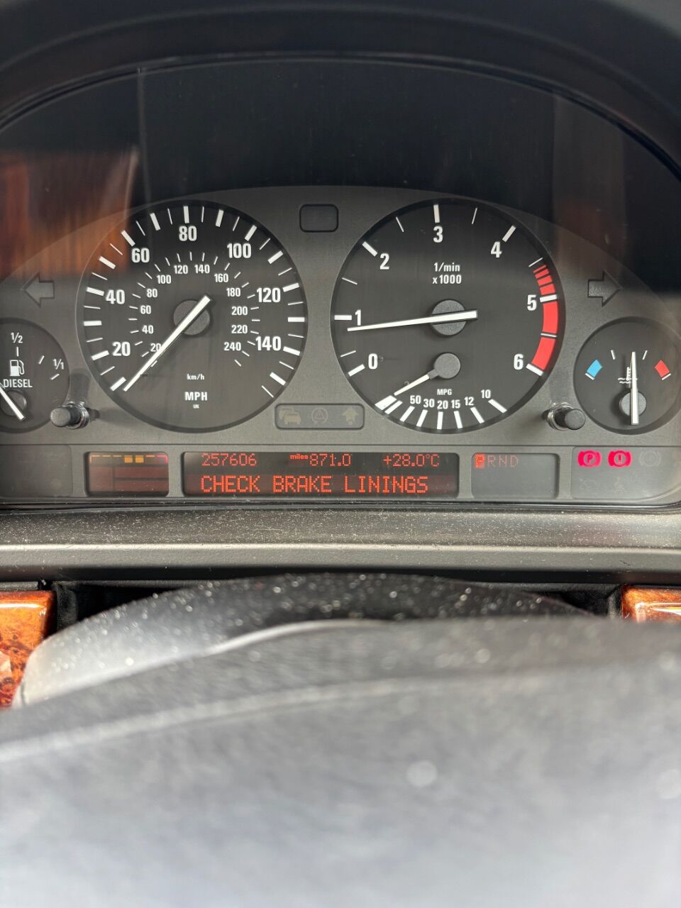

MOT booked for Monday so I’m now doing the little jobs. First was to turn off the brake pad warning light again as it’s back on. I think at this rate I might just unplug the sensors and see if that turns them off, and if not work out is there’s any resistance value and stuff a resistor in there. If it comes on again before MOT (it will), I’ll reset it just before the test so it should hopefully stay off. As they are cheap I’ll likely also buy front discs and pads and another sensor for the front and see if that one is the issue, provided it passes MOT. Doesn’t really need new front discs or pads but while I’m there…

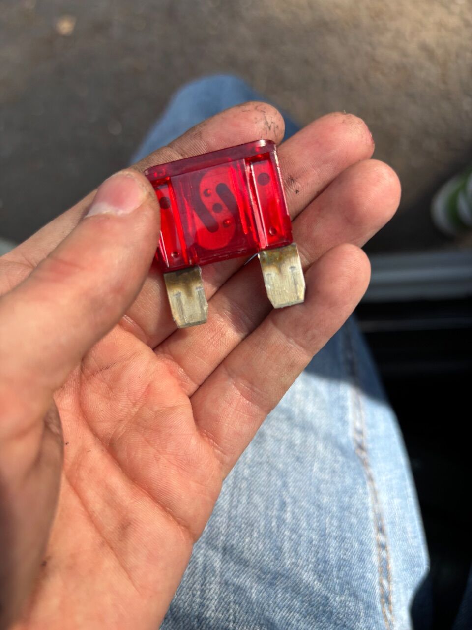

Next, I decided to mend the auxiliary fan. This hasn’t worked since I got the car, which is a worry as while the car has a viscous fan it’s not enough to cool the car down, and it needs that fan. Also means the AC doesn’t blow cold in traffic.
First I checked the temperature sensor, took apart and cleaned and refitted. No dice.
As a last ditch effort I decided to check the fuses. I was fairly sure there’s no issue as the heater blower worked. However; checking the diagram the blower is controlled by fuse 76 and the aux fan by fuse 75. Whoops, could be a fuse. So. Despite broken ribs, I ended up upside down in the passenger footwell to get a fuse 75 and 76 because BMW in their infinite wisdom put them in a completely different place to EVERY OTHER FUSE:
Fuse 75 is the red 50A fuse there, so I pulled it:
I mean, it’s clearly not blown but look how burnt and grubby those pins are, so I gave it a bit of a clean up and popped it back into the holder. Fired up the engine at set the car to max AC and heard the glorious noise of a fan that clearly hasn’t run for years and isn’t very well, but nevertheless it was running, and the AC is now ice cold. Result! I do think the fan has a lifespan measurable in minutes and I do think the motor will need replacing, but for now it works and that’s what matters. If it passes MOT I’ll treat it to that along with a gearbox flush.

@Imhotep If Google is correct as I suspected the warning light being on shouldn't be a fail anyway;
"MOT Rules on Brake Pads: If the warning light is on due to a faulty sensor or broken wire, but your pads are safely above the legal limit, it will not cause a failure."
I had a brake pad warning light on the Senator. I broke the new sensor when replacing the pads. I professionally repaired it by cutting the wires, stripping the ends and twisting them together. Taped up of course, cos I’m a pro. Warning light extinguished. I don’t enough miles in it to need a warning.
Trouble is the brake pad warning light on the 525d puts the low fluid warning light on, not a pad warning light. Though I have checked and it’s a minor apparently so should just advise hopefully!

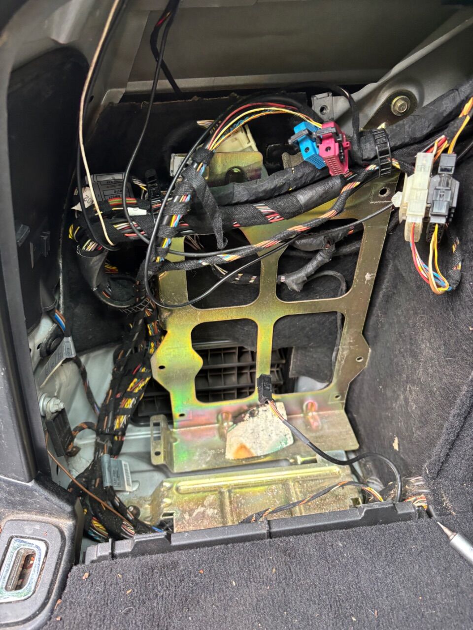

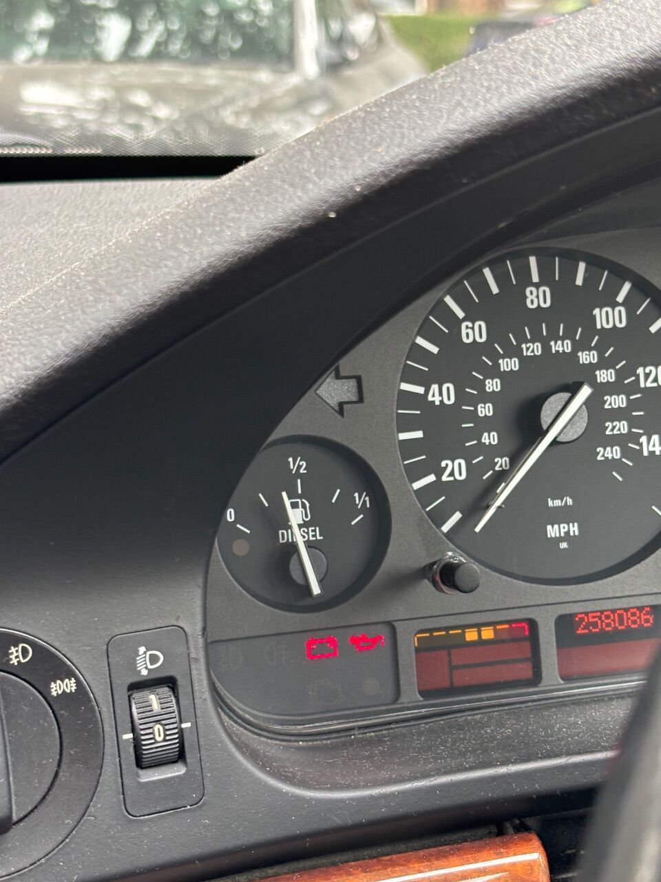

So this is the second time this week I’ve had to do this:
Parked up with 25 miles of range and come back to it this morning and it has 0 miles of range and won’t start because it’s out of diesel.
Now, the gauge never shows 0 when I park it up, it’s only the next morning it’ll show 0 so something is going on here. One thing I have noticed is I can’t hear the buzz of an electric fuel pump when I put the ignition on. Now this car does have 2 mechanical fuel pumps as well as the electric one (I think), so it’s possible the electric one isn’t working. I haven’t done too much investigation yet but I will be seeing what happens if I just give 12v to that fuel pump. As I understand it, the electric pump also tells the gauge how much fuel is in it, so that tallies that if it was inop/not working properly. Will be investigating…
Removed rear seat and hit sender with a rubber mallet. Lo and behold:
I’ve also noticed inside the hidden menu the fuel correction factor has been changed from default to about 8% more optimistic than it should be, so I’ve reset that down to default, and the above is apparently what £30 of diesel looks like in this car.
Will get a new sender on order. For now I’ll just keep the jerry can full of diesel and handy. I want to see what it now thinks empty is since before it was pretty much ‘when the light came on’

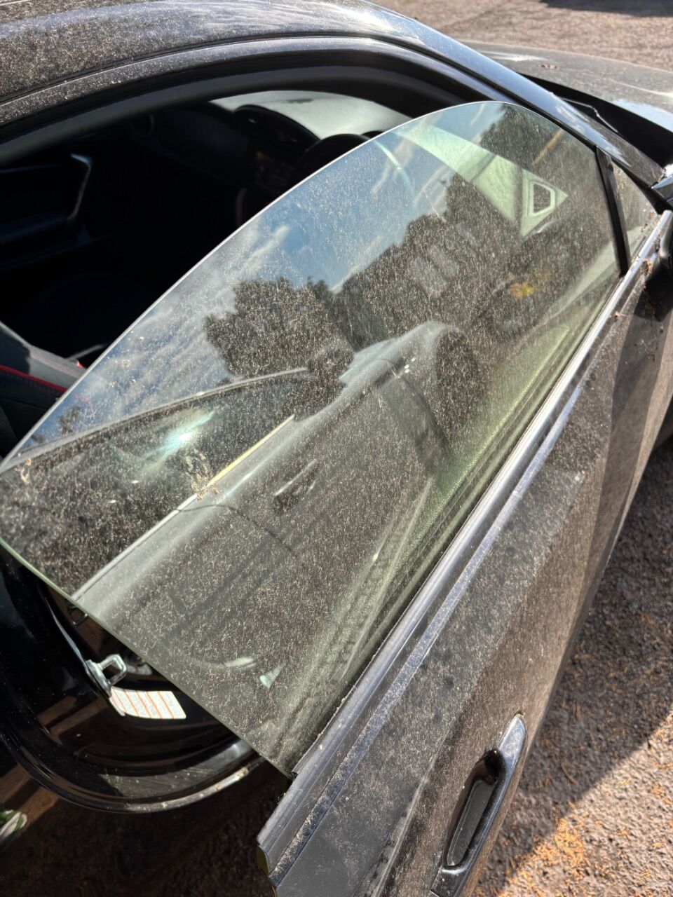

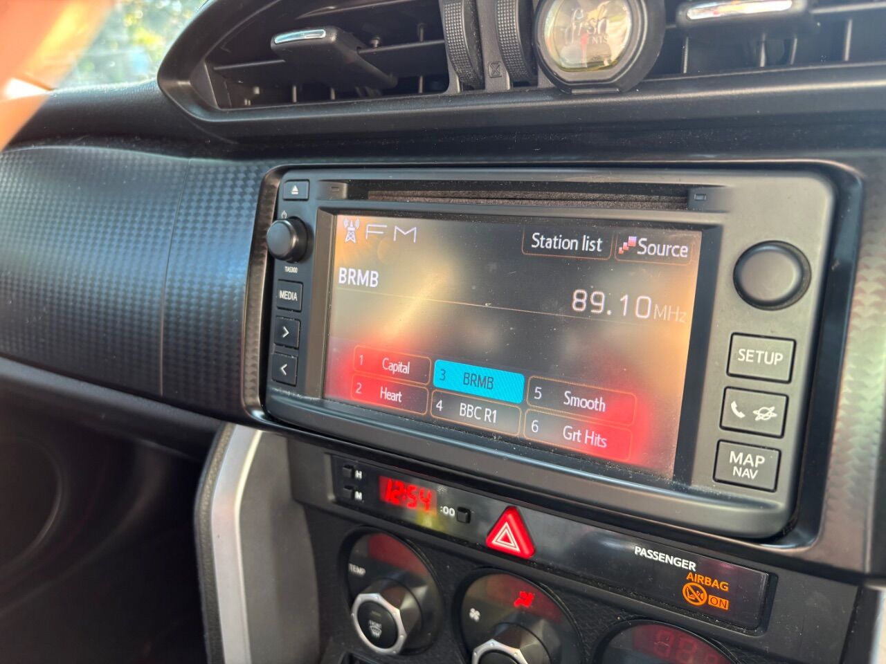

I am in the GT86 today.
Poor thing looks very abandoned so I’ve decided to start working on it. It’s out of test now and unused (where it’s parked is private land so as it’s SORN no huge issue). All it needs to drive technically is a driveshaft nut, everything else can be sorted later. But I did need to make it look less abandoned. In lieu of a sponge and some water (no communal tap and no sponge), I cleaned the windows a tad. It’s not much but it has made the car look a bit more loved. I also removed the tow eye from the bumper…
I’ve also put the stereo back in it so there’s not just a load of wires hanging out of the dash…
