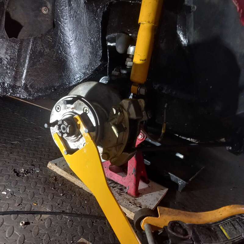

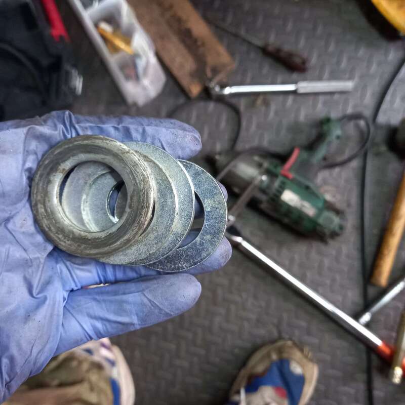

So before I started on the engine I had a few jobs to do. Pretty much fit a new rebound stop, some shock absorber bushes and torque the hub nut. I always do the washer method when dealing with CV nuts. Whereby I remove the conical washer and replace it with a flat one. Then I torque the nut fully. I then remove the washer, replace it with the correct conical washer  then I torque again.

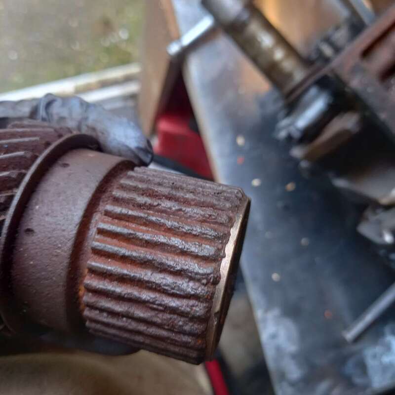

Managed to get a bit more  stripping done on the engine. The primary gear needed taking off and luckily I had the puller for it . (I love old tooling) I made sure to fit an old crank bolt in the nose  as I didn't want the puller to mash the threads. It would have probably been OK but didn't want to risk it. Anyway the primary gear needs renewing it's very chewed up.

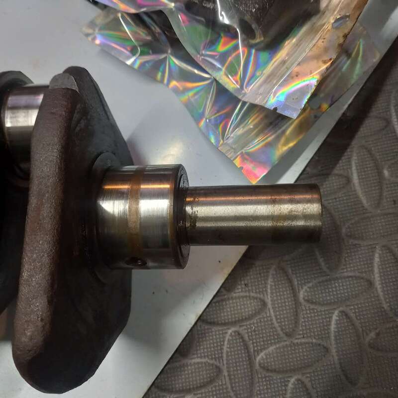

The crank looks quite pitted. I'm  not sure what to look for in terms of that so any advice is most welcome. Cheers

Blimey, that primary gear does look rough, never seen one like that before. Nice to see you getting stuck in so quickly

I know Hahaha!! Wonder what the past owners been doing with it. Thanks mate it's been great back in the garage tinkering :)

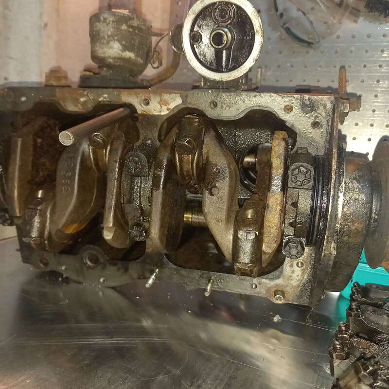

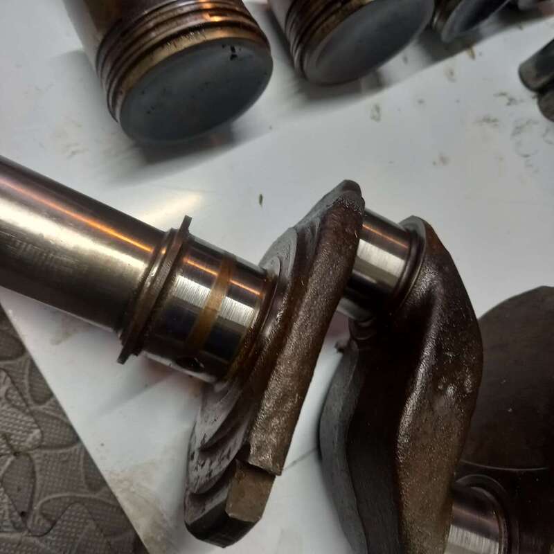

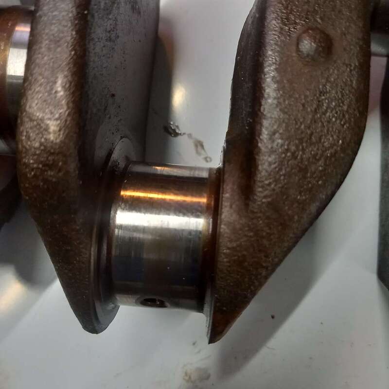

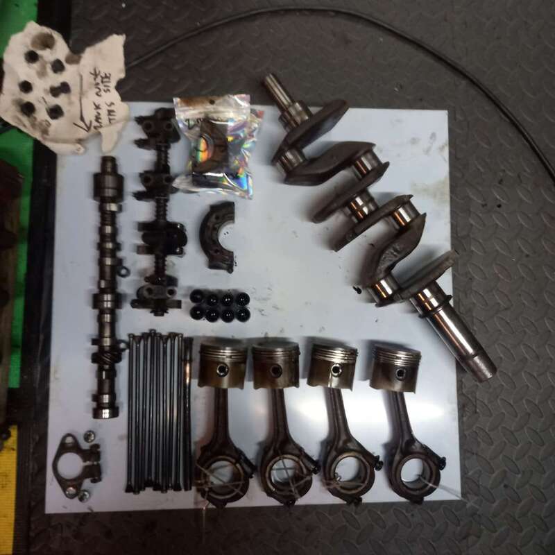

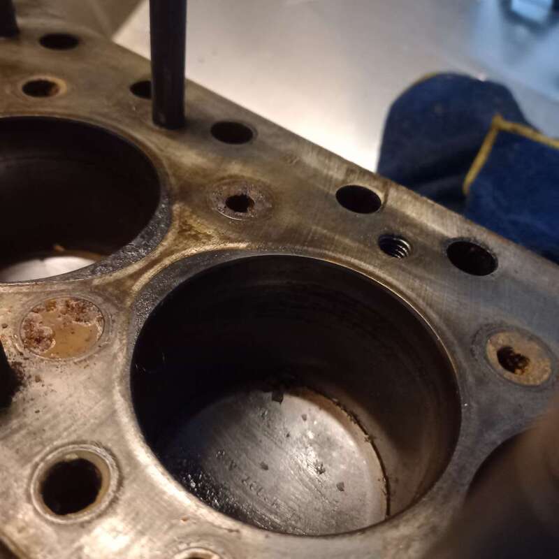

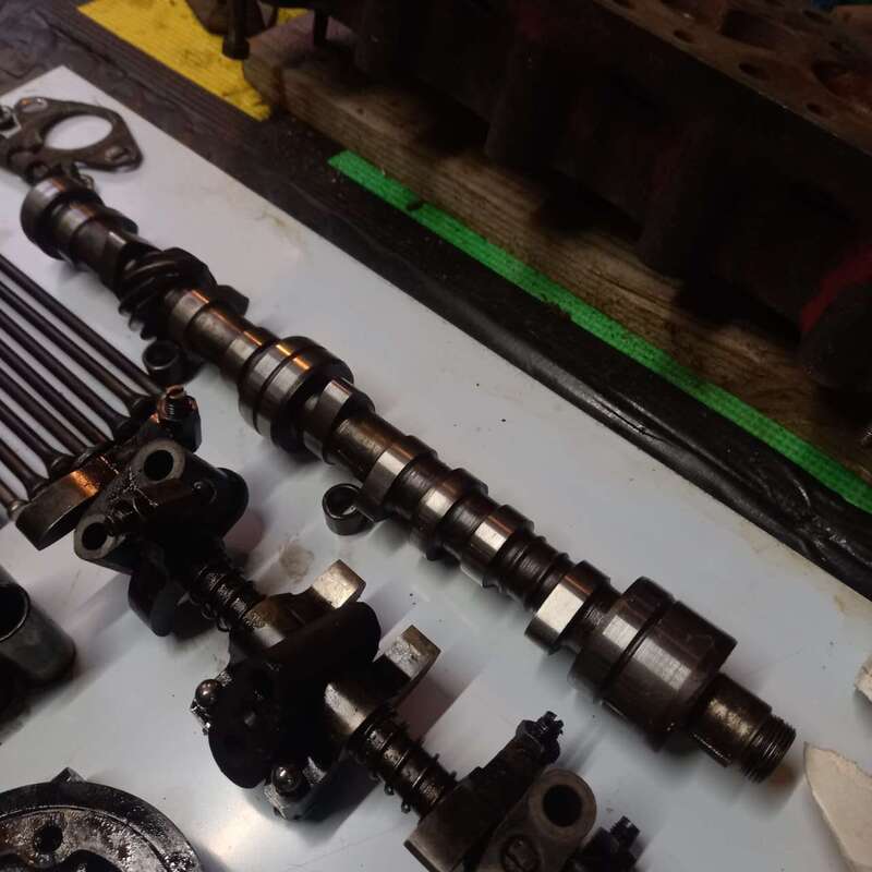

So I've got the crank and cam out. I'm not sure what wear I'm checking for really. But there's obviously scoring on the crank.
It looks as though it has the original crank shells so it must not have had a grind previously.

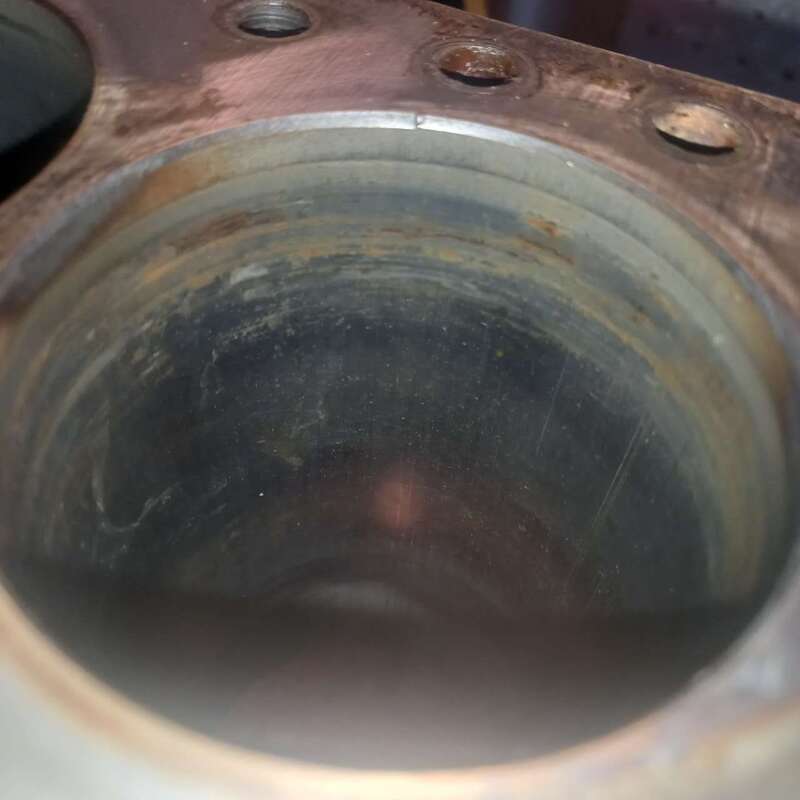

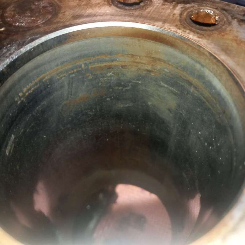

There's a lot of scoring on number 4 piston. The bores actually look really good considering , so may just get away with a hone.
If I go for a rebore I've been quoted £50 for the first cylinder then £20 for the following ones. So £110 for the Job if I chose to go that way.
Guess for now I'm going to clean the block up.
Oh yes and ignore the bunch of followers. I'm going to put a new cam in so will replace them.

Just looking at the piston bores. They're smooth if I run my finger in there. But still might air on the side of caution and have them rebored.

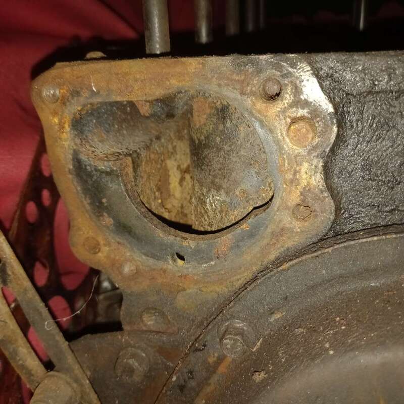

Not much progress today. Just removed the engine number plate. Easy enough to do. Maybe not the smartest idea but it won't match the V5 anyway

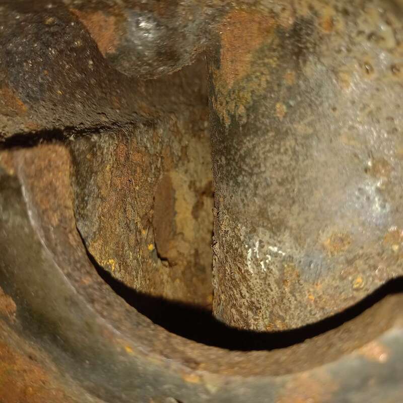

but the main reason is that I'm going to hot Caustic dip the block. As Caustic reacts violently with aluminium,  I thought it was necessary.
Also removed.the core plugs so the Caustic gets in all the nucks and crannies. I will then rinse it off and use electrolysis to remove the rust once the grime has been removed
Block and a few other grubby bits have been in a Caustic solution for 12 hours now. Will probably end up having the jet wash it properly clean to remove the sludge but it seems to be working OK.
The crank doesn't look too bad in the pictures.  Man in a machine shop showed me how to check for ovality using a vernier, which isn't accurate enough to do a proper measurement but will show if there's a difference ie ovality.
Pistons look done for really.  If you need new pistons, might as well get it rebored - that's just an opinion.

Ahh excellent,  thanks for your help. I'll check later for irregularities.
Absolutely, I'm definitely tempted to have it rebored.
