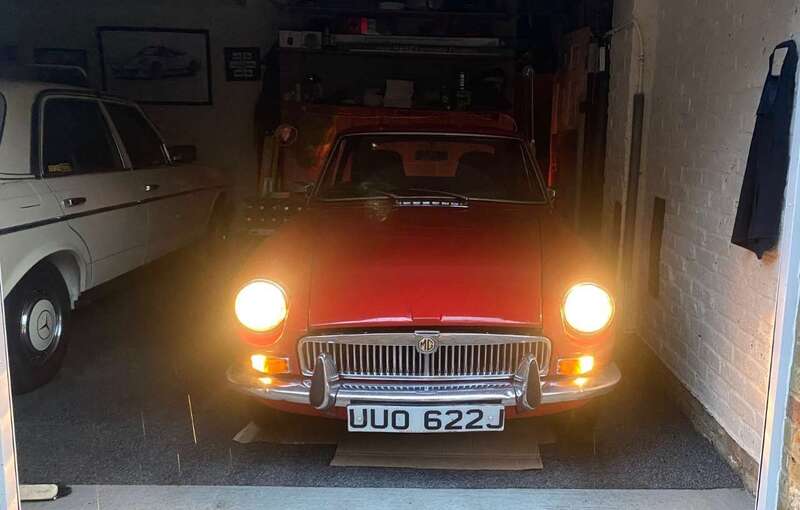

I replaced the light unit and the lighting system is now fully operational.

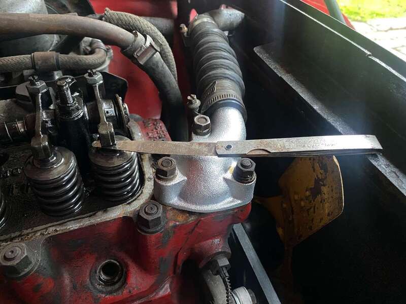

I removed the rocker cover. I was pleased to find that the valves, springs, rockers etc are all nice and clean.
Rather than using the rule of 9, when adjusting tappets I work on cylinder 1 whilst the valves are rocking on cylinder 4 etc...
The clearance on all eight valves was way out.
I adjusted the clearances to a tight 0.35mm, which is about 0.013 - 0.014 inch, which is about right.

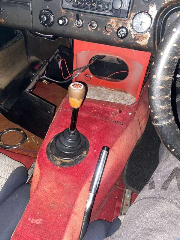

I am not a fan of the centre console - it's ugly. I removed it to reveal a tidy carpet fitted over the top of the transmission tunnel.
Ideally, I would like to fit this type of speaker grille and trim and completely remove the console.
Let's see what I can score at Beulieu in the spring.
Whilst fiddling with the console, I traced a red wire that extends from a warning light that is fitted to the console. It goes to the overdrive switch.

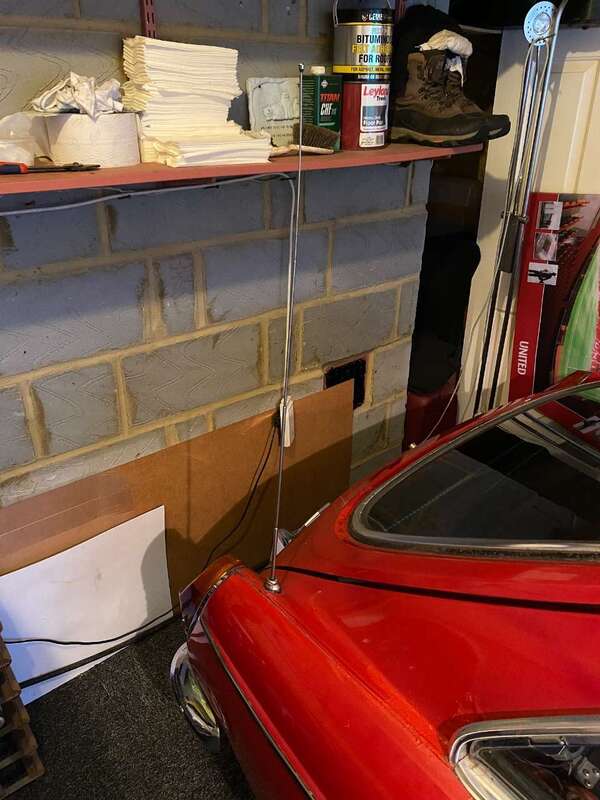

The electric aerial that was fitted to the MGB was broken so I removed it. I had two spare aerials in the garage but neither seemed to fit. Today, I pinched parts from the old electric aerial mast, got them to fit one of my spare aerials and hey presto, I have a fully operational aerial and the radio works a treat.
Next time, maybe tomorrow, I will tidy up the speaker wiring and find out why the right side speakers aren't working.

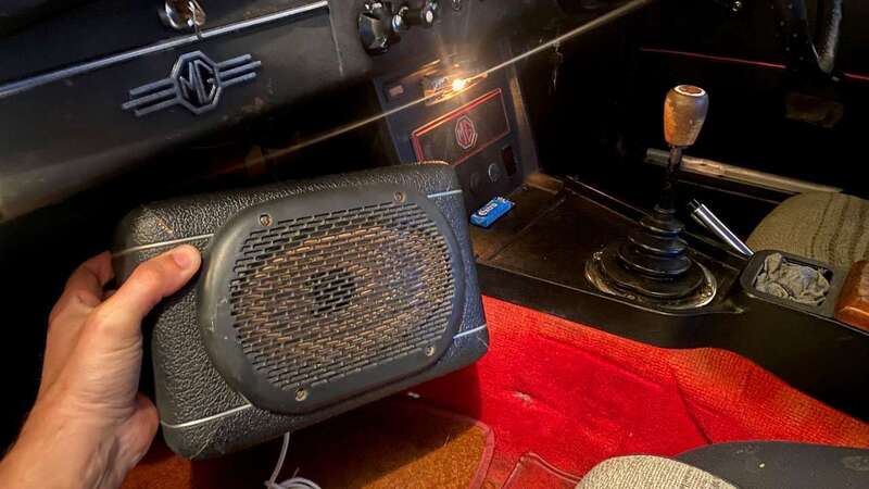

I made time this afternoon to remove the central console.
With the console removed, I had a look at how the gearstick is secured. Looks like removal of these three bolts will enable removal of the gearstick and provide access to the nylon bush that is apparently causing the transfer of vibrations from the gearbox.
Now that I know what the noise is and that it is nothing particularly serious, I am happy to deal with it later rather than sooner.
Before I removed the electrical switches and lights fitted to the old console, I checked which cable does what. To my surprise, all three cables that extended to the interior light were live! How can this be? When I put my tester on each end of the bulb, both were showing +12V. Madness. Or perhaps sorcery?
When fiddling with the rear speakers, I noticed my favourite 10mm spanner, still holding on tightly to a bolt that secures the passenger seat, which I thought I'd lost during the time the MGB was in my workshop. Win.
And this is the result of today's tinkering.
The interior looks much better without the ugly plastic console. I love the exposed carpet on the transmission tunnel, even if it partially as new and part faded.
The centre speaker is connected to the radio, which now pumps out tunes via five speakers.
The white cable is for charging my iPhone, which is connected to a +12V socket, which takes power from the electrical supply to the heater switch. Speaking of which, the old heater switch was on the old console, an ugly looking thing. The original heater switch is the one on the dashboard, below the radio, to the right of the heater control knob. Initially I planned on reconnecting the cables back to this switch, however I found there are cables already connected to it. The switch doesn't do anything, so it's all a bit of a mystery. The new heater switch is now below the radio, to the left of the choke knob.
I doubt that I will ever bother finding the early original speaker console but I will look out for a chrome speaker grill, which would look more period than the current plastic one.

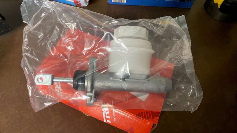

When I got the MGB, the brake master cylinder reservoir was empty. The cylinder was obviously leaking and caused fluid to spill and in the process strip paint from the top of the bulkhead.
And the underside, where it leaked through.
As best as possible, I cleaned up what was left of the paint and sprayed Rust-Oleum paint to protect the metal.
I previously bled the brakes, with the old master cylinder in situ, connected to the brake line. The brake pedal was soft to the point where it would almost touch the floor but if I pressed it half way, released it and pressed it again, the pedal was firm and the brakes worked well. I assumed that the master cylinder was faulty.
I replaced the brake master cylinder with the new part that I got from Moss Europe. A fiddly job but I got there in the end.
I bled the brakes right through, probably went through about 2.5 litres of brake fluid but the pedal was still soft.
I've had this spanner for decades, no idea where I got it from but it's the right tool to adjust the MGB's rear brakes.
The adjustor mechanisms have been recently replaced but the brakes were not correctly adjusted, especially on the offside.
I adjusted the rear brakes to perfection and I was sure that I've bled the brakes correctly.
A test drive revealed that the brakes are no better. The pedal is still soft and only gets hard when depressed half way, released and re-applied.
I did not think to bench bleed the master cylinder before fitting it. I've done some research and it seems that air could be trapped inside the master cylinder, despite the effort that I went to to bleed the brakes.
I can't think of anything else that could be causing the problem. I will remove the master cylinder, bench bleed it and have another go at bleeding the brakes.
