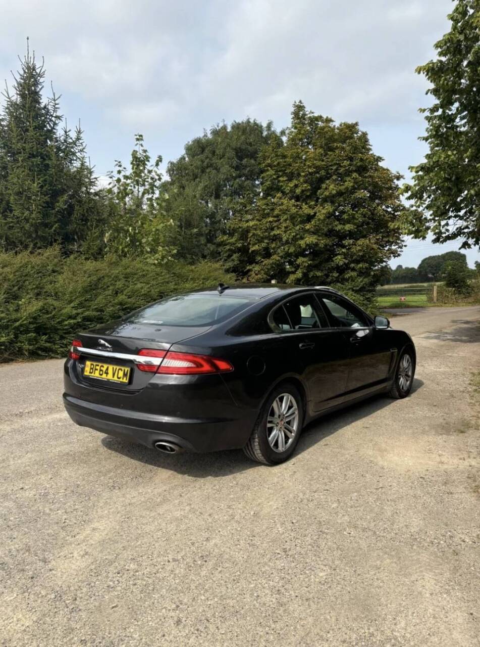

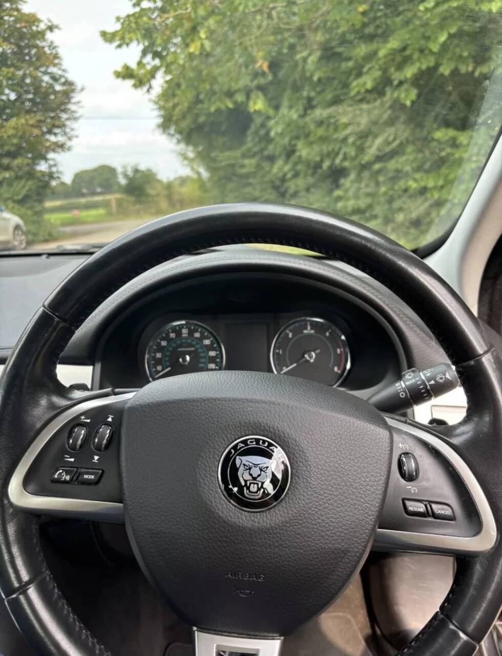

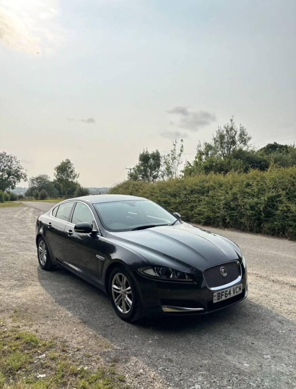

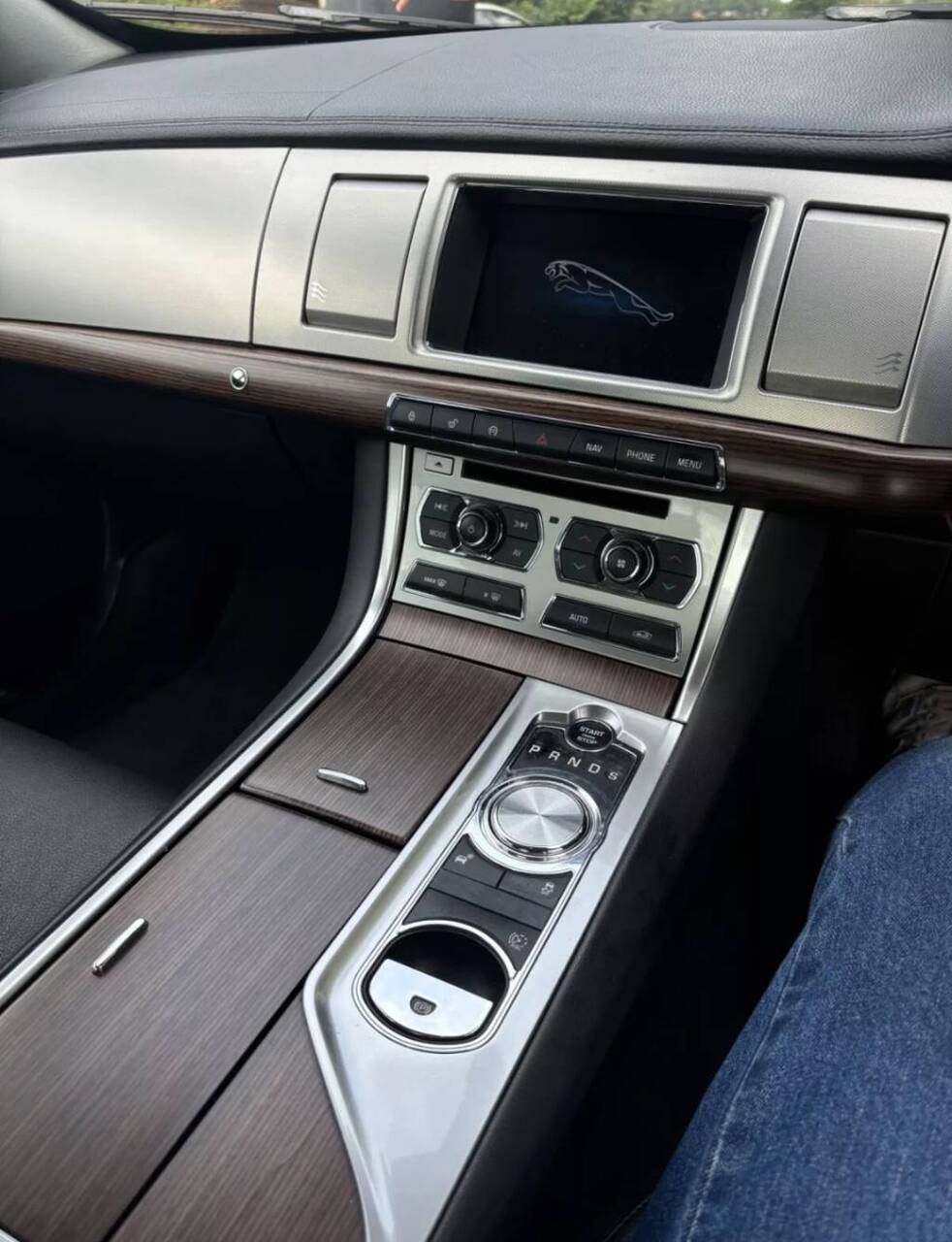

So drive done yesterday, effectively driving from 3.30pm until 11pm with the purchasing of a jaguar XF in the middle.
Audi did "well", XF was a lovely thing and drove back with no issues. 2015 car on 100k miles for £4k seems really decent value. When I did a car check on it it said that a bad trade in value would be £4.3k and the previous owner paid £8.7k in May 2023. I checked the rear subframe and the "rust" is so incredibly superficial. I will clean it up for her regardless as I know it's a failure point on these XFs.
