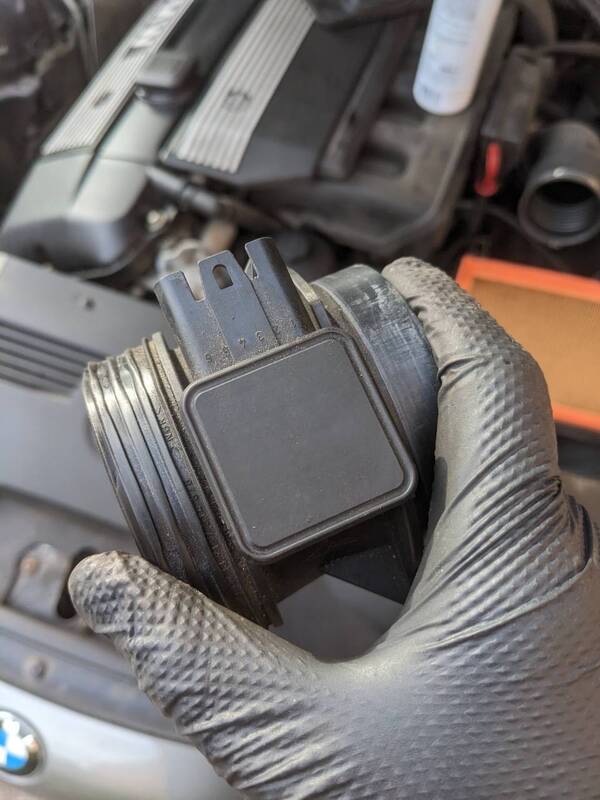

SiC Posted April 23, 2024 Author Posted April 23, 2024 I disconnected the MAF after a drive to warm the car up. Arse Dyno suggests it's much more lively with it disconnected. So presumably either a vacuum leak somewhere or MAF is tired. MAF looks immaculate inside. Has Siemens written on it, which suggests it's not a cheap part. Hard to know if genuine or not but I think it is. Can't see any date codes on it though. Too expensive to parts dart with a new one. About £180 for a genuine Siemens VDO from Autodoc. So unlikely I'll be doing that. MOT booked for 10th May 🤞 bangernomics 1

RoverFolkUs Posted April 24, 2024 Posted April 24, 2024 23 hours ago, SiC said: I disconnected the MAF after a drive to warm the car up. Arse Dyno suggests it's much more lively with it disconnected. So presumably either a vacuum leak somewhere or MAF is tired. MAF looks immaculate inside. Has Siemens written on it, which suggests it's not a cheap part. Hard to know if genuine or not but I think it is. Can't see any date codes on it though. Too expensive to parts dart with a new one. About £180 for a genuine Siemens VDO from Autodoc. So unlikely I'll be doing that. MOT booked for 10th May 🤞 There is a breather pipe which commonly splits, it goes from somewhere just after the air box to somewhere under the inlet manifold. Sorry I can't be more helpful than that as I can't remember exact details but a smoke test finds it! It will usually nudge the emmisions into an MOT fail though so all may or may not be revealed when you get it done

SiC Posted April 24, 2024 Author Posted April 24, 2024 1 hour ago, RoverFolkUs said: There is a breather pipe which commonly splits, it goes from somewhere just after the air box to somewhere under the inlet manifold. Sorry I can't be more helpful than that as I can't remember exact details but a smoke test finds it! It will usually nudge the emmisions into an MOT fail though so all may or may not be revealed when you get it done Is this on the rubber intake pipe? I know that often goes (from googling). I have checked that and it's in excellent condition. Date coded 2017 so definitely not original. Hard pipe going to that has no splits either. Given the engine light only comes on after a long run and only once in my ownership (albeit I have seen pending codes too), I don't think it's a major leak if there is a vac leak. Might just be one of those old car/BMW things that have to be lived with. Especially if it passes the MOT as it is. I've also read that cracks in the plastic cam cover can do it. Likewise leaky oil caps can too. I might pull the dipstick and/or cap to see if the running changes dramatically. Ideally should of course but if it doesn't then it suggests it's adapted to the air leak already. RoverFolkUs 1
SiC Posted April 24, 2024 Author Posted April 24, 2024 I believe also there is a vac line that goes from the engine to the fuel tank where the Fuel Pressure Regulator is. Like a car length vac line is going to cause any issues. Great job BMW engineering 😒 I'll get my hand vacuum pump out and vacuum that whole section. Brake booster, charcoal canister and FPR vac line. They all come off the same intake hose port. If that holds vacuum for a decent amount of time at least I know that side is all good.
RoverFolkUs Posted April 24, 2024 Posted April 24, 2024 2 minutes ago, SiC said: Is this on the rubber intake pipe? I know that often goes (from googling). I have checked that and it's in excellent condition. Date coded 2017 so definitely not original. Hard pipe going to that has no splits either. Given the engine light only comes on after a long run and only once in my ownership (albeit I have seen pending codes too), I don't think it's a major leak if there is a vac leak. Might just be one of those old car/BMW things that have to be lived with. Especially if it passes the MOT as it is. I've also read that cracks in the plastic cam cover can do it. Likewise leaky oil caps can too. I might pull the dipstick and/or cap to see if the running changes dramatically. Ideally should of course but if it doesn't then it suggests it's adapted to the air leak already. Hmm, no I believe it would be whatever pipe/hose is attached to the smaller part you are holding in photo #2? SiC 1

SiC Posted April 24, 2024 Author Posted April 24, 2024 That whole lot is the next thing I'm going to look at. Right now my first priorities are having good brakes. 😄 I just hope it's not a worn out MAF. At £180 for a genuine Siemens/VDO unit, I'm not in too much of a rush to replace it willy nilly.

SiC Posted April 24, 2024 Author Posted April 24, 2024 22 minutes ago, JakeT said: They also use the idle air valve instead of the throttle at small pedal pressures. I'm surprised it used an IAV. Didn't see one or where one be attached when I removed the throttle body.
JakeT Posted April 24, 2024 Posted April 24, 2024 They’re a separate unit, silver cylinder. Under the inlet manifold. If memory serves me correctly the second, smaller hose in that rubber inlet bellows feeds it.
