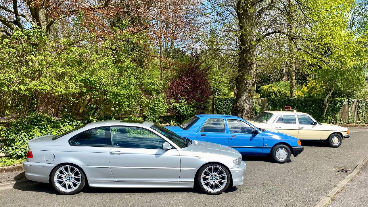

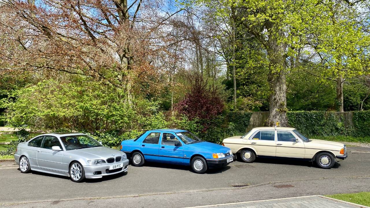

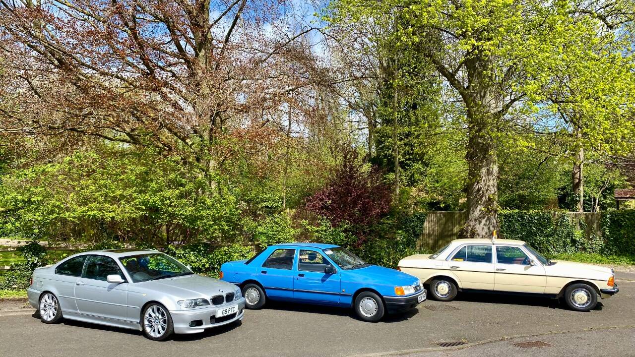

Peter C Posted April 20, 2024 Author Posted April 20, 2024 My three toys (aka money pits), first time together. Andyrew, Conrad D. Conelrad, wesacosa and 38 others 40 1

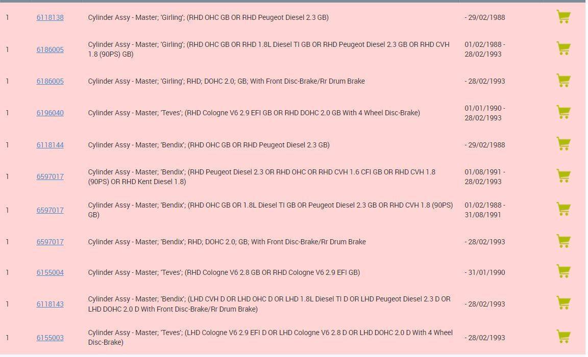

Peter C Posted April 28, 2024 Author Posted April 28, 2024 Right, back to the car. I was planning on replacing the brake master cylinder today. Access around the cylinder couldn't be any better. I stuffed lots of rags under the cylinder, including an old pair of pyjamas, in case of spillages. I used a syringe to remove as much brake fluid from the reservoir as possible. What came out was shocking. Some of the fluid looked more like mud. I removed the three pipe fixings and the two nuts that secure the cylinder to the servo, all nice and easy. The cylinder is in shocking condition. At this point I found out that the replacement cylinder is not the same as the old one. The distance between the fixing holes on the old cylinder is 90mm and about 70mm on the replacement part. Every eBay / AutoDoc / Google search points me in the direction of part number BBM 4068, which is the same as the replacement cylinder. From the listings, it appears that all Sierras, regardless of spec and age use the same cylinder. Apart from mine. I can't find any alternatives online. What do I do? egg 1
Peter C Posted April 28, 2024 Author Posted April 28, 2024 @egg Thank you! Looks like I need part number 6597017. Do you agree?
egg Posted April 28, 2024 Posted April 28, 2024 8 minutes ago, Peter C said: Do you agree? Not completely sure as that seems from 1.2.88 on? But the CVH doesn't have pre 88 listed 🤔
Peter C Posted April 28, 2024 Author Posted April 28, 2024 4 minutes ago, egg said: Not completely sure as that seems from 1.2.88 on? But the CVH doesn't have pre 88 listed 🤔 According to the eBay database, the cylinders are all the same for all Sierras but clearly that is not the case. I am now looking into having mine refurbished. egg 1
egg Posted April 28, 2024 Posted April 28, 2024 4 minutes ago, Peter C said: I am now looking into having mine refurbished. I notice the link I provided also has seal rebuild kits listed - but again - not sure what one!!
Peter C Posted April 28, 2024 Author Posted April 28, 2024 32 minutes ago, egg said: I notice the link I provided also has seal rebuild kits listed - but again - not sure what one!! Considering how manky the brake fluid was, I doubt that a fresh set of seals would solve the problem. The cylinder needs a proper repair. egg 1
egg Posted April 28, 2024 Posted April 28, 2024 It's a reminder though, that these cars are getting old (I know not in AS years!) and that even supposedly obvious parts for a standard Ford can be tricky. Joey spud 1
