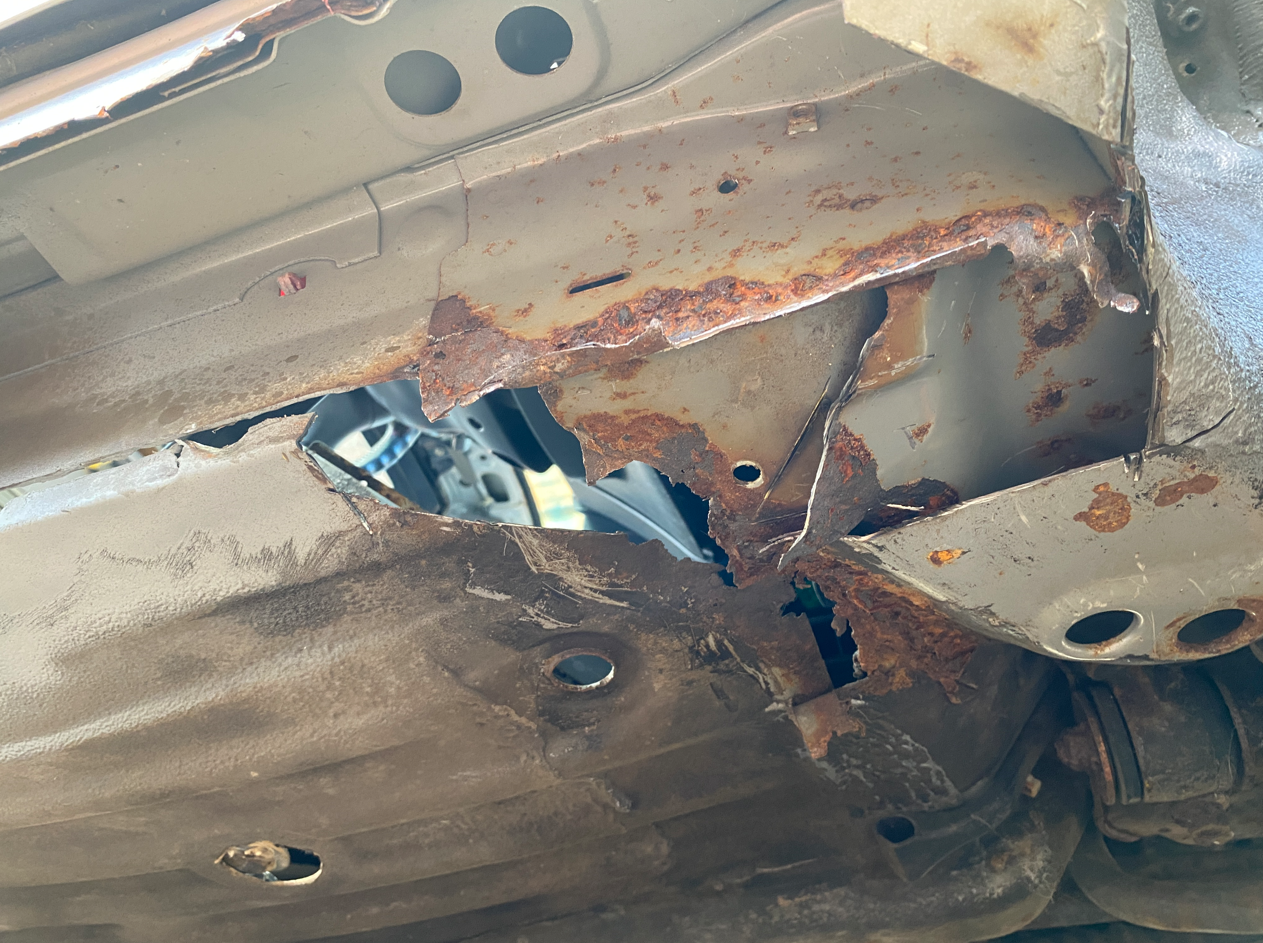

As you can see its pretty crispy, but to be fair, i have seen way, way worse on these, Especially the Rovers and MGs. Its quite an awkward place to repair, but after opening it up and seeing what it consisted of it didn't seem that bad in the end thankfully. It looked quite daunting on the outside, but as soon as i cut it out i was quite surprised how little it had spread up. The Problem is all the layers of metal joining and meeting up at that one seem, The sealer breaks down over time letting water in and just starts rotting it out. Very bad design to be honest as it also acts as a Scuttle drainage thats why it has them two big holes there.

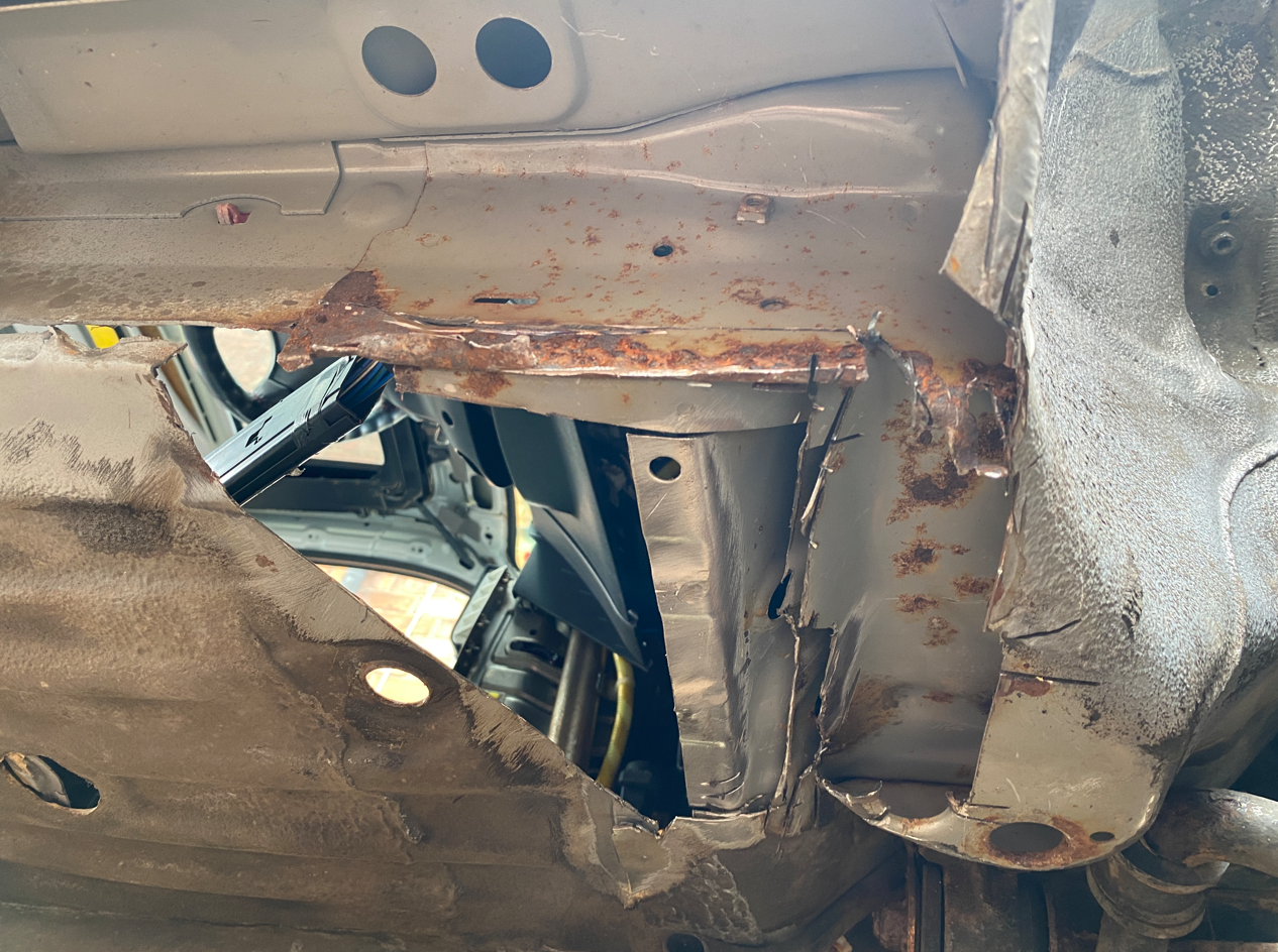

Heres what it looks like after me hacking at it with an angle grinder for about 30 minutes trying to make sure i dont cut too much off so i can get references.
It ended up being one of them places where i had to cut more out than i needed to just gain access to rust that was hiding. At this point i decided to just break down the repair, firstly by starting off with the floor section. The floor is spotwelded to the firewall panels, and curves around in the corner.
With some really dreadful welding as i was upside down, i managed to get the piece i made in. The Sharpie line is the line of the next panel that was to go over the one i had just put in.

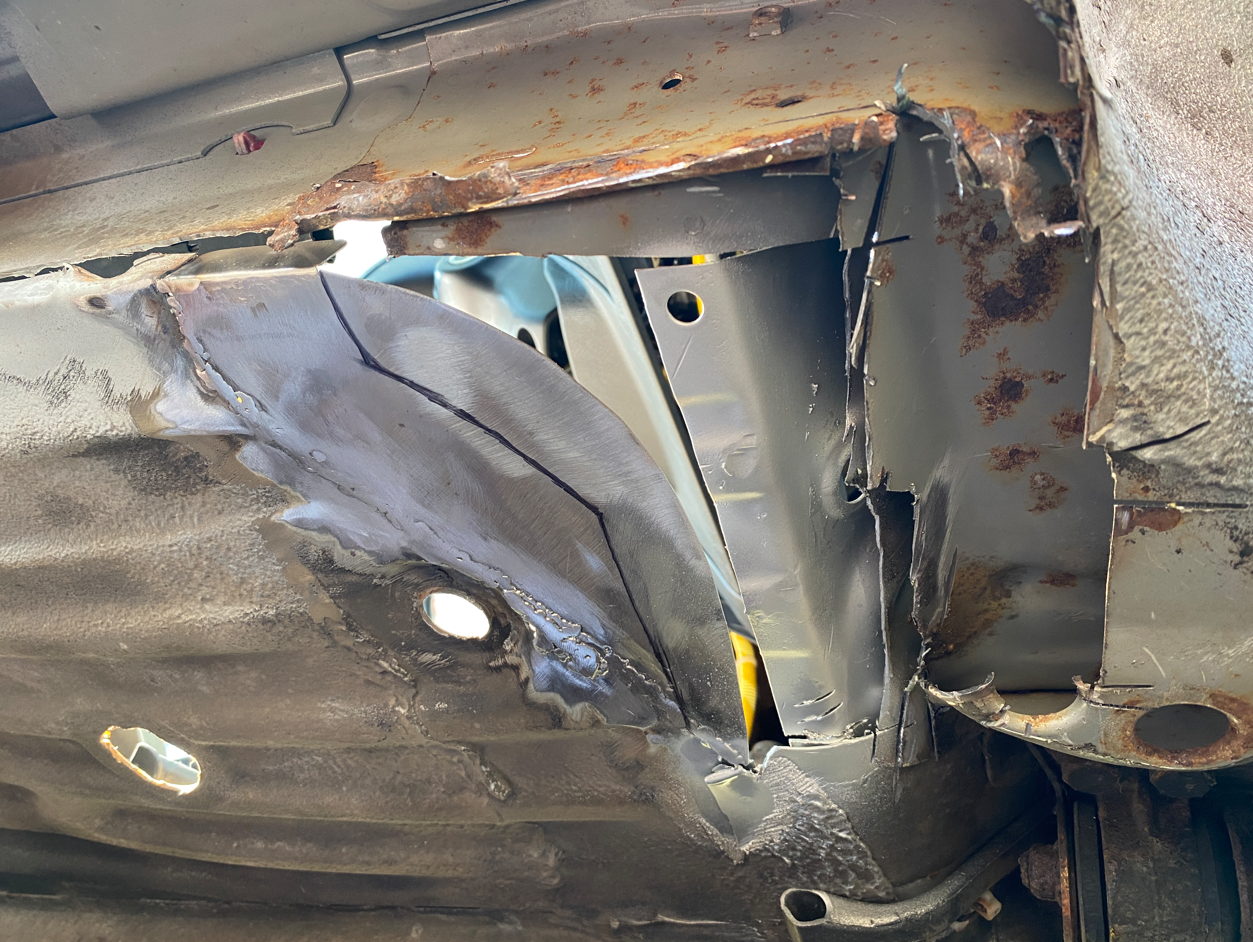

its been awhile since i did a post but the good news is that the jacking point is now all welded on the car!
the welds aint the best as i was working upside down, the main thing is they are holding and are strong. This section welded in is apart of the fire wall and finishes at the seam on the front floor. I wanted to replicate the seam from factory.

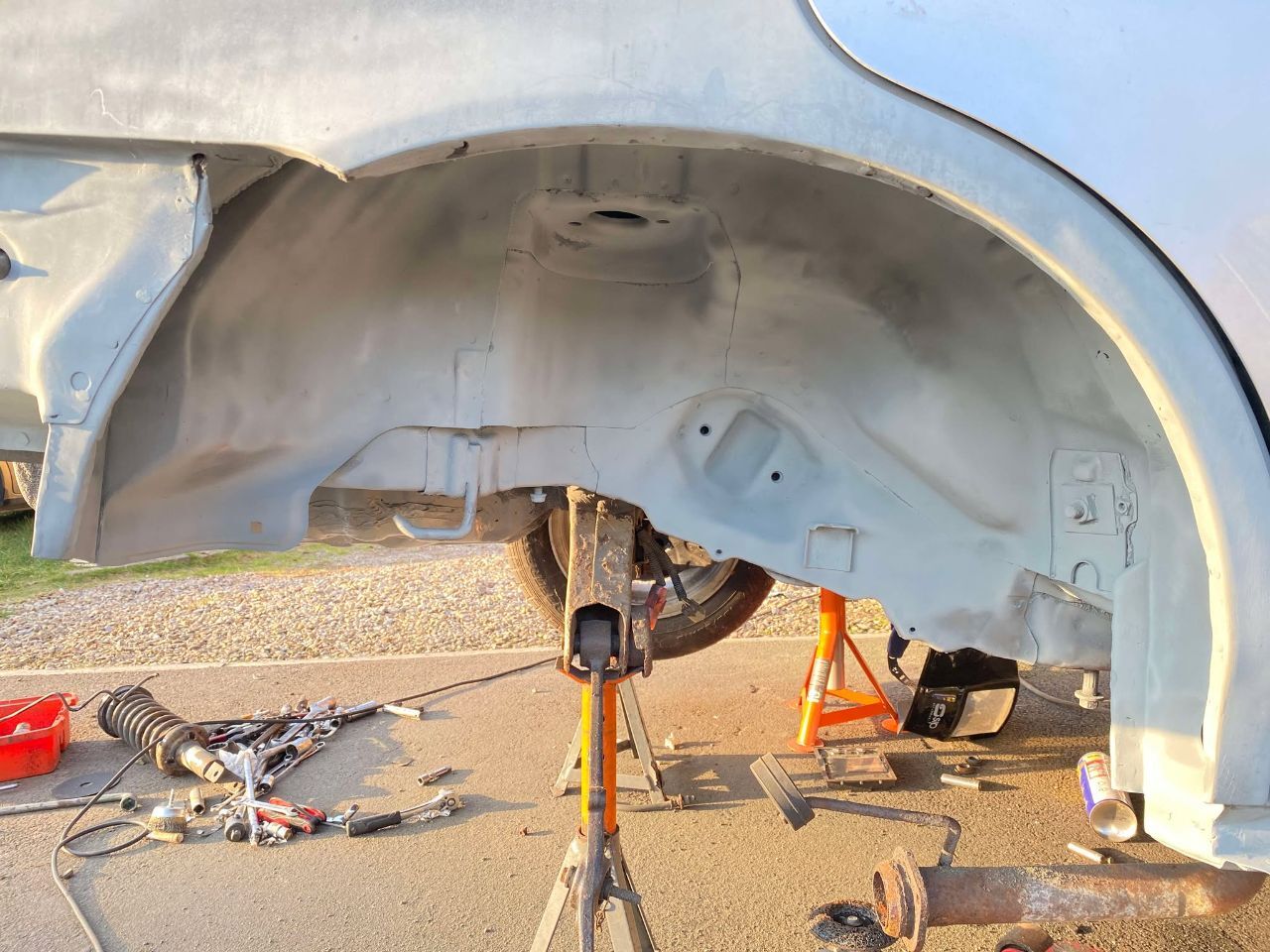

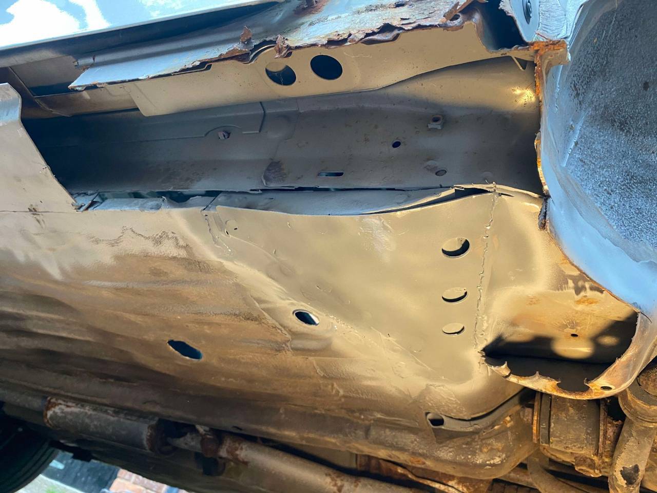

Today ive taken advantage of the nice spell of weather and decided to get back on with the Honda after winter. with her being outside i was worried about the work rusting, however it has held up really well! Cheers Bilt Hamber!
So today i have decided to start stripping the old underseal starting with the driver side inner arch at the rear. it was a pain to do but it will be worth it in the end. Just got to do the rest of the car...
So its been stripped back to bare metal and has been coated in Electrox Zinc Primer. I will then Epoxy the arches tomorrow along with seam sealing.
I also included a good before photo of the arch prior to all the work i have done!
482845769_467445046336577_1734186567724348012_n.jpg.a805a9b95d2050d424366c14827ca0f1.jpg475854423_1774353826469145_7590113575974071547_n.jpg.df2962144d2e33b75d47ae647651e5e4.jpg477053227_495009033675148_8798500964369879339_n.jpg.dd6df2295570109d991a501835ebe60a.jpg
Managed to get the Inner arch all Epoxy Primed! Whilst waiting for it to cure, i started to strip down the underside of the old waxoyl, the Factory E Coat has come up really well, so im deciding to not bother stripping it back to bare metal and to only focus on any blemishes of rust, i think it would be a waste of time to ruin this coating, and it will also save me a massive amount of time. So the idea is to key the whole underside  instead with 180 grit in order to apply the epoxy to it so that it adheres. Im hoping i can get the back end all painted by the end of the month. Its going to get colder again unfortunately so ill be doing jobs off the car such as sorting out the trailing arms, making brake pipes etc so that when it comes to painting and stonechipping i can get the bits back on quicker.
I still need to Seam seal, im going to wait 96 hours for this epoxy to fully cure then it can go on.

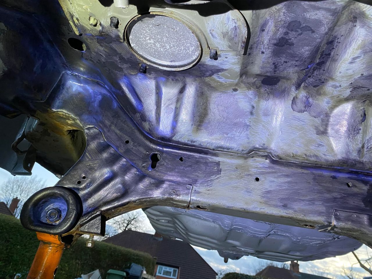

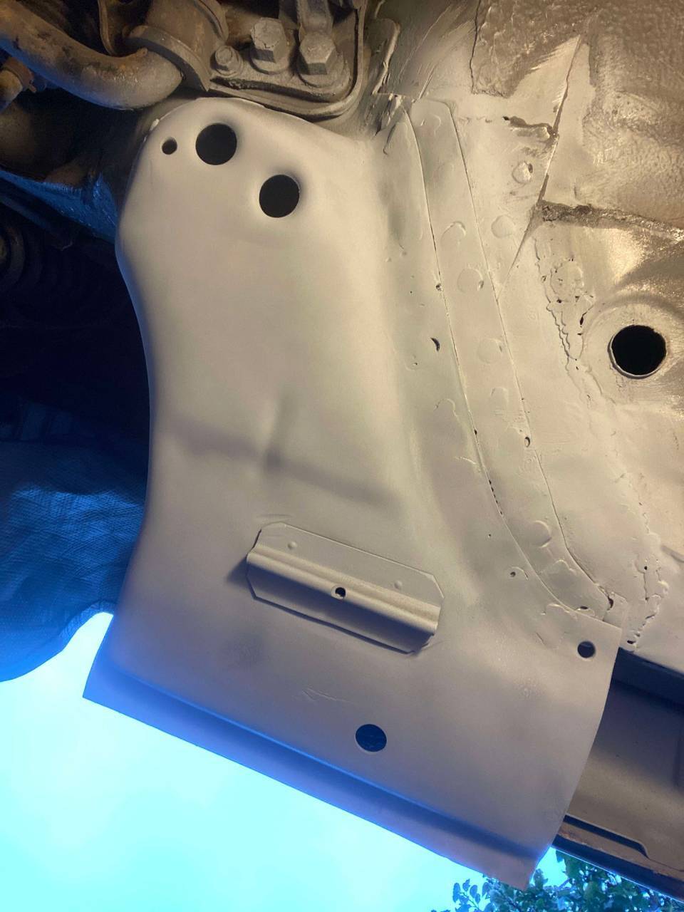

So i started to strip down the underside bit by bit after work, 2 hours here, 2 hours there. and today i managed to get the epoxy on one section! very happy with it. I Just hope the Epoxy Primer actually sticks this time as ive had a few issues with it in the past being able to pick it off with your fingernails. Im hoping by applying it by stippling the brush, itll have a much thinner layer on and plus less brush strokes and gives off a nicer looking texture. Not sure as to why i could pick it off as ive done plenty of keying, and degreasing. i think the method of application was potentially wrong and i was applying it a bit too thick. Lesson learned though. Thankfully i didnt apply any epoxy inside the cavities when welding otherwise that will have been a PITA.
Some more work done tonight after work, thankfully this section where the fuel tank goes is now all fully ready for painting. Ill be doing that tomorrow. Ive given the E-coat a good key with a wire wheel and any bits of rust have been dealt with Hydrate 80 the rear crossmember has come out quite nicely albeit there was quite a bit of surface in some places however that came off quite well with the wire wheel. Also good news the Epoxy has set ROCK hard the technique i used has worked really well by stippling rather than brushing and has left a really good texture. I honestly dont think the underside will need stonechipping. i will probably aim to just prime over the epoxy, then base coat then lacquer and finally Lots of Dynax UC.  As for the arches and back of the inner sills i will be using Gravitex.
