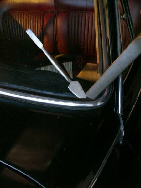

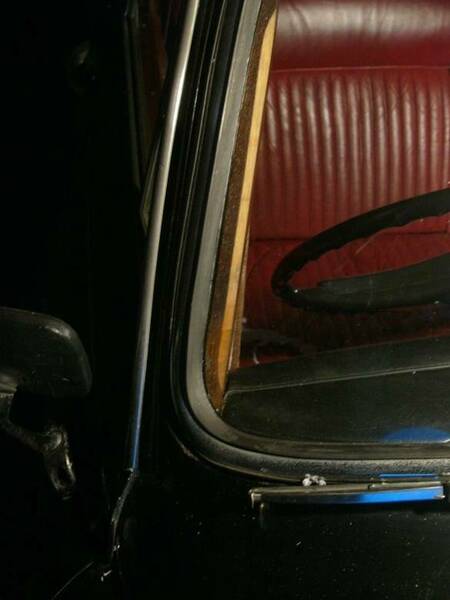

Bfg Posted November 2, 2023 Author Posted November 2, 2023 I'm not moving very fast on this, not least because I've been fitting ram pipes within the air filters of my TR4, Katie < here > and then also swapping out her seats. But the plan for tomorrow is to drive up to nr. Downham Market, where those Norse Folk live, to see my friends Mathew and Justine. Mathew loves his Triumphs and Justine is supportive to the point of her even coming to our Triumph Sports Six Club meetings and being socially active. She's one special lady. Mathew has kindly offered to help me tidy the Daimler up - so I'm hoping to drive, pending floods and other obstacles, the 65 miles so that he can have a look. ...But as the car's windscreen rubbers leak ! and because of the present weather situation - I really wanted to have a go at sealing around the windscreen today. Rain water dribbling down the back of the walnut veneered dashboard and onto my right ankle isn't what one expects when driving a distinguished motor car. so . . . ^ I eased open up the rubber windscreen seal to vacuum out the soil deposit., having previously been shopping for a suitable sealant which I found at my local, and extremely helpful windscreen replacement specialist - Gold Windscreens, Martlesham, Ipswich who very kindly provided a tube of the above, together with a spray pot of appropriate glass cleaner, and copious lashings of helpful advice. The task of oozing said sealant inbetween the rubber seal and the windscreen glass went well enough. As a novice, the technique I used (but did not take a photo of ..because I had my hands full) was to draw an old n' rounded flat blade screwdriver along the rubber to open up the seam, and to immediately follow along behind that with the nozzle. It would have been very much easier with two persons ! Job done and the excess firstly scraped and then wiped away (on industrial blue paper toweling) and then the residue was cleaned up with the solution provided. I did another run with the sealant, this time very tightly into the corner, because somewhere along the past 55 years - the old window rubber had lost it suppleness, so having been pulled away it was not pinching tightly closed again. Job neatly done. Hopefully tomorrow will be dry and bright anyway Pete Garythesnail, DVee8, rainagain and 6 others 9
Matty Posted November 2, 2023 Posted November 2, 2023 Ooh I need to do this. Both my front and rear screens leak on supposedly new rubbers (not fitted by me). I'm in no rush to start taking screens out! Please let us know how successful it was after tomorrow's drive Pete. Both cars are looking stunning. Daimler for me if you find yourself giving one away 😄 Bfg 1
Bfg Posted November 2, 2023 Author Posted November 2, 2023 I'll let you know Matty, how well the screen is sealed. I've only done the sides and across the bottom, but I think that should sort out 99% of the trickle. Let me restore the Daimler for you before I give her away ! Pete Matty and loserone 2
Matty Posted November 2, 2023 Posted November 2, 2023 How kind! It doesn't look like it needs much, although having read a lot of the thread it will no doubt be perfected. I hope the screen sealing works as then I will definatly be copying. Good luck for the trip in this weather!

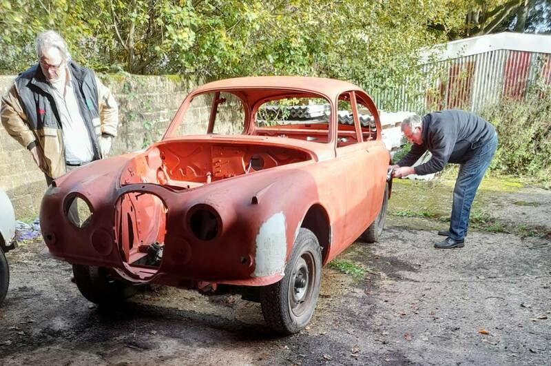

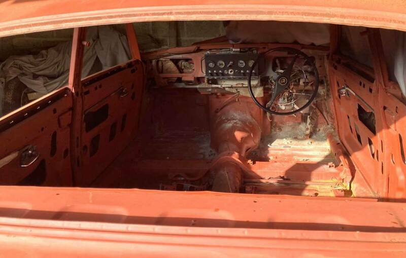

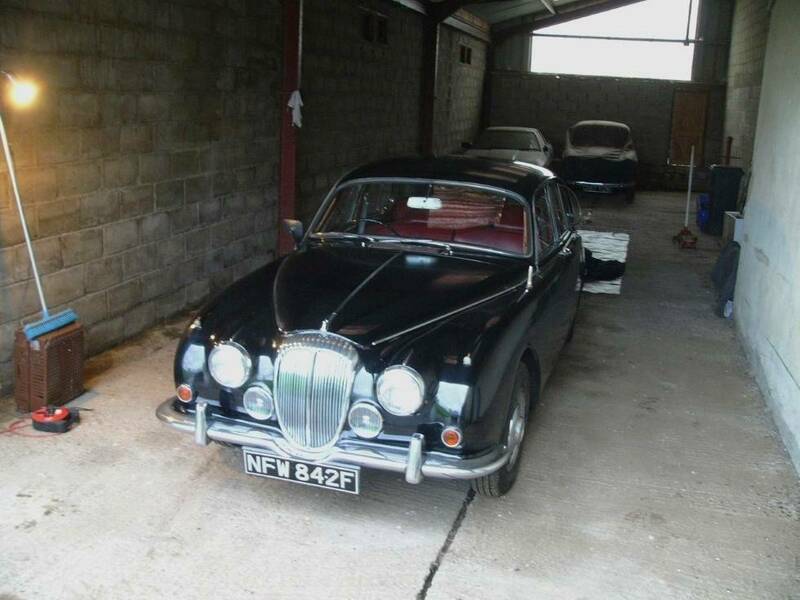

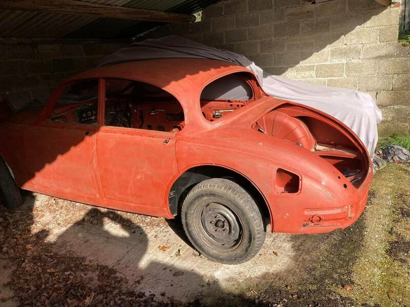

Bfg Posted November 5, 2023 Author Posted November 5, 2023 I suspect the following, taken yesterday, may start you wondering . . . Matty, barefoot and inconsistant 1 2

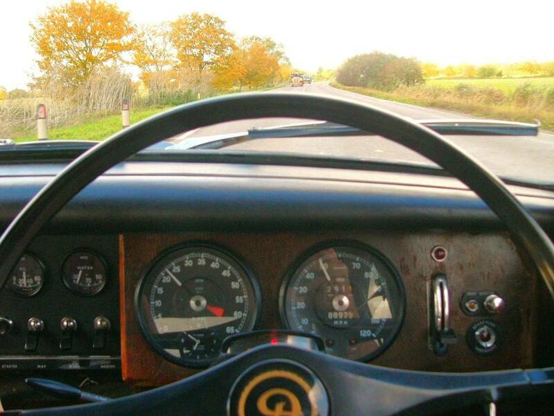

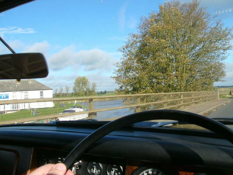

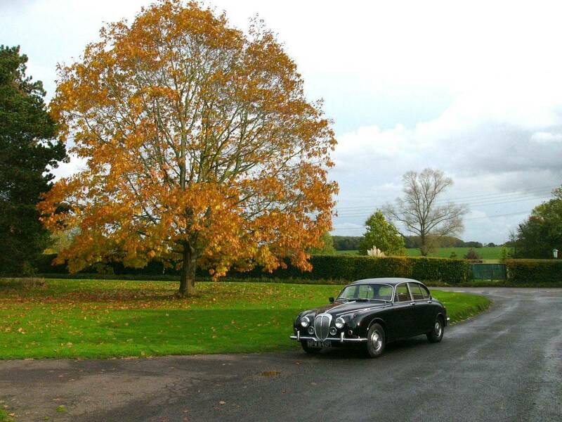

Bfg Posted November 5, 2023 Author Posted November 5, 2023 From Friday .. no rain to test the windscreen sealant but I'm sure there will be before too long. . . ^ Norfolk where the land is flat and the blue skies have a particular expanse. ^^ In overdrive top, just poodling along behind lorries. ^ View down the (un-polished) bonnet as I picked up the pace along the clear roads skirting the ever beautiful Thetford Forest. I love driving through sunlit woodland, especially as their colours turn autuminal. ^ Back to my enjoying driving through Suffolk countryside. "since the last MOT in 2017 - the car was only driven a further 200 miles before I bought her." She's now clocked up another 435miles ..in two weeks. I've discovered she's not so handy where the roads have roundabouts every half a mile, but for all else - I like Pete Matty, inconsistant, High Jetter and 8 others 11

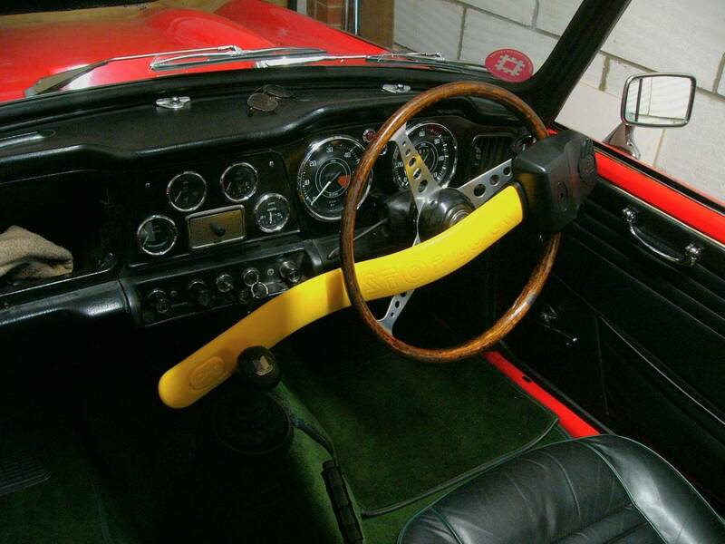

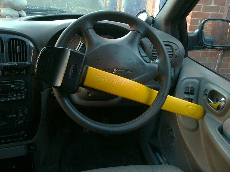

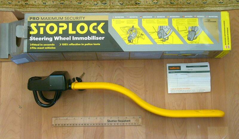

Bfg Posted November 7, 2023 Author Posted November 7, 2023 Not much happening this week, but I had noticed how very insecure these cars are, what with both front and back opening quarter-tlight windows and locks which are of brass and so badly worn that any old car key can be wiggled to open the doors. So for when the car is being left in a vulnerable location I've just bought one of these. . . This steering wheel immobiliser is the higher security Pro model of the Stoplock range, which gets good reviews (NB. the Elite model of the same device has a deep offset for fatter steering wheels). After looking on-line, including for a second-hand one, I bought this new (with 2 keys) from Halfords. They presently have them with a £10 off RRP, and then another 10% off when buying on-line and free postage over certain order value. In total it cost just a few pence under £35 delivered. Either or both are of course only a deterrent, especially when steering wheels on classic cars may be wood rimmed with easily snipped through aluminium spokes, but it is quick n' easy to use, and an obvious nuisance to would be joy-riders. Even though you may otherwise also have an ignition immobiliser, that's not known about until the vehicle is broken / smashed into and tried to be started, and then the dashboatd ripped out to be hot wired. Better to move them onto another, quicker and easier target because of a deterent I think. Because it's universal fitment - it also means that I can use it on other cars. Who knows I might even configure it around the frame and through the spokes of my motorcycle. I'm sure many of use have cars parked up and left unattended, possibly for weeks on end. Food for thought perhaps ..and a great price from halfords. Pete p.s. I’m not telling the insurance company because they’ll insist it’s always on the car when parked. lesapandre, Low Horatio gearbox and rainagain 3

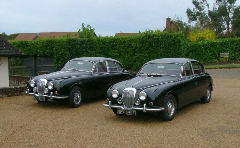

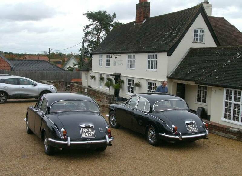

Bfg Posted November 9, 2023 Author Posted November 9, 2023 Here is something you don't see very often .. Two Daimler 250's, 1968 and 1969 respectively, each in black with red leather, each with less than 90k miles on the clock (genuine), and each with manual / overdrive. Tony's owned his for some 20 years now, and I've own mine for some 20 days now. His is in very beautiful and original condition complete with chrome wires and PAS ...but I'm still delighted with mine (..the one with the lesser shine). I've just met Tony through a Facebook Daimler group, and so this was our first rendezvous to talk about these cars over a cuppa. He very kindly agreed to take me out in his (I asked, as he seems very modest) ..so I might know what to expect in terms of ride, comfort, driver response, noise levels, oil pressures, etc., etc. The steering wheel is an aftermarket one, but it's a nice compliment to the Daimler's original wooden dash and A-post trim. Pete p.s. on the way home I stopped to take this village green photo of my car . . . RayMK, tooSavvy, DSdriver and 7 others 10
ETCHY Posted November 9, 2023 Posted November 9, 2023 Tbh I always preferred these with the steel wheels & hubcaps, somehow suits the car better imo. I still hate that fucking door mirror 😄
Bfg Posted November 9, 2023 Author Posted November 9, 2023 I certainly don't mind the steel wheels on the Daimler, so have no plans to change them. I'm happy for those who have Jagwaars to keep their spokes. lesapandre 1
High Jetter Posted November 9, 2023 Posted November 9, 2023 2 hours ago, Bfg said: I certainly don't mind the steel wheels on the Daimler, so have no plans to change them. I'm happy for those who have Jagwaars to keep their spokes. That thought came to me earlier, looking at the 2 side by side. Daimler was the more refined brand. lesapandre 1
lesapandre Posted November 10, 2023 Posted November 10, 2023 I don't think the Daimlers were originally sold with wires - it may not even have been an option? The average Homburg-hatted Daimler owner would have considered that too racey. Likewise the MK2 Jags - fewer were sold on wires...but... When values of Mk2's moved from the 100's of £'s to the 1000's of £'s - 1980-90 - the trade tarted them up with wires to increase their value - that - some chicken wire, wob and a blow-over in lipstick red. 😂 Owned by bank robbers innit. Low Horatio gearbox 1
