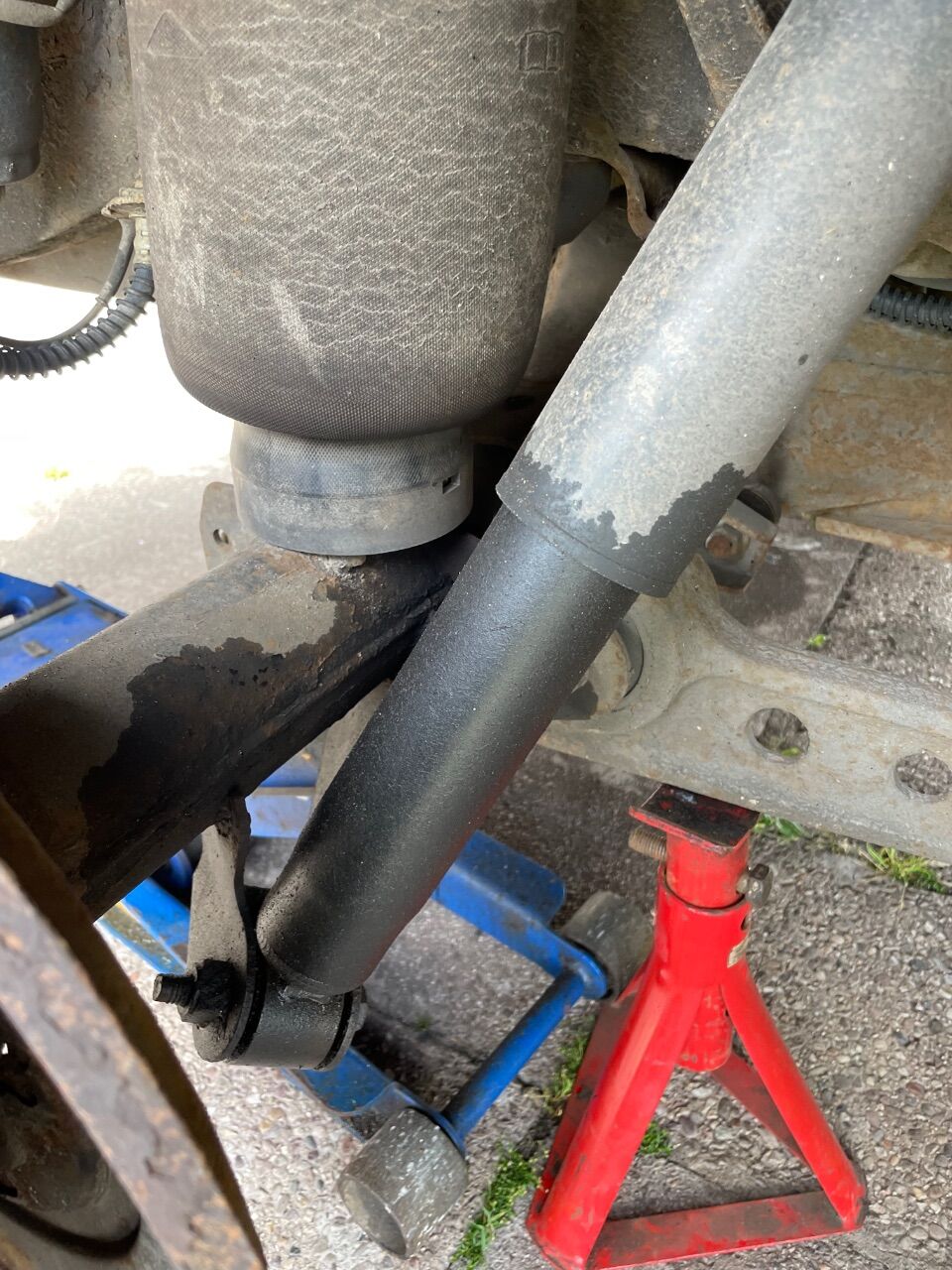

After noticing the new rear shocker leaking on the drivers side, I picked up a set of shockers again with the intention of taking the others back next week. Options for good quality standard shockers are limited. The PR2 are now naff, or there’s “All makes” which I’ve heard bad stuff about, or there’s genuine, which are much more expensive. So I’m trying these All Makes.
that shocker is just under 12 months old. I kind of wish I’d just rebushed the old ones.

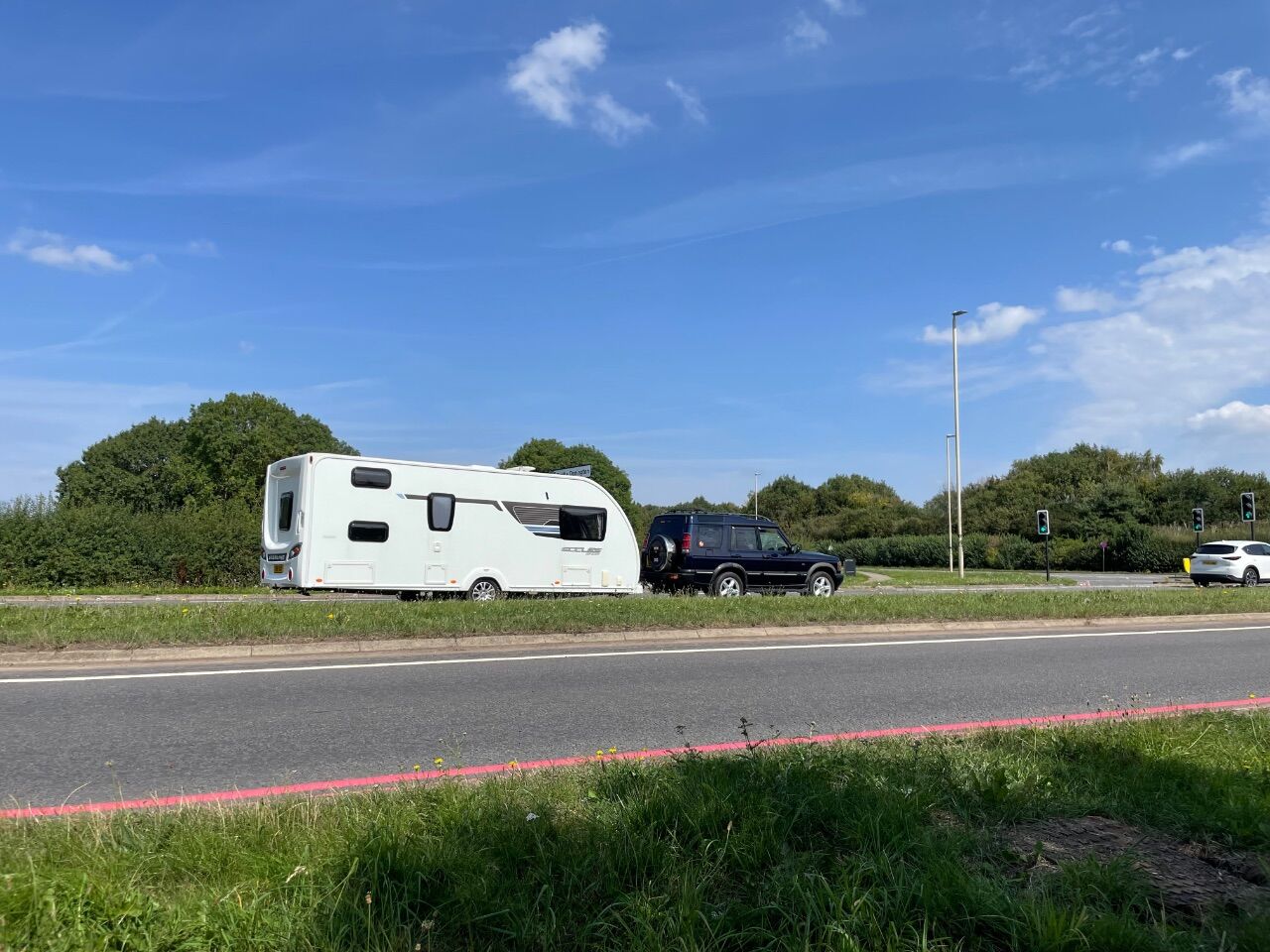

We went to convoy in the park last weekend and left around midday Monday. Got a mile from the campsite and lost drive at a set of traffic lights right outside donnington park.
luckily rolled it back far enough to get traffic past.
AA called, family put in a safe location. 2.5 hrs we were stuck there. Only about 48 miles from home.
first time on the big taxi.
this was a “safe tow” to get us off the lights. We were taken to shardlow services on the A50 and dumped in the car park. AA said next relay 5mins away.
and hr later and I got bored, I lay underneath and buggered about with the transfer lever, box had slipped into neutral and needed wedging in with cable ties and hopes and dreams. Got drive back, hooked up and got the hell outta dodge. will fix that this weekend maybe.

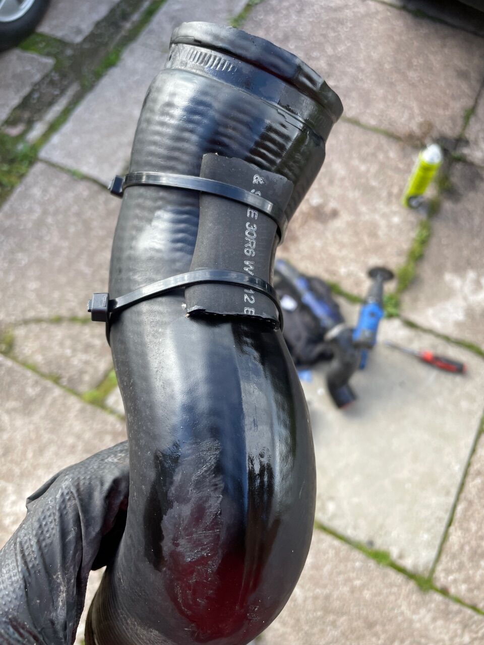

first things first, there’s a sound of rushing air under acceleration which was quickly diagnosed as the intercooler to manifold hose.
nice split there. No one local stocks a replacement so I’ve ordered a boost hose kit off Empire tuning which is coming tomorrow.
I’ve bodged that for now, by applying rubber pipe and cable ties to save complete failure.

boost hoses arrived this afternoon
here’s the one I bodged yesterday, which didn’t work
the turbo pipes removed, the metal pipe was a bit rusty so covered that with rust converter before refitting.
and what is it with silicone hoses? The moment you touch them they’re dirty. Looks like they’ve been on for 12 months already
