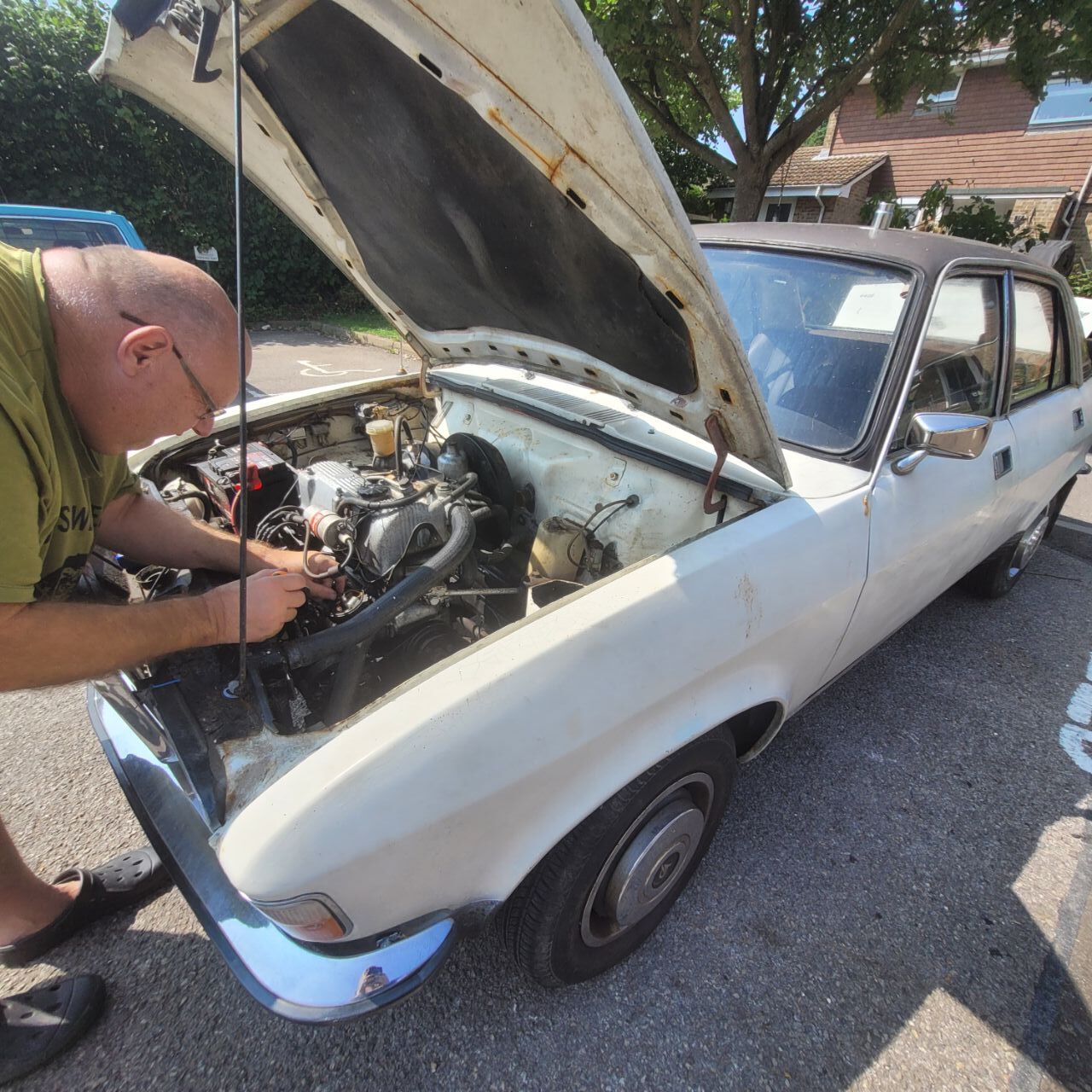

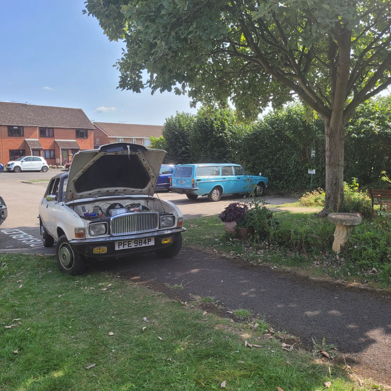

Drove the old VDP to my friends house in Bishops Waltham today so we could have a tinker, aux belt replaced with a shiny new one 'though i actually did that yesterday', points were essentially touching so widened the gap a smidge, also got the rear lights working, turned out to be a split right in the middle of the loom, filled the dash pot as it was bone dry and adjusted the little carb so its idling in gear now and actually quite happily goes in reverse, well you have to wait about 3 seconds after selecting reverse and then you'll feel it start to move back which is still a vast improvement over before as it used to only go in reverse on a completely flat level at extremely low revs and even then it was hit or miss , though on the drive back the indicators packed up, hazards still work though so probably knocked a fuse loose when we were messing with them?
I may have been a little harsh about this car, whist I'm still not madly in love with it, I certainly appreciate it a little more than I did
  • Weird Car changed the title to Weird Car’s weird cars! ‘VDP IMPROVEMENTS'
So after removing and cleaning all the fuses I now have indicators back, and as a bonus it also fixed the 12v socket and horn!
