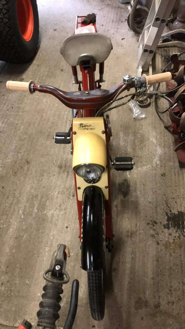

I managed to sneak in a couple of hours going through some basic checks, cleaning and lubricating the little Norman and am pleased to report that all looks to be in good shape. No rounded nuts/bolts to report, even most of the slot heads are very unmolested.
A turn of the peddle and she’s keen to live.

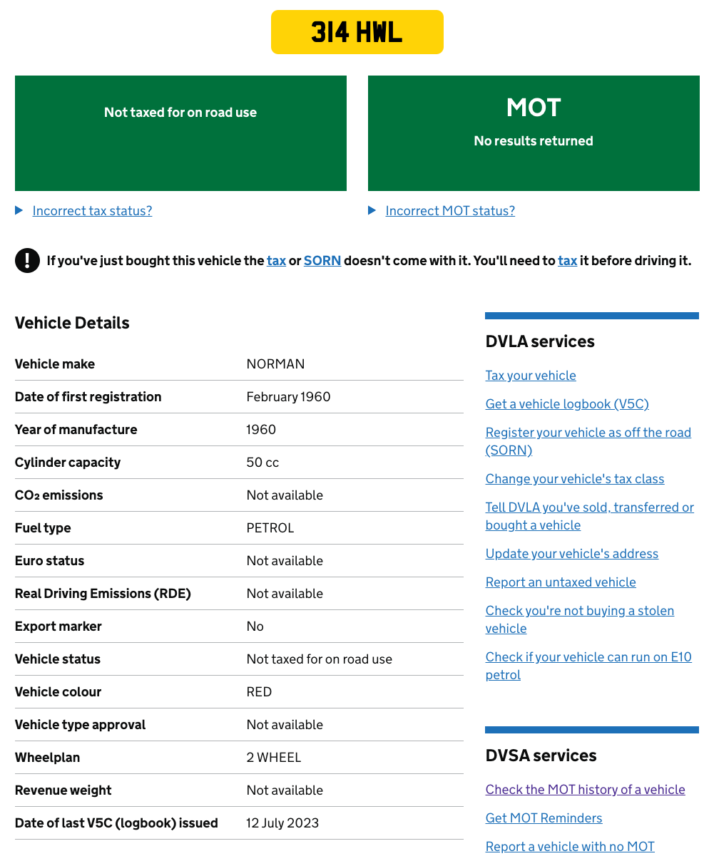

after many decades asleep indeed! not taxed for on road use, means its never been taxed since it was computerised!
48582942_Screenshot2023-07-15at19_43_33.thumb.png.5bf07df40e52ef9e5489accffee769cd.png
means it may of been off the road even longer then Brian had been! since its clearly not been taxed since the late 70's if not earlier

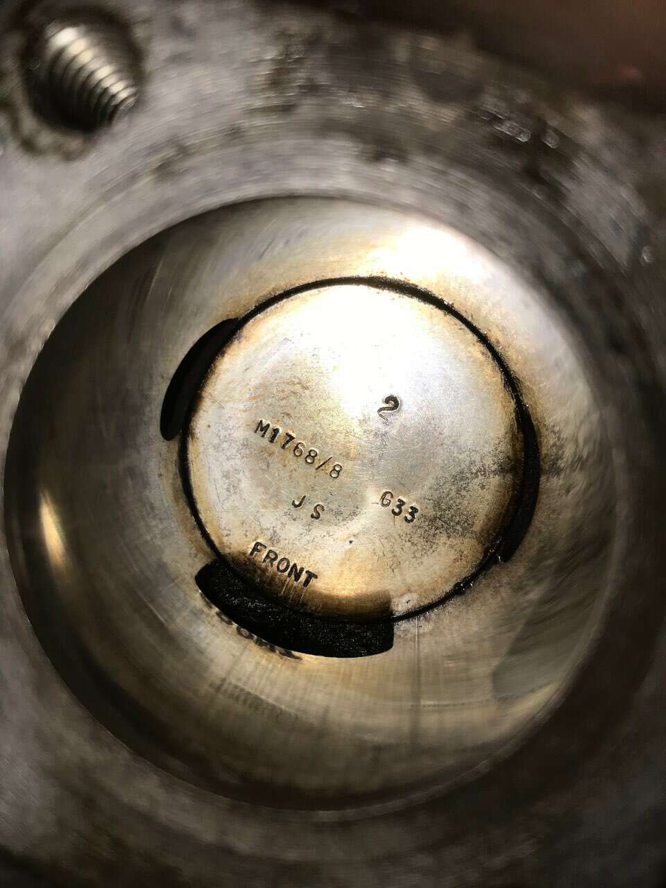

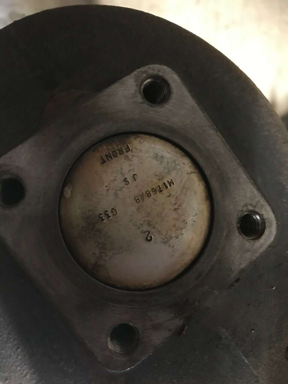

The head has been off to see if a de-coke would be necessary. That’s a definite no then, all looks very well in here.

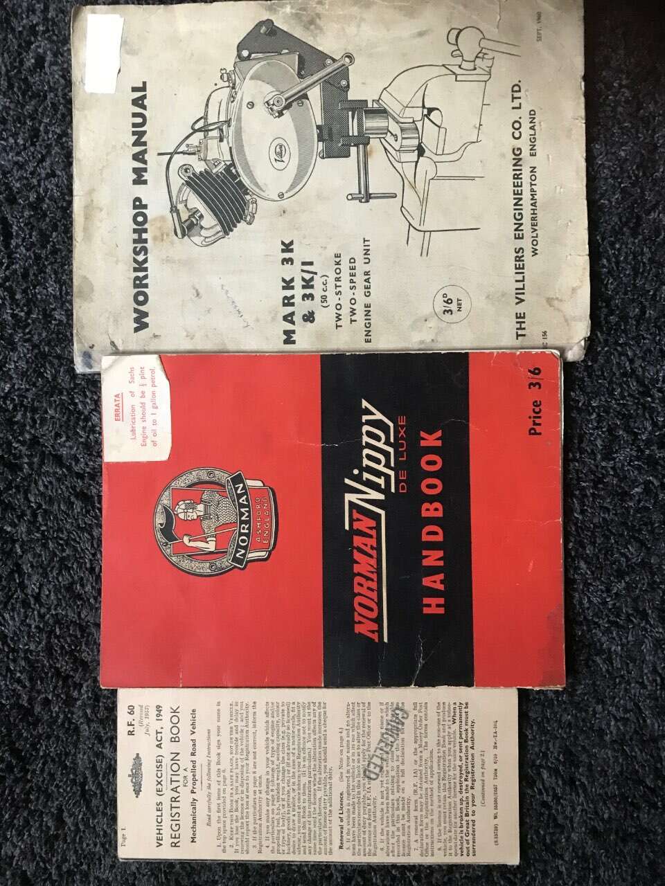

It also came with a handbook and I’ve already found a Villiers 3k handbook to keep with them.

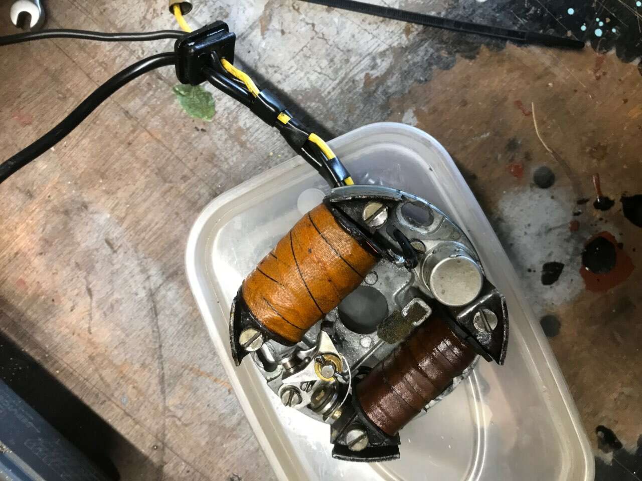

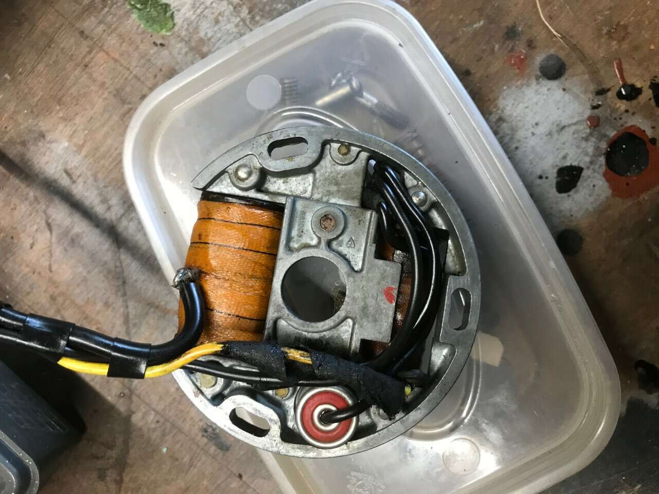

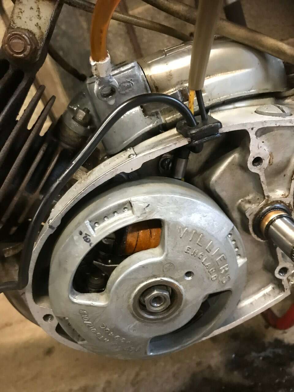

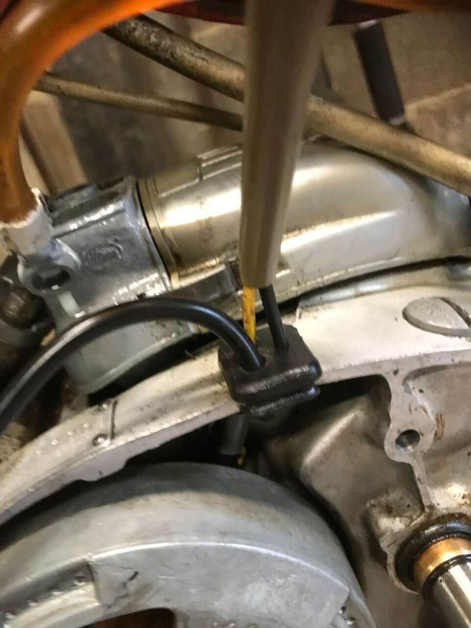

Okay, as requested by LBF some tinker notes to avoid him being reprimanded 😉
Further work has involved flushing the fuel tank, cock, pipe and filters. The carburettor was fully cleaned and blown out and a new gasket made for the chamber tops, the gasket was incredibly fiddly due to its size. It has also been noted that the throttle cable was hanging on by only two strands and so new components should hopefully be winging their way to me soon.
On the ignition side of things I noted there is no ignition kill wire despite the wiring diagram stating that one should be present and the handlebar switch incorporating a kill button. The flywheel/magneto popped off of its taper much more easily than the majority of Villiers engines I’ve worked on and indeed with the backplate removed I could see no trace of the wire. Another fiddly job, a new wire was soldered into the low tension at the points. Everything was replaced carefully and the new wire pushed through the cover plate grommet hole where it was always supposed to reside. My guess is that many years ago new ignition components were fitted but it was felt unnecessary to struggle as I did with the extra wire, after all the engine can be killed at the throttle if adjusted to suit. I however want to be able to let go the throttle and still have the bike tick over, as Norman intended.
Of course while the flywheel was off the points were cleaned and the gap set and also the felt cam wiper had its first few drops of oil in many a year.
