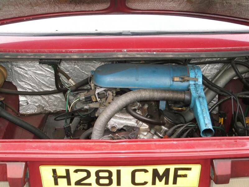

Zelandeth Posted January 27, 2024 Posted January 27, 2024 Important safety tip as a former owner of several Estelles: Don't be tempted to fire it up without the throttle return spring fitted. It will seem to return just fine, right up till the first time you touch it with the engine running. Also as far as alternative air cleaner mounting goes, the fuel injected version used a clip same as the intake duct side to hold the air cleaner to the throttle body. wesacosa, rob88h and tooSavvy 2 1

Zelandeth Posted January 27, 2024 Posted January 27, 2024 It normally runs from a little hole in the air cleaner bracket (the one that clamps under a rocker cover nut) and the throttle arm itself. Annoyingly I can't find a clear photo of it in situ because stuff is in the way. You can just hook it over the rocker cover stud for testing, but I suggest adding a zip tie so it can't ping off into low earth orbit (or into the side of your head). wesacosa 1

Zelandeth Posted January 27, 2024 Posted January 27, 2024 Found one photo of the aforementioned spring lashed up in "service mode." As I recall that was about 30 seconds before it escaped and exited into the scenery after bouncing off my right temple and making me fall into a rose bush. Hence my suggestion of a zip tie! tooSavvy 1

Zelandeth Posted January 27, 2024 Posted January 27, 2024 If in doubt rummage around in the deceptively huge voids behind the rear wheel tubs. They can eat an astonishing amount of tools and components while looking totally empty. To test the engine out you could even just use a couple of rubber bands. It's just a helper spring as the internal one isn't strong enough to overcome the drag of the long throttle cable in this application. If the cable isn't hooked up yet you should be fine. Just mind your eyebrows as these aren't shy about spitting back through the carb if running lean, especially when cold. wesacosa 1

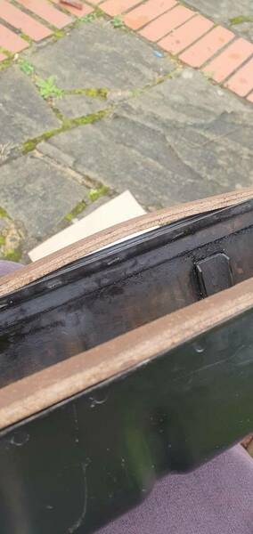

wesacosa Posted February 17, 2024 Author Posted February 17, 2024 why is it that even the small jobs somehow turn into epics Trying to fit a rocker cover gasket but the Estelle ones are cork only. not sure if my rocker cover has distorted a little but I've spent two hours fucking around with it and just can't get a satisfactory fit the one I took off was rubber but they never did a rubber one for the 1.2 Estelle so no idea what ita off. Probably a 135 rapid or a Favorit
plasticvandan Posted February 17, 2024 Posted February 17, 2024 Always used to stick cork rocker gaskets on with hylomar or similar on reliant rockers,mainly to stop them falling off when trying to shoe horn them back in the engine bay.you may find soaking it in hot water for a while aids finding its shape wesacosa and SiC 1 1
wesacosa Posted February 17, 2024 Author Posted February 17, 2024 was looking to use hylomar as I'm a big fan but its nowhere near fitting. soaking might be worth a try though. ta
