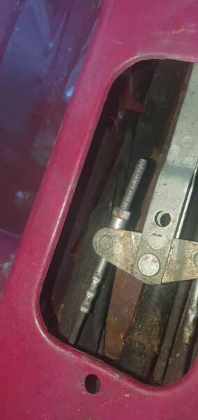

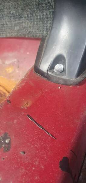

wesacosa Posted May 27, 2023 Author Posted May 27, 2023 10 minutes ago, Zelandeth said: The pipes in the tunnel are metal (at least were on mine) though there is a hose running between the riser where it comes out and the heater matrix which can (and do) leak. Indeed can let go when you're doing 70 and douse your left ankle in scalding hot coolant. Wakes you up quite effectively that one. If it's still present, be VERY careful removing the plastic shield that covers those hoses, they were incredibly fragile and nigh on impossible to find intact 20 years ago when I got my first Estelle. the hose is rubber, it looks like heater hose and judging by its look and the clips on it , its original Where is the shield you mention?

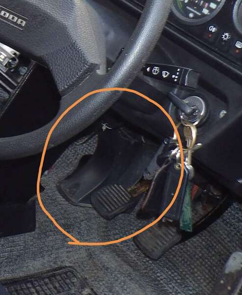

Zelandeth Posted May 27, 2023 Posted May 27, 2023 1 hour ago, wesacosa said: the hose is rubber, it looks like heater hose and judging by its look and the clips on it , its original Where is the shield you mention? This one. Which may well already be missing. Most are. wesacosa 1
wesacosa Posted May 27, 2023 Author Posted May 27, 2023 ah ok gotcha. ta. No its still there! although small crack in corner not sure if I caused that taking carpet up or not 😳 The leak is actually further back. can't quite see in pictures but this is the cover behind the handbrake and there are two rubber hoses running through there uk_senator 1
Zelandeth Posted May 27, 2023 Posted May 27, 2023 Ah, I've never done battle with the plumbing at that end I'm afraid so can't offer any hints there. Good the trim panel is still there at the front, only one of mine has ever had it. wesacosa 1

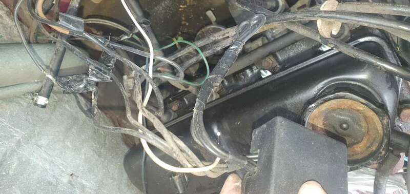

wesacosa Posted May 30, 2023 Author Posted May 30, 2023 noticed the voltage regulator didn't look like one I saw in another picture. Seems its an after market. Took it off and found what every shite car purchaser fears, someone elses bodged wiring. Hoping they have just cut the plug off and soldered it to the loom of the new regulator but who knows. Crappy Haynes wiring doesn't give wire colours too so this could be fun I think this car is going to be a lot more work than I bargained for. I also think I overpaid for it as its not quite as nice as I remembered. Still, onwards and upwards. Should be done just in time to start paying Khunt £12.50 every time I drive it uk_senator and Rust Collector 2
wesacosa Posted May 30, 2023 Author Posted May 30, 2023 A bit of further poking around and my suspicion was confirmed. The black box attached to the voltage regulator fixings isn't an after market VR but the control box for the 90s aftermarket immobiliser. There are two black wires and a white wire which run from the immobiliser key switch to the black box. They run along the floor and through a grommet in the rear bulkhead. Somewhere between the bulkhead and the engine compartment they pick up two thicker brown wires and all go to the control box. Looking at the alternator its not original so I assume it must have a built in regulator otherwise the car has no regulator (Which may explain why it keeps blowing washer pump motors?) I can't find an sign of the original plug or wires that went to the OEM regulator. Given it looks like a professional* installation I am now less worried about random bits being arsed about with but I think I will try and figure out how it works so I can remove it and have one less thing to potentially leave me stranded by the side of the m25. Surely can't be that hard to remove?! rob88h 1

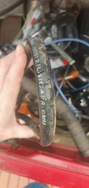

wesacosa Posted June 23, 2023 Author Posted June 23, 2023 not as much progress as I'd hoped. Lots of time waiting for bits to arrive. I have binned off the Immobiliser as it turns out all it did was interrupt the ignition switch to solenoid. I fitted new ignition system and Gammatonix power driver ilo the condenser. I now going through replacing fuel hoses and rebuilding the carb. lots of crispy rubber to be found somewhatfoolish, Back_For_More, Dyslexic Viking and 4 others 7

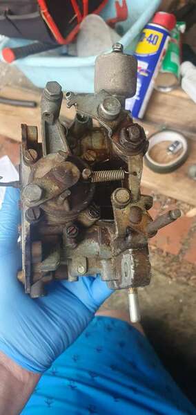

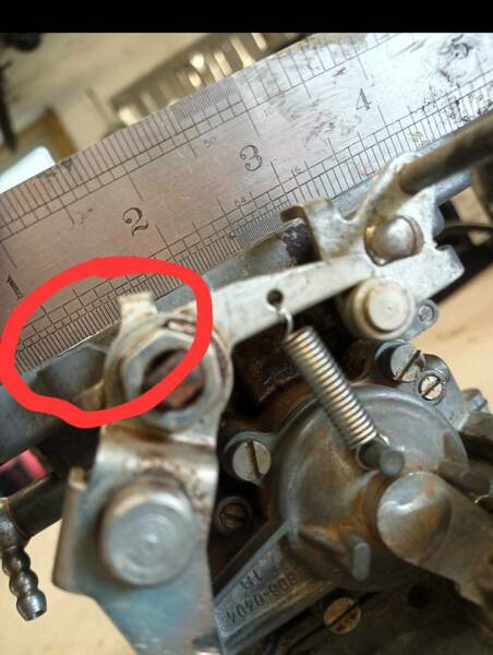

wesacosa Posted July 1, 2023 Author Posted July 1, 2023 Still not managed to get it running yet. Ignition system all done and carb now stripped, cleaned, serviced and back together but really struggling to get the float height set. Manual gives two values one for the horizontal settings when the tab just resting on the valve ball and the othet when you push float fully down. I just can't seem to get them both in the box. spent about three hours today fiddling with it but no closer..Super frustrating as time to the ULEZ deadline and FoTu is ticking away uk_senator and tooSavvy 2

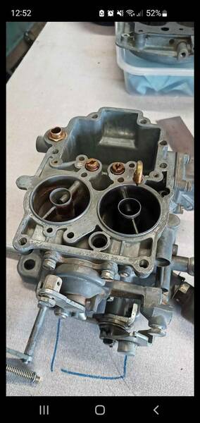

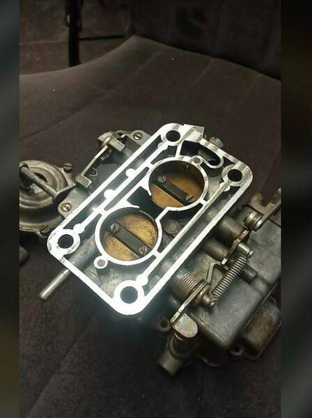

wesacosa Posted July 3, 2023 Author Posted July 3, 2023 Bit of a blow today. Got the carb rebuild done but looks like the lid is bent out of shape ( a common issue apparently). I had checked the surfaces with a set square during stripdown but had somehow missed this. Really gutting as I'm not sure how easy its going to be to resolve but probably final nail in the FoTU coffin Shame as the carb was looking really good other than that compared to when I got it uk_senator 1
RayMK Posted July 3, 2023 Posted July 3, 2023 @wesacosaUnfortunately of no help to you at all, but after reading your post above I thought I'd better check my garage to see if any Skoda spares remained. I rarely spend time in the garage these days and could not remember exactly what I had got rid of about 4 years ago. Sadly, it seems as though I was remarkably thorough. No Skoda parts at all, so the three or so Jikovs which I had must have gone to the chap at Stanford Hall. I would have thought that a decent used carb could be found if the warped flange cannot seal. Perhaps a double gasket and/or a suitable sealant would get you going temporarily? Again, no help to you but I found four Solex 26AIC Reliant sv carbs in today's search. I knew I had three so the fourth must be the result of an illicit breeding programme. wesacosa 1
wesacosa Posted July 3, 2023 Author Posted July 3, 2023 thanks for checking @RayMK much appreciated. Suggestions on the forum seem to indicate that either you can have it machined flat of heated and bent straight with a vice. rest of carb surfaces seem ok so might pop it down to the machine shop and see what they suggest RayMK and rob88h 2
Tepper Posted July 5, 2023 Posted July 5, 2023 Could you lap it flat on a pane of glass with some wet & dry? Shouldn't take too long on a part like that so long as it's not mega warped. rob88h and uk_senator 2
wesacosa Posted July 5, 2023 Author Posted July 5, 2023 1 minute ago, Tepper said: Could you lap it flat on a pane of glass with some wet & dry? Shouldn't take too long on a part like that so long as it's not mega warped. yeah maybe. Although I'm wondering if heating/bending might be worth a try first
vaughant Posted July 5, 2023 Posted July 5, 2023 13 minutes ago, Tepper said: Could you lap it flat on a pane of glass with some wet & dry? Shouldn't take too long on a part like that so long as it's not mega warped. I would do that... 10 minutes ago, wesacosa said: yeah maybe. Although I'm wondering if heating/bending might be worth a try first Before you do that. After sanding flatter you can then in theory for a thicker gasket/goo to take up the difference but not affect internal dimensions much (not sure how vital they are). I suppose adding some heat initially and perhaps a lump of wood/soft mallet on top might help it get closer? I'd worry with my hamfistedness that I'd crack or break something though 😬😬.
wesacosa Posted July 5, 2023 Author Posted July 5, 2023 30 minutes ago, vaughant said: I would do that... Before you do that. After sanding flatter you can then in theory for a thicker gasket/goo to take up the difference but not affect internal dimensions much (not sure how vital they are). I suppose adding some heat initially and perhaps a lump of wood/soft mallet on top might help it get closer? I'd worry with my hamfistedness that I'd crack or break something though 😬😬. The trouble with removing material is that the top gasket is really complex with lots of tiny cutouts so not easy to make a thicker one. Also they are really fussy about float height so would make that more difficult to set. Either way I don't think I am going to attempt anything myself as I will 100 percent guaranteed make matters worse. I will ask the local machine shop for advice
uk_senator Posted July 5, 2023 Posted July 5, 2023 1 hour ago, wesacosa said: The trouble with removing material is that the top gasket is really complex with lots of tiny cutouts so not easy to make a thicker one. Also they are really fussy about float height so would make that more difficult to set. Either way I don't think I am going to attempt anything myself as I will 100 percent guaranteed make matters worse. I will ask the local machine shop for advice I would also be looking at sanding it flat, as long as nothings protruding further in.. It doesn't have to be immaculately flat as the gasket will make up for minor discrepancies, & maybe making a second gasket out of card.. It can be fiddly, but do-able with a scalpel (done it numerous times on Webers). wesacosa 1
wesacosa Posted July 5, 2023 Author Posted July 5, 2023 my thinking was that it hasn't worn out of shape, it was bent out of shape by the air filter housing bolt being over tightened, so was thinking it might be easier to have them heat it and bend it back into shape rather than mess around flattening it, then making new gasket, then potentially have to fiddle with the float height etc. uk_senator 1
Mr Pastry Posted July 5, 2023 Posted July 5, 2023 12 minutes ago, wesacosa said: my thinking was that it hasn't worn out of shape, it was bent out of shape by the air filter housing bolt being over tightened, so was thinking it might be easier to have them heat it and bend it back into shape rather than mess around flattening it, then making new gasket, then potentially have to fiddle with the float height etc. Is the gasket actually leaking though? If not, just put it back and try it. Top bit is basically a lid for the float chamber, so it is below fuel level in operation (or should be) and doesn't have to seal that well. The float chamber is not pressurised. If it is leaking, then I would try flatting it - doesn't have to be 100 percent flat as long as you can improve matters so it pinches the gasket. Trying to bend it, with or without heat, is quite likely to crack it and even if successful, some flatting will still be needed afterwards. Float height will be affected whatever you do, but it isn't super-critical on most carbs. RayMK 1
wesacosa Posted July 5, 2023 Author Posted July 5, 2023 i'm just going by what I am being told on the Old Skoda forums. Apparently the warped lid and drawing air in is the number one reason these carbs don't run right

wesacosa Posted October 21, 2023 Author Posted October 21, 2023 I decided it was better to send the carb off to someone who knows what they are doing. Initial report back this morning. The lid is indeed warped as thought, but quite badly (2mm deflection in the centre). His expert eye also spotted what I missed, the base is also warped slightly Apparently when the airbox is over tightened it first pulls the lid out of shape but then over time can distort the rest of the carb. prognosis seems to be mixed. He thinks he can machine the base flat. Apparently they do have one small machining in them before they are scrap. He is going to try and heat and reshape the lid but he thinks 2mm is probably too far gone so might need a replacement. The good news is the top of the carb body is not warped because that's usually goodnight Vienna As for the rest of the car, its still waiting for me to get out of my ULEZ sulk and start putting the cooling system back together, cleaning back and treating the floorpan and putting the interior back in rob88h, High Jetter, LightBulbFun and 2 others 5
wesacosa Posted January 4, 2024 Author Posted January 4, 2024 Got a message today that the carb is now done and ready to be posted back. He wasn't able to fix the lid so he has found me a good used lid, he ended up having to machine 0.5mm off the base as it was worse than we thought. He also found the fuel shut off solenoid was bent slightly and not sealing and the 2nd stage spindle was too tight so needed freeing up. Carl1981, RobT, Joey spud and 11 others 14
