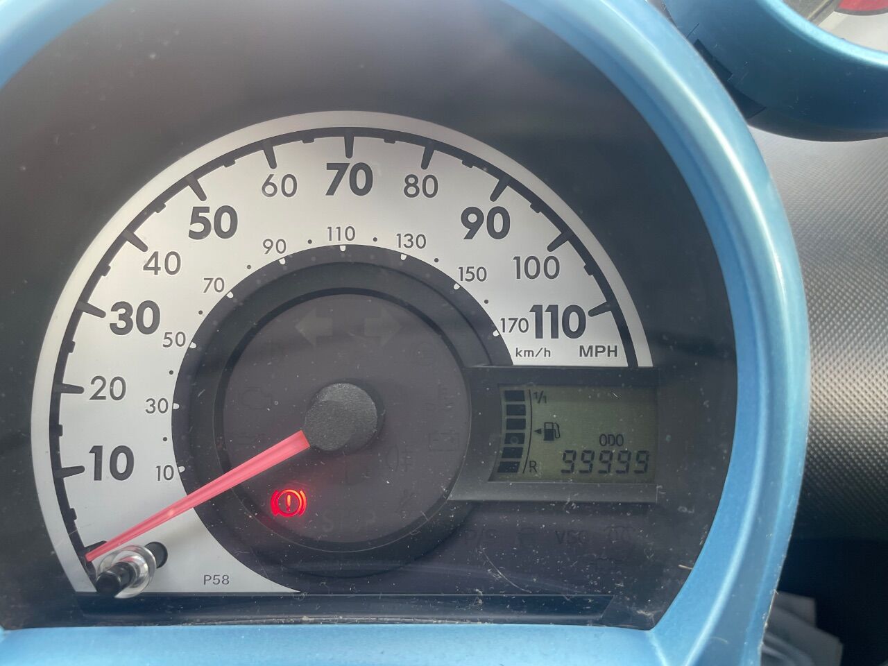

At work about to go home, and I spy this.
99,999!

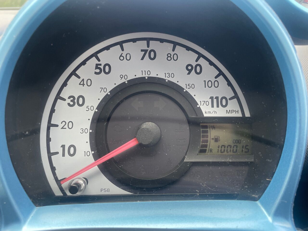

But that means nothing to me. This, though, meant something:
It ticked over to 100,015 miles as I pulled up at home.
I picked the car up with 15 miles on the clock in September 2010. All of those 100,000 miles are mine. Trips to and from London when I was freelancing. A European tour to Budapest in 2012. A stag do to Düsseldorf in 2022. Now saving my arse betwixt cars.

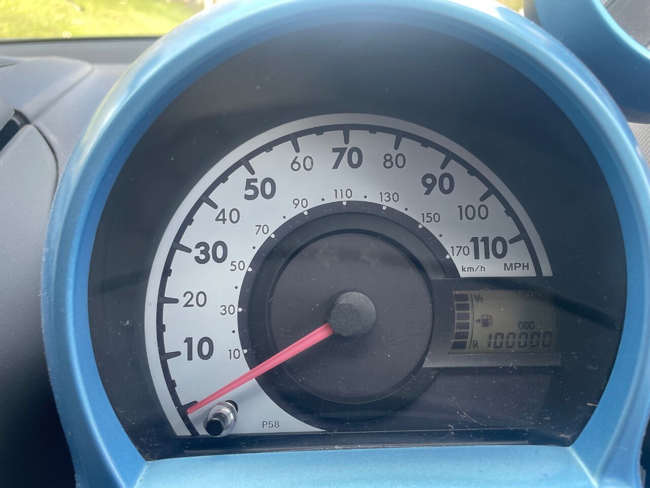

I am an idiot.
There is 99,999!
100,000 clocked over just as I was leaving the compound.

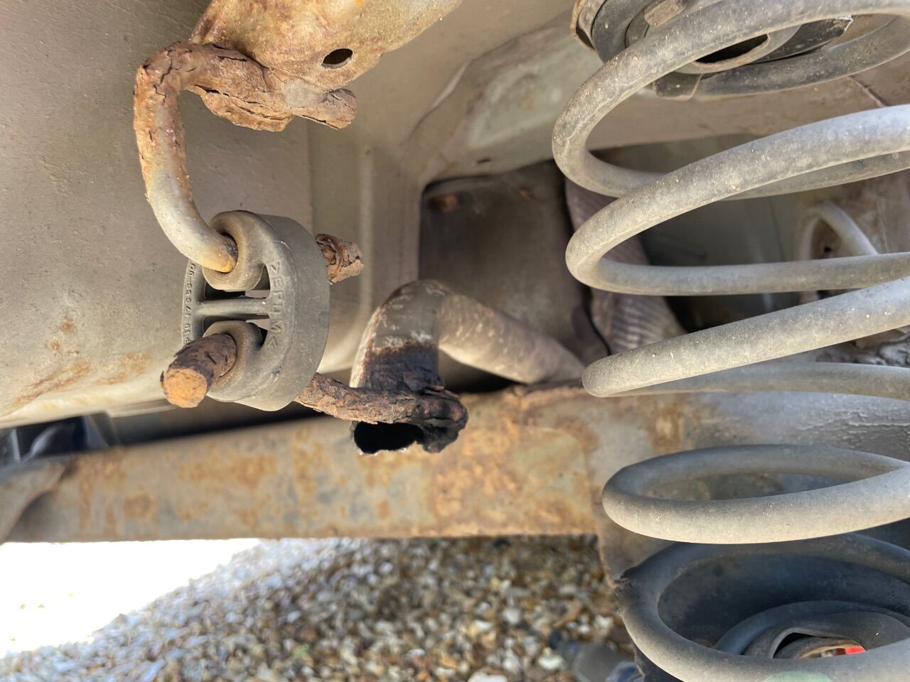

I genuinely thought I could get near to the next MOT without attending to the back box.
But, reversing in to the parking space in Lidl, the car felt difficult to reverse. It's too hot to fuck around so I just carried on and then I felt/heard some scraping. Looking under the car after I parked it revealed the back box of the exhaust had dropped off and folded under the car. No bother, I went and did the shopping, and I came out and drove it round the corner. Many a helpful motorist flashing and beeping me about something, I said "yeah yeah I know I know". I'd have driven home really as I thought it was still attached to the car. But I heard the exhaust making an odd noise, almost skipping on the tarmac.
I pulled over and the back box had completely detached from the exhaust and was hanging on for dear life by the hanger! Which, helpfully, you cannot cut with a cheap utility snap knife. But it was easy enough to work it off of the hanger.
Drove home like I was driving a Spitfire.
Currently deciding the best thing to do. This is the 3rd exhaust I've had, they've all been shit. I've seen a Hornet exhaust on eBay for £120 and I'm tempted to go for that really and get a garage to fit it, especially as the pipe broke on the bend going over the rear axle so I don't think it's a particularly hard job to do. Which makes me think I could do it myself, again...

Short answer is yes, yes I can. The hanger is still in place so the exhaust part was what fell off. The blowing I had was from the pipe.

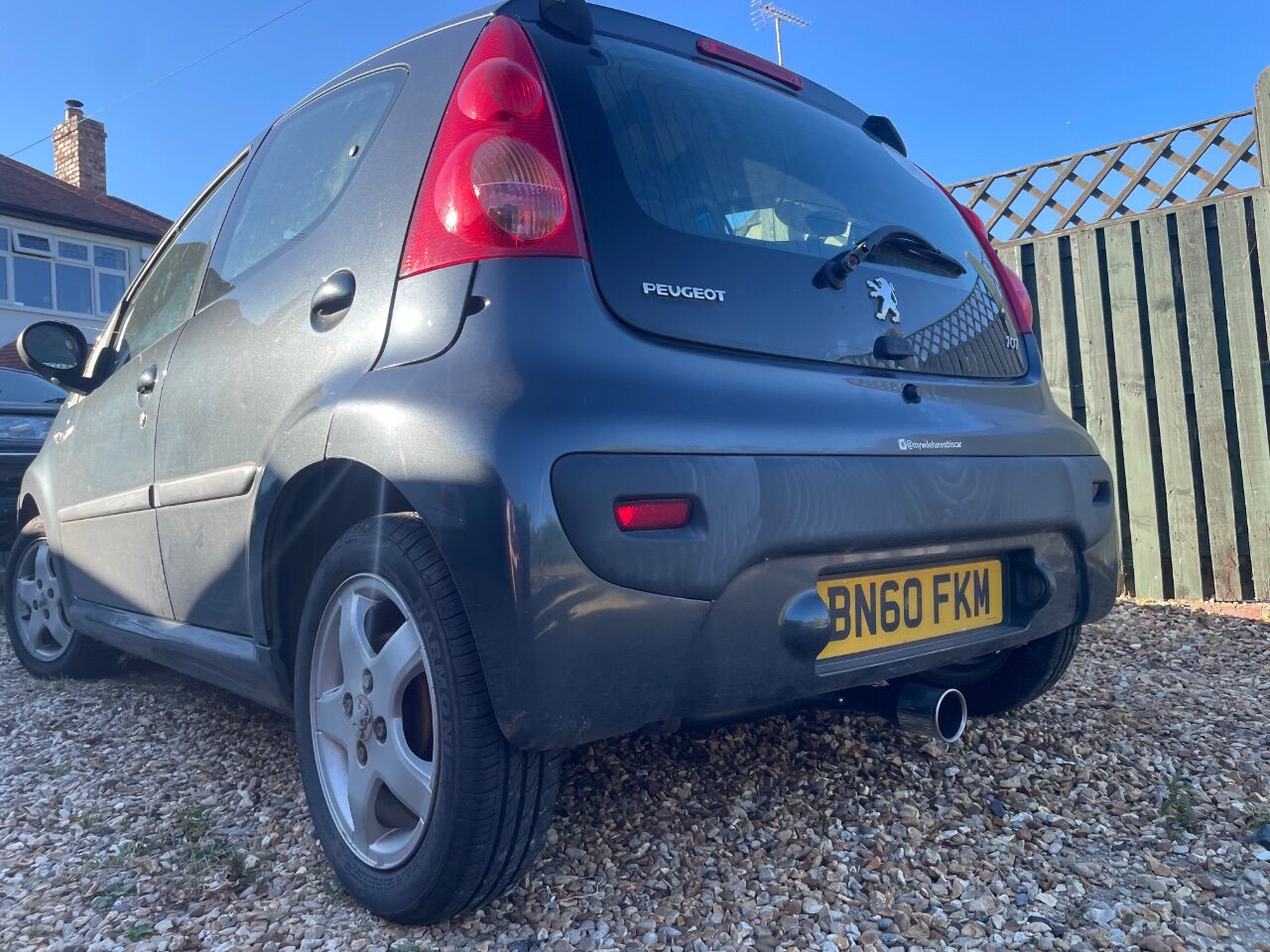

Took their sweet time but it turned up today, and is now on the car.
Have taken it for a spin - 2-2.5k it’s loud but either side it’s not bad. It’s a pop/bang map away from being a nuisance. But I cannot complain for £140.

Looks good , there a great car to drive bit of extra exhaust is always good.
