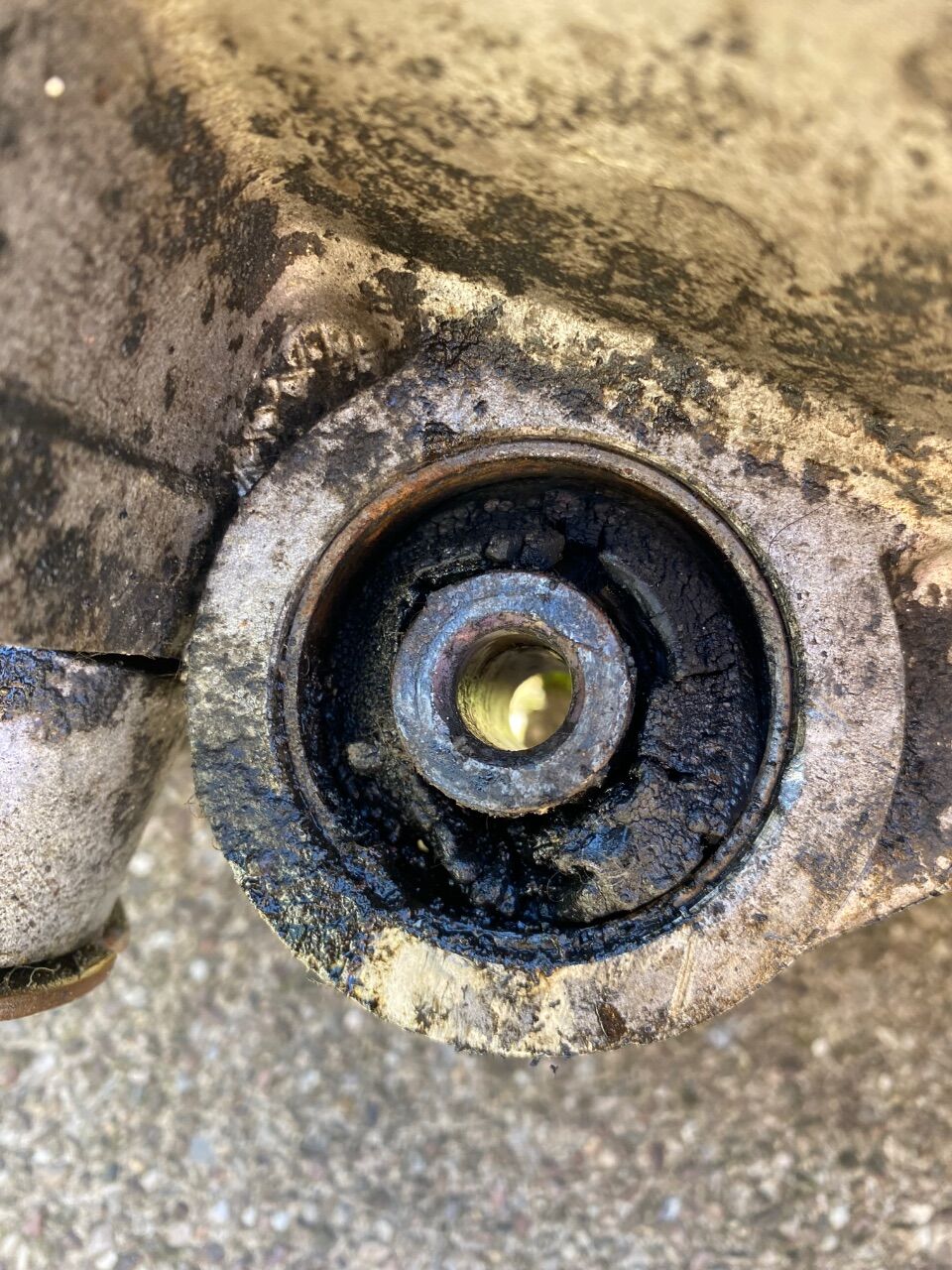

The rear core plug on mine was leaking 12 years ago. I araldited a penny washer in it and it's only started to leak again now.
Not a bodge if it works*
That’s not a bad idea, It’ll be easy to replace properly when I take the gearbox out to fix the rear crank seal but might do as an interim repair.

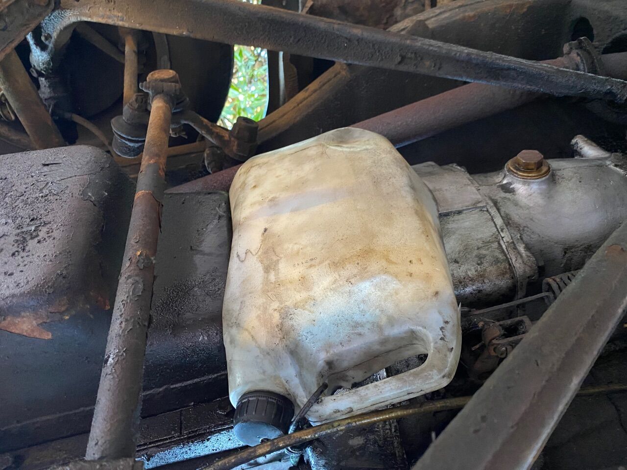

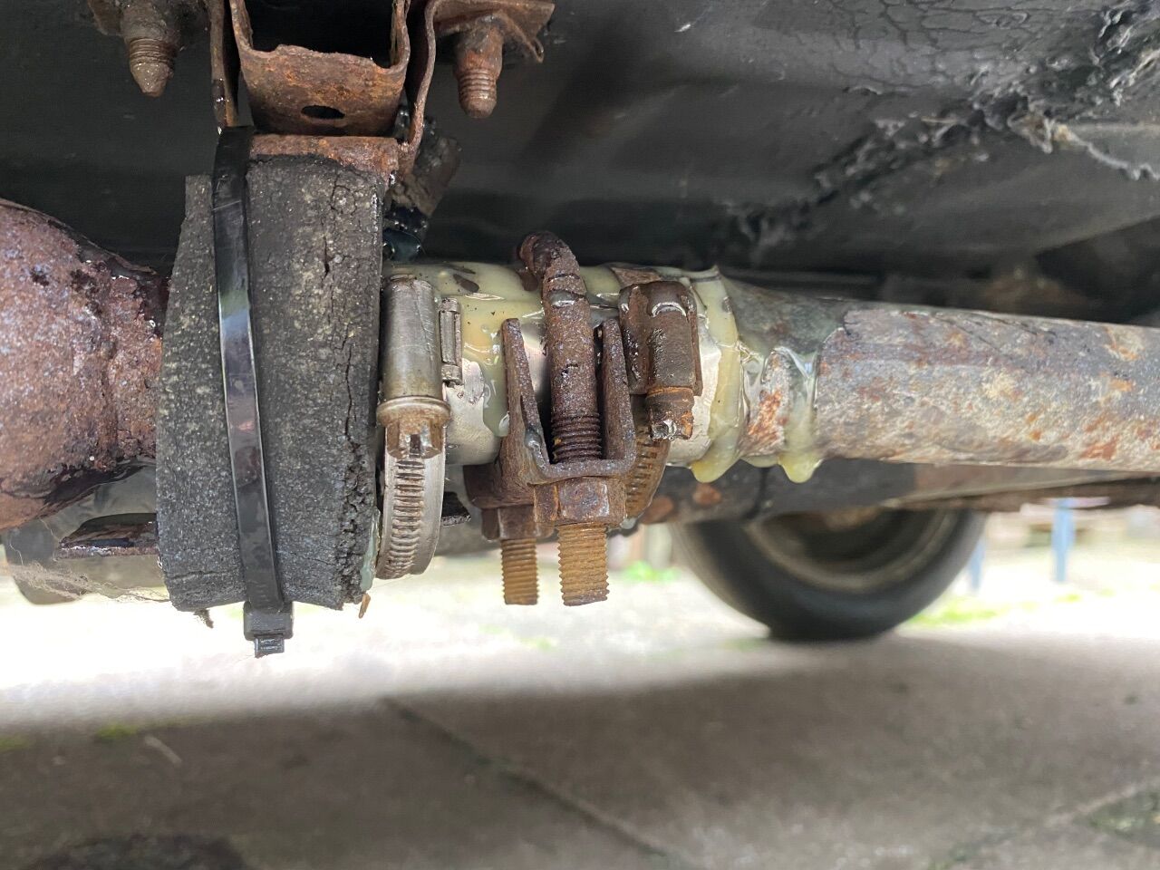

Talking of interim repairs….. a 5 litre bottle cunningly crafted to shape and a couple of bungee cords mean I have an oil free driveway, presumably until it’s full of oil and pours out everywhere.
*no idea why the image is inverted
That's genius, and with the convenient spout to allow you to pour it back in the engine!

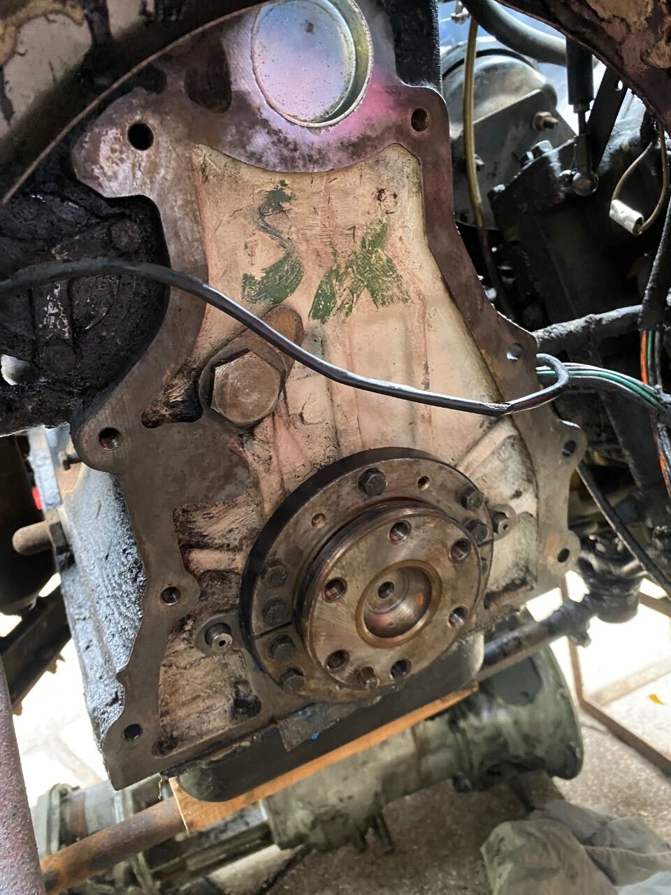

Despite the 2.6 engine in the Rover performing perfectly (leaks aside) I bought an engine from a Rover 3 litre mk3 because it was cheap, and seized.
The engine complete with auto box was collected from Manchester and was soon back home in Stoke and getting taken apart. It freed off with a crowbar on the starter ring  pretty easily. The gearbox was taken off and the engine was stripped to a short block, parts like the box and the power steering pump and specially adapted dynamo it bolts on to will be sold on as I don’t need them. The engine looks to be in good shape internally with no scoring in the bores , no lip in the bores and no sideways movement in the pistons. The engine can be converted to manual using a Rover 80 flywheel and seems to be quite a common conversion in P4 circles. Unfortunately 4 of the 6 spark plugs snapped off in the head and will need be removed somehow, I might get the engineering shop that skims the head to have a shot at that job.  As the engine came from a mk3 3 litre it has a fancy “Weslake” head which helps the flow of gases into the engine and looks really cool, although mine needs a really good clean up!
The whole 3 litre engine conversion malarkey will be a bit of a back burner project for the time being but the engine will look great with the alloy castings cleaned up and the block nicely painted and the increase in BHP and torque should come in handy.

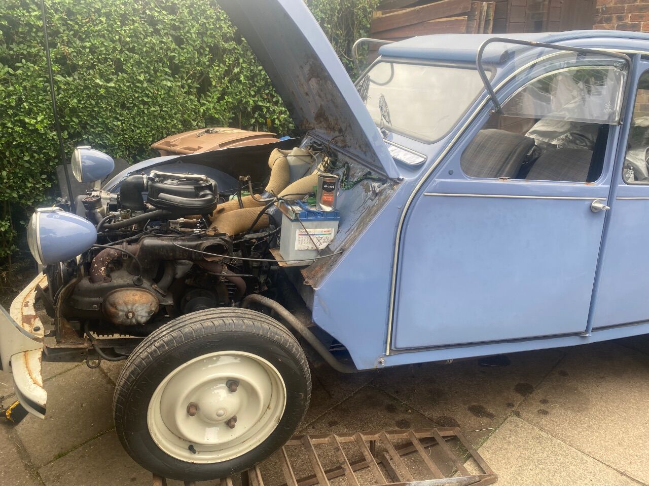

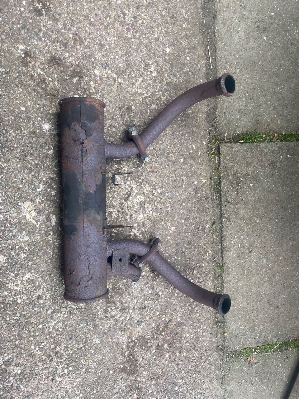

The MOT on the 2CV expires next month, time flies when you’re enjoying yourself! The crossbox in the exhaust was blowing on the last MOT although the tester couldn’t find the leak. It’s steadily got worse so I bought a replacement from ECAS near Stafford, parked outside was a very nice Traction Avant which I thought was worth taking a pic of. They’re glorious cars when viewed up close.

Enjoy fitting the crossbow in the 2cv, I found it was a complete bastard of a job in my Acadiane trying to get all the joints to seal.  Those new clamps you've got do help pull it all together!

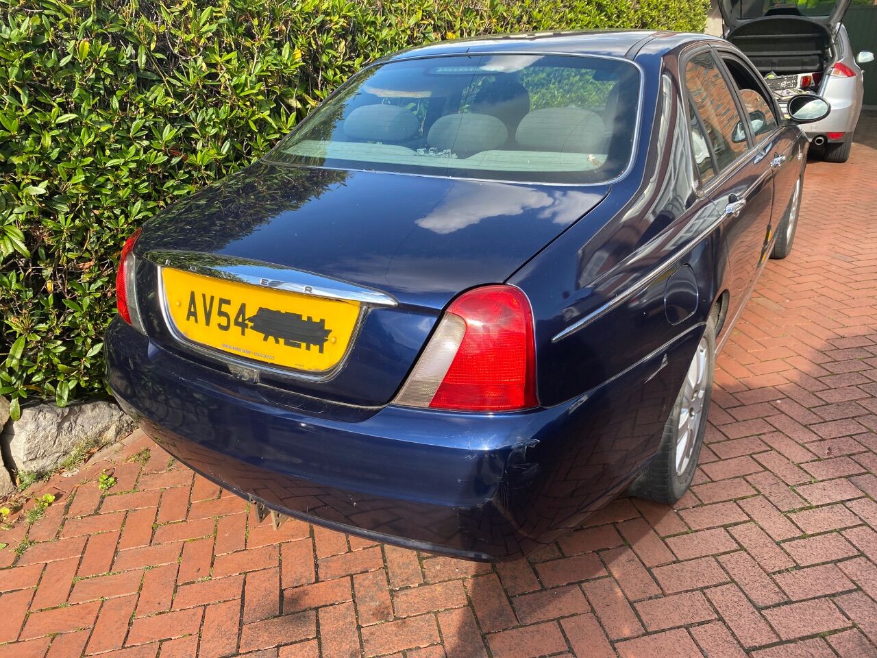

Soooo, I was sat in the barbers waiting my turn for a trim and browsing Facebook marketplace….
Anyway, long story short, it just kinda happened  even though I’m meant to be reducing the fleet, not increasing it. It was local and cheap and I’ve never had one before…

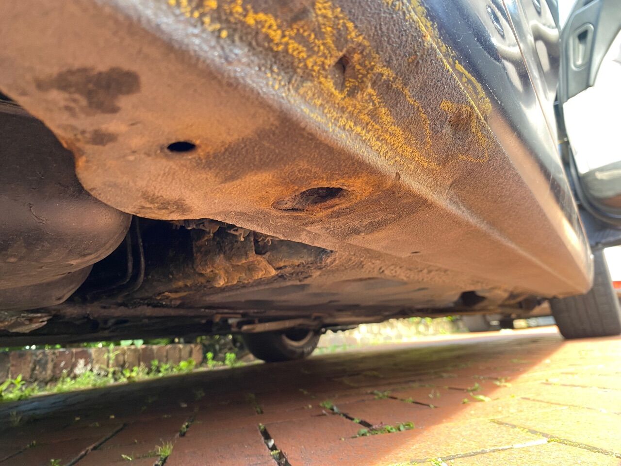

It’s a late 2004 diesel connoisseur. The previous owner was selling as he’d spent a load at the last MOT  on brakes and stuff and a pre MOT check had shown it needed even more spending on it, rear brake pipes corroded, front wishbones, drop links, tyres and a small rust hole on the drivers sill. Nothing too bad.
It’s pretty straight and only has 69k on the clock. It’s a nice looking thing but probably won’t be staying as it just doesn’t seem as good as the Laguna. I know they’re a couple of generations apart but the 75 really does feel like something from the 90s….. which of course it is.
What really lets the 75 down is the interior. Everything feels loose and flappy, fabric on the door cards falling off, poor quality plastics, droopy headliner, boot floor and trim collapsing, it feels like a clapped out Kia rather than a premium product. The spec seems pretty poor too, I thought this trim level was near the top but it has cloth manually adjustable seats. I’m guessing Project Drive is behind this general crappyness but it could be remedied with a nice new leather interior from an earlier 75 in cream or something. Dark blue bodywork and a cream interior…. Yum!
But of course that isn’t going to happen because I’m reducing the fleet… aren’t I?

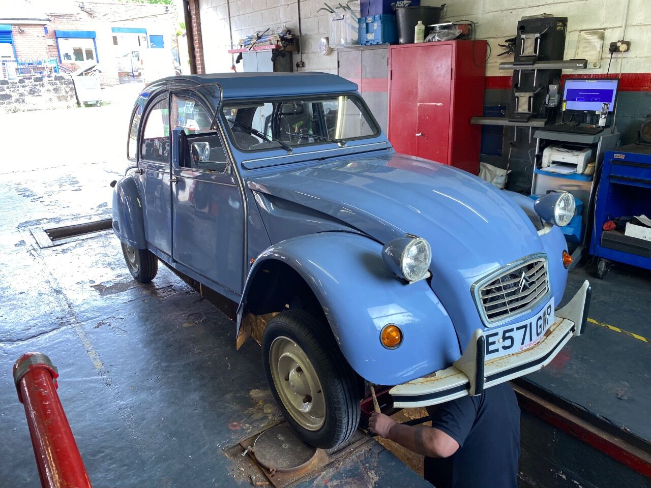

Bet everyone had forgotten about the 2CV, well I nearly forgot the MOT was coming up so rummaged around to see what was needed, the crossbox in the exhaust was on its last legs for the last MOT and definitely needed replacing this time around. A new was was obtained from the ever helpful ECAS who luckily only down the road from me. The crossbox was soon fitted but this then revealed a blow from behind the torpedo exhaust section, I think all the movement when I fitted the crossbox finished it off. With the MOT looming I did the sensible thing and cancelled the MOT and put a new silencer on order bodged it up with a coffee tin, hose clips and epoxy resin.
The little 2CV flew through the MOT, the play in the king pins even self healing since last time. Result!
I still need to sort the rest of the exhaust out though.

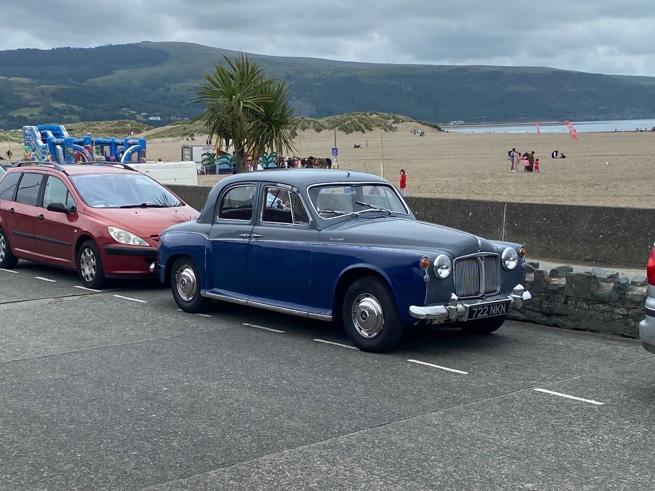

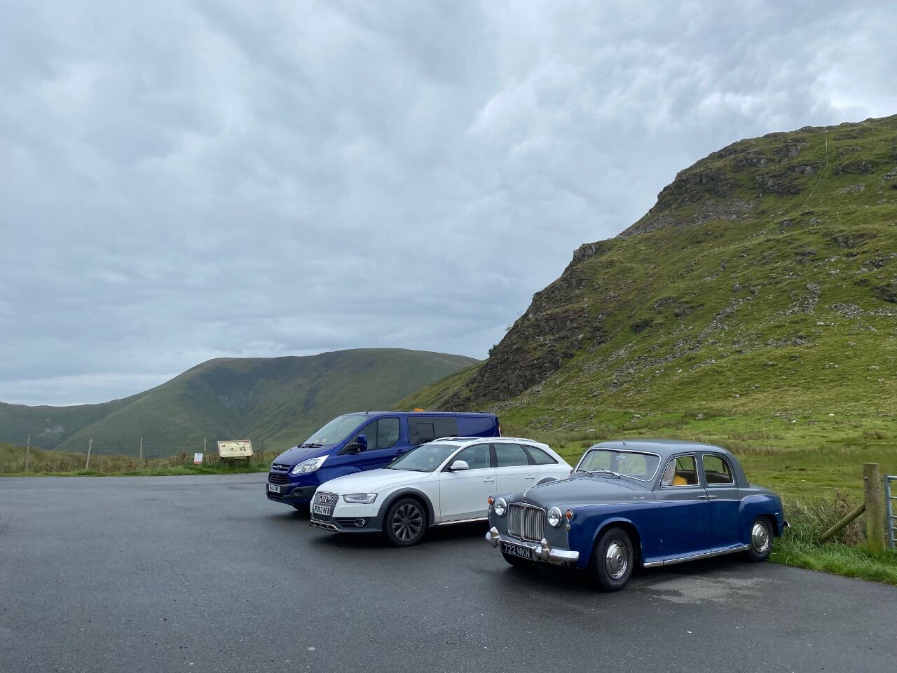

As a child I spent a lot of time at the Welsh seaside town of Fairbourne in Mid wales and I’d been hoping to drive the Rover over there for a while, once I’d got everything working and I had confidence it would actually make the journey from Stoke on Trent and back. The Rover, like all old cars always has a to-do list which always put me off making the 100 mile odd cross country A road jaunt.
Anyway, today was was the day I threw caution to the wind and together with Mrs Lankytim made the pilgrimage to the Welsh coast.
Here’s a photo dump of what turned out to be a totally uneventful journey where nothing of note went wrong, other than the engine getting a little warm as we ascended the big hill at Dinas Mawddwy on the A470. I remember failing to get conquer the summit in a clapped out MK3 Escort in 1998 and having to roll backwards down to the bottom to get the run up I needed to get to the top.  The Rover barely broke a sweat, impressive. We even managed a couple of overtakes on the windy A roads,
Things went so swimmingly that we crossed the wooden bridge at Paenmaenpool and went to Barmouth for some chips.
The return trip via Bala and Wrexham was as uneventful as the outward leg and even the traffic wasn’t too bad. As well as the Rover was driving it was a relief to get back home and get the kettle on. The Rover has come a long way from the seized up hulk I picked up from a driveway in Birmingham last year.

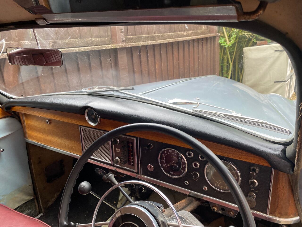

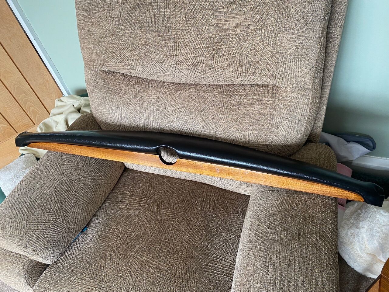

The fuel gauge decided to show empty a few weeks ago so I had a look to see what the issue was. I was hoping for a quick 5 minute fix and find a bad earth or something but eventually I had to remove the fuel sender and found the metal float had filled with petrol. I nearly ordered a new one from eBay but I had a distant memory of a seized up fuel sender kicking around the garage somewhere. It was eventually found under a pile of scrap at the back of the garage and after retrieval its slightly dented float was substituted for the petrol filled item and normal fuel gauge operation was restored. Brill! The old float and the sender from the scrap pile have been put in the spares stash to see if I can repair them.

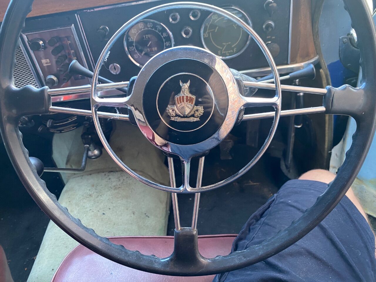

Another job that I did was to swap the steering wheel for a better example I had in the loft. The original had a few big cracks in the Bakelite (or whatever it is) and the horn push was faded and crazed. After a good workout of pushing and pulling the old wheel was off and the replacement installed. It does look much better!

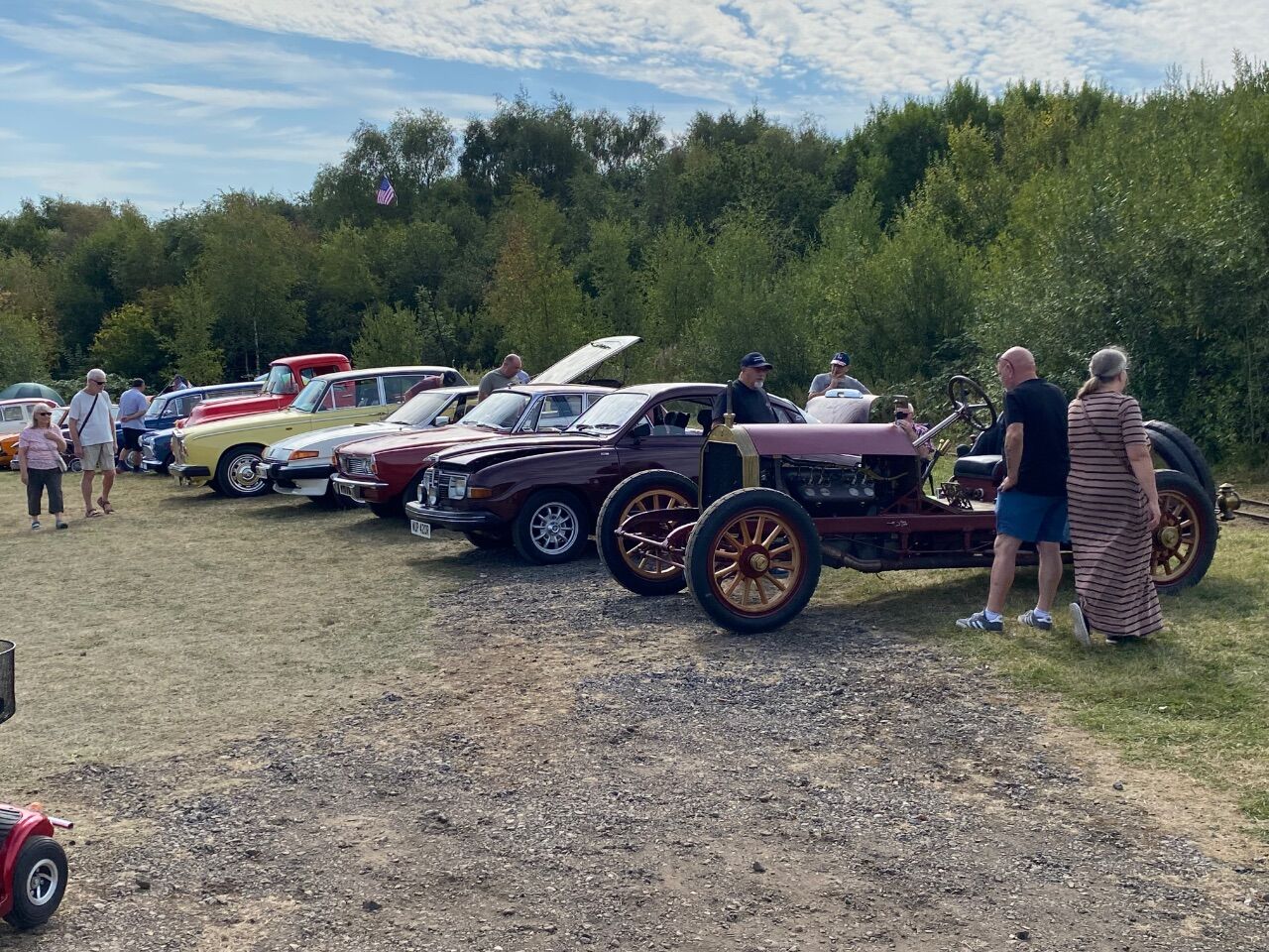

Bank holiday Monday was spent mostly at a local car show at Apedale country park in Newcastle Under Lyme. It’s free to get in and very well attended. The Rover was pressed into service and after meeting up with a few friends a nice day was had. Just one issue marred the day, is it not an unwritten rule not to interfere with other peoples cars? We were sat behind the Rover having a bit of a picnic and an elderly rather rotund gent with his middle aged daughter started poking around the Rover. Nothing to be bothered about, but next thing they’d opened the drivers side doors and were looking inside! I asked if they needed any help and the fella said that my Rover was looking a bit tatty and needed work. Cheeky geriatric obese tosser! I mean, he’s not wrong but it’s just the sheer entitlement of it.
P4s rear crank seal is still giving issues and I don’t think I can put off repairing it much longer.

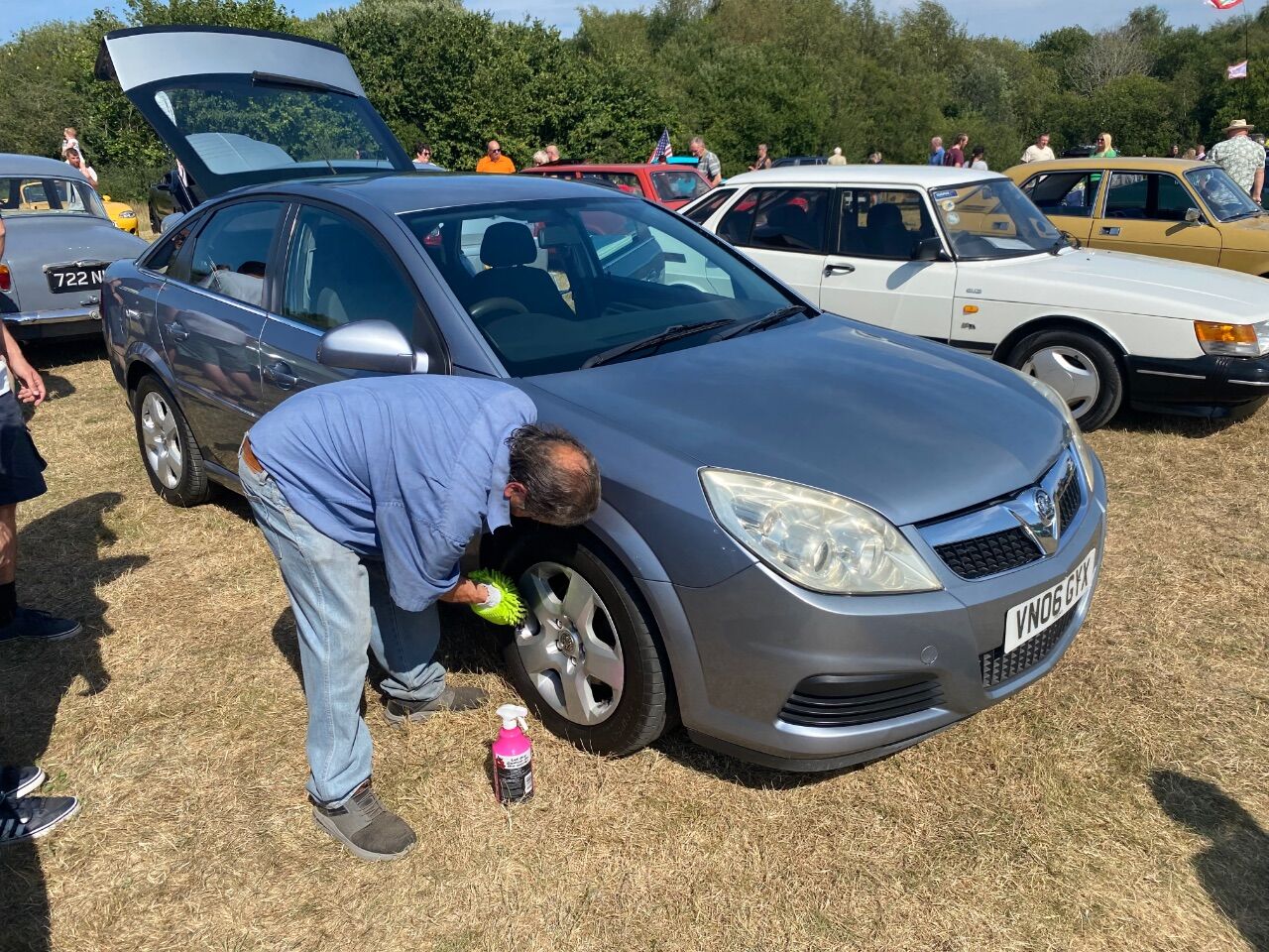

Anyway, here’s some pics. There was a 1.9 diesel Insignia which I initially thought looked out of place but the owner clearly cherished it. They’re starting to thin out so perhaps they’re passing into the modern classic stage of their lives? Either way, it clearly brings the owner pleasure which of course is the name of the game.

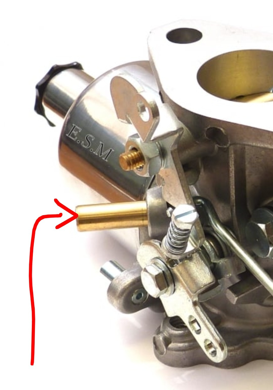

@Lankytim.. closed circuit breathing 😮
The MM1000 carb has a brass pipe machined into the carb, open just near the bridge/throttle flap.
With an oil mesh catcher in-line, such a *mod will send all your nasty pongs 'up the pipe'!
