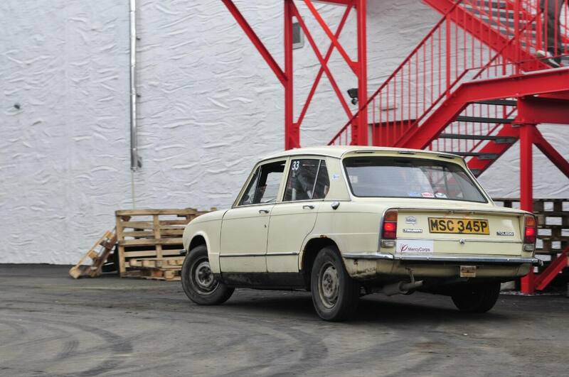

leakingstrut Posted September 11, 2022 Author Posted September 11, 2022 Thanks everyone, I'll try to keep the thread updated with how I get on with it! Oh, and here are a couple pics of my old poor old 1300. BeEP, Rustybullethole, Spiny Norman and 6 others 9
Rustybullethole Posted September 11, 2022 Posted September 11, 2022 Is that a roll cage in the back there? leakingstrut 1
leakingstrut Posted September 11, 2022 Author Posted September 11, 2022 Yeah, full-ish cage. Can’t remember the make, but it looked well made, at least for a period one. I’ve still got the cage at my old man’s, but I’m not sure if I want to put it in this one - I like having rear seats. Also there is the issue of having a cage increasing the risk of head injury if you aren’t in a harness, though I think in a car that is almost 50 years old the cage will do more good than harm. But I’d rather keep this one a bit more stock inside for now. Big pain to fit from what I remember, when we took it out we just cut the B pillar as the car was getting bridged. Footwells were so rotten it just pulled straight out taking the floor with it. Rustybullethole, stripped fred and GMcD 3

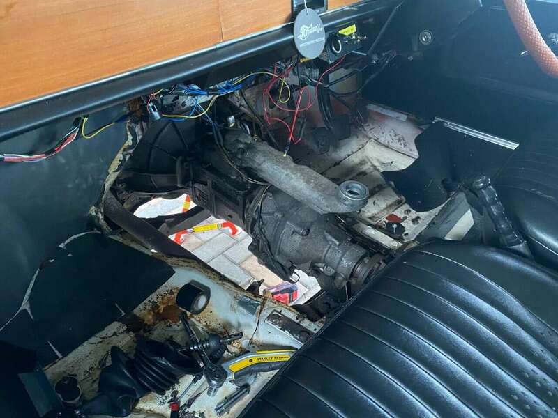

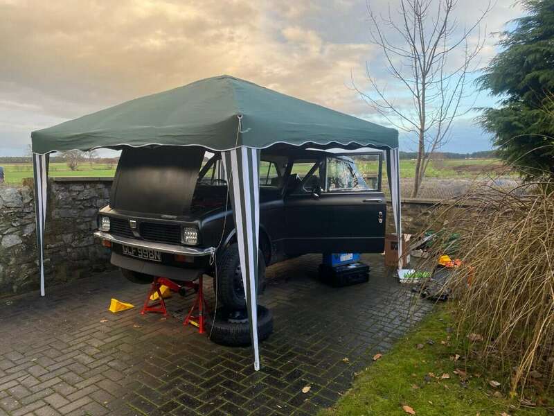

leakingstrut Posted November 26, 2022 Author Posted November 26, 2022 Got a few days free, so it’s time to swap the gearbox. With the engine swap being relatively recent the bolts came undone pretty well. I had more problems doing the droplinks and brakes on my wife’s 10 year old modern. Had my FIL helping, and him being an experienced car fettler and ex RAF aircraft engineer helped a lot. We came up even on trapping each others fingers taking the box out. With the box out we replaced the clutch, which was actually in really good nick. But while it’s open we might as well. The new clutch cover wouldn’t fit on the dowels, I suspect the tr7 dowels are bigger and the previous one had been drilled out to fit. The original one looked good so we reused it. At this point light was dying and beer was calling… FIL is as good on the pans as he is on the tools so we had lamb, pork and chicken curries. Let’s see how hangovers are tomorrow for putting it back together. aldo135, GrumpiusMaximus, N Dentressangle and 20 others 23
