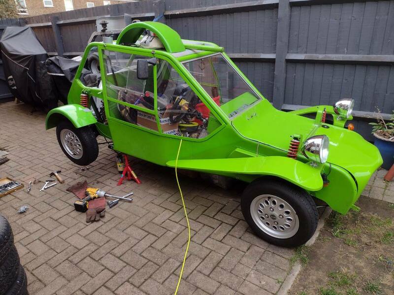

started to mock up the rear mudguards:
then got busy with some metal bits and ended up with this:
then yesterday i finalised (for now) both side brackets, and got the mudguards mounted up, along with rear lights fitted:
happy with that. spent the rest of the day wiring up all of the lights, so i now have working indicators, rear lights and brake lights. the way that the gear linkage is set up means that there cant be a reversing light switch in the usual sense, so i need to wire one to a manual switch on the dash, as well as a rear fog light. at the end of the day i picked yup an exhaust that i hoped would fit, but it wasn't to be, so i will mostly be cutting and welding exhaust today, as well as hopefully manufacturing an engine cover / shelf on the back. i'll try to take more pics today :-)

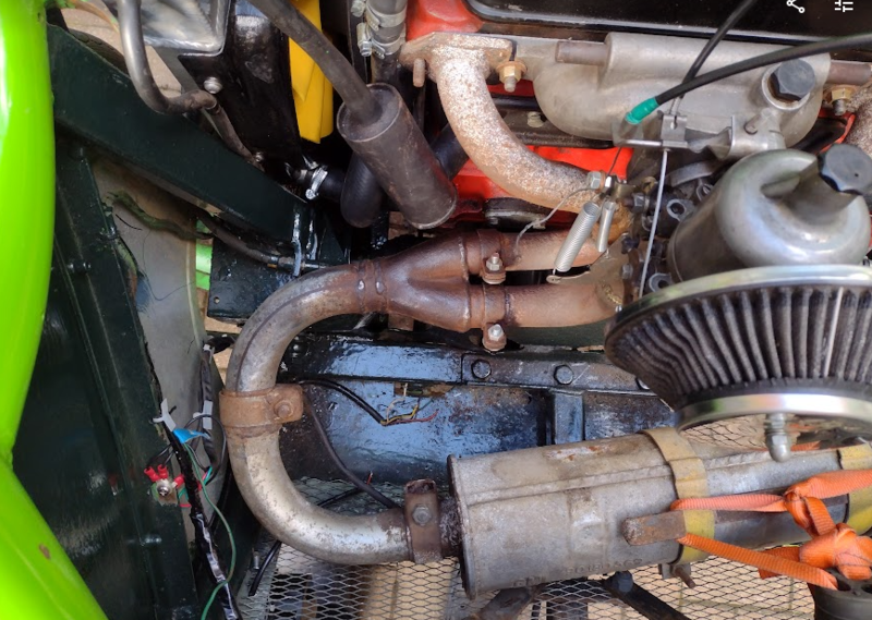

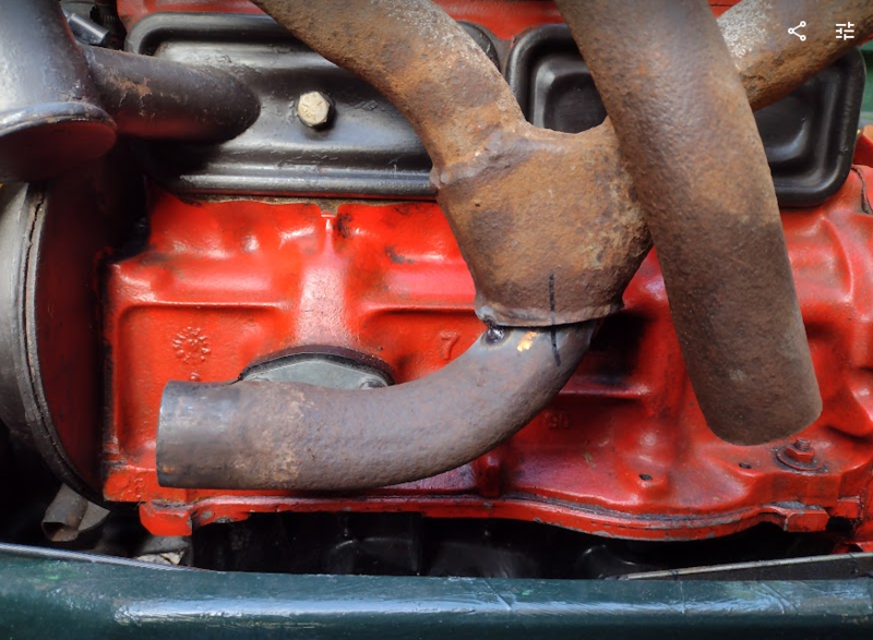

made a start on making a suitably shit(e) exhaust for this.  now bear in mind im doing this with a stick welder, so it was never going to be pretty....
first up. ah. that wont work.
time for a bit of dodgy cut and shut.
and then a bit more
couple more clampy bits
and a suitably shite exhaust hanger. this is only temporary...
the intention is to get it running on this setup, get the first event out of the way, and then get it over to a custom exhaust place and ask them to make up a nice quiet stainless jobby for it. hopefully it wont cost too much, but i think it'll be worth it in the long run, as i can see this one not lasting forever......
And this was the happy moment. I've got a new dissy on the way, as I don't trust this one, but it was good enough to check it runs. Forgive the blowy exhaust, I hadn't tightened up the manifold properly.
