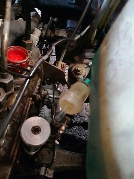

Tried to do a bit with this today starting with the only thing that went well. These cars were supposed to have a pre filter before the lift pump but it has been removed on this one but I want to have one to protect the new lift pump so after some searching I came across a universal coarse filter which will work perfectly for what I want. This must not be confused with the fine filter for carburettors, this is more intended for larger things such as rust flakes etc. And the main diesel filter takes care of the finer particles.

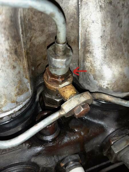

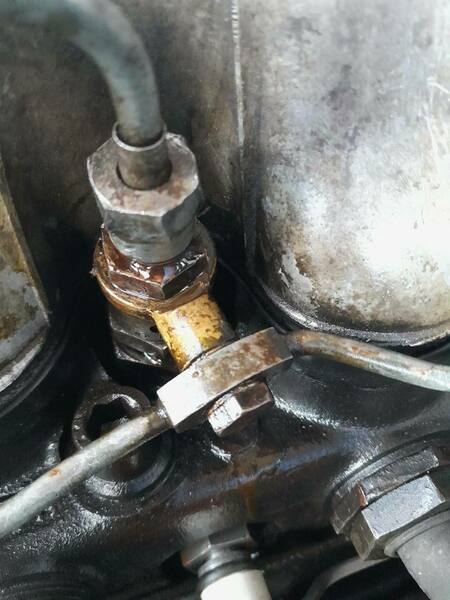

So after this I tried to get the leaking injector to stop leaking. There is no gasket where this leaks is, it's just the 2 surfaces pressed together that should keep it tight, not sure what it's called in English. And this is the top coupling that holds the pipe on so took it off and found nothing wrong then screwed it back on and was careful that everything came together straight and not crooked, it went fine to screw it together too and I tightened it as much as I dared. But after I started the engine it started leaking again. I don't understand why or how this can leak and I can't drive the car until this is fixed. I have marked where it is leaking with an arrow in the picture below.
So I possibly need advice on this now if anyone has it. And the mysterious hole on the engine that oil was leaking out of and I put a bolt in, this bolt is now impossible to get out, I can screw it both ways but nothing happens and there is still some oil leaking here so I may have made this even worse now that the bolt cannot be removed. So this along with the injector is very frustrating and bothers me a lot now.
Try a copper washer in the joint?  If it has been overtightened in the past, the male threaded part of the coupling may have been stretched and is bottoming in the injector.  Just a thought.
Thanks, but I'm not sure if it's possible with how the connections are. But I'll think about it if it's possible.
My long experience with small marine diesel engines has taught me that diesel fuel is excellent for using as penetrating fluid for rusting nuts, copper washers should be annealed (heated to cherry red glow then plunged into water) each time they are re-used because this softens the copper.
On the leaking oil bolt, as the thread is obviously damaged (hence it will not tighten) the problem is it is just spinning. You will need to apply some pressure outwards whilst rotating the bolt anti clockwise. If there is a gap at all between block and bolt head, a very thin screwdriver can be used whilst turning the bolt with a socket. If there is no gap, a small pair of vice grips on the bolt head at 90 degrees to the block, then turn and pull at the same time. This may take several attempts as the vice grips will keep slipping off.
For the diesel leak, as said, a copper washer should work.
Thanks both. I'll try this on that bolt and on the diesel leak I'll see if I can get a copper washer in.

Then it looks like I can get most of the day tomorrow to work on this, but I have a question. You have recommended using a copper washer on the coupling that leaks diesel, but where? It leaks in the joints and threds where the arrow is in the picture below and there is several millimeters of clearance to the bottom there, so you can't have a washer there, so did you think it should be inside? So together with and around the injector pipe?
20220926_150120.thumb.jpg.90c28ea8f0c683d1c7aa79f64f7a2a70.jpg.118d31d30ec6bc258ac1e5912242273f.jpg
I thought it was leaking from the bottom section against the brass fitting - hence copper washer suggestion but if it is leaking from the top union then that isn't appropriate - sorry if that was confusing.  I think next I would undo the top union nut, and have a look at the fitting inside.  Make sure it is all clean and not damaged, try and refit it and tighten it carefully.  Not sure what type of fitting that is.
Thanks. I will try this but I don't want to loosen the pipe on the diesel pump because then I will probably have a leak there too. So will try my best.
And one more question, is thread seal tape a no? Because I have one that can withstand chemicals and 120 degrees. It feels like a bodge but what else can one do if this won't stop leaking.
Some here have found new diesel pipes for this engine in marine use, not sure if they are exactly the same. But I have found a kit with all the diesel pipes complete, if I can't get the leakage to stop then I'll have to try this if it is the same.

Thread tape is only of any point if it relies on the threads to seal, which I doubt. I would expect the pipes to be flared and seal on a conical mating surface. If this is damaged, or dirty this will prevent full contact and may cause the leak.
Was what I suspected with tape. And thank you, here you used the words I have struggled to translate. And am pretty sure that it works as you have written here.
So this is what I have to do, clean and check for damage.
Maybe the injector fitting uses an olive under the top nut to create the seal. Like this... (hopefully olive translates appropriately from English to Norwegian)
