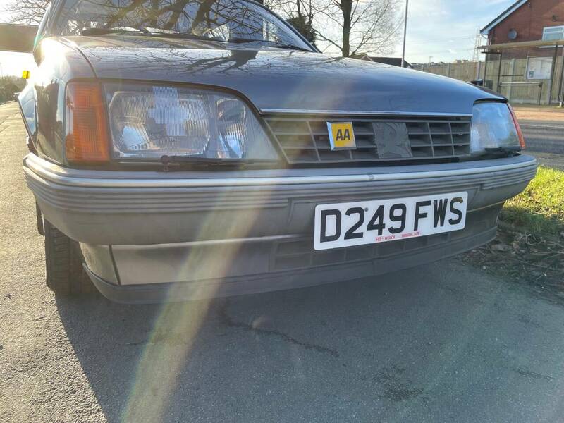

Hurrah. Plates are on. Front was ok, rear plate had just been screwed through the rear panel (twats) and the original holes were missing the screw holders. Someone sent me those in the post, and two extra for my B series manta. Rear plate is now stuck on correctly.

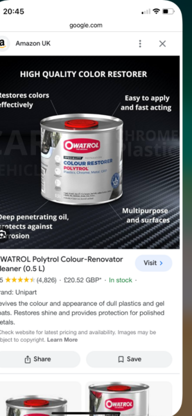

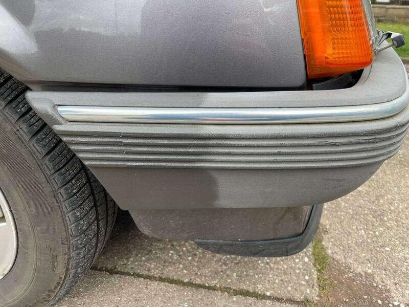

Front bumper looks much better after using automatic transmission fluid to spruce it up. Wish I’d done this sooner.
That does look good. Never heard of trying ATF, I’ve just bought some of this to try:
  • Agree 2
It actually resembles the rear bumper now, which is new.
  • Like 8

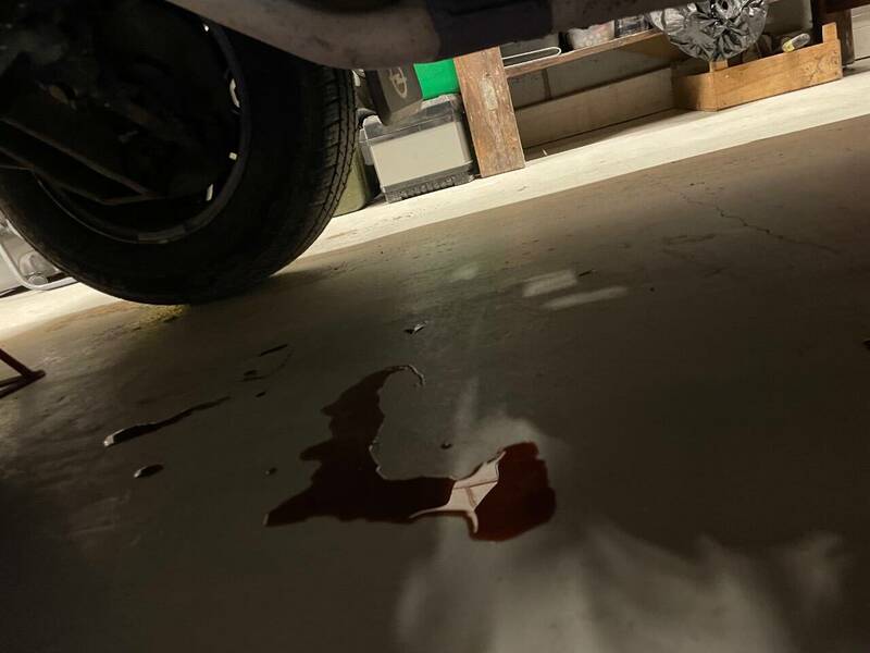

Couple of things to note. The gearbox has bled on my nice clean garage floor. Great.
Looks like it’s coming from the selector shaft, that’s a new one. I think pretty much every orifice on this box has leaked.
oil pooled up in that gap behind the nut. Not entirely sure what the next move is…

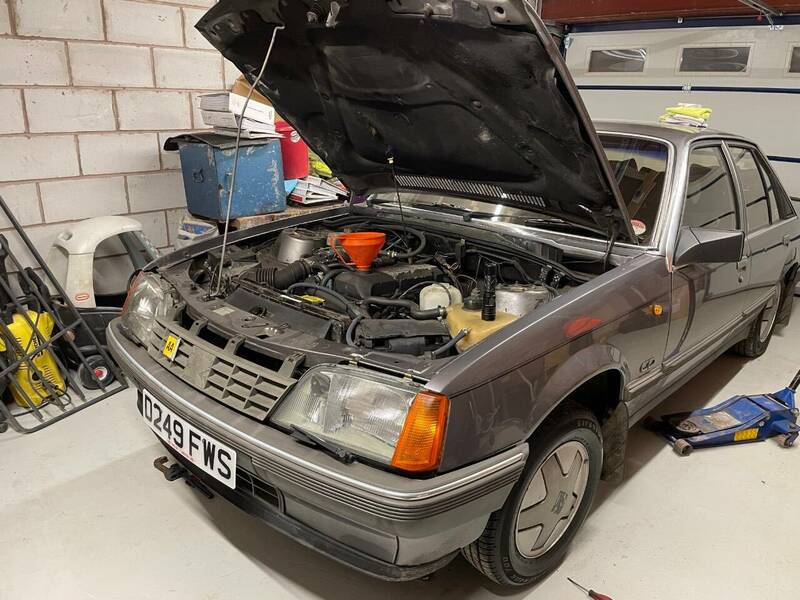

time for a service. The 20l of 20/50 heavy duty diesel oil came in useful again. Probably got enough for 3/4 more after this one.

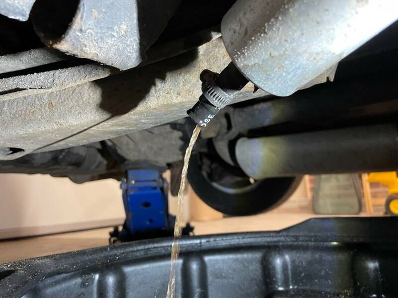

now this should be interesting. We all know the fuel tank was crusty inside…
looks a bit brown
oh that’s very brown
Well that’s 12 months and about 2500 miles worth of fuel. I think this year I’ll be tanking the tank off for a refurb.
You can probably change the selector shaft seal, had that once on a TH400 (?) three speed once. Cheap and quite easy I think, garage did mine as it was in anyway.

Result on the pass, it does look tidy though, good luck sorting the oil leak on the gearbox they always seem problematic when the get older, they just seem to sweat oil! the dipstick tube O ring is another culprit

Looks like the new cork pan gasket is leaking too. Which is a pain in the ass. Probably going to need a new one and plenty of sealant.
You can get a heavy duty gasket for the pans, tougher than cork and doesnt squidge out the sides like cork does, not sure if ive any left but cant check until Wednesday

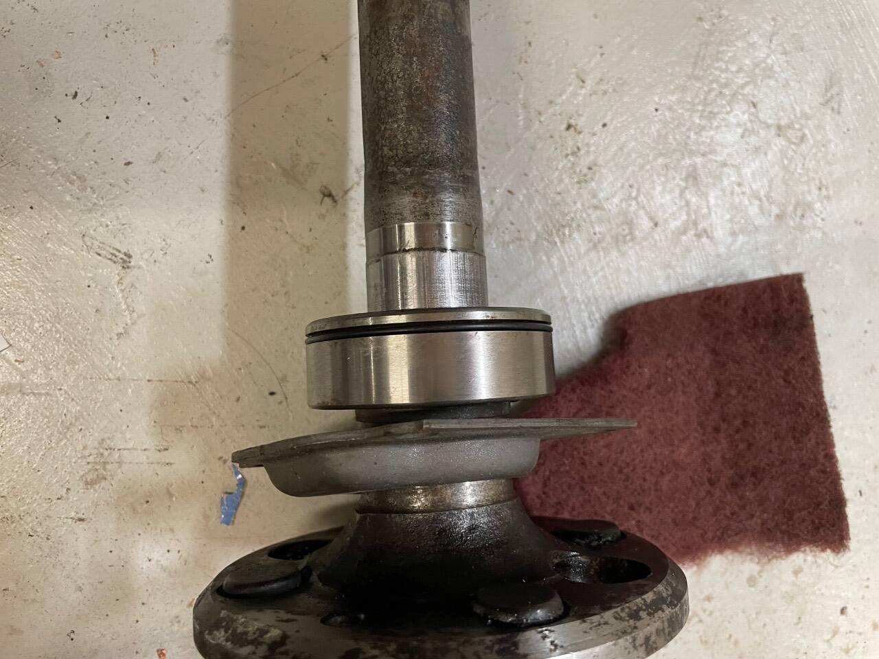

Today I’ve attempted a wheel bearing change. Which has failed.

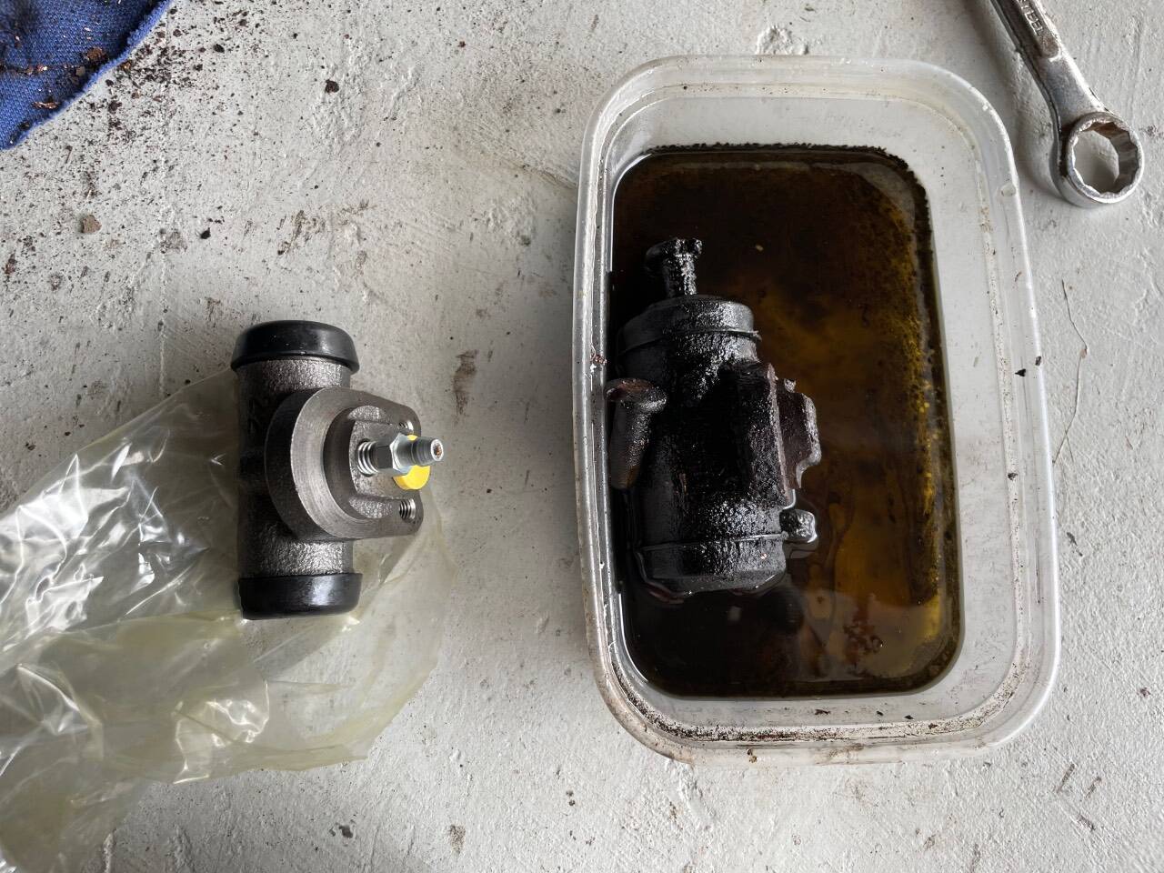

these half shafts need slogging out. It came eventually once I’d stripped the brake shoes off and went hell bent for leather with the copper knocker. But the wheel cylinder has died too. I got a new cylinder locally.
once the half shaft came out, I measured the bearings and the one I’ve been sent is incorrect. Great.
so I’m now in talks with the supplier to try and find a correct bearing. I’m not holding my breath. I rang GT and they don’t stock it anymore. The place I got the cylinder from doesn’t have one either.
BRT610 is the number I need apparently. Struggling to find one.
I looked on some classic Opel parts pages for wheel bearings, but found none there either, unfortunately.
I’ve just had a phone call with the bearing supplier. He has the Delphi book in front of him. He states that my car should have the smaller bearing. The larger bearing fitted to my Carlton is found on estate and diesel models. Strange.
im now having to source diesel and estate bearings but ask sellers to measure first.
With no one answering messages on eBay, I did the right thing and ordered this wheel bearing for 9 quid.
it has the same SKF number on it. So I’m hoping that it’s the right one.

If the SKF, or any other bearing manufacturer's number, matches with your old one it will be the same size and spec bearing.
That was quick, only ordered it yesterday afternoon and it arrived this morning.
just need to get it pressed on. That might be tricky,
I made use of the large press at my former place of work. The bearing slid on easily.
I’m now home. But I forgot to press on this odd pointless shim. So in the oven it goes
clean up the hub while it’s cooking. 180 degrees for 5 mins
