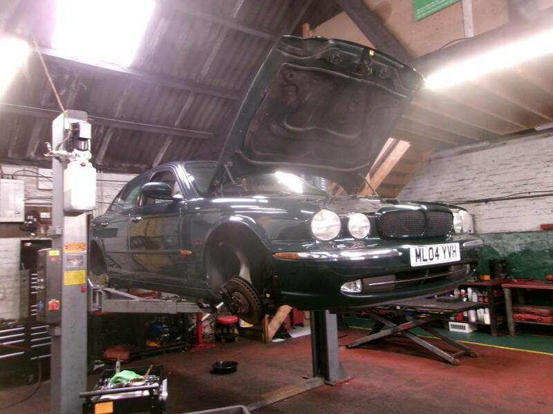

Exciting update ahoy!  Here's Handsome up on the lift this very morning...

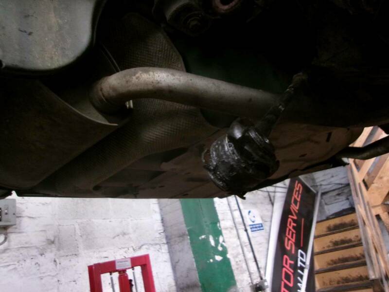

And here's one of the rear bushes that failed.
Going to look much better with all the new/nearly new parts on!
Excellent!
Good to see they’ve got no intention of just leaving it sat around.

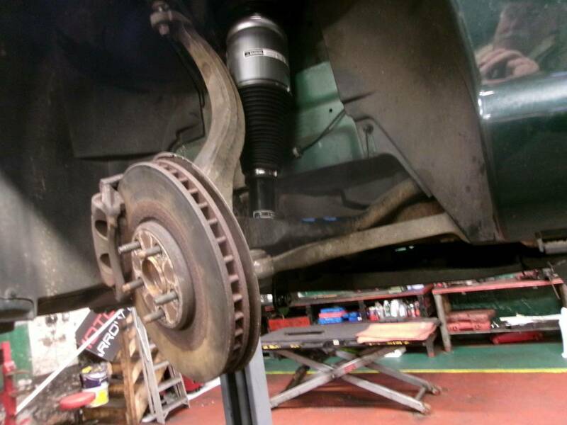

There's the new front strut in place.  It's short of a bolt at the moment because one had to be butchered to get the old one off.  This seems to be a recurring theme with this car!  However, it's taking shape.  MoT is booked for next Monday.

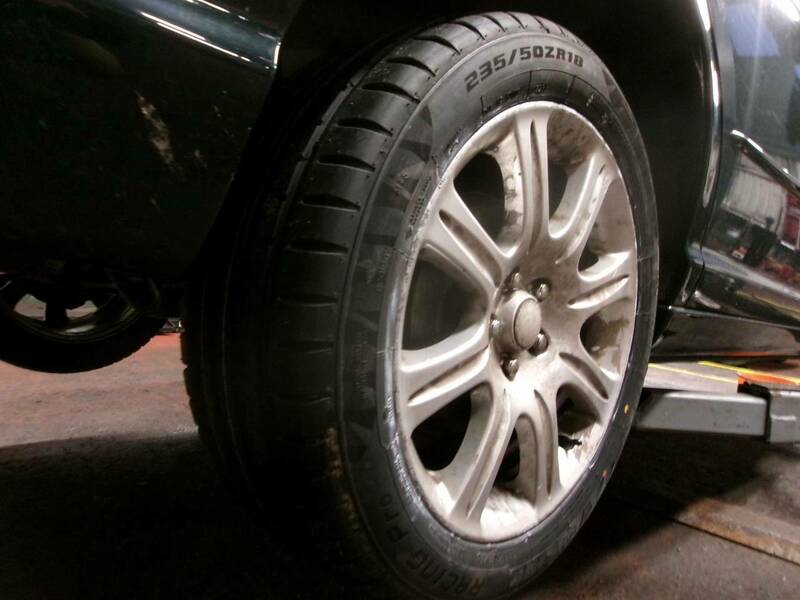

MMMMMMMMMMM sweet!  One of my beautiful new tyres, fitted today and back on the car.  Note lovely new wheelnuts too.  The old ones were the standard Ford-designed items, consisting of a steel nut inside a tin or ally cap.  The nut and cap react and swell and garages have to (all together now) "hammer a smaller socket over it!"  Which means the caps are toast.  These new nuts are single-piece.  All 20 of them...

There’s something nice about a new set of tyres on a car😆
That new strut is massive! I’m guessing they’re expensive!?

The strut was from the bay of e; £200.  I paid that last year for a back one when the garage told me they couldn't get one from any of their suppliers for under £450 + VAT.
Finished?  Amazingly, we're still awaiting that one bolt for the bottom of the front strut!  But, Tom's booked an MoT for Monday.

Funnily enough I have a spare bolt for said strut as I replaced one of mine today and bought a spare (2nd hand bolt) just in case. The bolt was fine so I do have a spare so in a pinch I'll make sure you make your Monday deadline.
Serious tyre envy here, if only for the fact that I imagine brand new tyres on an XJ will feel nothing less than dreamy.
Chodspeed for the MOT!
I remember when I had my first one, the 1978 Daimler Sovereign; it came on a set of ropey old Pirellis which were probably ideal when they were new.  But by the time it came to me they were long past their best.  I was offered four part-worn Cooper Lifeliner whitewalls off a Lincoln Continental and snapped them up.  Oh boy I loved driving that car on those tyres!
Handsome should probably have a set of Pirellis or Michelins; I don't know.  But following a tip upthread, I hit up ebay and replaced the four Chinese ditchfinders that were on it with... four brand-new Chinese ditchfinders.  They'll do.
