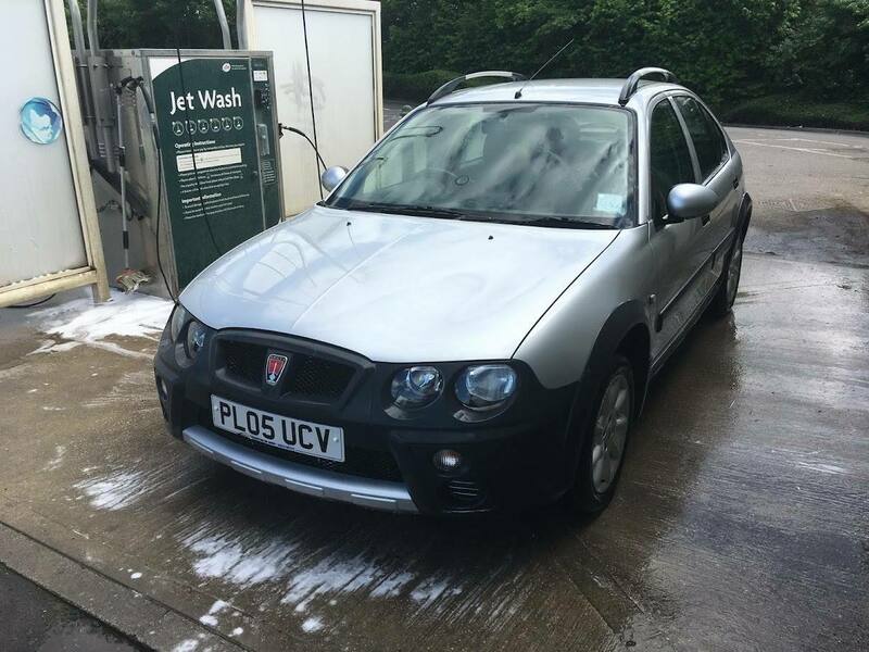

2. This Rover Streetwise. Bought as a curiosity/semi-daily driver and it's effectively become my nemesis.
It's a project drive car so it feels cheap, but that's not my real problem... in 1ish years of ownership i've had the following delights:
- Tensioner AND water pump bearing failure led to the cambelt eating itself, jumping some teeth and mashing my valves. Head off and new gasket/belts etc. Not fun. Picture from last year.
- A few months later, it started burning lots of oil on startup... head off again and turned out to be dodgy stem seals.
- The boot wiring had frayed in the boot lid causing the rear lights, heated rear screen to break, that needed soldering back up
- The roof lining is coming loose and there's a water leak in the boot. Not bothered about fixing these just yet.
- Then some absolute scumbags stole the cat (along with the oxygen sensor) and made a pigs ear of it
Now i've got the car back with a new exhaust, the power steering has started to become heavy/juddery. So next job is to swap the belt and fluids and hope to god it's not the pump. I really don't know why I bother with this car.

Tried getting to the bottom of the Streetwise's steering judderyness today to no avail.

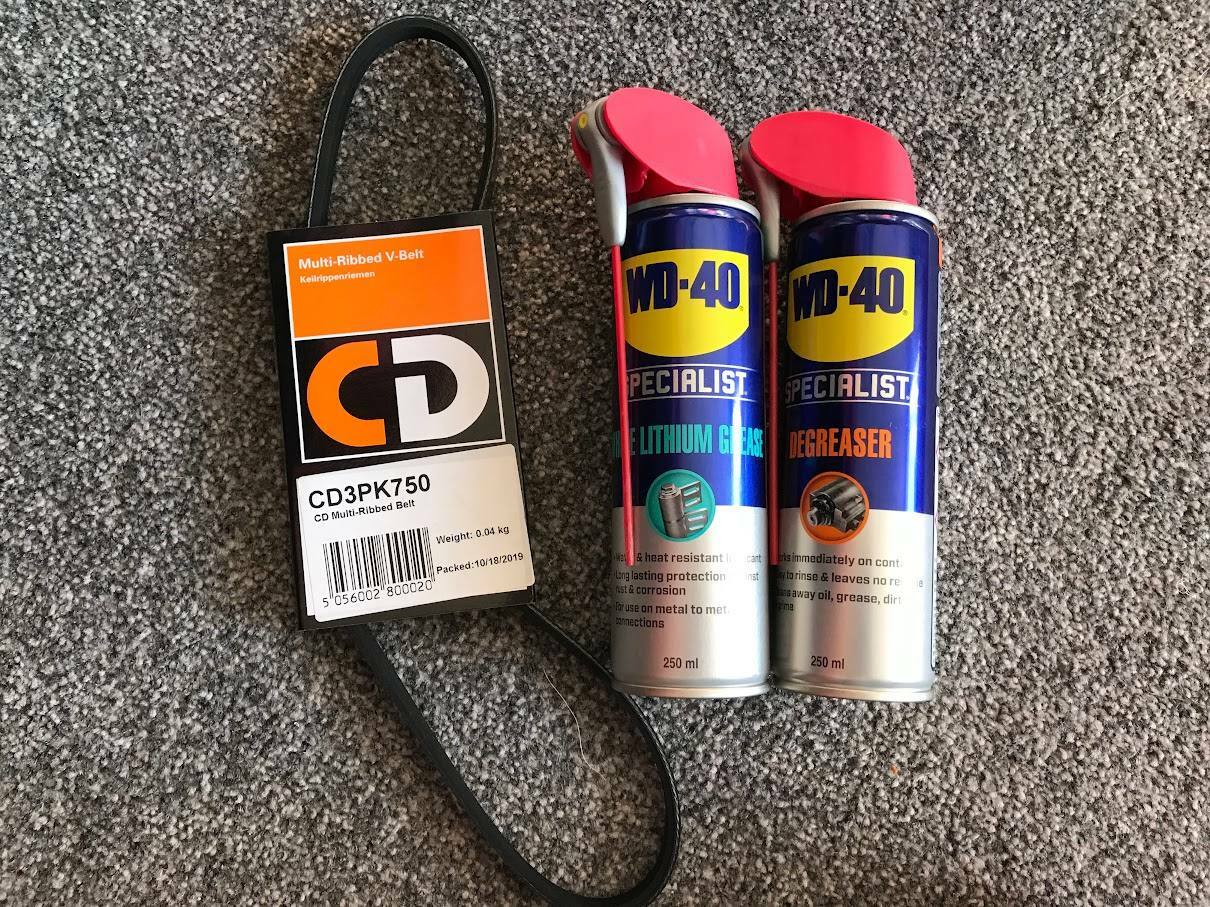

New drive belt fitted (literally a 2 minute job, nice surprise!) and some new fluid, but still seems to judder. I'm at a bit of a loss with it, it only judders at low speeds when the car is moving, but when dry steering or at any reasonable speed it's perfectly smooth. The old belt was a 3PK750, the new one was 3PK755, but both seem to be valid for the K series. I'm tempted to just leave it and see how it goes, it's not even that noticeable and i've hit my knowledge limits here...

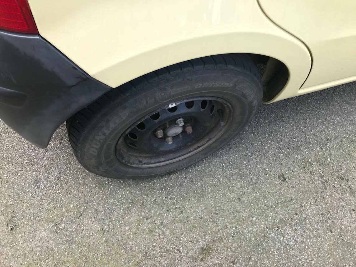

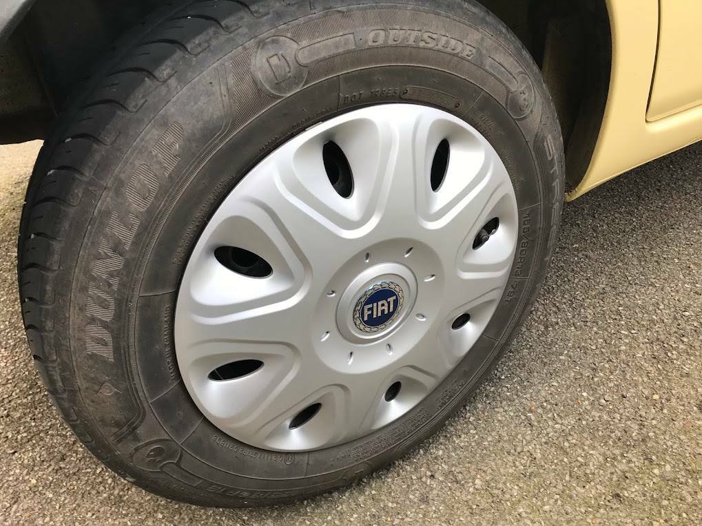

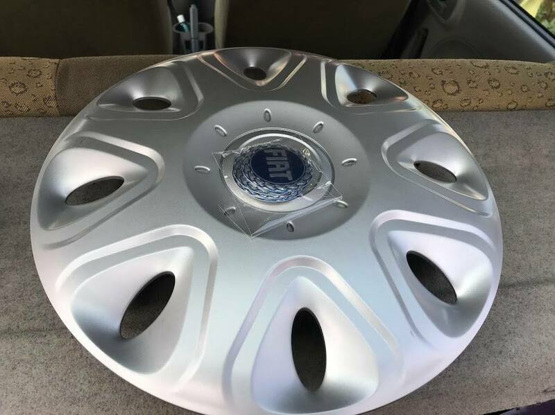

Also made a start tarting up the Panda today  - being a cheapskate i'm not paying for official Fiat wheel trims, so bargain bin wheel trims and stickers it is.

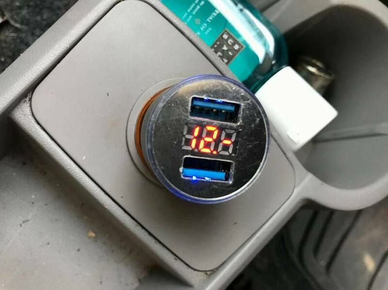

Also some fault finding on the 12v socket, it's not worked since I got it. The plastic had mostly disintegrated and I think it's shorted as the fuse had blown. Luckily parts are cheap and it's an easy fix.
It lives!

More Streetwise steering juddering debuggery.
Tried oiling the UJs, but no difference yet.  One thing I have noticed is that the juddering only happens when the engine is on a low idle... at startup when it's idling at 1300 RPM it seems fine, but once it's up to temperature and at 900RPM, it's juddery. If I rev the engine while steering the juddering improves. Not really sure what this tells me - belt slipping perhaps? Pump failing? To be continued.

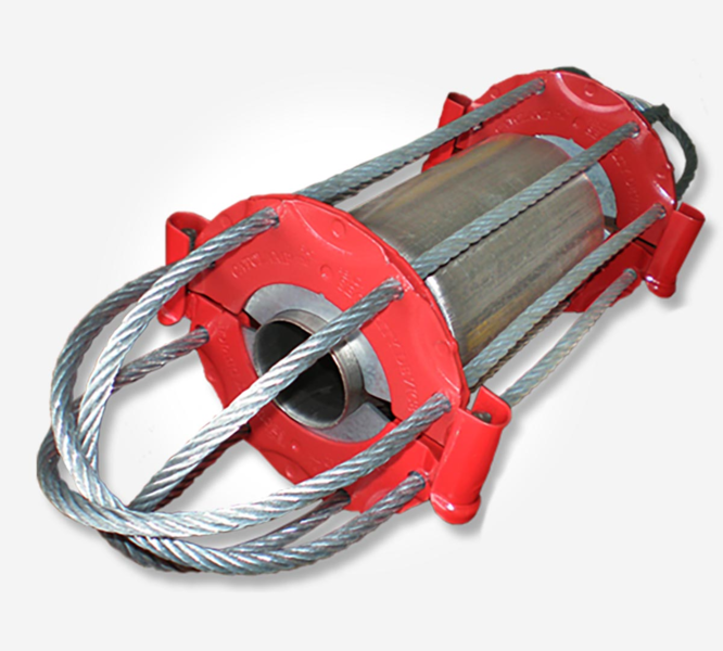

How about something like this?
I know it looks ridiculous and carries a pretty price but it should be cheaper than replacing it with OEM and saves you the hassle of constantly needing to replace aftermarket cats?
Plus has the added benefit of being able to remove it and keep it for future Hondas/Rhondas you may end up getting should you come to get rid of the 600 at some point
What’s stopping the scrote just cutting either side of that cable and taking the whole thing including the guard thing though?

Erm, yes, that's a good point! I think it affixes to the car somehow to stop that from happening, and the cable itself is supposed to take ages to cut through if they even attempt it
Ok just looked it up, if you unwind the cable from the device, wrap it around the underbody or otherwise attach it to the car somehow, then wrap it over the cat. The idea being it would take ages to cut through it so should deter them, and that means they can't cut around it and steal the device with it as we thought at first.

Speaking of which.... time for another go

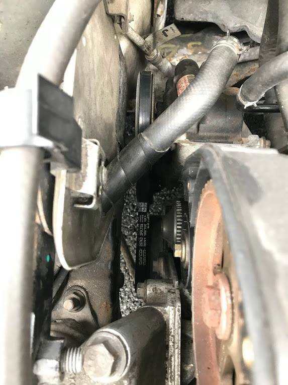

New belt on! Checked the tensioner while I was there - it feels fine. It's turning freely and there's no play in it which is good.
I've clean a fair amount of muck off the pulleys while I was there too... and it's actually made a difference!
It's not perfect, but the juddering is definitely less!! So maybe a combination of a slightly looser belt (5mm...) and some grime on the pulleys has been causing it to slip? Next time i'm under the bonnet, i'm going to give the pulleys a second clean and see how it goes. Definite headway though :)
Thanks for the suggestions everyone!
HOWEVER. Being the Streetwise, it's not going to let me off that easily. While taking it for a spin to test the new belt, the "boot open" dash warning light has started flickering on and off while driving. I suspect some water ingress to some cabling somewhere as it's been raining today. To quote myself: "I really don't know why I bother with this car."
