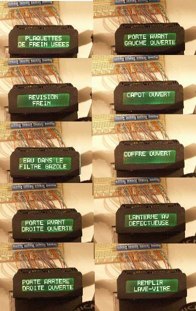

Neither of the two in my 827s have screen bleed although i know this is a common problem as ive had ones in the past with bleeds.... Currently they work perfectly fine and are fully functional other than the screen is fragmented no doubt due to ribbon/flexible connector you mentioned. Strangely it improves with temperature so the warmer the car is the better the display is. I will take some pictures tommorow and post them here
I have approached numerous companies in the UK with a view to getting it fixed but not one said they could or would be willing to fix it due to parts availability or lack of knowledge with the unit. The unit itself is crucial to the function of the car ive always put up with it simply because id rather have a functional car and an intermittent screen than the unit being broken or lost and the car being useless.
@jamescarruthers Its very difficult to find a picture of one with a fully working screen for comparison as the cars and the units themselves are so rare now but here is what mine looks like...  Like i say the display varies with tempature and use i believe the ribbon connector needs resoldering but theirs thousands of the little pins so i dont imagine its an easy job...
cRLvn5gP9ijXHVkM2dRKoEcGFtkpeY0VvU9IUIKG.thumb.jpg.9ba4d07f3815aed9d25e508644a5b698.jpg
82658064_2448412935473252_3349100770254389248_n.thumb.jpg.39e079b8046130194ddd809546c2701c.jpg
Situated under the radio
7IPOfwk1cpZeeS2aK2XoGvXPchOmxRt2zXjUdFIr.thumb.jpg.872e3309a8b416f385897c2f5471f916.jpg
