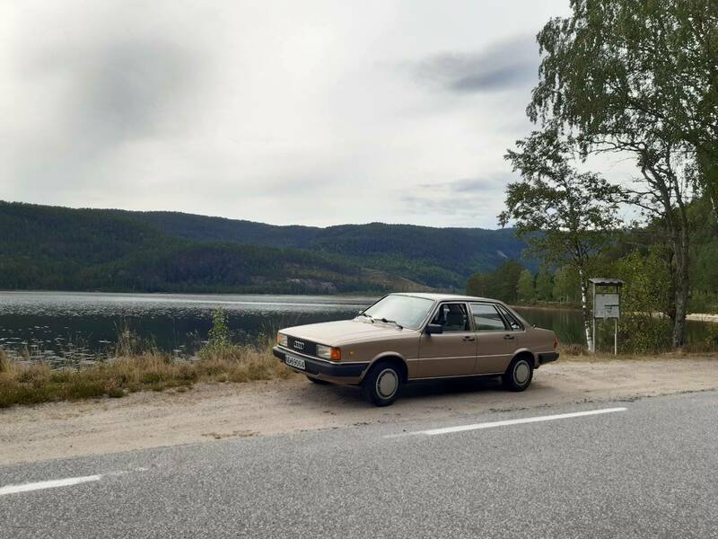

Dyslexic Viking Posted February 28, 2022 Posted February 28, 2022 Since I now have 3 vehicles, I thought it would be best to gather them all in one thread. So I now have 2 cars and 1 van. The modern Hyundai, The 1982 beige and green Audi 80CL, and the newest fleet member my 2004 Opel Vivaro 1.9 DTI. Audi Vivaro and with the Hyundai lurking in the background Lots of space for activities here. The interior needs a clean and new seats in better condition. A better photo of this from the previous owner taken in summer I have gone into the details of the Audi before, so I will focus on the Vivaro. It has 296,000km on it now and 2 previous owners. The first was a small municipality in western Norway that owned it from new to 2016 and the last owner from 2016 to 2022. It has until 2016 been maintained at the main dealer and the last owner has also maintained it well. And he was clearly sad to see it go but had to sell it. So it is in good shape for its age and mileage. The plan with this is to convert it into a camper something it is perfect for and a suitable retirement after a 18-year long working life. Dick Cheeseburger, stripped fred, cobblers and 17 others 20

Dyslexic Viking Posted February 28, 2022 Author Posted February 28, 2022 And if anyone in the future or now wants to know more about the Audi, I post a link here to the old thread on it. Mrs6C, AnnoyingPentium and juular 3
