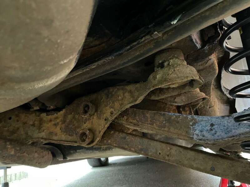

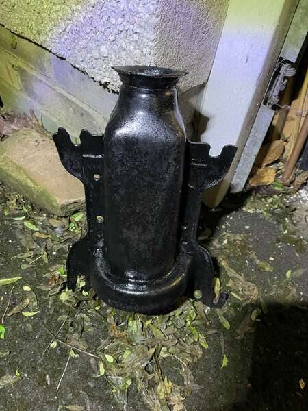

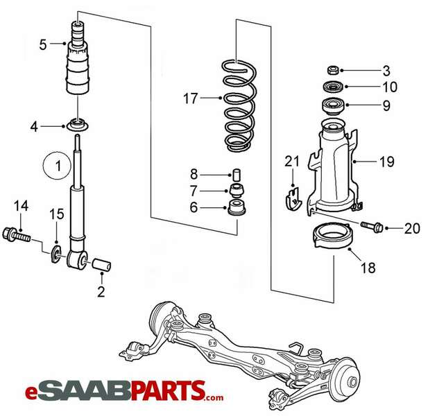

I cleaned up the carriers, whilst doing this I found a shim had fallen off one of them. I don’t know which one it came from! Does anyone know what the function of the shim is and how to determine where it should go?

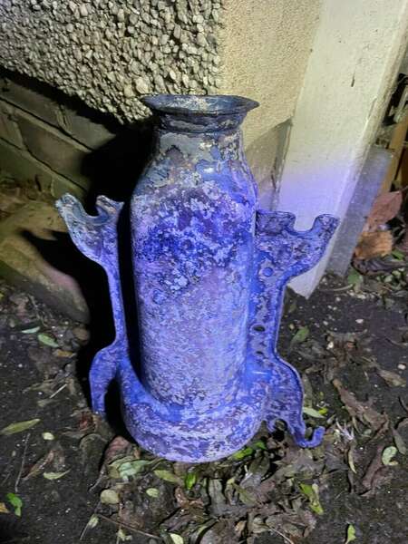

After a good bit of wire brushing they were treated to vactan.
And then black paint

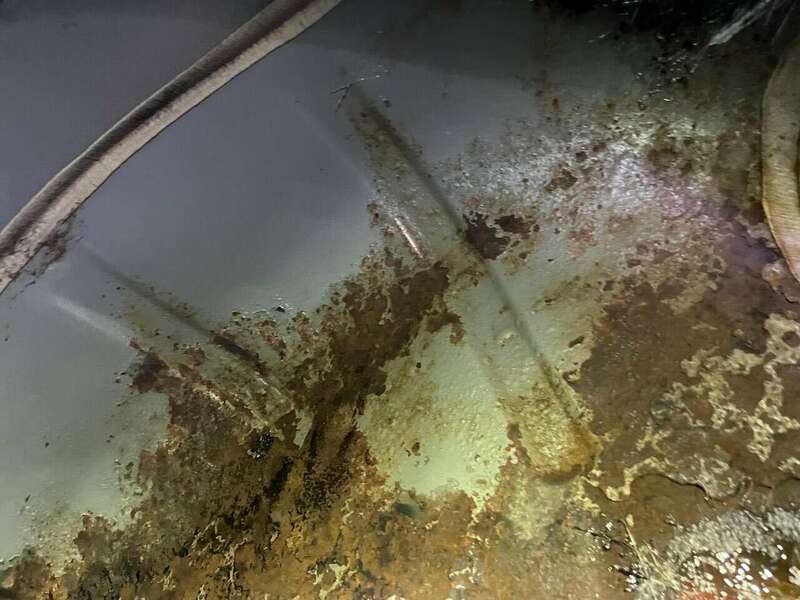

The wheel arches were quite badly rusted inside and around the fuel filler. This all got wired brushed and vactan applied.

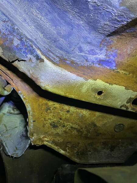

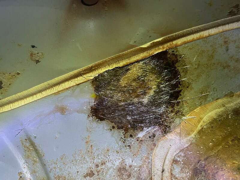

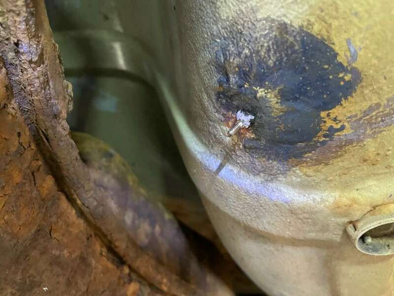

Both of them had a hole at the top of the arch where a fixing for the arch liner used to sit. I don’t have a welder nor did I want to have to rip out all the sound deadening foam to weld it, so I bodged two small glass fibre patches to cover the holes. It was great fun having resin drip onto you as you try and apply it to a surface above your head.

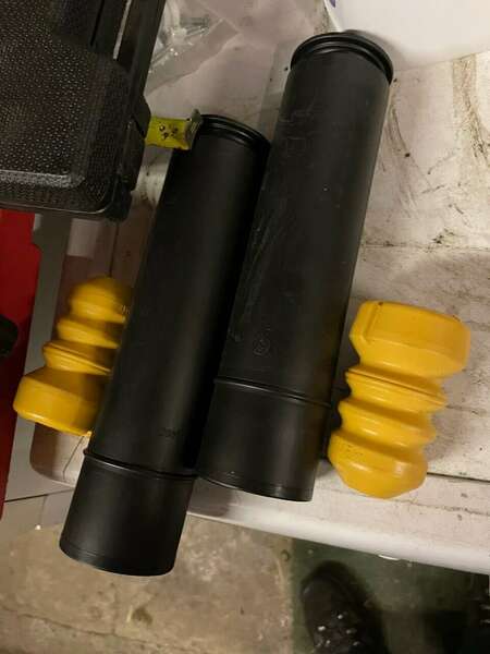

FFs I’ve got I picked up the shiny new bump stops tonight

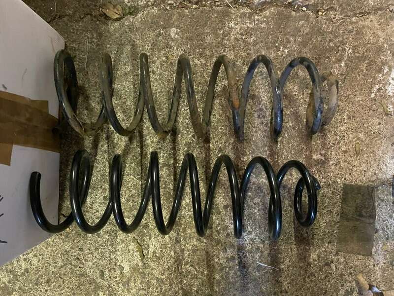

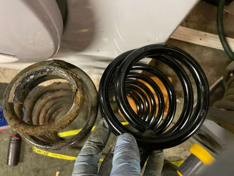

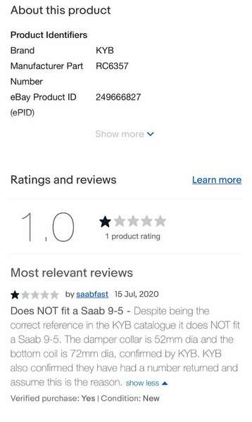

However I opened up my new springs and went to fit everything only to find the springs are too big at the bottom.
This is the part number for them
  • rainagain changed the title to Saab 9-5 FFS my springs are too small
From looking at eBay I’m not the only one with this problem

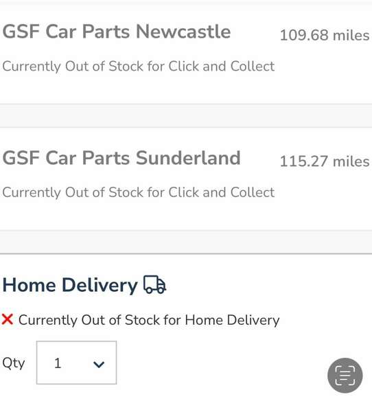

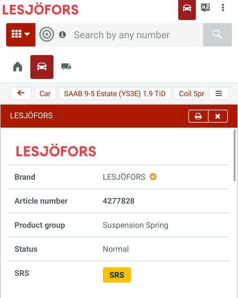

I checked Saabits and partsforsaabs, they had nothing listed. I found four matches on the GSF and I used the lesjorfors catalogue to get the right part number for sport suspension without self levelling.
I went to order them and this happened:
When will it end?!?!?

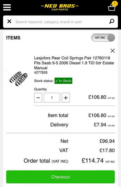

Found the right springs on neo bros, does anyone have a discount code for them?
@rainagain The last code i used was UKS2021 but obviously it might be 2022 or 2023 by now.
Ah bugger I just ordered them literally two minutes before you posted that! 🤣
13 hours ago, Wgl2019 said:
Set of Eibachs are highly recommended, slight lowering but progressive so actually make the car ride better on small bumps. £150 on eBay https://www.ebay.co.uk/p/1625302491
I just ordered two rear springs from neo bros, with express postage this comes to just under £120. After I placed the order I just realised for £30 more I could have gotten two front springs as well! Doh. No doubt one of the fronts will snap in the next couple of weeks.

The new springs arrived and were slightly shorter than the intact one I removed. Maybe at some point a spring has snapped and someone had fitted non sports springs?

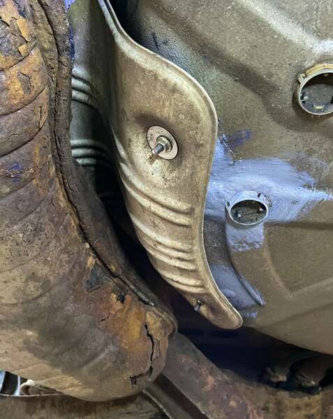

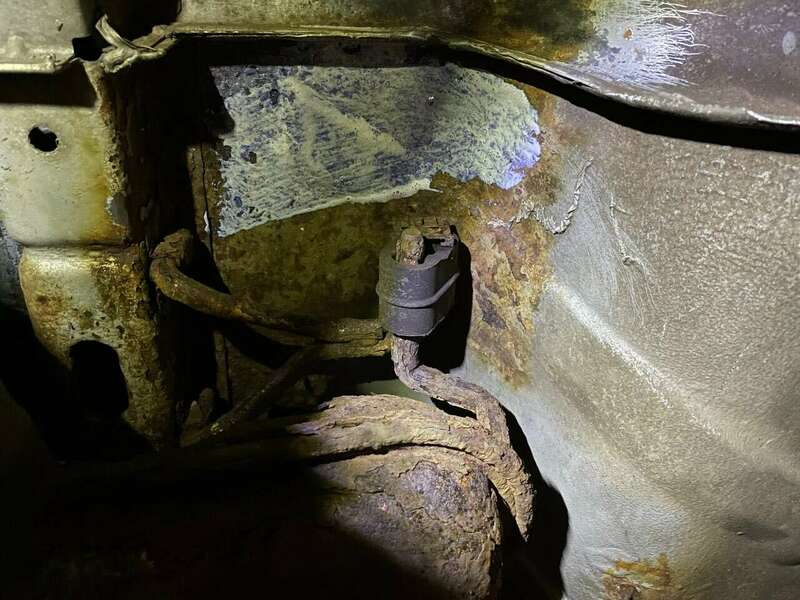

Just to make things more interesting whilst under the car the rear heat shield fell off as the studs securing it had rotted to nothing.
I did try and tap a new thread on them but they were so far gone it ended up being a M3 thread which is far too thin to hold any weight. I did manage to tap the one above the back box as it was less rusty.

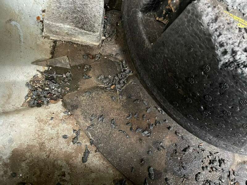

To replace the studs I snapped them off and then drilled holes into the spare wheel well, which had seen plenty of mouse action. There was also some water in the wheel well I’m not sure if I have a leak or if it’s just condensation from sitting
I then installed some new bolts with nut lock on them to stop them coming on done. The heat shield was bolted to these bolts between large washers as it had rotted round the bolts.

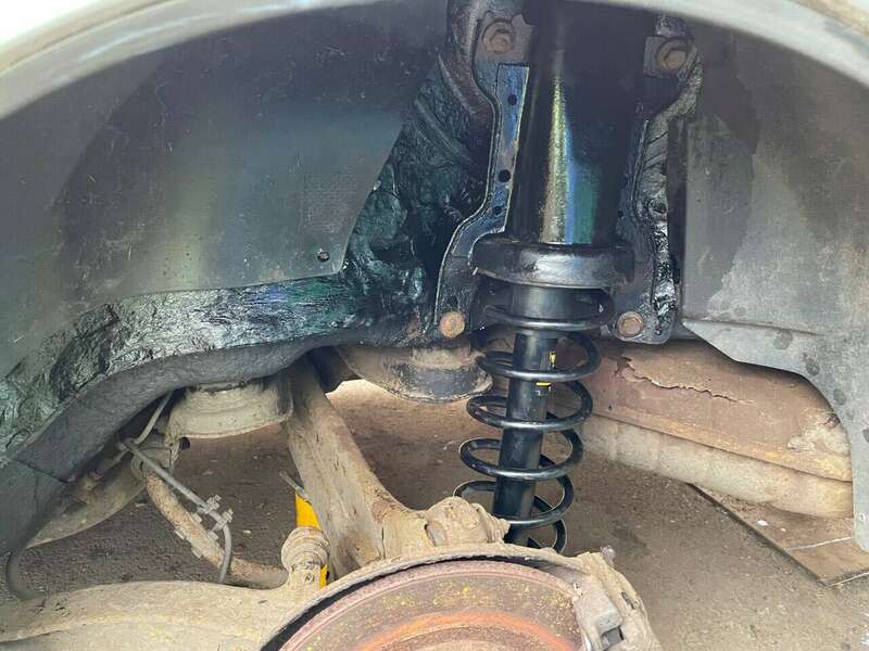

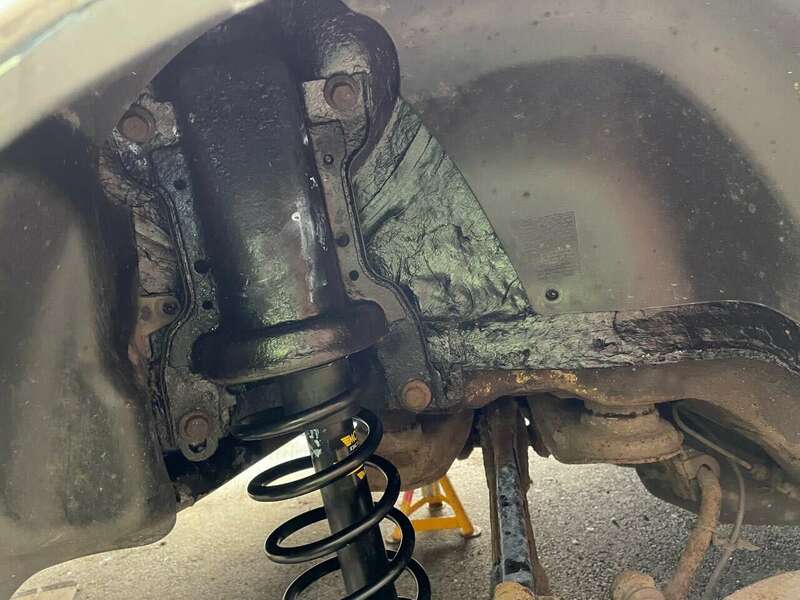

I build up the struts using the springs and my nice new Monroe shocks. They do look nice in the cleaned up arches. I even washed the wheel arch liners when I had them out. I wasn’t sure what side the shin was from as I’d seen pics online showing it on both sides. In the end I just left it out.

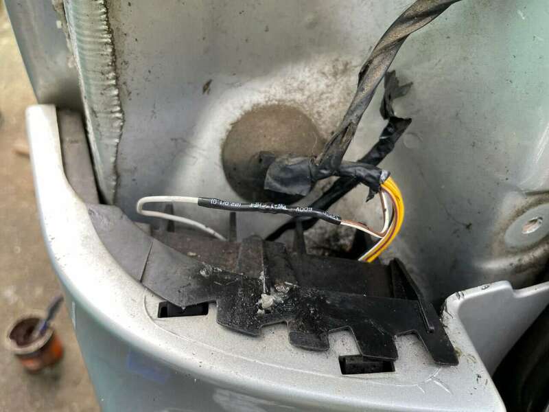

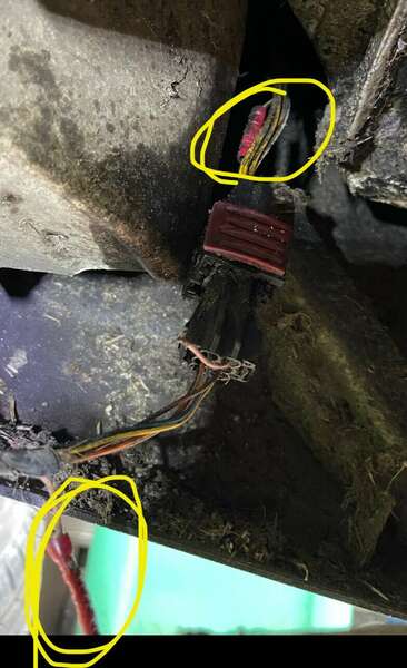

With the rear of the Saab in the air I noticed this broken wire for the parking sensors.
It looks like the connector pins failed and someone used these crimps to bypass it, however the wire that used to connected them together is long gone. I could get to the bottom wire quite easily but I couldn’t see how I could get to the top wire without taken the bumper off.
I instead traced the wiring harness up to just behind the rear tail light. I found the brown/white wire there and cut into it and added a piece of spare wire I had from the injector plug repair kit. This was fed under the car and joined to the other piece of wire. All the joints were heat shrinked to try and protect them.
I turned the ignition on and success! For the first time I now have parking sensors.
