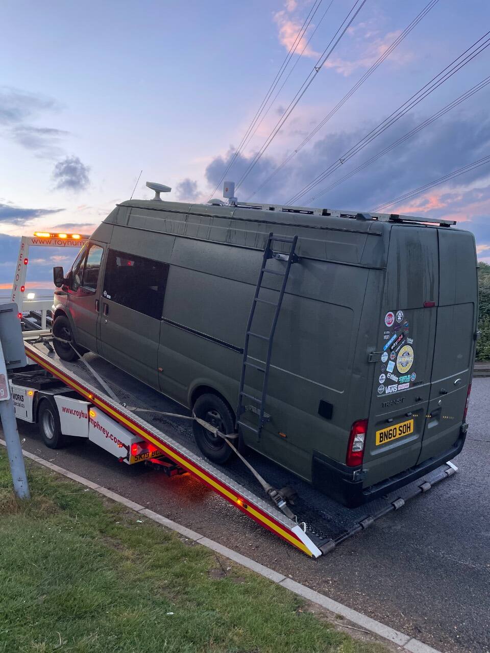

Made it to Norwich
No idea what’s happened but aux belt is shredded, all pulleys seem free so nothing has seized. Think it’s just come off somehow and got caught up.
Now waiting for the RAC… FFS…

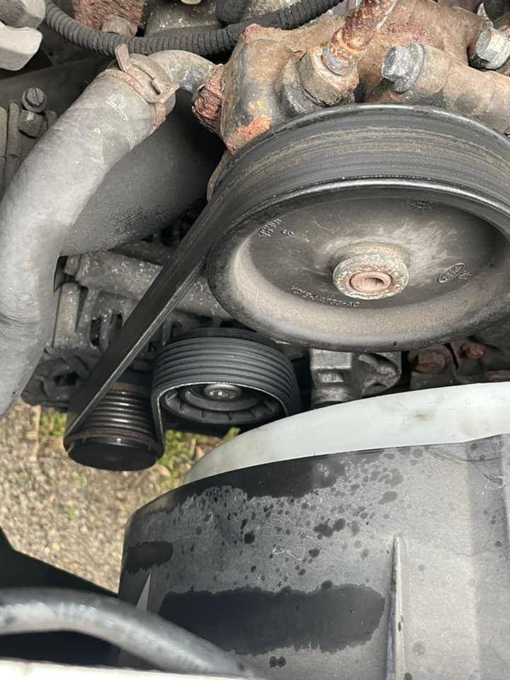

I trimmed the shredded bits off the belt, levered it back on with the wheel wrench and limped it to Thickthorn services.. belt came off again half way round the roundabout, forgot the lack of belt means I also lost vacuum so brakes too.. that shat me up.
Recovery company from Diss are on the way.
Trip to get a new belt and tensioner tomorrow, then see if anything else is causing it to throw the belt.
Nothing feels loose and the tensioner/belt I only fitted a couple of months ago so I’m at a loss currently…

I think to be honest it was just awful quality parts from Transit Parts UK, I hadn’t read reviews until afterwards..
The new Euro car parts Dayco belt was an awful lot harder to get on, even with the tensioner fully open it was tight to get on. The TPUK one wasn’t difficult and still squeaked sometimes. Also the tensioner they gave me.. first one the casting cracked when I put the square drive in on my breaker to open the tensioner, and both of them the belt sat off it 1/4” - see pic of beforehand.
The new belt doesn’t squeak at all, the tensioner sits right too.
Goes to show that £42 for belt and tensioner from TPUK as opposed to £128 from ECP is a big difference for a reason..

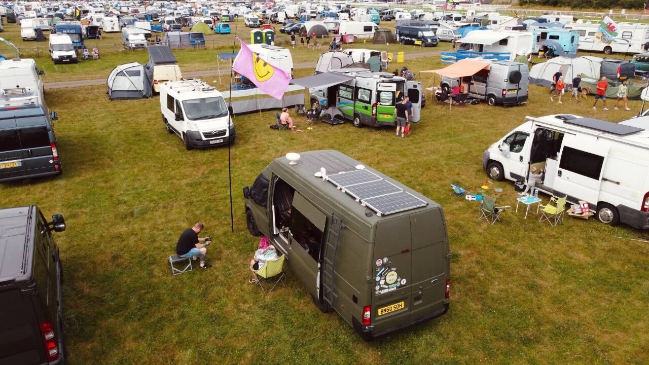

First trip out since it passed its MOT
Down at Stratford upon Avon racecourse for Vanlife Festival. Absolutely amazing, some fantastic builds. I want a Merc Vario next.
