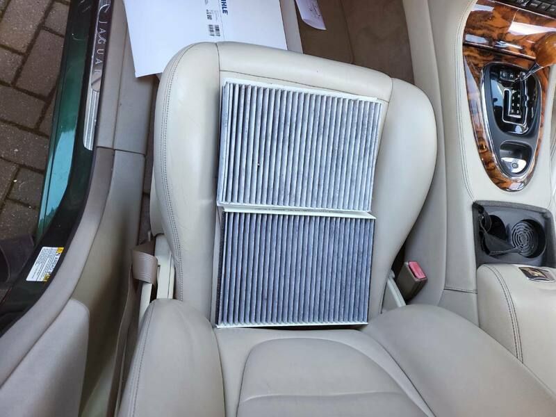

Lesson to self - check if things actually need replaced before buying replacements.  The old cabin filter (left) looks cleaner than the new cabin filter (right)...
If anyone needs a cabin filter for an X350 XJ let me know ...
EDIT: cabin air filter looks pretty clean too, but changed it anyway.
I changed the pollen filter - did I forget to mention that in my main thread? It was very spidery and the weather was unpleasant, so you probably cleared more out of there than I managed.

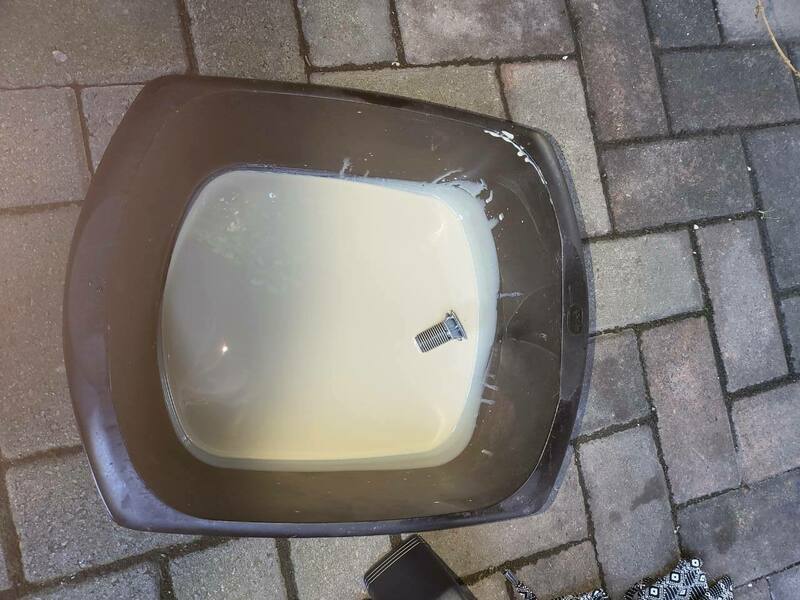

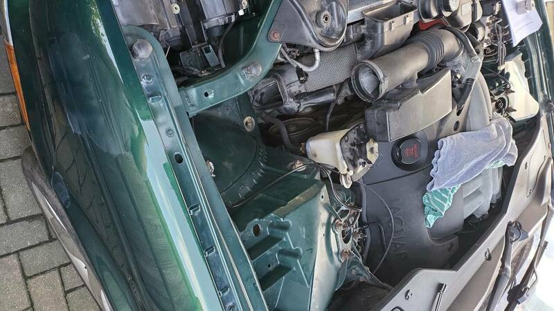

With thanks to my beautiful assistant / mentor @wesacosa the power steering fluid was flushed today
Would have been easy with the proper kit - airbox out, syringe fluid out of reservoir, return line off reservoir, blank off cap, connect pipe to return line and into bucket, 4l funnel on top of reservoir full of ps fluid, turn engine on and let drain through.
We had a bit of difficulty without having the right blanking caps, pipes and funnels.  Getting a seal for it not to leak at funnel to reservoir interplay was a challenge and my drive now looks like the exxon valdez.  But a bit of ingenuity and managed to make it work.  Amazing how quickly the pump draws 4l fluid through the system and most of my 9 quid a litre dexron iii ended up in it - best part of 5l used in the end and suspect system capacity is about 2l.
Desperately needs done as this is not what it should look like!
the procedure said to turn lock to lock 3 times slowly (5 seconds per steering wheel turn) but the 4L had gone before we had done one

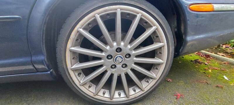

Oooh are these not proper desirable mega money wheels?  Not sure how I'd get them to me from Birmingham though ...
Not confident they are tbh. Mine look different and are the correct split rims. I do have a set of alloys at home also... wasn't sure if I wanted to part with them but I'll have a look and see20211012_132905.jpg
I will qualify my response and say I'm not sure if jaguar had a different design that looked similar? They're called sepangs on mine
Sabres on this one are supposedly desirable. I liked that they have sidewall

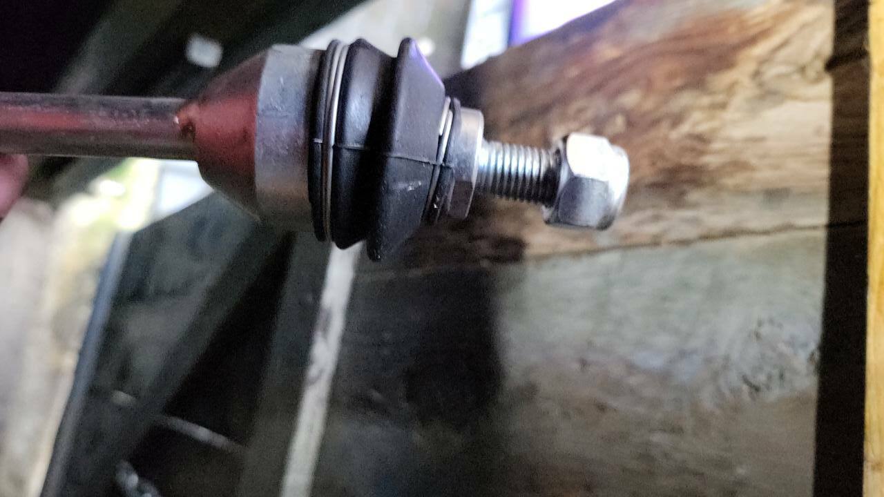

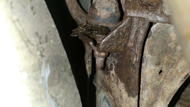

So attempted to fit the rear suspension links today.  What a nightmare.
The outer bolt came out easy.  The inner bolt was stuck tight but plenty of penetrating oil and a bit of effort and it turned.  Except it turned on both the outside and the inside and quickly mangled the ball joint.  I didn't realise at the time, but I think there was a hex slot on the end to keep it in place whilst it turned.
Over two hours of cursing and swearing (with some help from @wesacosa), mainly trying to clamp with mole grips to stop it turning, we had got it turned about halfway off but it refused to go any further on the rusty thread.  We then tried to cut it off with a dremel, but the discs kept snapping.  Eventually, we cut through the bolt, then i drilled that wider, then chiselled it wider, and eventually could turn it off.
Problem I now have is that the new part is impossible to tighten.  It has a slot for a spanner to fit on, except it is impossible to get a spanner to fit on it, as the bracket stops the head getting on and the body stops you getting in from an angle.  I am nervous about clamping with mole grips again as run the risk of damaging the boot. The aftermarket links I have don't have the hex slot on the end to hold them in place.  Any ideas?
Dreading doing the other side where the access is even worse ...
The bit circled in blue is where you are apparently meant to get a spanner in.
