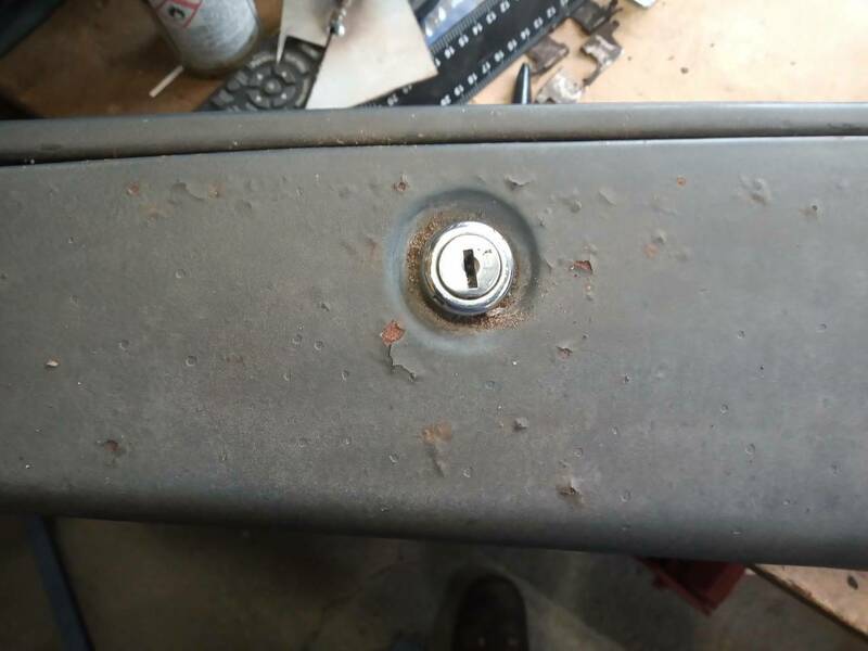

I have been slapping more layers of paint on this, now at the stone chip phase but its a tad boring. In the mean time I have been rifling through the garage and then noticed how grotty some of the bits of my MG are looking so decided on a slight spring clean....

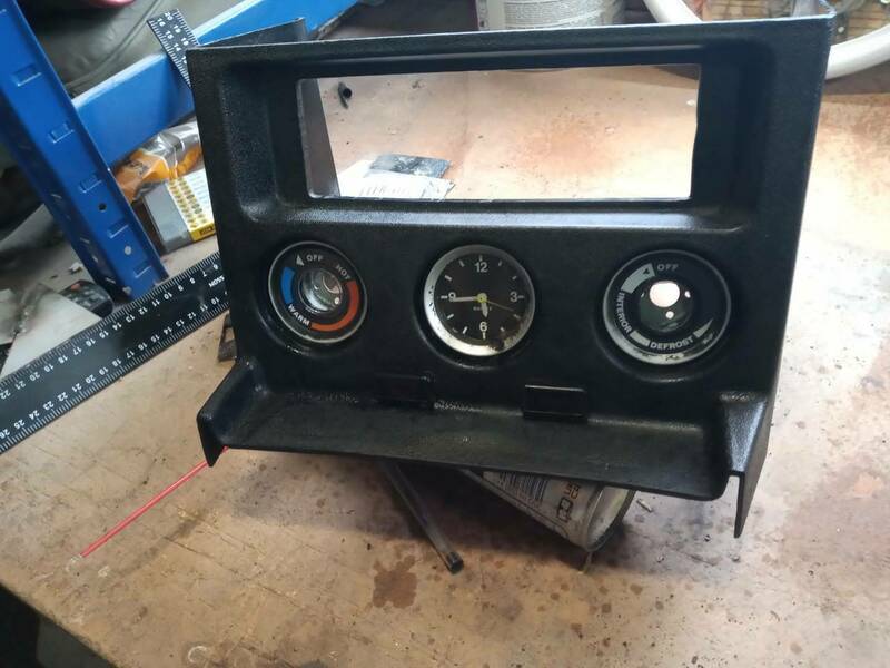

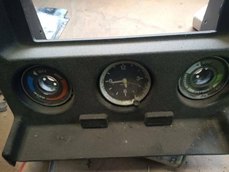

Starting with the center console which is thick with dust....
Some inappropriate cleaner and a rag later....
Then onto the dash itself kinda forget to get a before picture so this is after obvs..... I know its not great but its better than it was honest!
Then I spotted something, I thought it was just the body of the car that was rusty, the fun part of having a metal dash is that can rust too!
Admittedly its just surface  and its only the passenger that gets to look at it but I might have to do something about it..... Maybe....
Anyway time for another layer of stone chip on the Rover.....

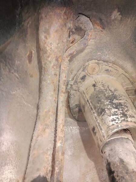

But then it gets worse, unfortunately the mud trapped against the back of the filler hadn't only caused the pipe work to rust through but also the strut tower.....
This was all completely hidden behind the fuel filler
The hole that isn't circled is the fuel filler hole! Its all a bit awkward to  get at and access from the inside is nearly impossible, great, I really love this sort of thing.....   🤪

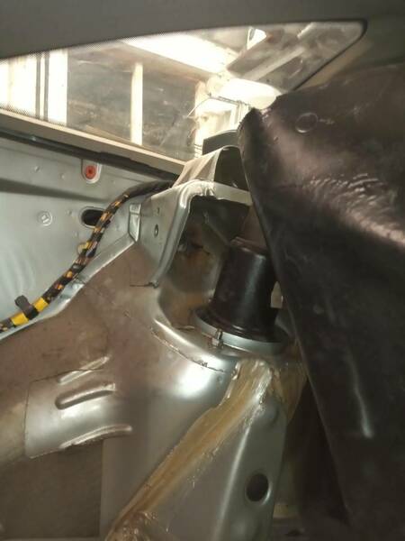

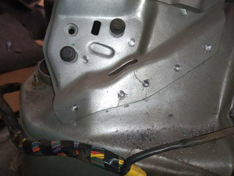

Anyway back to Rover prodding.......  The strut top repairs on the Rover are awkward as there is a bracket welded over the top of the rear struts which the seat belt reel is bolted too.  I think for best access I need to remove the brackety thing which means drilling out all the spot welds..
Picture with pointless red circle around the bracket...
Brackety thing without seat belt.....
You can see the rust hole and also why I will need to un stitch the top for good access. Maybe tomorrow I will get the spot weld drill bits out and use this as a distraction from worrying about the MOT ....
Regarding the fuel filler I thing I am going to use an early  Land Rover 90 filler neck as its short and has a vent line..
Probably make up the rest in hose...

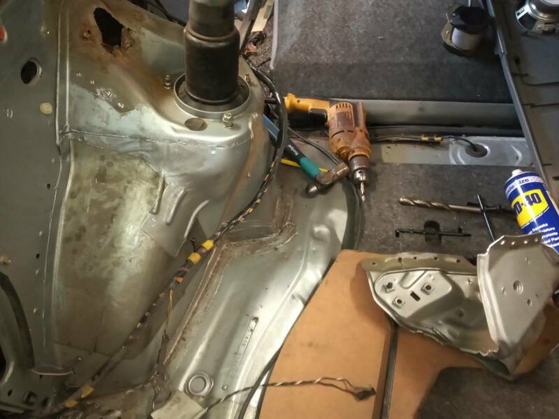

This morning I have been doing what I should have cracked on with yesterday...
Bracket removal time, carefully mark up were it should go back and then get the spot weld drill bit out.
Then get the long drill bit out to reach the awkward spot welds...
Then dug a couple of persuaders out and attacked it and off it came...
Ta dah no bracket and easy access to the rust hole.

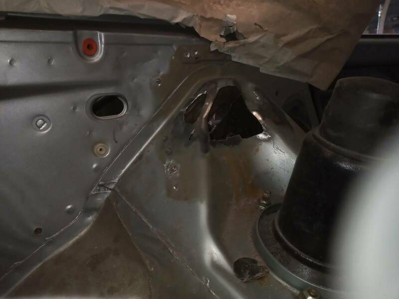

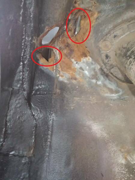

I am still focused on the rust hidden at the the top of the rear strut tower. I attacked it with a variety of angry wire brushes
Then decided that I needed to access to under the tower and to do that I would need to cut it off, erk.... So out with the spot weld drill bit and a slitting disc for the grinder...
Going for it, getting a bit mediaeval
Off! Now you can see (thanks to a slightly blurry picture) why I needed to do that.....
Yeah not much progress but I now have a clear plan, I will be welding in new metal on the inner wing (now I have access), then plating the strut top that I cut off (the good metal left is surprisingly thick possibly 2and a bit mill) and then weld that back on easy! And all because the fuel filler is a mud trap, nice.

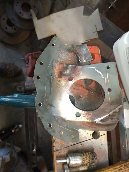

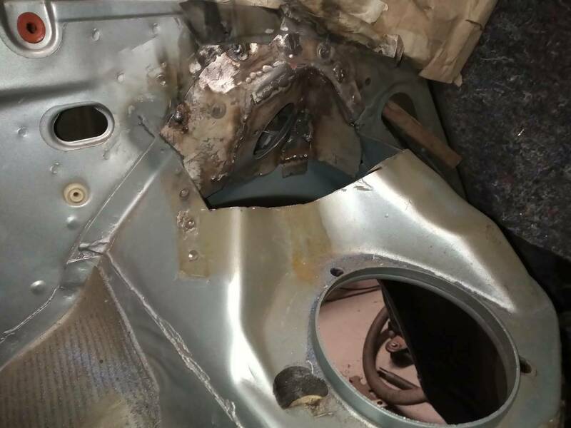

Small update...
The strut top is now plated up, the holes are no more...
Has the heat distorted it too much to be welded back on?
Well no it should fit might need a bit of persuading but seems okay..
The next thing to try and tackle is were the inner wheel arch around the fuel filler hole has crumbled to dust, the big issue is that its such an odd shape or at least it was....
I have been trying to cad it but apart from making a card board mess I am not getting very far...
The thing is its not exactly structural, for starters its got the filler hole in it so its just a bigger hole than it should be! The real issue is its supposed to keep mud, water, salt etc out of the inner wheel arch.  I am starting to think I might make the surrounding area strong and then try and create something in glass fiber to keep the mud out? Not sure will mull it over....
That's all for now!

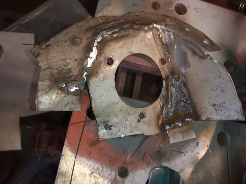

Its Rover time....

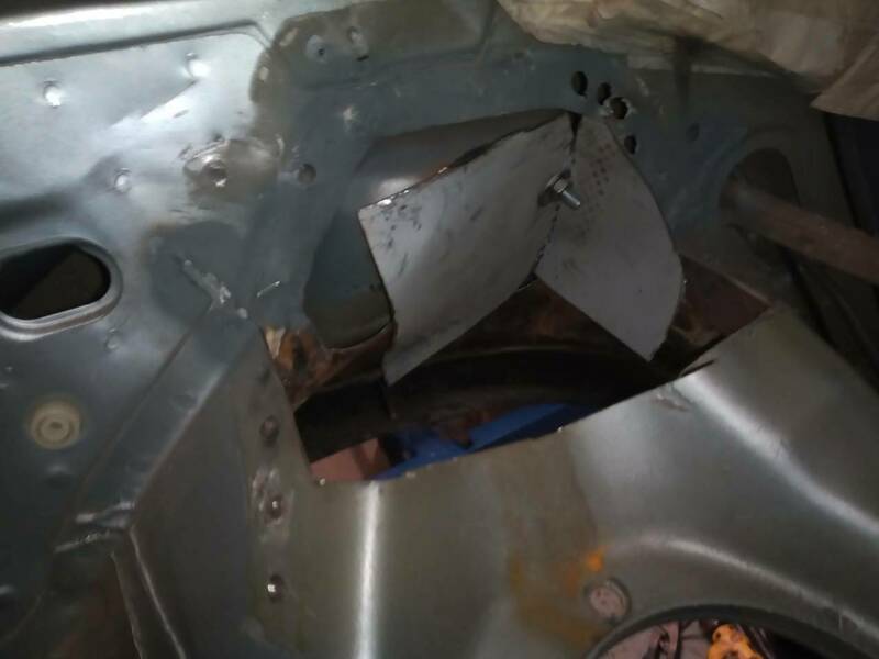

Predictably I am still on the body repairs and yes its that inner arch area behind the fuel filler. I did consider other ways of sealing the area but I decided that my best option was to stick with metal, better the devil you know well..

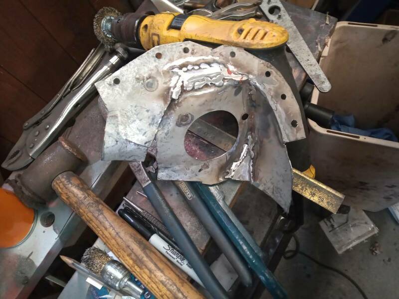

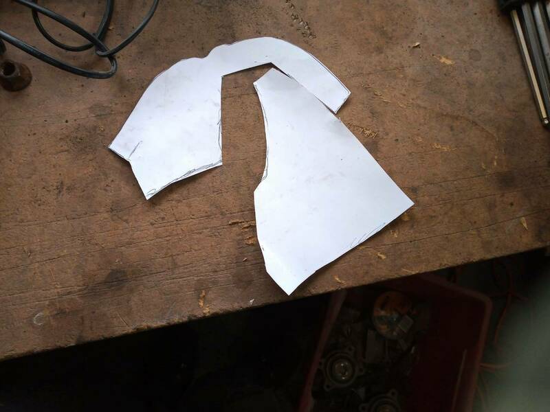

I decided to break it down as much as possible, templated and then made up a simple top section in steel and work  from there.
Pictured below is the top arched section  in steel and a card template of the awkward inner section.

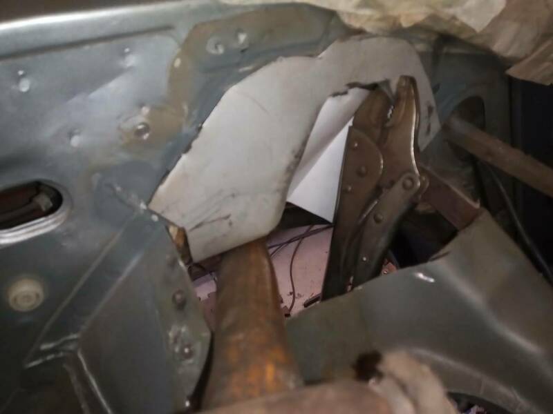

I then followed that up by making a rough inner section and marked up some holes to match the outer filler, so I could screw it in place.
Before the inner section looked rather hollow...
After

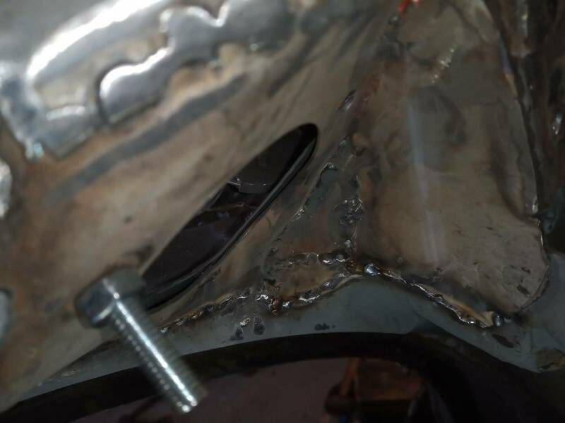

Once I was reasonably happy with the shape of it the next step was to weld the two sections together...
Yep that looks suitably odd, then another trial fit....
Not too bad, at this point I re fitted the top of the strut to see how that lined up...
Hmmm will need some finessing! Back to the inner part, it definitely has some issues, quite obviously a nice big gap that has been conveniently high lighted by a red circle...
So I cut out a little triangle infill bit and welded that in.
And after a bit more finessing (hammering and trimming in reality), re fitted it again..
That's a bit more like it.
Hopefully in the next instalment I will have received a new hole cutter (through the post) so I can cut a neat 60mm fuel filler hole in this part, then I will be in a position to weld this weird looking panel in place.
Thanks for reading....
22 hours ago, Marina door handles said:
Its Rover time....
After

Update time again, so more pictures that probably make little sense and some waffle.........
The hole saw arrived in the post so I could make a  neat hole for the filler.
This worked rather better than I expected...
And the view from the other side.
The next stage was what I thought would be a final fit but I found a gap in one corner so had to add another tab to the panel.
Looks even weirder from underneath but at least there are no gaping holes now!
So finally time to take a deep breath and start to weld the panel into place! But lets do a quick before and after.
Plug welding commences....
Look Ma no  hands, sorry I mean no tiny bolts...... And it stays in place!
At this point I had enough of crouching in the boot of the Rover, pins and needles had set in, in one of my feet, this is soooo much fun! Anyway progress of sorts, next time I will attempt to weld the bottom half of the panel in.
Thanks for reading.

A brief update, a little more welding, grinding and fun with paint.
Arty shot of welding to the lower section...
Red oxide on for protection.
Then weld through primer for the bits that are going to get a bit hot and bothered by the zappy sparky stick...
Next time I am off work I may get to weld the top section back on.....
