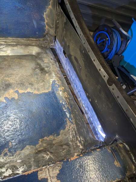

Set to work welding a repair piece into the front floor pan tonight.
Cut a clean edge out to weld against.
I didn't plan to butt weld this but actually ended up easier to as nowhere really to get a clamp in. The two pieces of metal level made it easy to get a magnet in.
This was an absolutely horrible job to do. Leant across the sharp metal inside with my head in the footwell. Wearing goggles, respirator, welding hood and helmet made it a tight uncomfortable fit.
I also got blue light shining on the wrong side of the helmet too. Presumably reflecting off the top of the footwell. I really hope the Sand Man doesn't come to visit me tomorrow 😬
Safety goggles are supposed to stop 99.99% of UV light, so that should offer some extra protection.

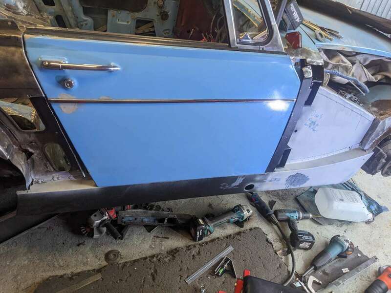

Next will be the a-post hinge plate. I grabbed the door and bolted the hinge panel on and put into place.
Checked everything still lined up, including this outer finishing panel. It's a useful check with those holes again. Then marked up at the bottom so I can make sure it's straight.
Also double checked the back panel mostly lines up when clamped.
It's starting to look more like a car again now. The door a post hinge panel and a-post outer finisher is next to weld on. Then back to that rear arch. That will take a bit longer as I need to fabricate some pieces to reconstruct the inner rear arch.

I had the whole day to do work on this today. Great in theory but two problems. I got up late and my neighbour came around for a chat. We ended up trying to refit the factory spoiler on his Audi R8. He bought it with an aftermarket one on and subsequent decided it looked crap. However it appears it had an aftermarket spoiler because someone had mucked up the connector on the factory mechanism.
Anyway I got a good 3hrs or so on this today.
Spent an awful lot of time lining up the door hinge panel.
Tacked into place once I was happy on the location.
Removed the clamps and test fitted the door. Thankfully it opens and closes just fine. Won't know completely for sure until everything is in place and on the floor but at least I know it's mostly in alignment. The bottom sticks out a fair bit, which it did before to be fair. However it's possible to push it in, so I suspect the door latch and hinges need adjustment. I did see some slack in the hinges, so that won't be helping either.
At least with these old tin cans, fit and finish was bad enough out the factory that I'm probably doing a far better job than when it came out of one. 🤣
As I was now happy with the fit, it was time to seam welded all along with a few puddle welds. I probably did it a bit too quickly as I got the ol' big thunk as the panel told me off for getting too much heat in and hence warped it a bit.
Finally started grinding the welds down. Not quite finished as slow going from having to use a finger sander to get in there.
Now time to be off to the local cheap carvery for some food!
Once ground down the welds, it'll be time to fit that outer cover piece. Then the front is done! (Actually not true as I have been poking and found some hole that need patching in the arch)
