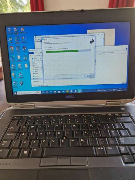

In other news my knocky Delphi diagnostic reader has arrived from Ali Express, all £30 worth. I can't say I desperately need it right now but I'm sure it'll come in handy. The laptop I'm using is sacrificial so it doesn't matter too much if the supplied software has AIDS.

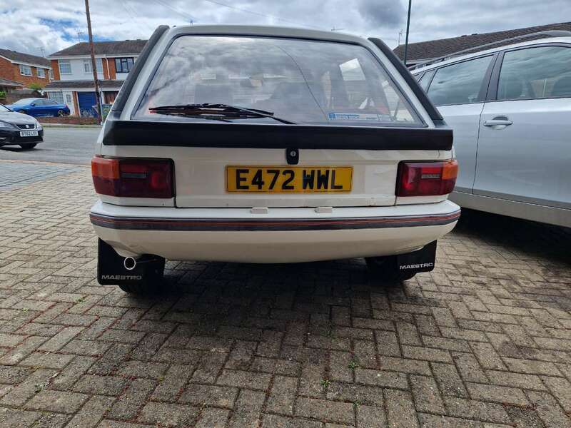

Today I waited until the Maestro was dry enough then put it in the garage. It's been a crap day weather wise.
Collected the BMW wheels with their 6mm Continentaaaals and stuck them on the front, had a passing glance at the front brakes which look fairly new.

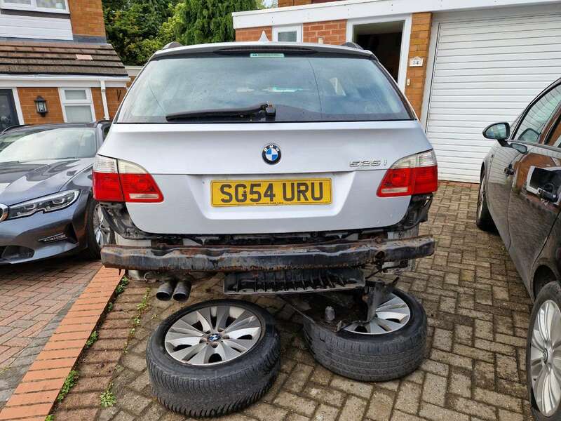

Then jacked up the rear to commence bumper removal for parking sensor fitting. Usual ballache of rusted fixings but also the battery tray boot floor bit is pretty ripe and the spare wheel well is on the go, too. I'm giving this zero attention.
Bumper came off easy enough but I was scratching my head wondering why I couldn't find the live feed to reversing lights but like a numpty I was checking the (clear) indicators.
Of course the reversing lights are mounted on the tailgate, which is a pain in the ass because now I've got to drop the headliner to find the reverse light feed. Like all good mechanics I gave up at this point and had a cup of tea.
I'll be using a relay as I've had trouble with direct feeds before, plus the battery is in the boot so easy enough to find a 12v feed.

Continuation of Project Reversing Sensors today, I finally managed to find the reversing light wire in the D-pillar harness. Which is good because the situation above the headliner was not conducive to finding the wire I needed. I did spot roof mounted rear speakers which would partly  explain why the sound system is more than adequate in terms of sound quality.
The Spur on the reversing light wire switches a relay which feeds a fused battery +12v to the reversing sensor module. Handy having the battery in the rear corner for this.
The kit came with a cheesy LED display but no way am I pulling out the trim to fit it on the dash, it looks shit anyway.

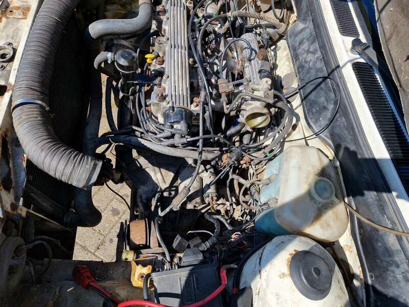

After this job is complete, it'll be under the bonnet to fit the intake hose to hopefully cure the lean running engine light. I'm not familiar with how to remove the engine covers and things on a Beemer so this will be a voyage of discovery.

Changing this intake hose was a bit of a logic puzzle but I got there in the end, there are a few strategic removable bits and pieces that help with access. Sure enough the old one was "sealed" with silicone goo which had probably let go after a few hundred heat cycles.
There's plenty of evidence that muppets have been let loose on this car. I mean it's fine as it goes and stops but taking stuff apart revealed plenty of broken off clips and rounded screw heads. I think some of the harness routing under the bonnet is a bit fishy, too.

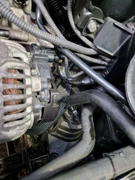

There is a minor oil leak, I think on the lhs of the engine. It doesn't seem to be dripping out but it's quite grubby down there. Do any bmw lickers eg @Tepper have any thoughts as to the culprit? It's an old-skool M54 I think.

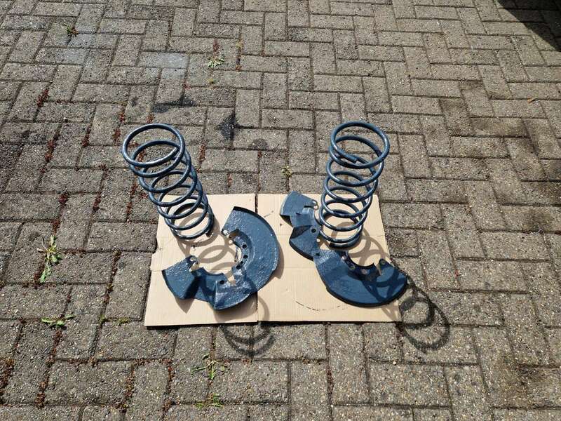

When I do eventually get round to the clutch, there are a host of other upgrades to go on at the same time.
To get the drive shafts out, I need to at least partially dismantle the front suspension. So that seems like a good opportunity to change the struts for the adjustable Leda rally jobs I have in Stores. I've got new bushes for the lower arms, new ball joints, new wheel bearings (if needed), new strut top mounts and bearings... Basically a complete overhaul of the front end.
I do wonder if my car has incorrect bottom ball joints. Early cars had a 'symmetrical' type but it was later modified to an 'offset' to change the castor angle. My steering is very heavy, perhaps just 'of its time' but maybe because wrong ball joints are present.

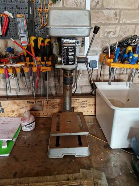

Simply couldn't be arsed to tinker today despite the fine weather. There is other stuff going on such as Master Grogee's swimming lessons, and a trip to a charity outfit called TWAM who sell on 2nd hand tools.
I went to collect one of those slightly shonky pillar drills which clamps a normal electric hand drill into a frame, but it had gone by the time I got there. The lads there were great though and they found another, much better one but it wasn't tested. They PAT tested it then checked out the bearings and said I could have it for £15! I gave them £20. Check them out, they are making the world a better place: https://www.twam.uk/

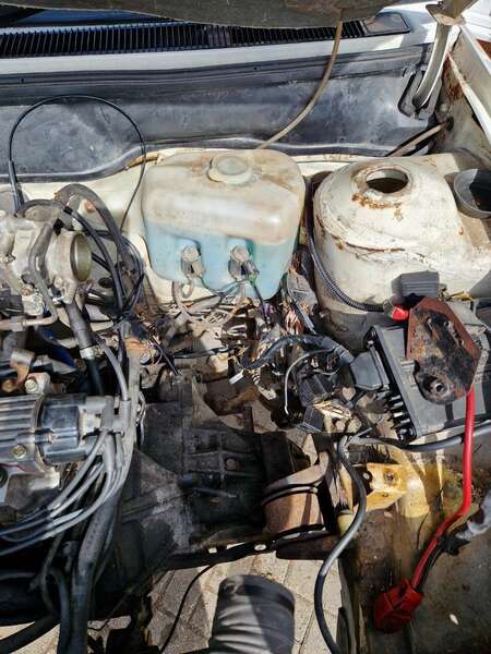

Then I decided to fix the BMW battery. It's had a way-too-small one floating about in the battery box unsecured and it was bugging me. I have a selection of spares including a nice AGM one which I've now fitted.
The correct spec is an 019 battery but this one will do, it's in good health and has plenty of oomph for winter starting. Because it's too short I engineered bodged some wood to fill the empty space, but it's properly clamped down now.
Of course whenever I try and do something good to my cars it comes back to bite me. Turned on the ignition to be met with the airbag warning light. Luckily my code reader was able to tell those high/low voltage codes to FRO and now we're back to 'only' one warning light for lean running.

The Maestro has been running a bit lumpy lately. Well it's fine with a decent stab of throttle but that barely open/light cruise is causing it to miss and stumble. We're dealing with a sophisticated* electronic fuel injection system here, so I can't just tweak carb to fix it.
My suspicions lie with the throttle body. Having read up on it, apparently these are fussy about the exact voltage from the throttle position sensor at idle. And also they can get gummed up in the bypass/idle valve area. Mine hasn't been idling smoothly at all, though I'm not sure how great they were from the factory. Idle speed is set at 650rpm which feels a bit slow for a 4-cyl but it's set in stone by the ECU.
@Cluffy and I had trouble with this in our 1990 XJ40 (a vehicle also blessed* with Lucas electrics) and luckily managed to find a working TPS for not megabucks.
I obtained a used throttle body a while ago and cleaned it up, greased the spindle etc so it's good to go on.
Swapping them over is a little complicated because it's in the coolant circuit and the breathers and vacuum feed etc but once disassembled it's reasonably easy to swap over.
I can report that the symptoms... are exactly the same. Except now my idle is too high.
I've alternately been wondering if a failing coil is struggling to ignite a lean mixture: had similar symptoms on a Mini once that loved to backfire on the overrun but changing the coil fixed it.
Theory 2 is that it's not happy on 95 RON. Yes I know it's meant to have leaded 97 but I was too tight to buy that last time and just threw in some extra redex to compensate.
Anyway I've just put a load of 99 Tesco juice in plus a splash of Redex so that may eliminate that possibility.

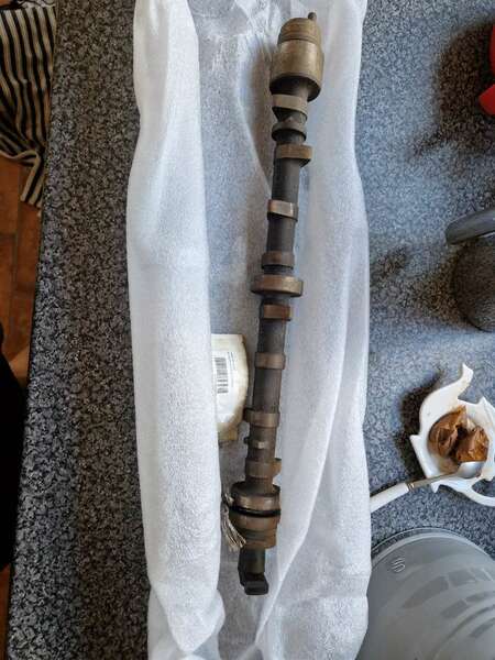

Also the camshaft I ordered from Spain arrived. I'm fairly certain this is NOS judging by the waxy stuff all over it. This is the missing puzzle piece for Project Ported Head - I've found a company willing to fix my cam seal problem, so I'll drop this and the head round to them tomorrow.

Discussed earlier in my boring thread is the new cylinder head and camshaft mismatch.
Despite both being 2.0 O-series heads, for whatever reason the carb-fed Montego (and SD1?) uses a different camshaft to the MG Maestro and Montego.
If you put the MG camshaft in the non-MG head, you get this: distributor side of the camshaft has next to no room for a seal. My initial thought was to machine out the head to accept the 'proper' seal, but after speaking with a porting company they've suggested machining down the cam seal face so it works with whatever seal the standard O-series uses.
Anyway, this cam is apparently NOS for a catalyst equipped MG Montego. I'm about 75% certain this doesn't matter and it'll be the same as a non-cat cam.
Quite possibly different valve timing and lift for injected and carb engines.  Have you checked?
Link to comment
Share on other sites
Both my camshafts are for EFi engines. One is for a non-cat version, my newest one in the pics is for an EFi cat version.
I'm pretty sure they are the same.
As you say, carb-fed and injection camshafts are likely to be different.

Popped round to see these guys, SC Porting near Rugby. https://www.scporting.co.uk/
They are going to get my cam seal face ground down so the standard (40/52mm) seal fits over it.
They are also going to check the valve seat inserts for hardness: if they're not up to task then they will replace with hardened seat inserts and machine the valve seat.
Interestingly I noticed quite a lot of pitting on the exhaust valves of the existing head so it's not been happy on unleaded presuming that's what it's had.
Once that's sorted out they will smooth out the ports a bit, there's not huge gains to be made but it can be flowed to give a bit of a power hike.
After that I thought I'd give the BMW some love. I noticed the ARB bushes had some play and there's a clonk when going over bumps. I ordered some Meyle replacements a while ago so with the sun shining I replaced them. What a nice easy job for once!
With the front up in the air I also took the osf brake off to have a closer look at the bearing. It's not obvious with the wheel on, but once I was able to get my hand on the hub it felt pretty crunchy. No play yet but that must be the source of the noise.

Operation Clutch. I really couldn't have asked for better weather, gorgeous day. Too hot really but I much prefer this to the grey unpredictability of July and August.
The plan is to strip down the Maestro front end and swap in some Leda adjustable struts. There's a whole host of rubbery and ball-jointy bits on standby should they be needed.
So far it seems to have behaved itself apart from a rounded out disc retention screw which I've drilled out now. That said, I'm not exactly working at breakneck speed, mainly because I'm writing down where all the nuts and bolts go. Also attending to silly things like pads seized into caliper bracket.
Surprisingly the drive shaft isn't seized in the hub, it's moving freely which bodes well for the next steps. Unfortunately the caliper piston seal is FUBAR so that'll have to go in the Bits To Buy list. I was going to swap over discs and pads for new items but there seems no point, the current ones are fine.
Unfortunately I was treated to a dirty protest from the Maestro this morning. It's wet itself around the rear, almost certainly my half-assed 'repair' to the fuel line return spigot. I think I'm going to treat the pinhole leak with some JB Weld and possibly heat shrink (not using a lighter).

Moar progress, if disassembly = progress. Left side basically stripped out. I've got the springs and brake shield marinating in some rust juice. They're a bit flaky but solid enough so should be OK after some paint. I know MoT testers now seem to have a hangup about rusty springs, which they never bothered about before.
Found a cute little BL bodge above the gearbox. There's a short 6" speedo cable that goes to a little gearbox (I think) and then the 'normal' speedo cable connects to that. Reading between the lines this is a result of using the Honda gearbox with the standard Maestro and Montego instruments... How pointlessly expensive was that?

Also been splodging some Smoothrite onto the springs and disc shields. Not strictly necessarily but this was always going to be an extended 'while you're in there' type job rather than a sprint.
