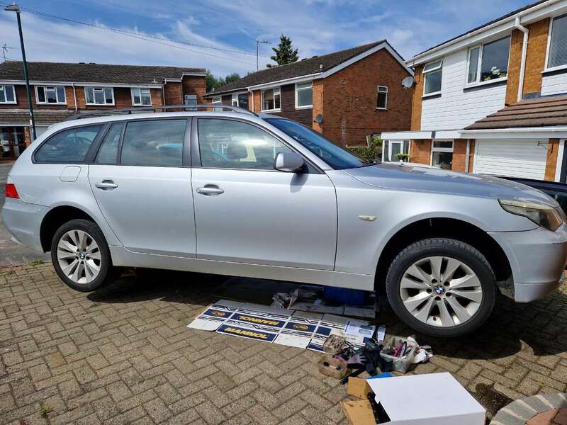

Found a window of time to tackle the BMW autobox fluid today. Once warmed up after a little drive up and down the bypass, I jacked it up level* and drained the fluid.
No need to remove the undertrays, they're long gone. It's running naked in true AS style.
The old fluid was proper stinky, and 'too many kickdowns' dark brown. I can't really describe the smell other than to say it was synthetic and decaying.
Managed to round off one of the Torx bolts holding the pan/filter on. I'm going to claim innocence here because I did my best with a good quality t27 bit and impact driver but in the end it just chewed it up. Being a plastic item it wasn't too hard to just break it off then retrieve the stuck bolt with some mole grips. Fortunately it was one of the most accessible fixings, what are the odds?
Cleaned up the gasket face. I considered taking out the solenoids for a 'decoke' but my spidey sense told me I'd regret it so I left well alone.
Feeling smug, I set up my fuel pump to confirm it would be happy pumping ATF. Clickclackclickclackclickclackclickclackclickclack
<silence>.
Oh, buggeration. Pump won't pump. I'm going to have to resort to manual fill method, with gravity fill not an option due to location.
Found my Big Syringe thing that I'd bought for whatever was the last bastard gearbox I did. What a piece of crap! Leaky, shitty seal inside and it wouldn't suck up enough juice. So I took it apart thinking maybe I could somehow improve the seal. I turned it around then heated it with a hot air gun to soften it.
That sort of worked, but the process of suck up fluid -> shuffle under car -> find fill hole -> press plunger was fraught with drips and spills. In the end I estimate I lost a litre of fluid to my shitty filling tool but it was either that or have no car while I find another fill tool. Luckily I'd bought 8 litres and I've got maybe 1-2 litres left over.
It's not helped by the method, which is:
1) fill to level
2) start and run for 30 sec
3) fill to level
4) start and select gears with foot on the brake, hold for 3 sec, change gear, repeat for a while.
5) select Park, go back under, remove fill plug, fill to level (with engine running).

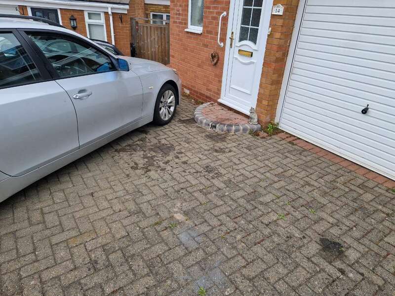

Basically this means I and the drive were showered in ATF - in my hair, all over my clothes, legs, arms etc etc.
Anyway. With my tools cleaned up with brake fluid and the car back on terra firma, I treated* myself to a shower. While disposing responsibly* of the old filter/pan, I noticed a 2012 date stamp. So not the original fluid as I suspected, but still perhaps ten years old so well worth changing. Who knows if it was filled with the correct fluid last time?
With some trepidation, I got in the car to go for a confirmation drive - has my hard work (and mess) fixed the problem?
Yes. Yes it has. This is a big relief and means the big BM is more or less cleared for duty as a winter beater. I celebrated by checking the tyre pressures which were all wrong then confused myself with the 'RPA' tyre pressure monitor thing... It needs to be run to initialise properly.
Someone is smiling on me up there today. I CBA cleaning up the oil stains on the drive but luckily it rained before Mrs Grogee could see the mess, hopefully it will all magically disappear.

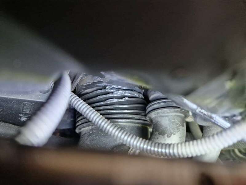

I have been pouring over RealOEM site for part numbers of bits to suit my parts darts approach to fixing suspension knock and PAS rumble.
Link to comment
Share on other sites
51 minutes ago, grogee said:
Yeah, I suspect the cat may not be happy and performance may take a knock, but I haven't got time to investigate before we go to Lincs this afternoon let alone fix it.
Actually I found a window of time and wielded the easy-start around the intake hose. The engine continued its smooth straight-six idle without any indication of ingesting easy-start.
However I did find evidence of a previous repair. I would criticise this for shonkiness except I was planning to do exactly the same thing - smother some goo over the offending area.
Anyway I think I've found a £25 replacement so that's not too extortionate... assuming this is the area of the air leak.

Mrs Grogee pronounced the BMW 'very smooth' which it is really. Fantastic cruiser. Trip is claiming 37.2mpg now which I don't believe but it's better than I expected.
I was musing on the journey to Lincs why it seems a bit slow off the mark sometimes. I think it's because peak torque is around 4-5000rpm but it spends most of its time trundling around at 1500-2500rpm, so it needs to be wound up before it finally feels fast-ish.
I couldn't help but wonder what a less shonky 525d-530d-535d might be like, with max torque from 1500ish rpm. I bet they're pretty needy with miles on the clock though.
The cabin is a really nice place to be but I would like to be able to sit higher, being a short arse. I have considered unbolting the seats and putting in some spacers with longer bolts but dunno if I'll do this. Crash safety yada yada.
Had another think about the supposed PAS grumble. Surely if there was a PAS problem, it would be worst at low speed or stationary. But when manoeuvring it's basically silent as far as I can tell. The grumble comes when cornering at speed - not racecar cornering but just a gentle curve at cruising speed.
I'm beginning to think it's the winter tyres on the front because it's not consistent left to right and there are two mismatched winter tyres on the front. I'm going to put the Continentals I've purchased on the front to test this theory.
