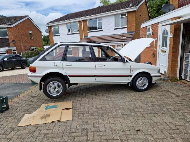

grogee Posted July 1, 2023 Author Posted July 1, 2023 While waiting for bits to arrive I decided to change the rear shocks to the Spax units I sourced last year. Found them still in their postage box, and was pleasantly surprised to find they came complete with springs. However, as you can see these are max power lowering springs so I've decided to throw the original springs back on. Meanwhile I've stripped the head having sourced a decent (Sykes Pickavant) spring compressor yesterday for £40. To set the valve clearances on the new head involves either finding a special tool (unobtainium) and even then I need to source special shims which are also unobtainium. I am inclined to check the clearances but I may have to live with whatever they are. I did buy a set of nearly new buckets, springs and shims but I'd need a micrometer to know what thickness the shims are. Dyslexic Viking 1
grogee Posted July 1, 2023 Author Posted July 1, 2023 Having looked at the valve clearance procedure in the HBoL, I've decided to forget that shit. Needs a special tool OR the home made one specified by Haynes which needs angle iron, plywood and a whole lot of patience. Fuck that to the moon and back. I'll take my chances by refitting the existing shims in their original positions and hope for the best! Even if I went to the trouble of checking the clearances, the odds of me finding the correct shims for all eight valves are miniscule. Fuethermore the HBoL specifies quite a tight range for clearances, but then says only change if it's less than 0.20, suggesting there's quite a wide range of practical tolerance. Matty and Dyslexic Viking 2

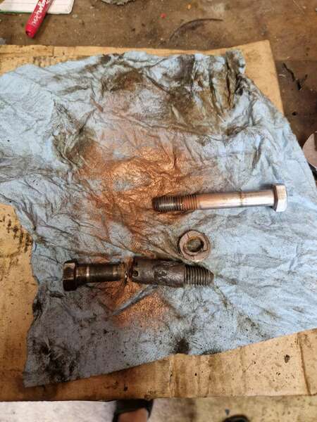

grogee Posted July 1, 2023 Author Posted July 1, 2023 Took the other rear damper off, well tried to anyway. It's done that trick where the inner bush sleeve is seized onto the bolt so you can't get it out. In the end it was a slitting disc carefully* wielded to cut through the bolt, and as luck would have it I had an almost identical replacement in Stores. I did make a bit of a mess of the beam axle where the damper mounts, but hopefully nothing too structural. The other Spax unit is now ready to go on, but proceedings were halted for a slap-up birthday lunch at Hickory's (if you know, you know). Matty and Dyslexic Viking 2

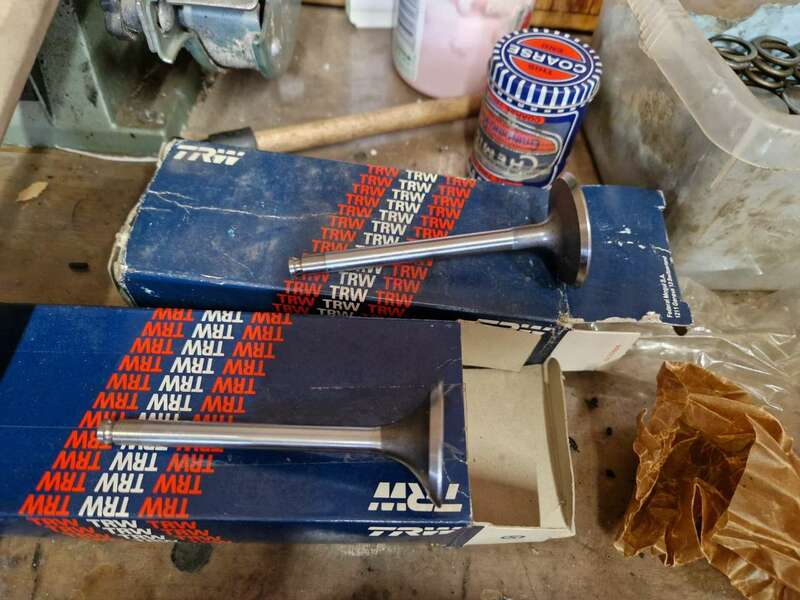

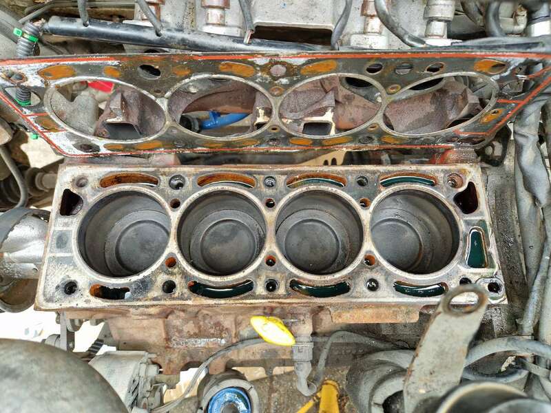

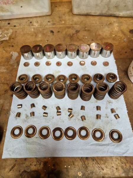

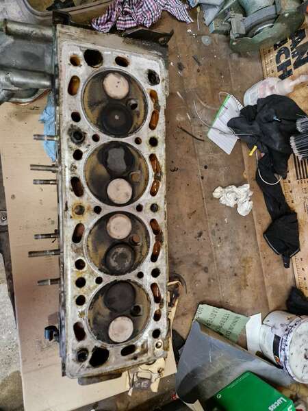

grogee Posted July 2, 2023 Author Posted July 2, 2023 Valve grinding day. I've come in for a cuppa and to listen to the end of the test match, four valves done and four to go. I'm glad it's not a 16v. New head is lovely NOSness and arrived in that waxy paper and a BL box. The cam cover is different so I'm not sure whether to use the (original) ribbed cover or change to this nice shiny new one, which is strictly speaking the wrong sort, cosmetically. I've decided I've got to do the valve clearances after all. I wouldn't be able to live with myself if it was tappety or didn't run right because I couldn't be bothered to set it up right. To that end I've ordered some angle iron to make the HBoL DIY special tool to clamp the camshaft down so clearances can be checked. What a pain in the arris. The other very BL aspect of this head is the way the valve seat inserts sit in the head. There is a recess around them that is perfect for valve grinding paste to collect in. And helpfully, the HBoL states: "... If particles of carbon or grinding paste should work their way into the engine, they would cause havoc with bearings or cylinder walls." Thanks Haynes, I'll make sure I clean it with my tongue then. On the subject of the valve seats - they are steel (magnetic) which lends credence to the Wikipedia claim that all 2.0 O-series can be run on unleaded. The handbook says otherwise of course but I suspect AR was just covering its arse. Sunny Jim, N19, Dyslexic Viking and 6 others 9
somewhatfoolish Posted July 2, 2023 Posted July 2, 2023 Never done the clearances on one of these although all shim systems are generally a complete fuckabout, but I'd caution against sweating to get it dead on, as with new shims, seats and valves it will probably all bed in and change over the first thousand miles or so. A decent micrometer doesn't cost much. grogee 1
grogee Posted July 2, 2023 Author Posted July 2, 2023 1 hour ago, somewhatfoolish said: Never done the clearances on one of these although all shim systems are generally a complete fuckabout, but I'd caution against sweating to get it dead on, as with new shims, seats and valves it will probably all bed in and change over the first thousand miles or so. A decent micrometer doesn't cost much. I shan't be sweating to get it dead on, besides which I have a limited pool of shims to choose from. What I want to make sure is that there's some clearance rather than none, and 0.3mm is the target but I'd take 0.05 either way of that. Anyway I need to get hold of my angle iron, cut and drill then glue some plywood on as per the HBoL instructions. I've lapped in 7 of the 8 valves now, dinner creation stopped play, but big thanks to @Cluffy for the loan of his valve sucker spinner and tin of crunchy paste. There's enough in that tin to last us both the rest of our lives, I think. COARSE THIS SIDE FINE THIS SIDE Cluffy and somewhatfoolish 2
MrBiscuits Posted July 2, 2023 Posted July 2, 2023 I've got a tin of that 'chemico' grinding paste somewhere, pretty sure I'm the third generation to have custody of it. Did you use that stick with the rubber suckers on to lap them in or cheat with a cordless drill?
grogee Posted July 2, 2023 Author Posted July 2, 2023 5 minutes ago, MrBiscuits said: cheat with a cordless drill I think you already know the answer to that, Kev. Let the Ni-MH take the strain... Cluffy 1

grogee Posted July 3, 2023 Author Posted July 3, 2023 Got the valves in place and got round to checking some of the clearances, it seems I'm in the right ballpark but need to twizzle a few shims around I think. My home-made cam clamp is OK but it's a bit of a kerfuffle just because I need some bolts that I don't have so I'm making do with something shite (coach bolts) which makes it a pain to clamp down. Still, it should be in a position to go back on the block tomorrow. I need to give the head bolts a clean and do some final checks but hopefully it'll go together without a fight. Royale80, rainagain, Tenmil Socket and 7 others 10
